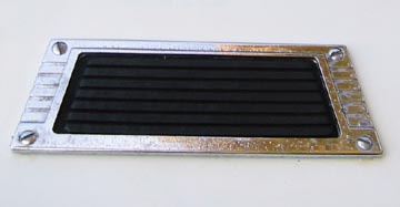

I am willing to make a mold of the Crosby steps pads for you, lets make certain what I have is stock/correct first.....
this is what I have, a set of 4 on my Capri

Awesome Madprops! Yours look just like the frames I have. Are they 8 3/4" long by 3" like mine? I got 4 frames from Brian L who generously gave them to me. Two needed chroming and 2 just needed some cleaning up. I was going to get all 4 re-chromed so they all matched until I got an estimate for $300. Fortuitously, Shipley let me know that Todd (thetudor) was selling 2 of the same size frames on Glassifieds. They're in good shape and don't need to be rechromed. I'm buying those, which combined with the 2 good ones from Brian solves my rechroming problem. I'm stoked. Thanks for the tip Shipley.
Madprops, I do have two black pads from the frames Brian sent me. I can send you one if you want to use it to make the mould instead of using yours (if there is a risk of it being damaged).

I've done a little research into the rubbers- There are a LOT of them out there. I've found one that I think will be IDEAL, and he company sent me samples of the 'cured' product. It might be a tad softer than the originals, but it is tough stuff. It is also UV stabilized.
It is a crystal clear product, and as such can be tinted to whatever color you want, including white...
Re:1957 Crosby Capri 15 years 1 hour ago #50334

It appears that both Madprops and Andrew are generously offering to make the white pads. Is either one of you just chomping at the bit to do it? I can send a pad to either one of you to make the mould. Madprops, you may already have the same size that I do.
Does anyone else need some white pads that are 3" x 8.75" for the shape Madprops shows above? Brian L? Shipster?
How many do you need to make to make it worth your time? I really only need 4, but would take 8 to have a back up set. How much do you estimate we're talking here?

I already have a package of silicone molding material around here somewhere and I will make you a mold then you can make as many as you want OK

I have pulled the best pad I have off the boat today and cant find the silicone RTV I mold material I had
so Andrew before I order another 1 lb. silicone kit $36
I dont see where we need a flexible mold here especially for a final casting thats flexible.....it seems to me we could do this cheaply with a plaster mold & we could seal off the plaster with a light coat of epoxy
any objection to a solid cast plaster mold?
Michael

No objection here. It seems to serve the same purpose for cheaper.
