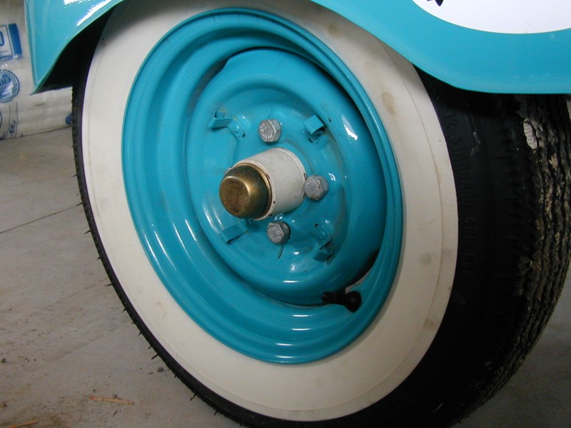

The wheels are white. They show no sign of yellow and appear to be the correct wheels. Comments?

These would be the correct rims, color was typically yellow.

Well, having said that, what size are your rims?
My originals where 8" and white.
I changed over to the 12" that were typically yellow.

As far as I know all Tee NEE rims were white from the factory. ( I checked all my books from 1956 to 1964)

Del's right, 56 & up were white. I guess I'm just used to seeing them yellow. I believe this is from 1955, so I assume it's a safe bet they changed to white in 56.
