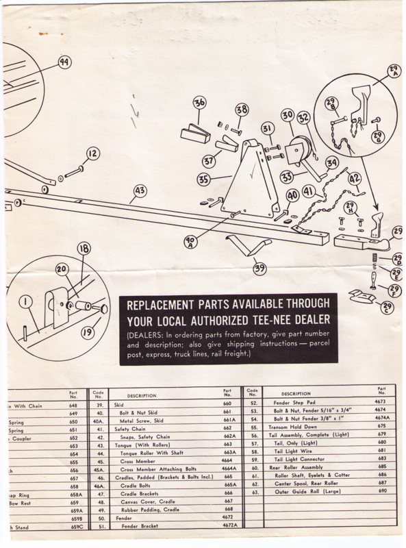

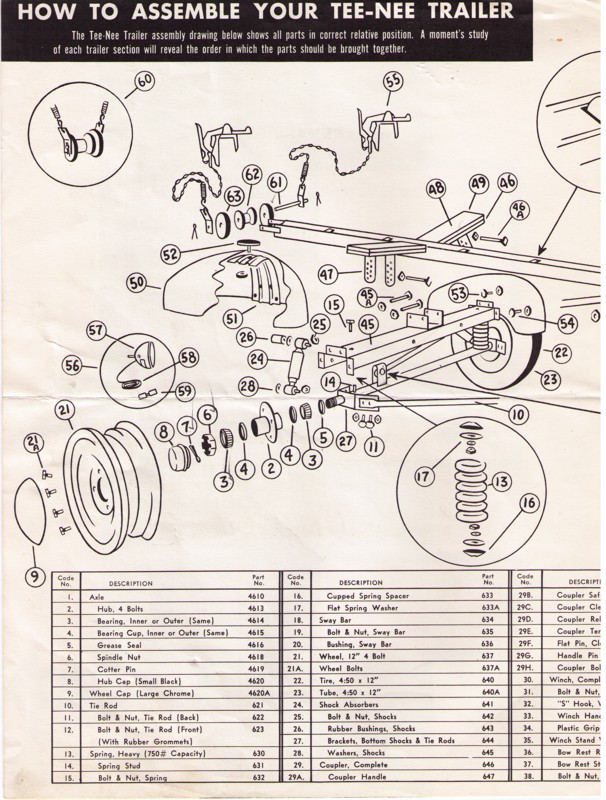

Randy, studebaker brake pedal pads are about as close a match as you'll find
Not sure what you're looking for in terms of a parts list, but I have this
Cheers
Bill

Randy, to what rollers are you referring? There are the rollers in the center beam channel, which you can get stainless steel versions on eBay, and rollers at the transom support.
Bill, these are really cool scans. Going to save these. Thanks for sharing.
Eduardo
Re:Tee Nee Trailer parts 11 years 7 months ago #107374
yep...very cool scan....and well worth a twinkie...I saved them too

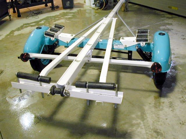

I searched for a long time to find either white or black rollers for my Tee Nee. No one I could find makes one long enough with an integral shaft that you can cut down. I'm surprised you found some up there Bill. If there was any way you could track down the manufacteurer it would be a big help for others in the future.
I finally bought two rollers (no integral shaft) from etrailer that were long enough to make both pieces for each side. Problem was it had bores to fit loose over a 3/4 shaft.
I found some 7/8 stainless round bar and machined the exposed shaft area to 5/8 and the areas in the rollers to .800 in. and pressed the cut down rollers on to the shaft.
I wet sanded them on the lathe and used ArmorAll vinyl spray to shine them up a bit.
It was a lot of work, but I'm always looking for an excuse to work with my lathe. They turned out nice and the shafts will never rust.
Sure would be easier if we could find the same ones you found in Canada.
Don
