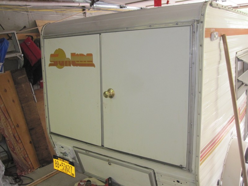

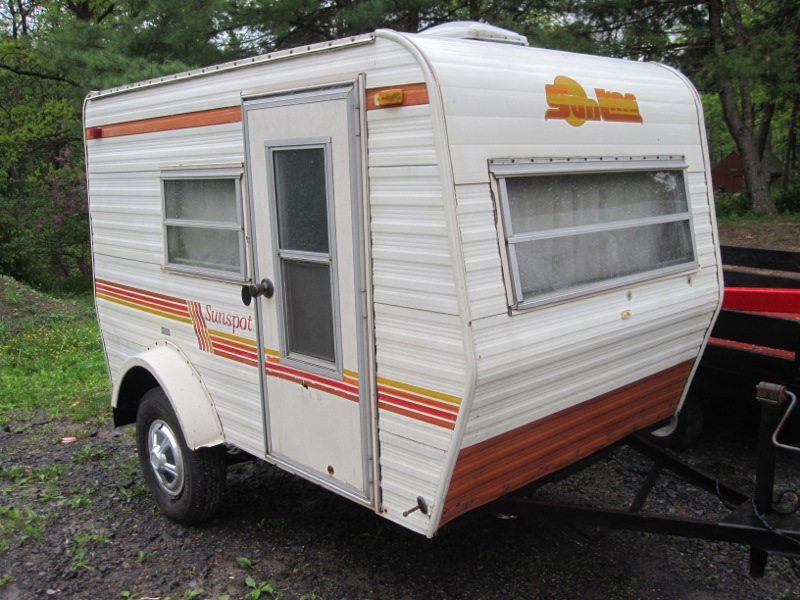

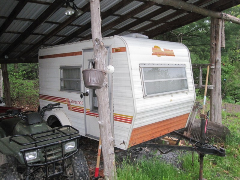

Kind of a crazy day, but got this home about an hour ago. 1979 Sunline Sunspot. Pics now, more later.

Was a bit discouraged last night, couldn't get it in the garage because it's too tall. Too tired and stiff to do much last night, plus I had a sciatic nerve that didn't want to let me relax. That is in part because I was an IDIOT yesterday, certainly not the first time nor the last. I left here a few minutes after 7 yesterday morning, and drove 85 miles before I realized I didn't have my wallet. So I added 3 hours to a 6 hour trip and just about killed myself sitting in the truck that long. Idiot...
Anyways, feel better today. Got up, got the measuring tape out and lo and behold, Spot fits in our pole barn. Woo hoo!
So with Spot under cover, it's time to work on Nine Lives, a little cat sitting in my garage...

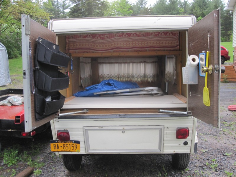

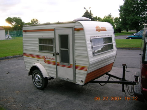

Re:New project - tiny travel trailer 15 years 5 months ago #32665
The reason Spot was so high was that a previous owner had removed the axle and took the spring seats off the bottom of the axle (which is how it came from the factory) and put the spring seats on top, which of course elevated the trailer. Yesterday I removed the axle, ground off the spring seats, bought some new ones at Tractor Supply, tack welded them on and re-installed. Looks much better don't you think?
Next is a complete 12V re-wiring, plus new 110V wiring. This trailer never had 110V, but that is about to change.
Before
After
Re:New project - tiny travel trailer 15 years 5 months ago #32706
Much better Frank. She looks good like that.
Re:New project - tiny travel trailer 15 years 5 months ago #32724
Thanks Bob!
With that done, I cleaned the interior to get ready for some dis-assembly and future construction. The floor is only 73" long, so initially we'll get a 6' air mattress or sleeping bag pad, and if that's not possible we'll buy some high density foam. Good thing I'm just under 6'!
I have the OEM hub caps sitting on my shop bench right now for a bit of minor dent repair and then a good cleaning, polishing and waxing. I've yet to really wash or clean the exterior either. Maybe this weekend. I've ordered all new wiring, a new junction box, new levels, and 4 scissor jacks. Yesterday I got new stop/turn/tail lights (along with white plastic angle brackets) in the mail to replace the old utility trailer style ones. All existing wiring is coming out, new 12V wiring being installed, along with auxiliary power for back up lights (I have yet to purchase). New 110V wiring will be added as well. We're still hashing over plans for the new built interior, but as long as there's room on the floor to sleep, all is good for now!
I have to do a bit of research on trailer doors. This one is falling apart, and needs to be rebuilt.
More to come...

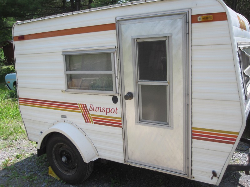

"New" door 15 years 5 months ago #33170
Came out great!

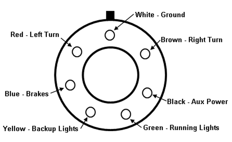

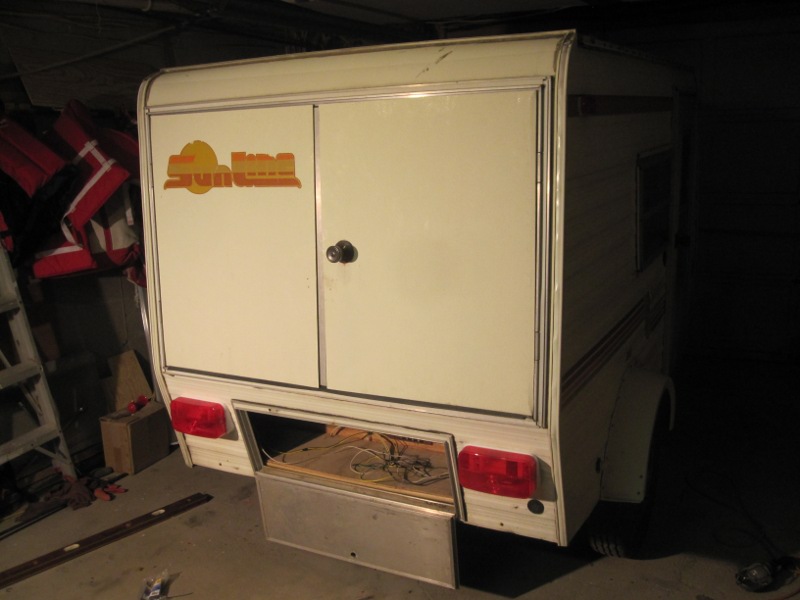

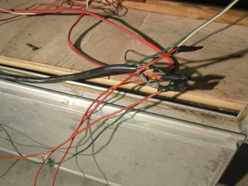

Hand me that big roll of red wire! 15 years 5 months ago #33313

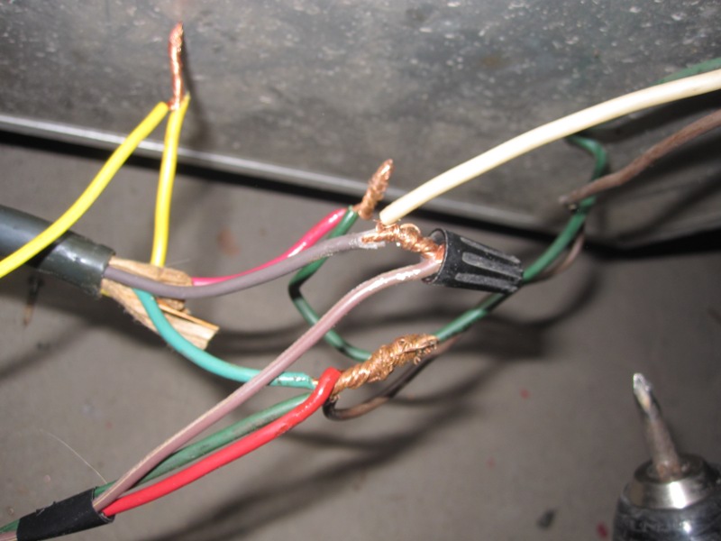

I've had boats with wiring challenges, so this didn't surprise me too much. All the wires coming out of the original sheath have been connected to red wire, with one exception - the red wire coming OUT of the sheath was connected to a green wire. I assume that was to avoid confusion? :laugh:
All I wanted to do was hook up some OEM stop/tail/turn lights. It's gonna have to wait a while till I figure this one out!

Re:New project - tiny travel trailer 15 years 5 months ago #33559
John, that is not what I need help with. The colors of the 4 wires running into the back are not what I would expect for a 4 trailer wire harness, plus they were all connected to red wires with one exception. Usually 4 wire trailer harnesses are brown (stop/tail), green (right turn), yellow (left turn) and white (ground), right? On this one, brown is ground, yellow is left turn, red is right turn, and green is stop/tail. In this picture, I have removed most of the red wire, and added new wire to replace it to help me figure out what's going on:
I pretty much figured it out last night and this morning, but now when the right turn signal is on, the rear marker lights flash. Otherwise the marker lights do not work as they are supposed to. That is something I intend to run down after work tonight. Right now, I just want the tail lights to work as they need to, and they do, with the exception of those rear marker lights flashing on a right turn.
Eventually I will wire it to correspond with the 7 contact rv plug in my pick-up, which is fairly standard. It looks like this:
I will have two trailer connecters on it for a while - a regular flat 4 pin so Gail can easily tow it and meet legal light requirements, and a 7 pin for my truck for additional circuits I want to have. Eventually I will wire Gail's Outback for the same 7 pin connector as is on my GMC. I know how to do it, it's just a pain to do!
If I hadn't taken three full days to go to Silver Lake, all this stuff would be done. Now it's going to be every morning and every night till we leave Thursday morning.

Re:New project - tiny travel trailer 15 years 5 months ago #33569
So do I John, that's easy on my GMC. It came with a tow package, 7 pin RV connector, and I have a 4 pin flat adapter I use with my trailers. Gail's Outback has a 4 pin flat, that's easy to hook up. Got a connector for her wiring harness from NAPA, presto zippo, done. What is not easy is wiring a 7 pin into Gail's Outback. It is not set up for it and is very difficult to do. I want to eventually have 7 pin power for the trailer, and have a 7 pin connector for Gail's car. Wiring the trailer is not the problem, it's wiring Gail's Outback.
Also, before summer's end, I expect to go to a 5 pin flat for the boat trailer when I add brakes. Most of these new hydraulic couplers have an electric attachment to prevent reverse braking. When I do that I'll get a 5 pin adapter for the 7 pin on the back of the GMC.
With the travel trailer, I hope to add brakes, back up lights, and auxiliary power.
This stuff is not difficult for me John. I wired my t-bucket front to back (for instance). I've re-wired plenty of boats and trailers, and pretty much know what to do. It just takes time, and wiring a 7 pin connector into Gail's car will take up the better part of a day.
I don't know how long it will take to figure out this trailer wiring, because so much of it is hidden and very well may require taking interior walls down. Never "did" a travel trailer before, so I'm learning as I go. But legal lights need to be working by Thursday a.m.

Re:New project - tiny travel trailer 15 years 5 months ago #33581
That link you had for etrailer is foreign stuff to me John. I want to set this up so it corresponds to the colors already part of my 7 pin connector on the GMC.
I didn't take anything you said as an insult. I have done a lot of wiring (110V at home and lots of 12V). In fact, I often add my own "twist" to 12V stuff and believe my wiring is better than most. Some of it is just experience too. I'm certainly better at wiring than I am at painting! Speaking of which, I learned something about Brightsides today and may be able to cover it with a base coat/clear coat next season. Maybe. We'll see how things go.

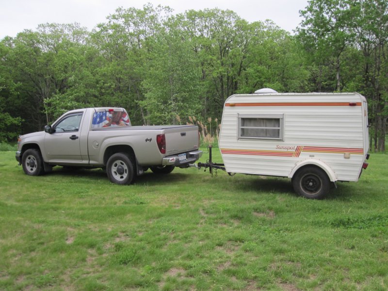

Re:New project - tiny travel trailer 15 years 4 months ago #33745
All new lights, all new wiring. Only real problem was a dead wire somewhere in the front of the trailer feeding the front right marker light. Fixed that. All the light wires are just twisted at the connections with the new 4 wire. I'm taking along my electrical stuff today and will clean it up at camp. Everything will run to and from a junction box. Forgot to get a license plate light, need to do that plus figure out where the plate should go. Doing great! We'll be out of touch till we get home Sunday.

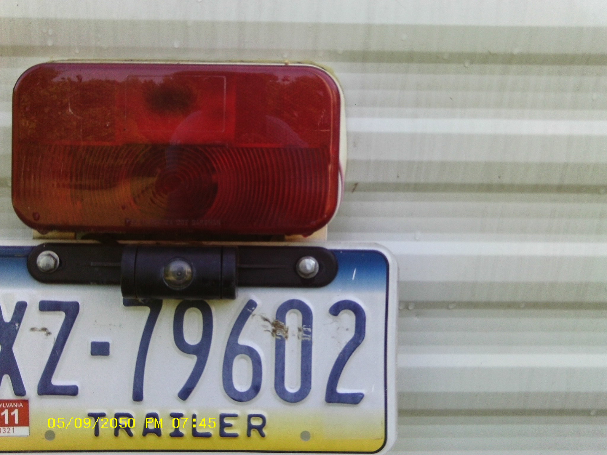

yep mark ,and frank if you go to an rv dealer they make a plate holder the bolts to those style of lights,and they are inexpensive,they usually have them in plastic and metal
Re:New project - tiny travel trailer 15 years 4 months ago #33933
I didn't realize they made a driver's side rear light with a license plate light and bracket. They do, and Thursday before we left I ordered one. Now I'll have a spare lens. These RV lights are cheap, like 5 or 6 bucks apiece, so no biggie.
Fish Creek Pond Campground, Franklin County, NY (northern Adirondacks, right outside of Tupper Lake)

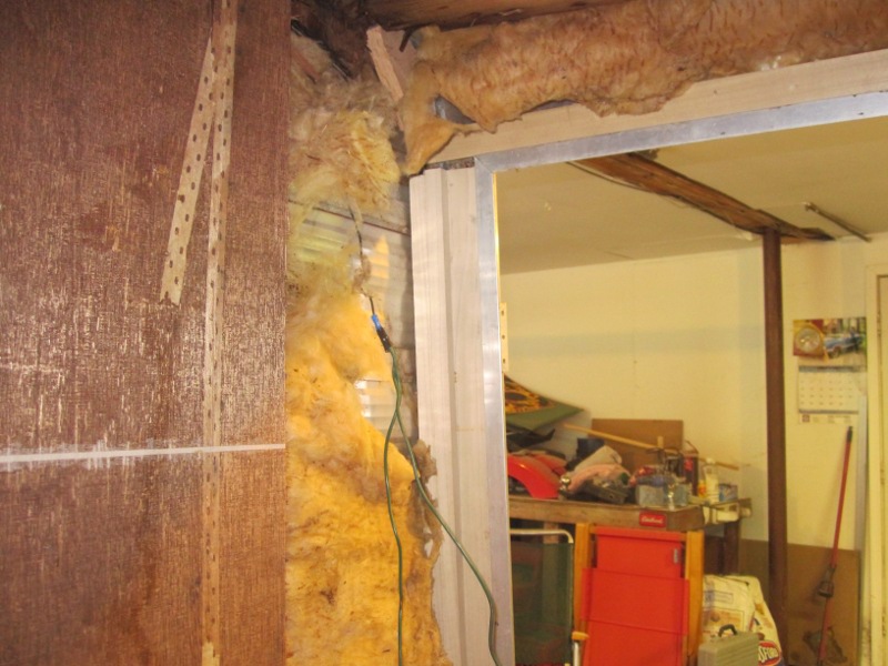

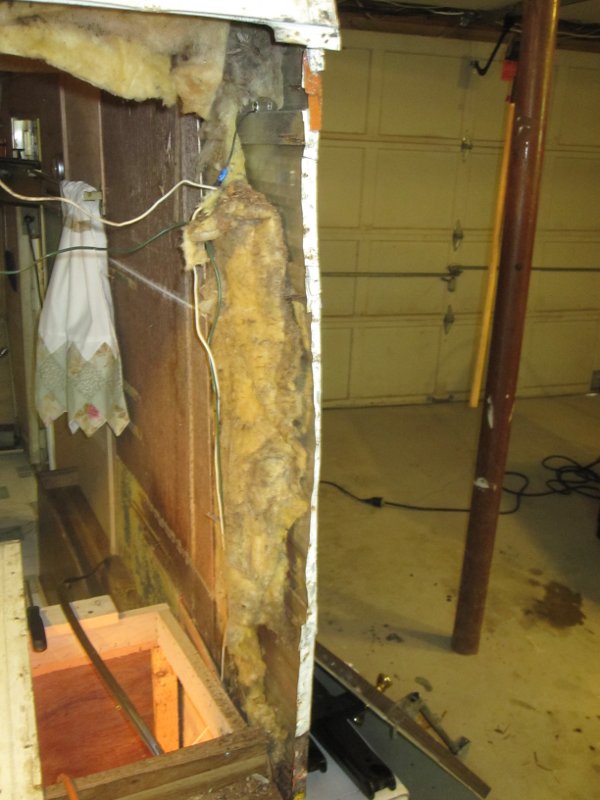

Rot repair 15 years 4 months ago #34776

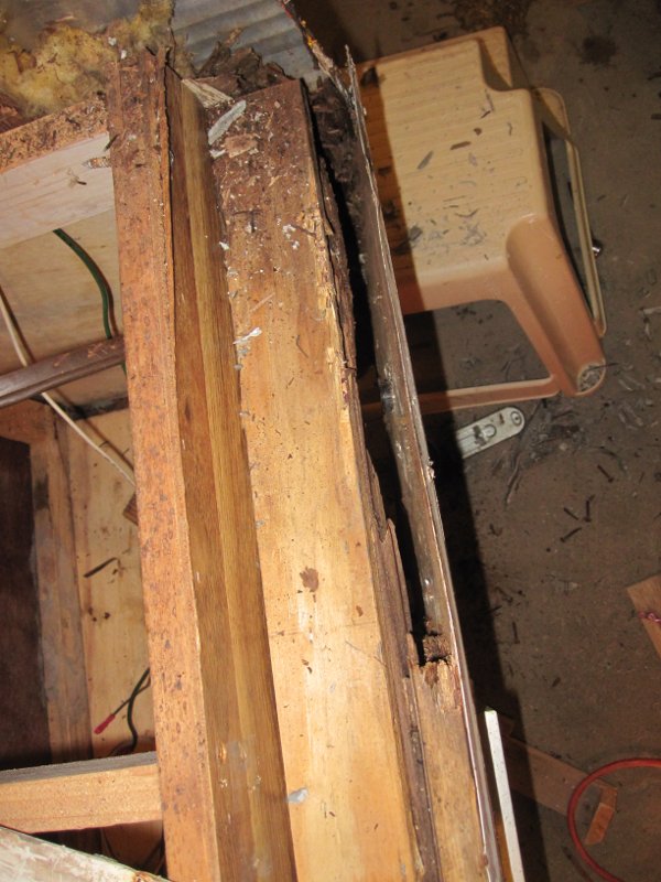

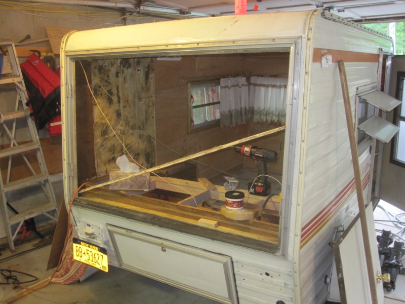

So now I'm replacing a bunch of rotten frame wood in the right rear corner. Not much left to do here but shape the wood (poplar) to the right dimensions, clean up what's left of the butyl tape I stripped off with acetone, re-apply butyl tape, staple and screw it back together. Probably will not get done today. Learning a lot!
Re:New project - tiny travel trailer 15 years 4 months ago #35392
I'm not sure how good a job I did, but all the rotted wood that fell out of the right rear got replaced today. Everything inside from the top of the corner seam all the way down, and then back across to the wheel well opening, the entire top frame for the door, other pieces here and there.
I didn't have much to go by, so maybe my door frame will be a bit tight, but I don't think so. I should know tomorrow. This is the Primary piece I made for the side of the door frame and corner of the trailer.
Air stapler gun was a major asset. I should have had one of those a long time ago! A buddy lent me a table top power plane, and I wouldn't mind one of those either.
This all started when we got back from our first Sunspot camping trip the 13th of the month. Soon as I had time a few days later I went down to re-do some of the wiring...
Good this is done. I need to drill new holes in all the new wood, but my right shoulder told me to quit for the day. Tomorrow drill new holes, remove frames, stick butyl tape on, place frames in place and screw them down. Then I can move to wiring and other interior and exterior jobs.
Cleaned the shop up (me too), put all the tools away, and went to dinner at the Midway Cafe. More tomorrow.

Re:New project - tiny travel trailer 15 years 4 months ago #35429
Thanks Jesse. This should be about it, but now I need to go inside and start work there, right after I get my wiring sorted out.
Back at it!
Success! 15 years 4 months ago #35434
The doors shut and open just fine. Frame literally snaps into place. We'll see how it goes.
You can see in the pic the nice bright aluminum above the door frame. That's a result of the weathered paint disappearing when hit with acetone, which I used for removing traces of butyl tape. I need to find some paint for it I guess.
Off to the next project.
