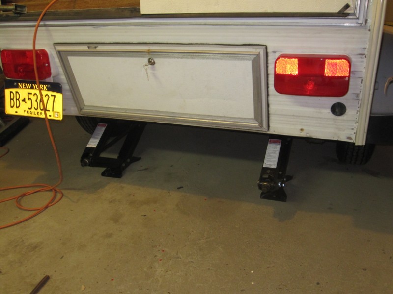

Well folks, as of 6:30 yesterday morning, Gail and I became grandparents. I figured I was going to Buffalo to see my first grandchild, but woke up sick and couldn't go. Gail did, so in-between resting and trying to take it easy, I mounted 4 scissor jacks.
I did it as close to each corner as possible, while keeping the jack ends away from people's shins. I added a new angle iron crossmember in the back, and used scrap pieces (a bit over 10" each) from cutting the rear piece to size to mount the front ones. Old steel looks crummy, but it's still good and strong. Each jack will be mounted with two 3/8 and two 5/16 bolts. I got new hardware last night (everything is just finger tight), and will wrap it up this morning. Basically, all the hard work is done!

Essentially took 1 and 1/2 days to get the scissor jacks mounted. Lot of figuring, metal fab, dozens of precise match-up holes in steel, then today was just getting new hardware on with nyloks. Time for a break!

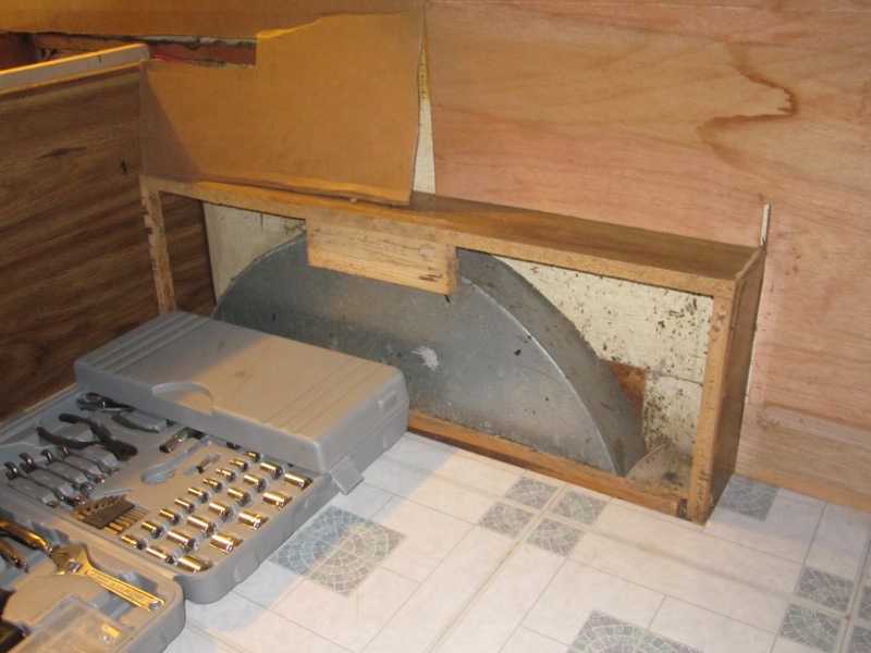

I tore the interior covers off the wheel wells because they were elevated such that a small open storage place was on the top of both of them.
Handy, but had to go away as these will be part of the bed base soon. I think I need more 3/4" plywood. These need to get faced with something more substantial than 1/4" stuff.

Just finished, all done in 3/4" AB grade oak plywood. Part of the support is a reconstruction of the wheel well covers with pieces of 3/4 plywood. Gail got the cushions done last night. You can see there are narrow and wider ones. The narrow ones will be seat bases, the wider ones seat backs (some day). Still need to get a couple coats of Minwax on the oak.
