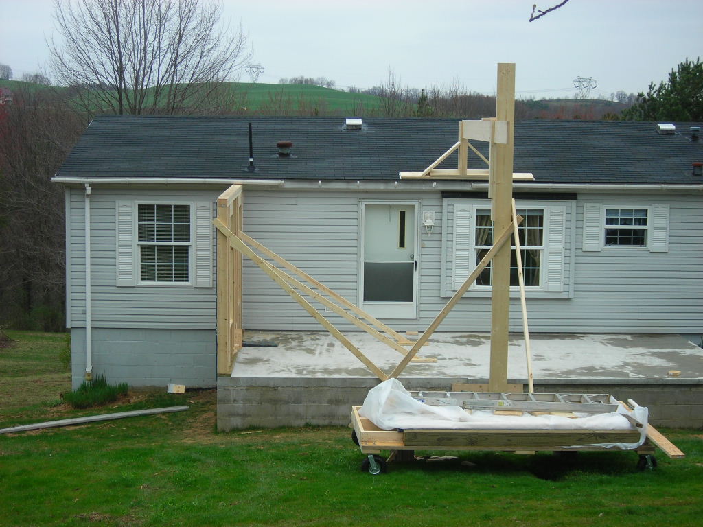

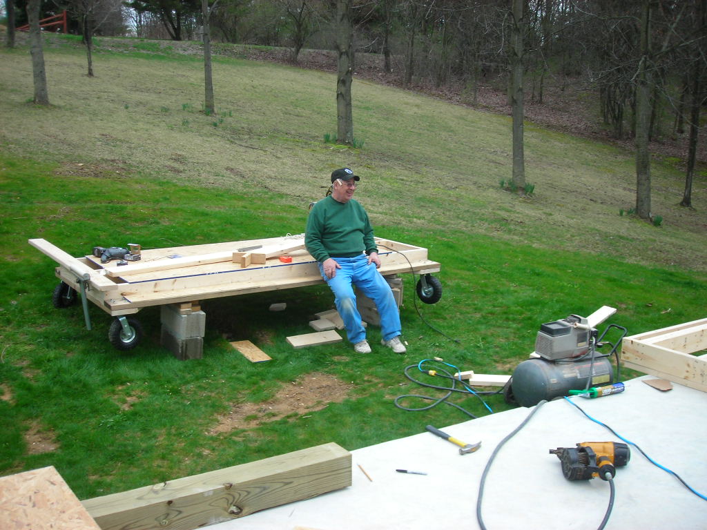

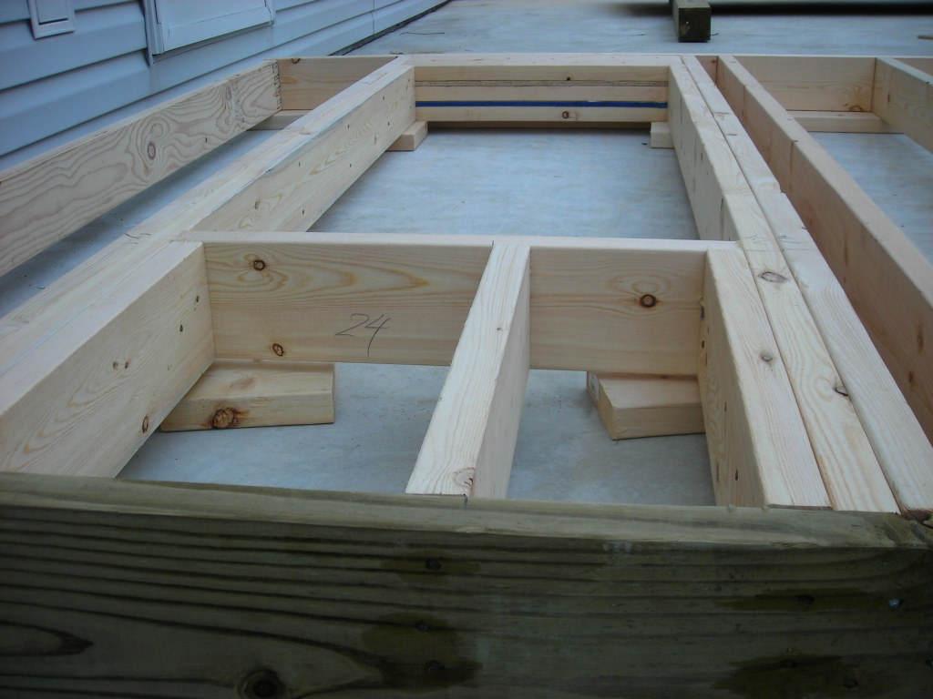

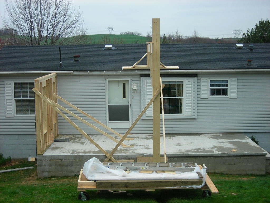

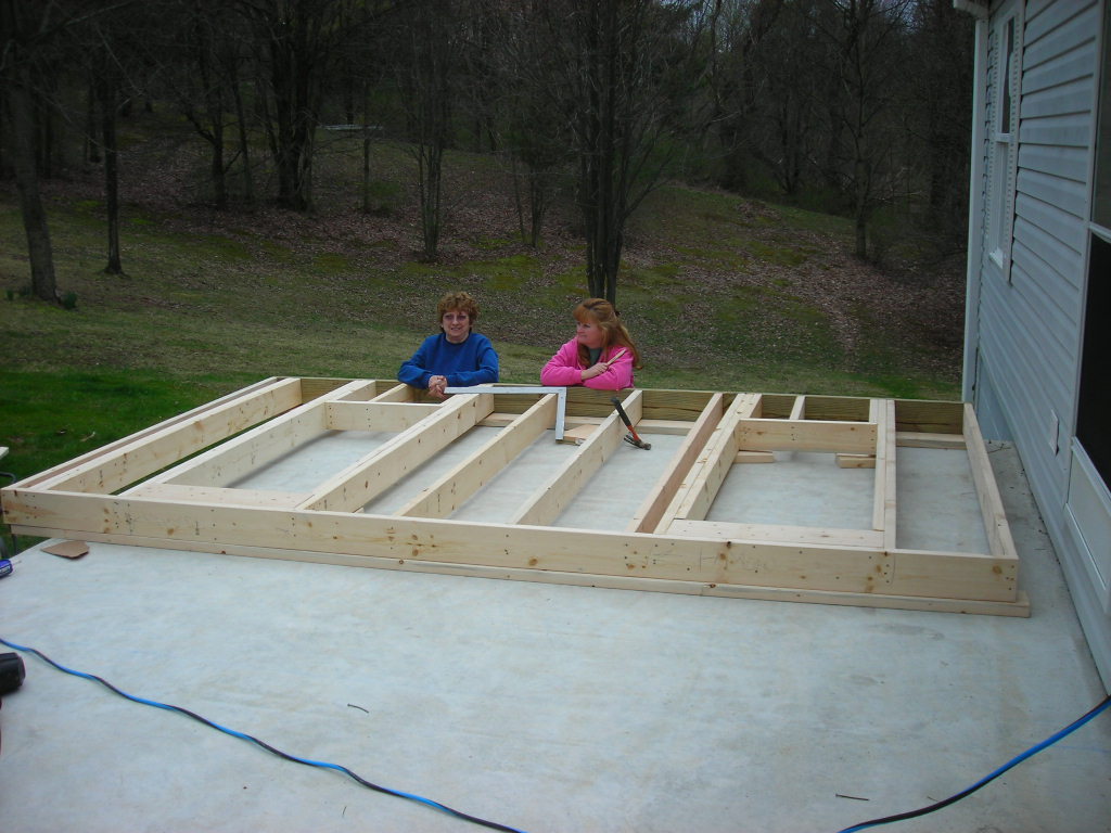

well im in worse shape then i even thought,it took most of the day for ed and me to frame one 12 foot wall,and its the easiset wall of the job,im hurting everywhere.

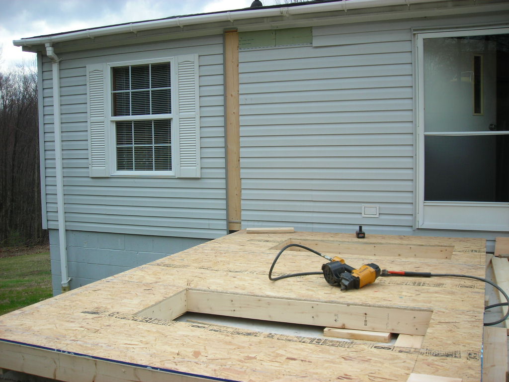

next i have to sheet it,then take down some siding and put nailers in the hose walls to attach it.heck its been so long since i built houses i forgot alot,lol.

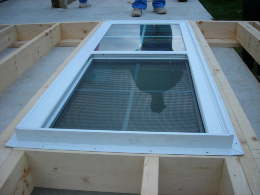

i even layed one of the windows in before i sheet it just to make sure i built it right.
i dont know how im going to get the roof done,i popped my knee loose just building the wall,lol. ed with my portable boat rack,that we used as a cutting table,lol.
Re:building our room and porch roof. 15 years 7 months ago #30132
Holy crap John are those 2x8's? That would be why your hurting so much!!!!!!!!! LOL I guess you really don't want that thing to go anywhere do you?! Looking good so far, but take your time buddy using those size studs will wear you pretty quick, especially when you get to the roof. Are you stick building the roof or are you having trusses made? Get as much help as you can lifting those walls. I wish I could get away from work right now to help you. Please take it at your won pace and don't hurt yourself. Looking good buddy.
Re:building our room and porch roof. 15 years 7 months ago #30135
  • john-gibson
  • Posts: 4014
  • Karma: 324

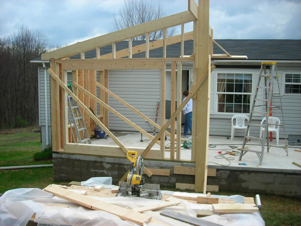

thanks bob,its a 2x8 treated plate and 2x6 walls.the plate is bigger because im ging to lay treated 2x8s down flat to hold up my 2x8 florr joists of the cement,the reason i didnt build the floor in the small room on the porch is money right now,lol.
as for the roof im stick building it with a 2x12 ridge board,and 2x10 rafters,my dad always overbuilt things,and i guess im the same way,lol.
wait till you see the 6 foot high x 8 foot wide window thats going in front,lol,there s a place around here where you can get windows for 60 bucks a peice,and the huge window was just 250,they are widows that were made the wrong size and brought back but they are brand new thermo paynes.

kind of thick on the depth of the walls, heck your losing what four inches off three walls of your inside dimension x the length by the width...4 inches might not sound like allot but...
Re:building our room and porch roof. 15 years 7 months ago #30239
  • john-gibson
  • Posts: 4014
  • Karma: 324
yep mark your right,lol,lol.
as for the depth besides the extra strength,i also get more insulation ,i can heat this place on less then 2 tanks of oil.
besides its the norm here ,the walls in the house are also 2x6,we have been building 2x6 walls for years around here.
as for the 2x10 rafters in 12 feet (one side) i could get away with 2x6,but for insulation i get more r value,i was going to go with 2x12.and should have.lol.john

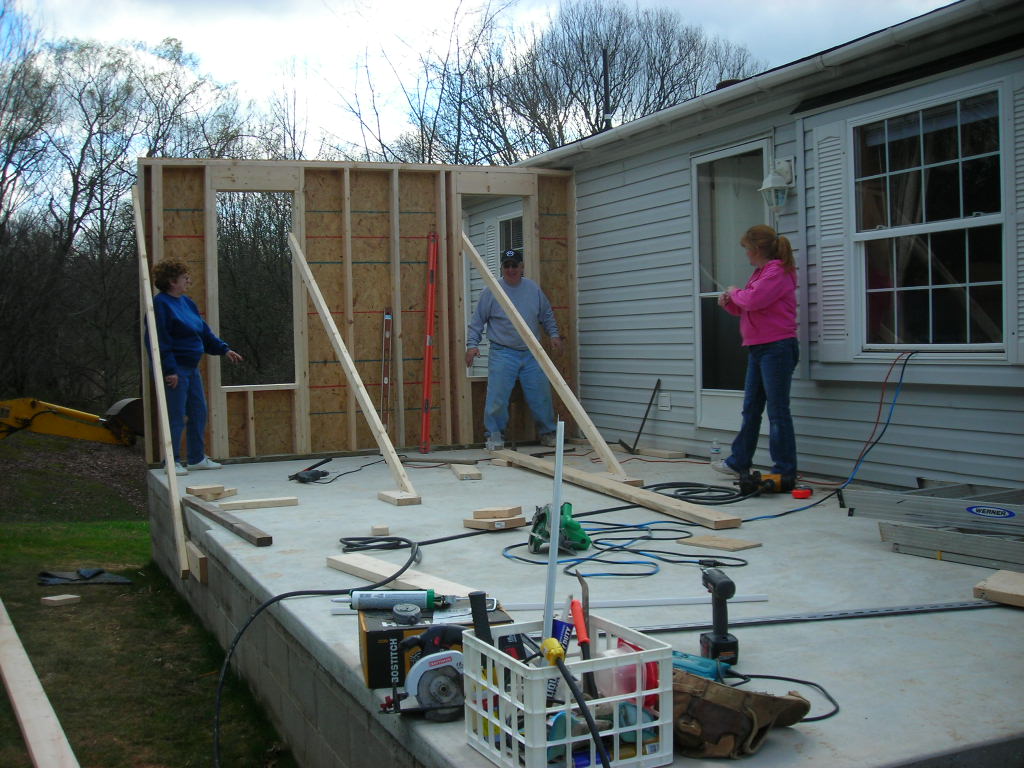

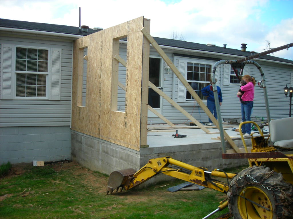

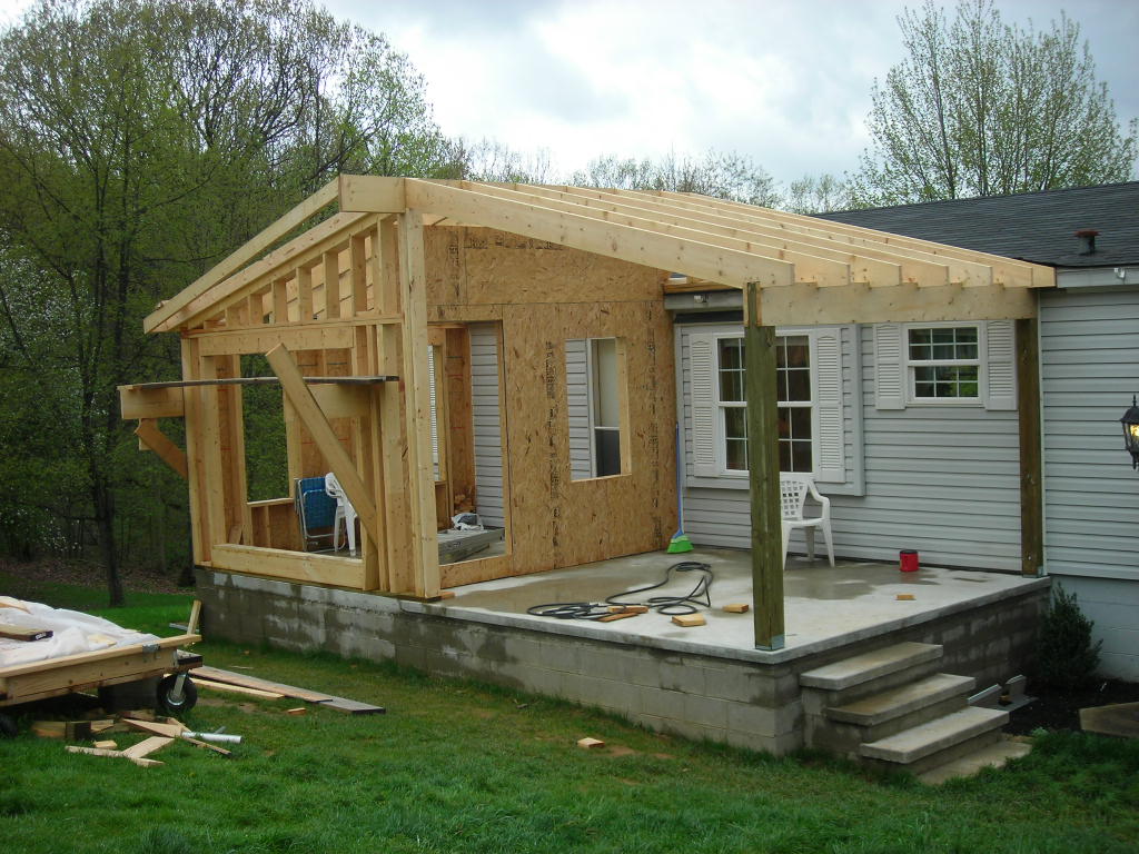

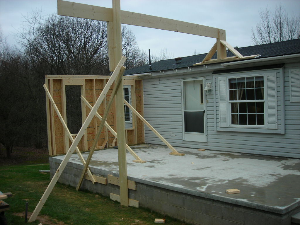

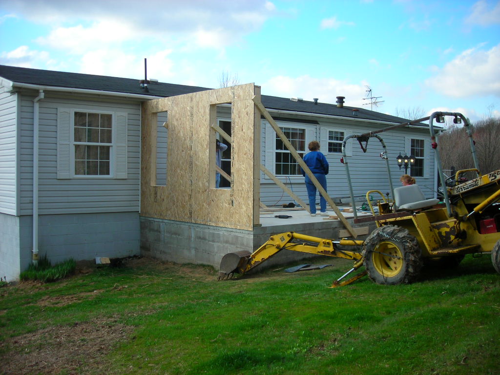

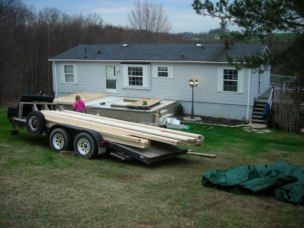

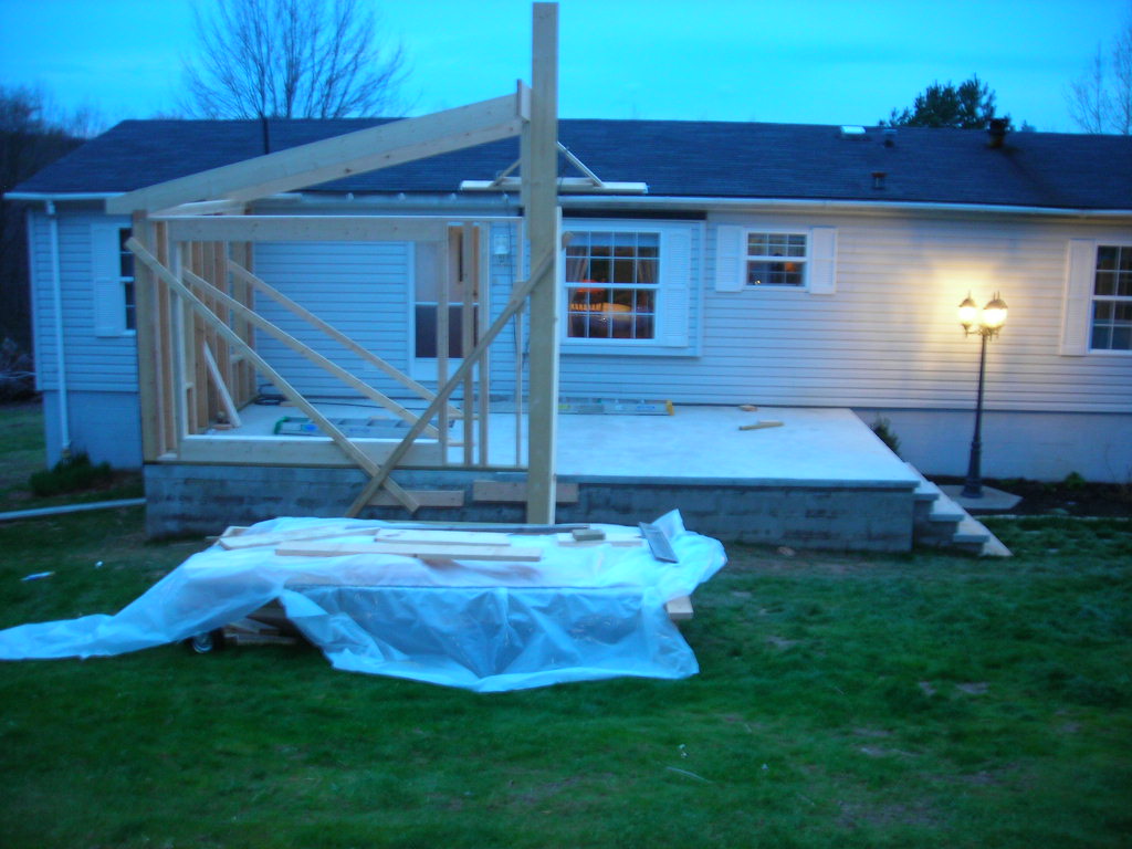

2 freaking days to build one wall!i used to be able (with 3 other guys)frame a ranch house like mine(framed ,roofed,and windows and doors)in 3 days,thank goodness ill have my uncle and steve here to tommorrow,but im going to miss ed ,he wont be here,boy he can work.
hes in better shape then i am,lol.john p.s. 4 pics

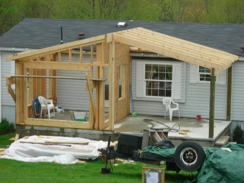

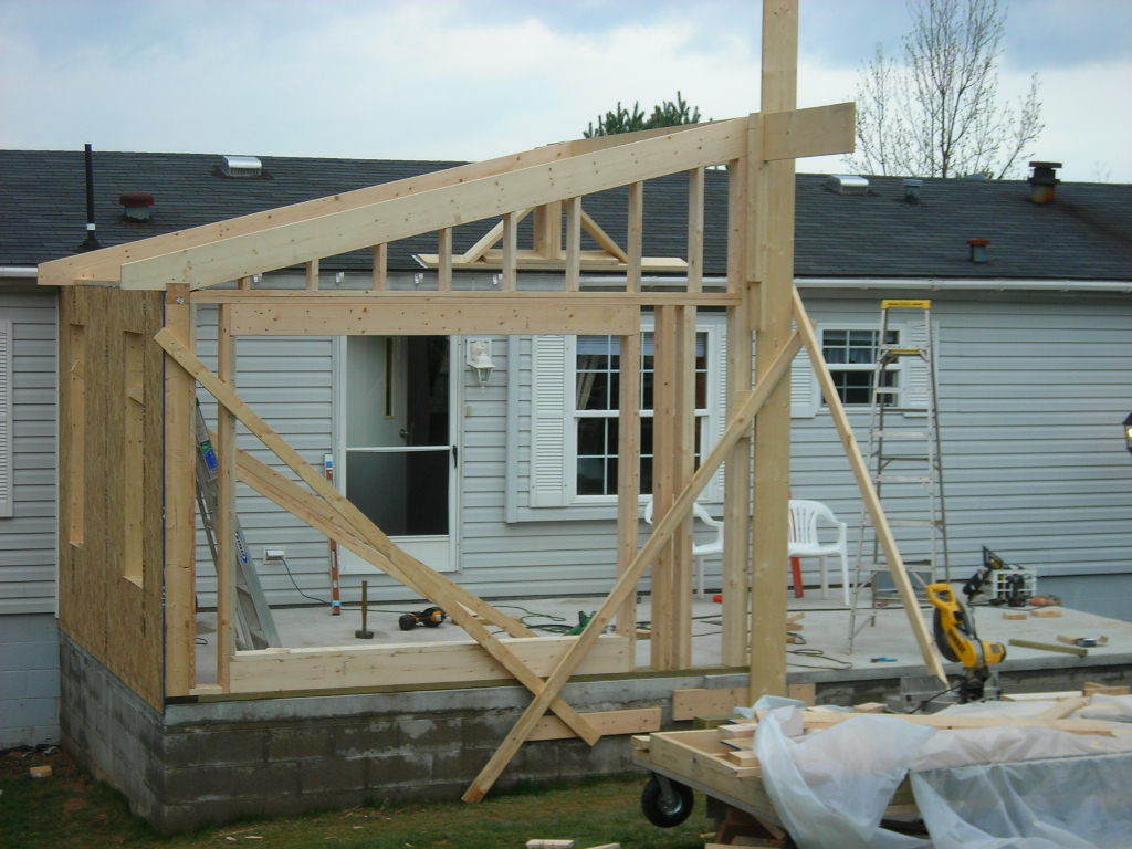

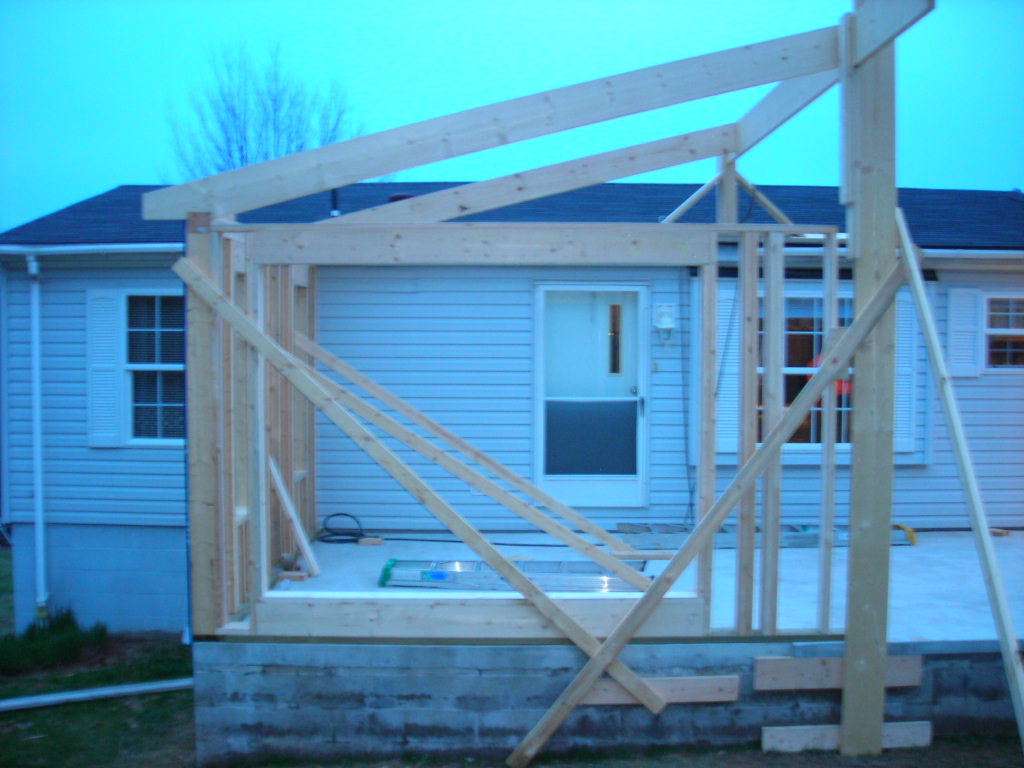

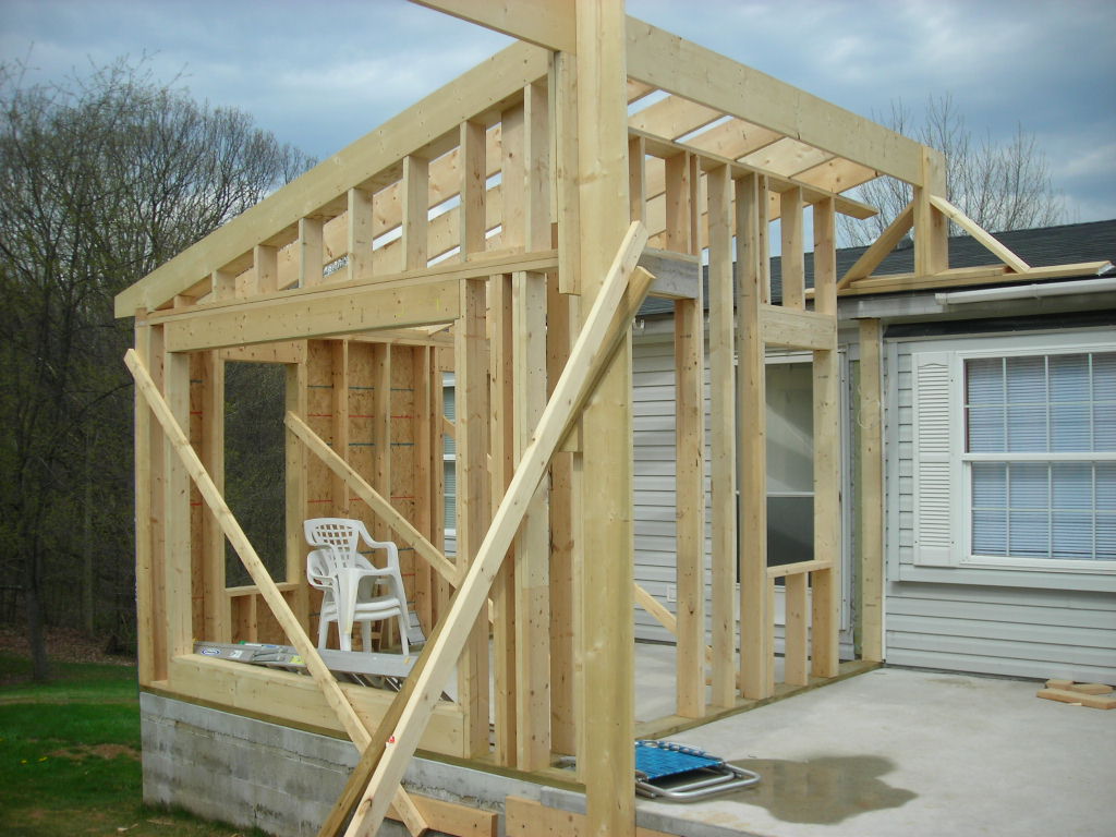

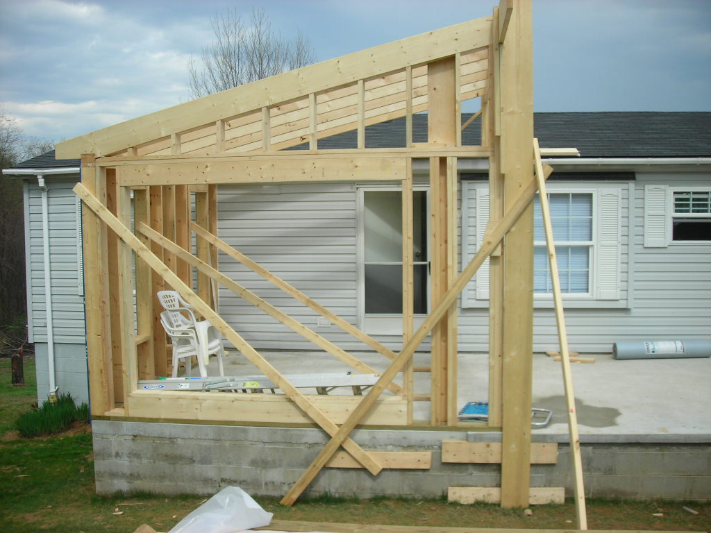

well,after all this time(the weather and my body wont cooperate),but we did get the temporary story board up,and 1/2 of the ridge board(2x12)up and in place,it takes a long time to get it just right,plumb ,level,and square with the rest of the room ,house and porch,but we got it,now its raining.
we also got 1 2x10 rafter to use as a pattern for the rest.
now to wait out the rain.
Re:building our room and porch roof. 15 years 7 months ago #30486
john,looks like your going to have a high cathedral ceiling. very nice. ron

yeah ron at least thats the plan in my head,lol.the front wall will go all the way under the ridge board for support ,but the right side wall will be between the door and big window on the porch.it will stand right where the light is right now.
the rest will be porch roof.
it will be a small room but a huge 6 foot tall by 8 foot wide window will be in the front wall.
and between the smaller windows on the left wall will be an electric fireplace my mom and ed got for lorraine for christmas.
we are building the room and roof over the porch,then have to save up to do the rest,almost broke,lol.john

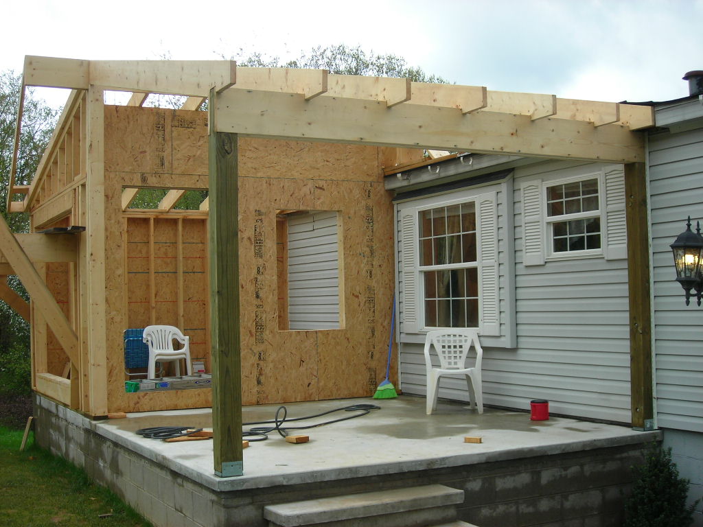

thanks guys,we got the front wall up today and 2 rafters,i still have to cut and install the jack and king studs under the ridge board,and then that story board(upright 2x10 )can come down,here is what the front wall looks like with window (6 foot tall and 8 foot wide) looks like.
the tough part is its all in my head,i havent drawn anything,and its hard to explaine until its done,lol.

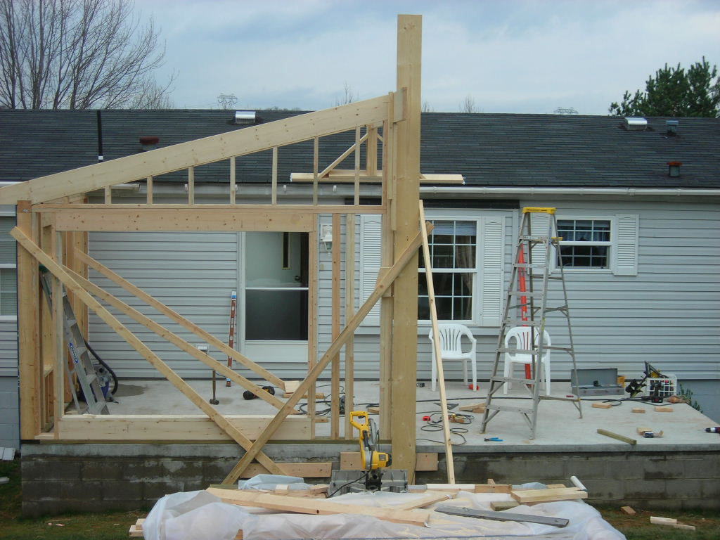

well,ed,lorraine and my mom helped get the gable end of the half of the roof over the room ,but man im slow,lol.

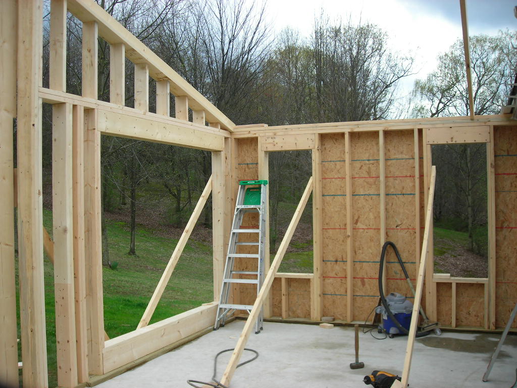

thanks bob,i had steve,ed and earl here to help yesterday,we got the side wall with the doorway and window in,(its set back from the ridge board because of the house window.)we also got up most of the 2x10 rafters over it ,next is setting the 6x6 posts on the right side of the porch,and running the rafters there too.
and i had a 3 nitro spell,chest pains,thank goodness the guys were able to keep going.it was too hot for me,but after the nitros i went back at it just slower,lol.

thank you bob,im trying to go slow and i am,lol.steve and i,got the porch posts up,and 1 of them bolted to the house ,also got the beam built and most of the other rafters done,on the porch side of the house,man im beat,and steves doing most of the work,but its coming along,not too bad from doing it from my head,lol.john

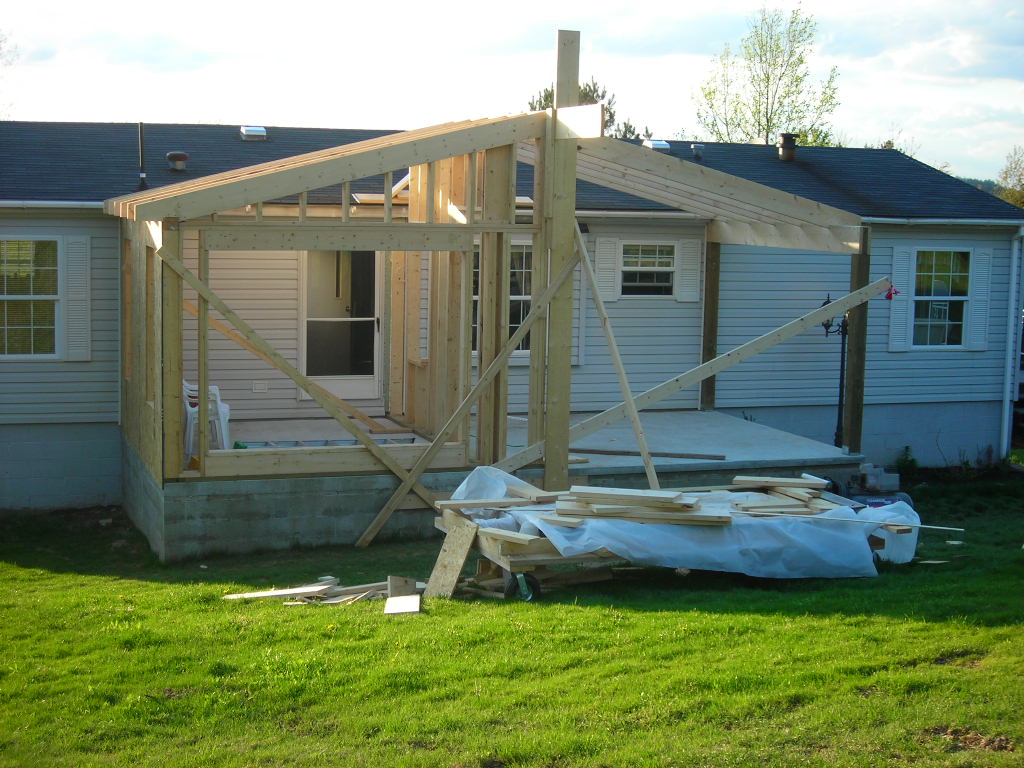

well,we havent gotten much done,i still have another porch post to put up,finish the eve ladders and lookouts,sheet the front and roof,finish the rest of the roof framing on the house roof,then shingle,im hoping i have alot of help this weekend,or its not going to happen,i probably wont have a boat ready for the hammondsport show in july,but my wife did promise me she would help me with the boat after the porch/room is weatherproof with the windows in.john

heck,its taking so long,that i just noticed that in the 1st pic there are no leaves on the trees,ut there are in my last post,lol,john

Re:building our room and porch roof. 15 years 6 months ago #31383

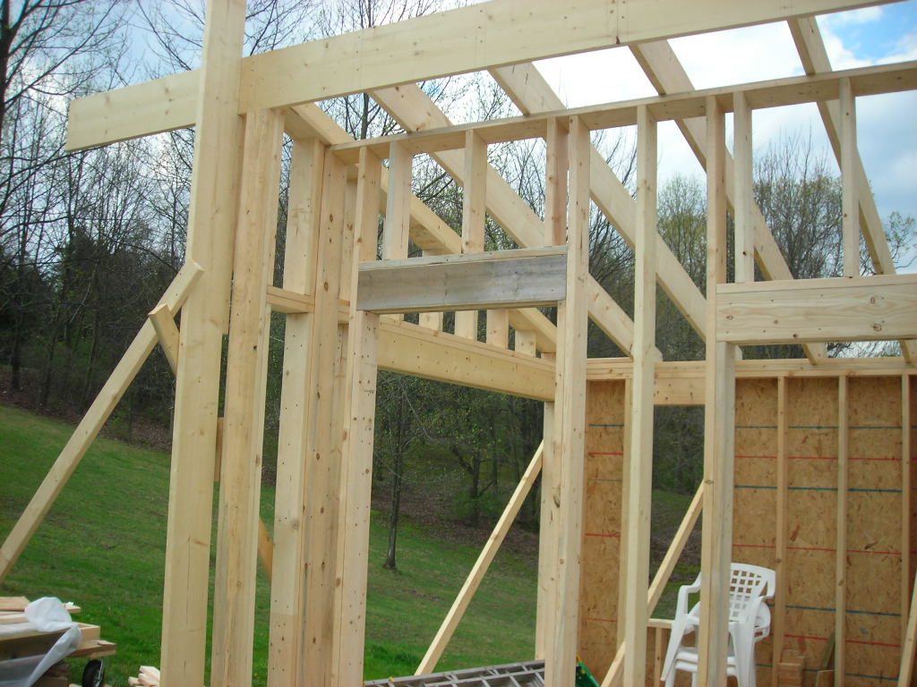

OMG..6X6 PRESSURE TREATED TIES FOR THE CORNERS.i guess your gonna add a 2nd story soon. hehe

bob,yep,im going to take her up on her offer,sand,sand,sand,lol,just kidding.
lol ron ,guess what theres another 6x6 going in between those two,lol,i am putting it in just in case and for railing,lol,johnp.s. did you notice the "birdsmouths" over the wall and beam,they cover both sides to lock things in place.
