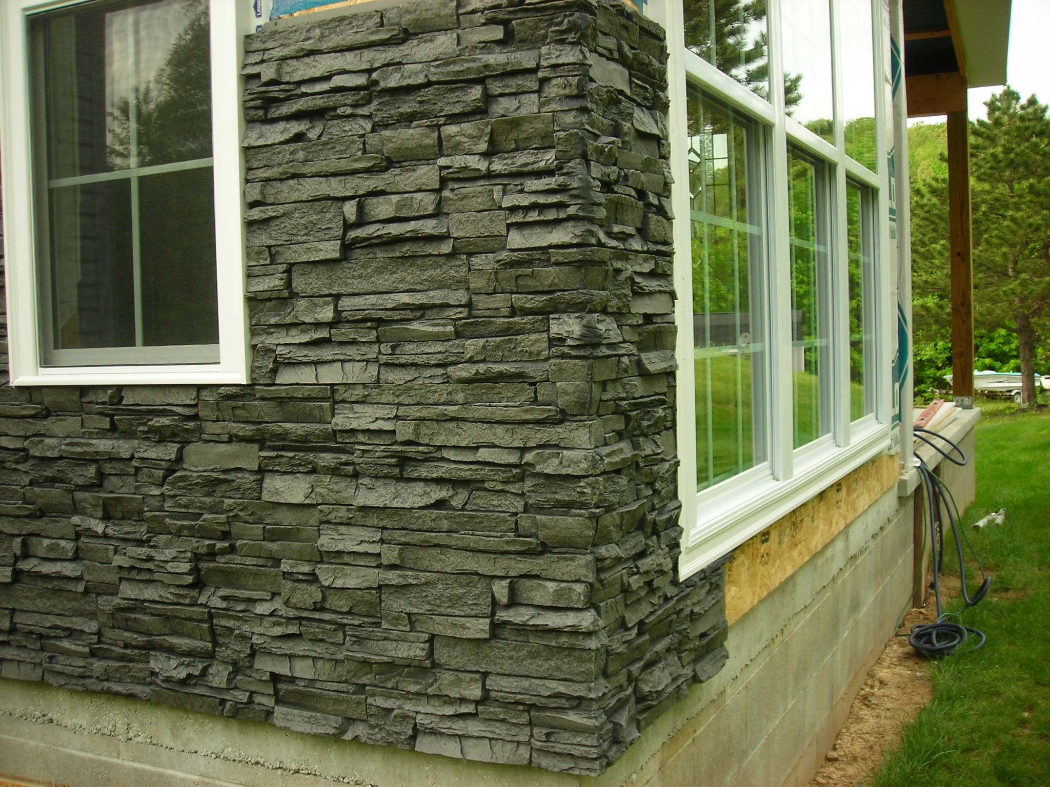

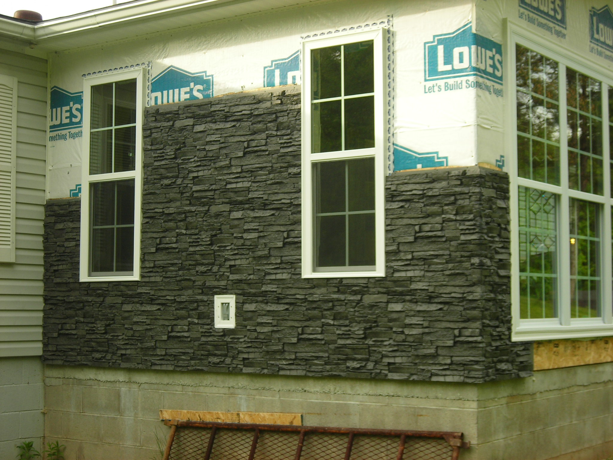

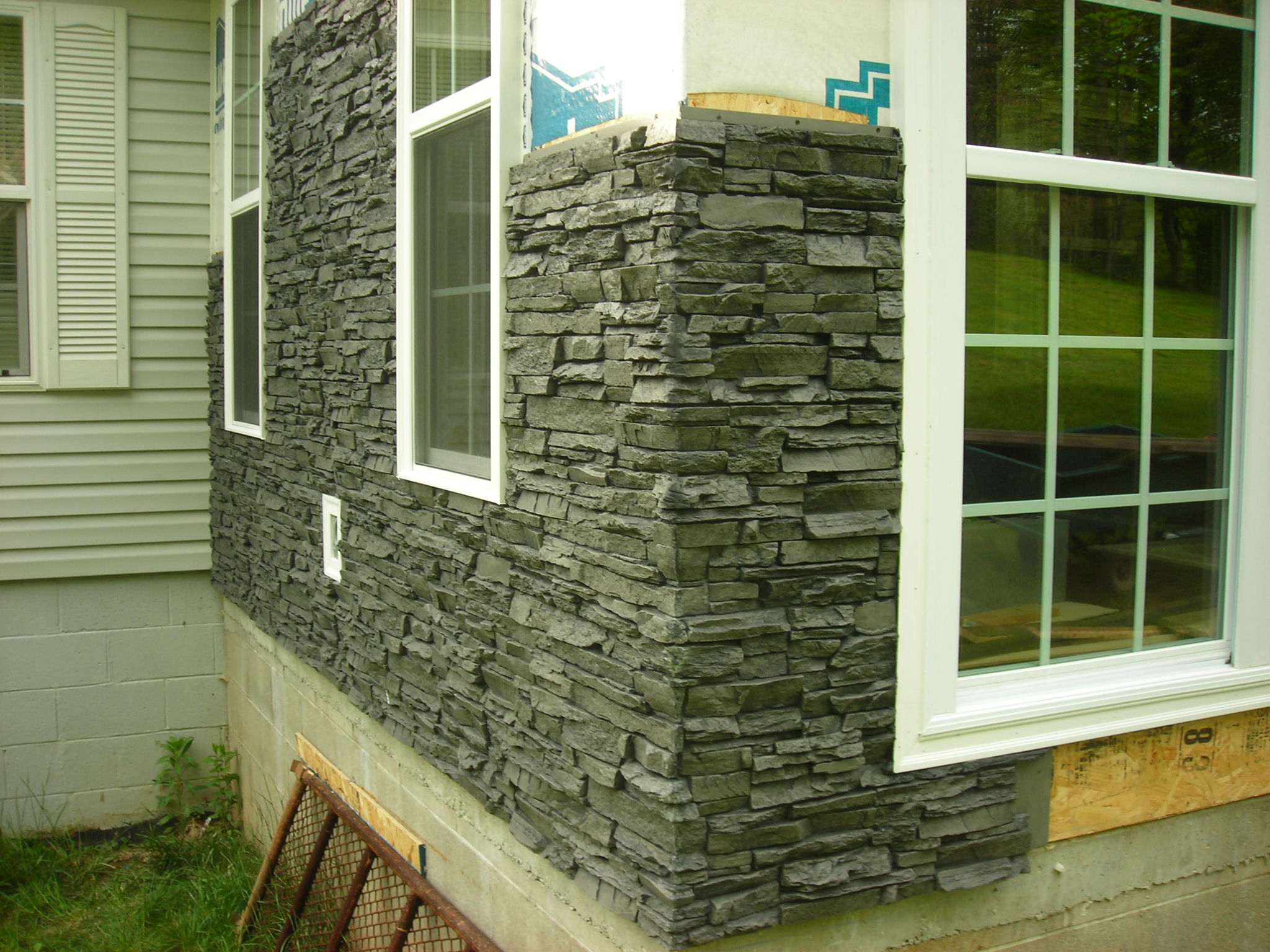

thank you skip,yep its coming along alot of glue,screws and caulk,lol,the toughest part are the corners,they have to be mitered then filed down to match each side.
i think it will add a lot to this plain house.john

John, looks fantastic! How did you do the outside corner? It looks like it was pretty seamless. Great looking job. Lorraine should be happy. I know you must be. When you get some landscaing done in front of the stone it's gonna look even better. Thanks for sharing.

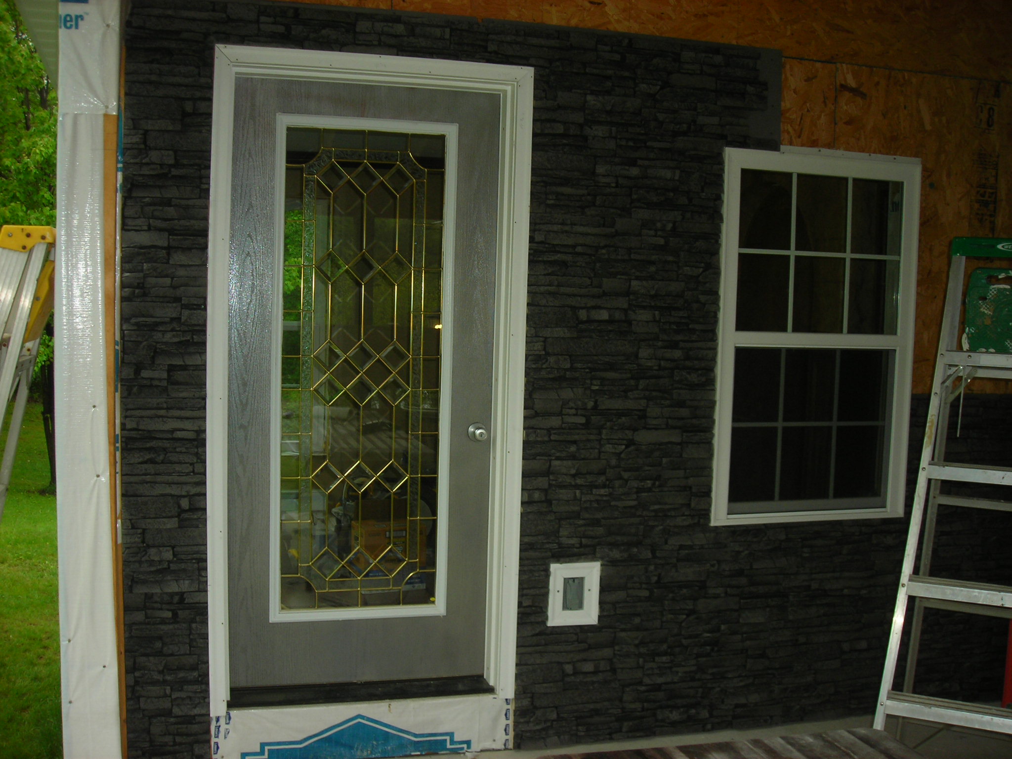

as far as the corners i made a sled for my table saw,so i can miter the corners,some of the stone matches up the loner stones have to be filed with a file,after both sides are up and glued and caulked together,so they look like each individual stone was hand layed,then a little gray caulk and add a little black caulk,then mix it together on the corners to match the rest of the stone.
a little time consuming but nowhere near as much as laying each stone separately,lol.

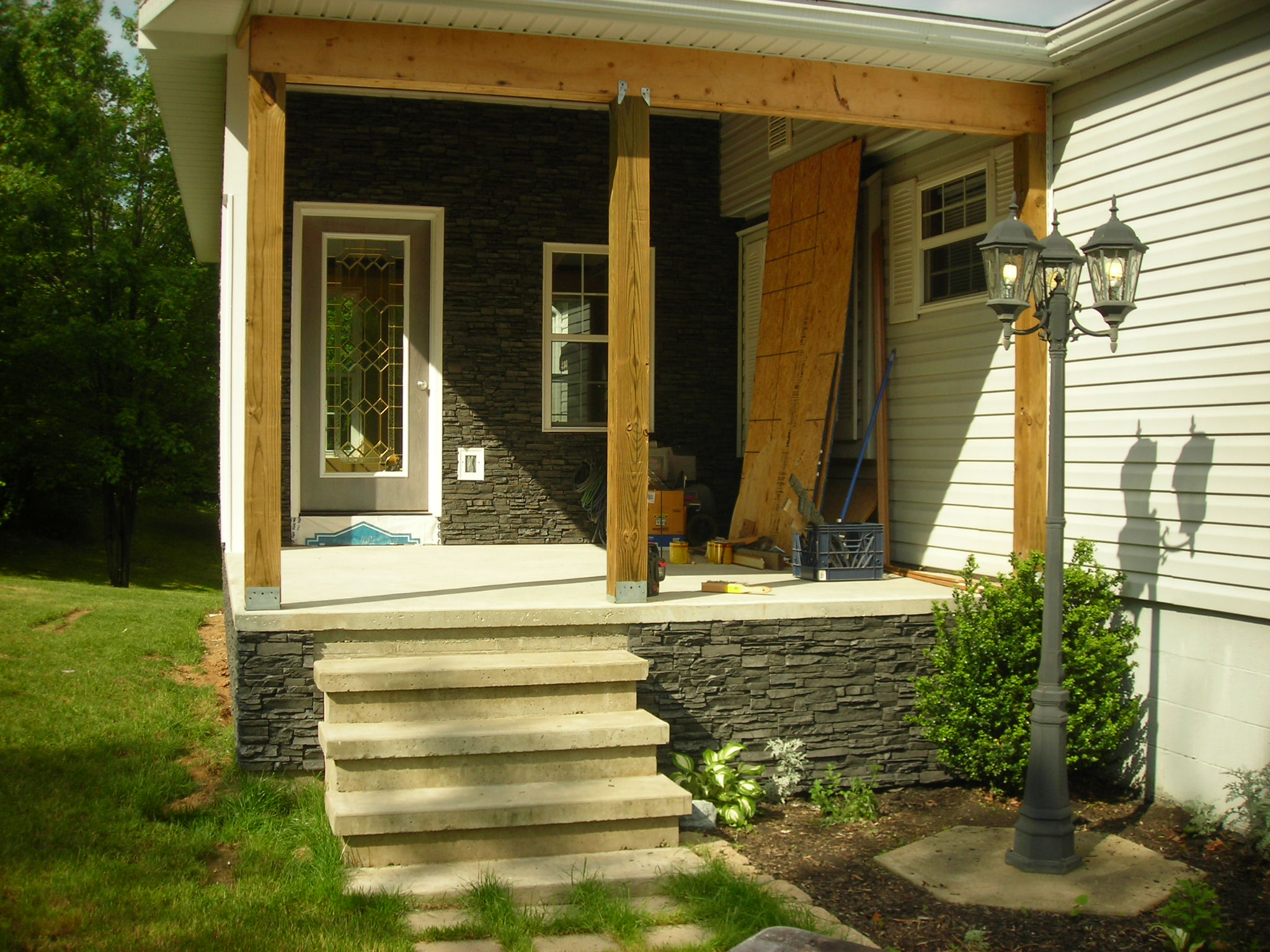

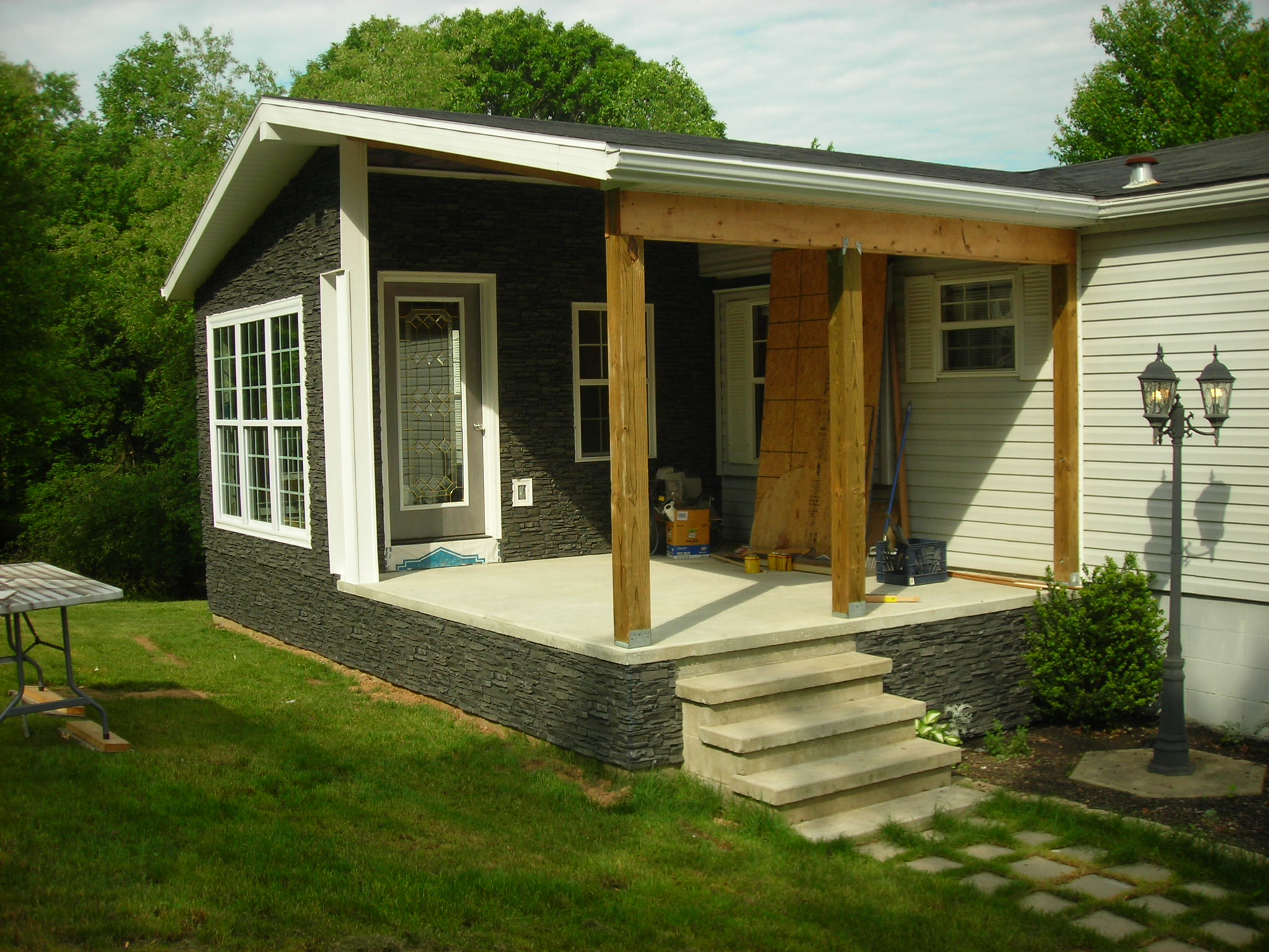

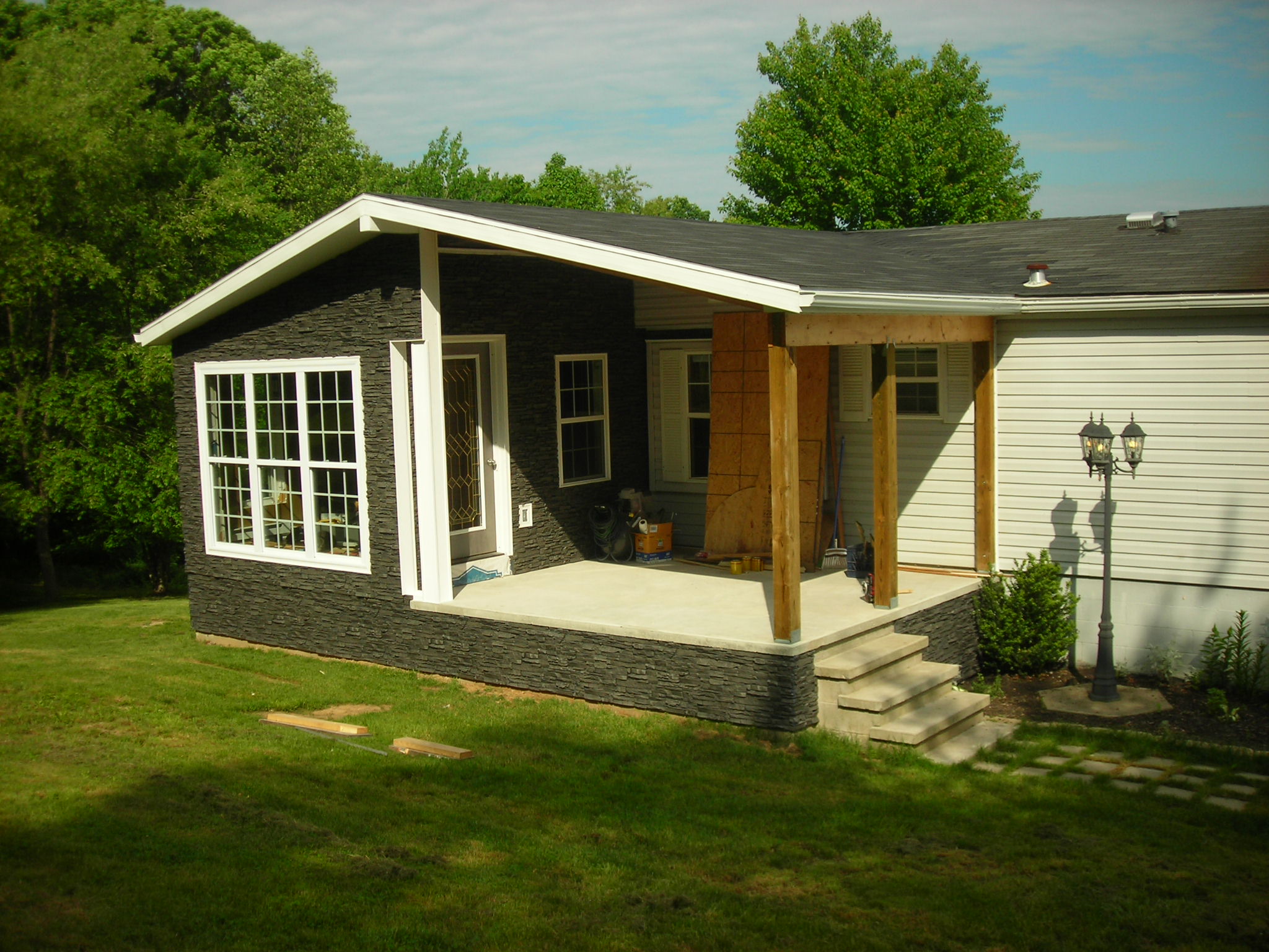

here are pics of wht we got done yesterday,it was and is raining so we worked on the porch wall,the post on the left and the bare wood there will be wrapped in white vinyl,and under the door i think im going to pour a half circle step.
and as far as land scapeing ,lorraine and i want a couple of dwarf Japanese red blood good maples.john sorry the pic is so dark,i hate this camera. ive got a row or two left on this side,i think i MAY have enough left to go around the concrete block ,at least on the porch addition,john

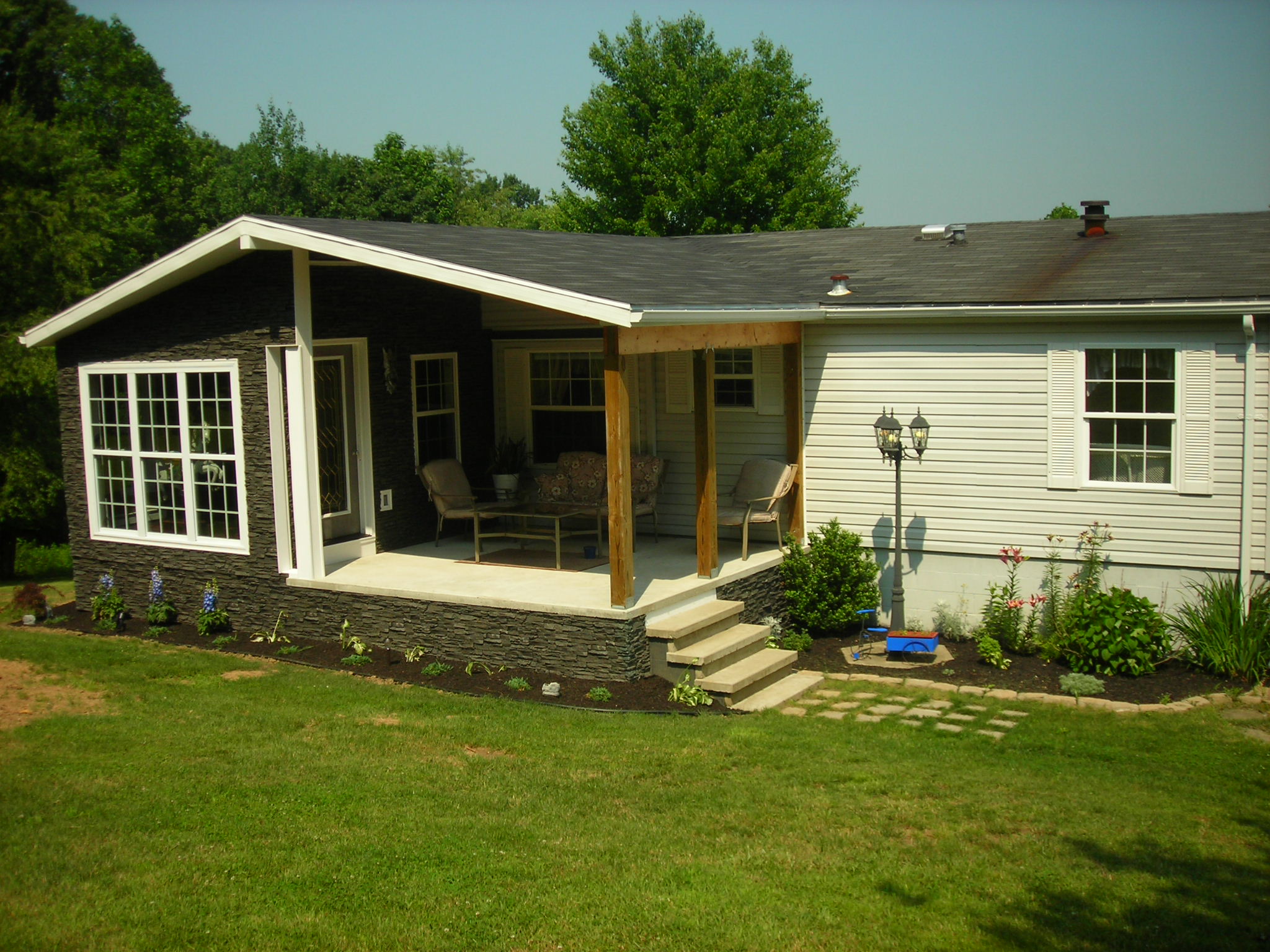

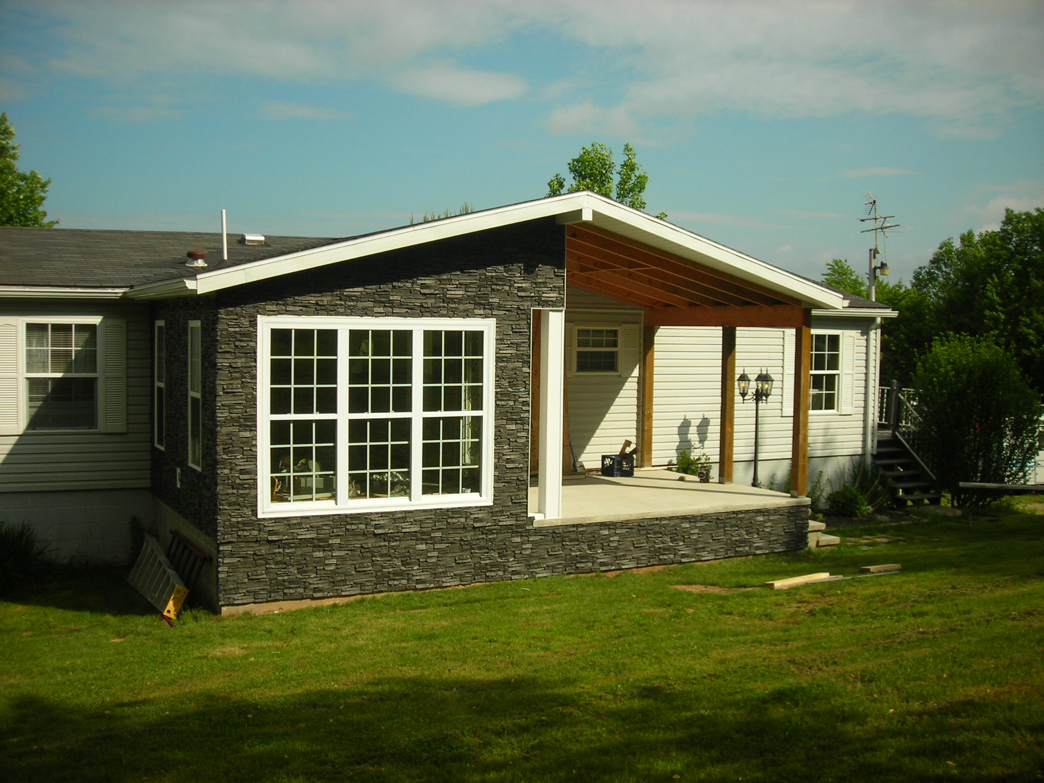

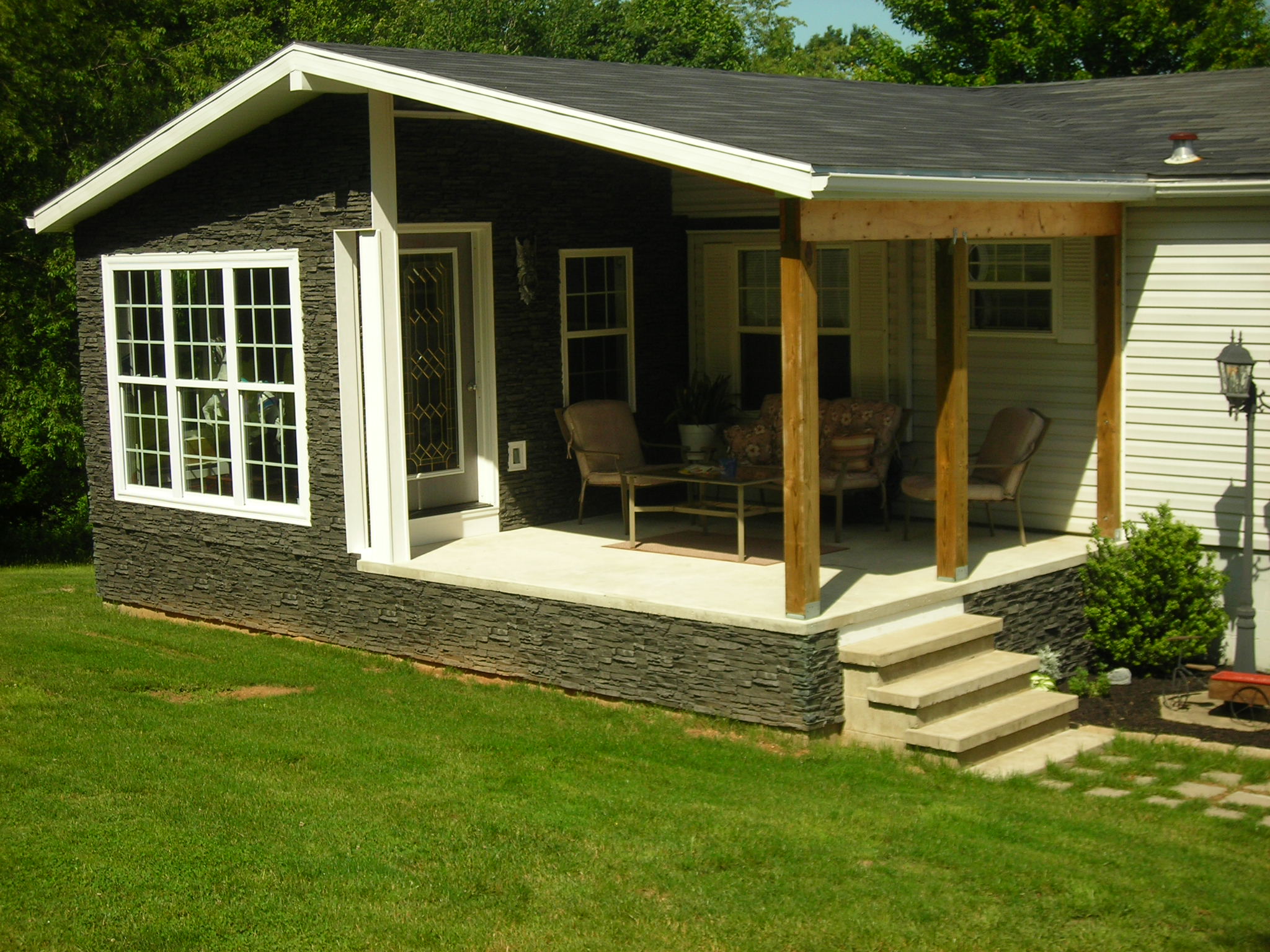

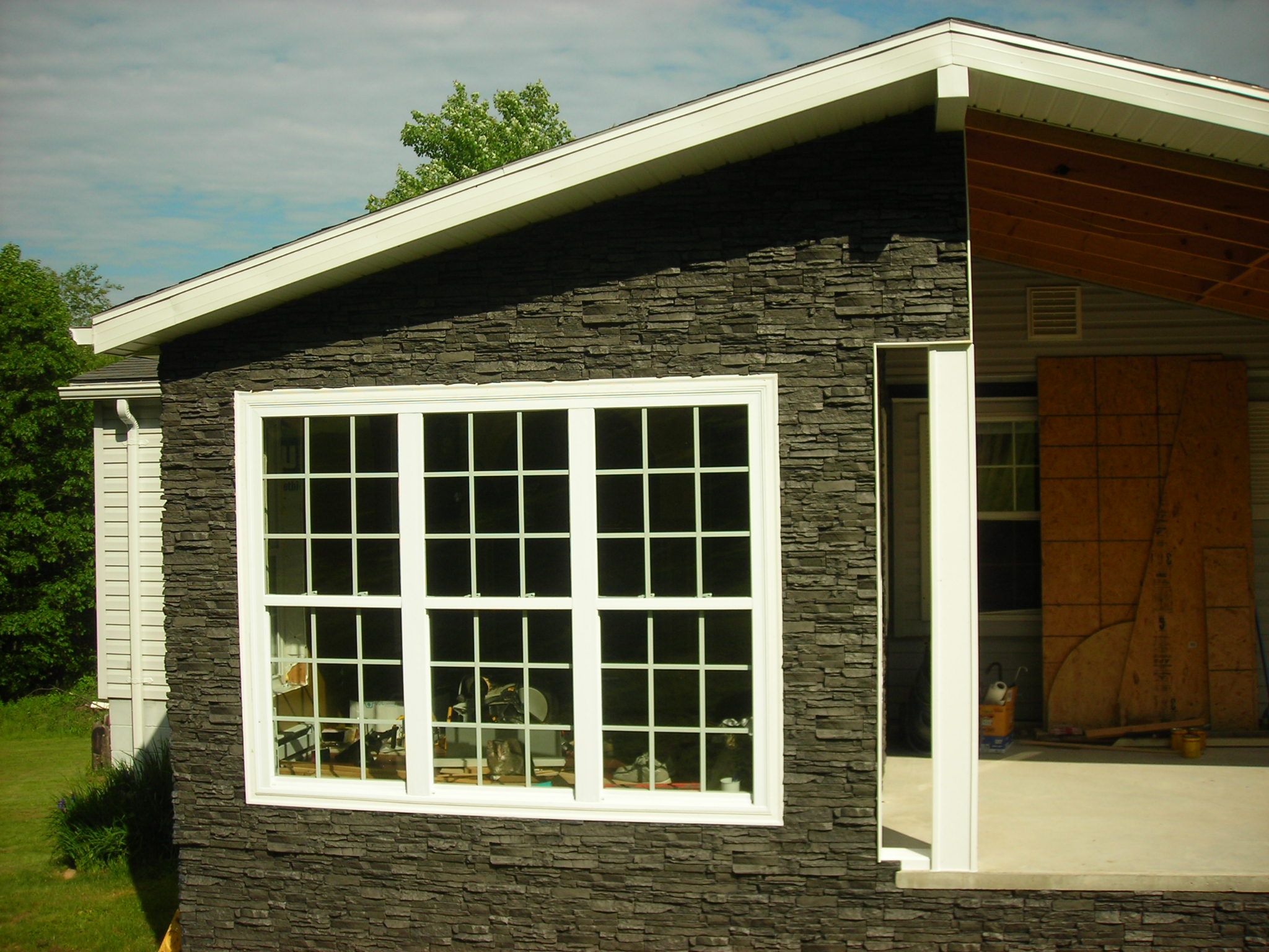

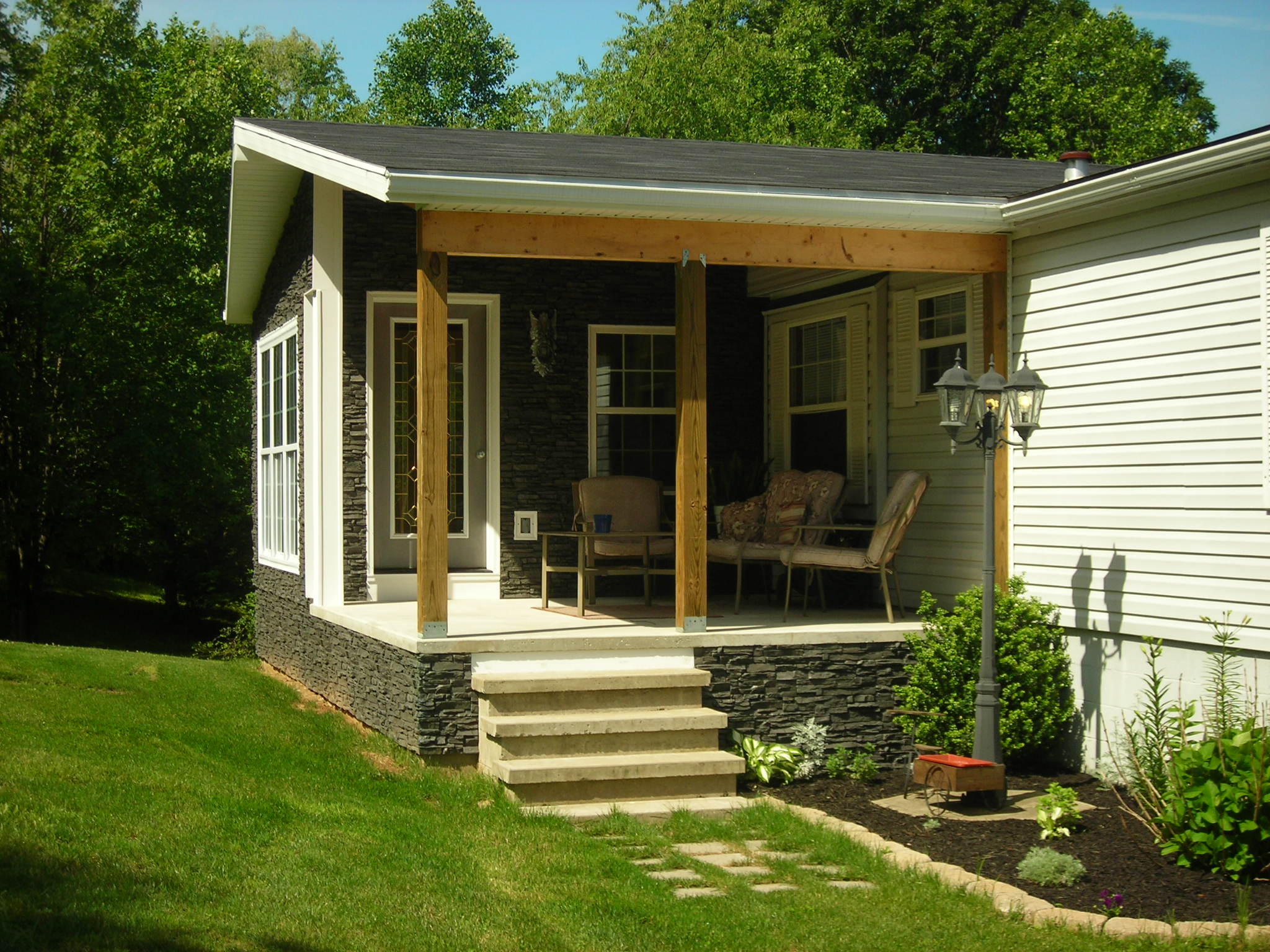

i got up all of the stone that i have,we were not planing on doing under the porch,but if we ordered a certain amount ,we got free shipping,so it was like getting the extra panels for free.
now im at a standstill because we are totally broke,lol.
in this 1st pic i still have a slab of concrete for a half circl step,that will look like stone.
and get the soffit finished,and wrap the post and beams in vinyl ,like the big one in the picture. you might have to click on the picture to enlarge it,its hard to see,lol.
please dont pay attention to the mess on the porch(osb,air compressor,etc.)i will paint the left side of the foundation to match the stone.
today i will finish blending the corners.
woo hoo,im in the homestretch,but still have a lot of touch up to do to it.john under the lip of the porch,above the top step,and between the stone ,there will be white vinyl,that matches the posts.
and if you see a seam under the big window its because thats where the wooden wall starts ,above the foundation,its 1/2 inch over as a drip edge.p.s. find the cat in the pictures,kinda like wheres wally,lol,john
john

all thats left on the outide is to paint the foundation walls and sides of the steps a darker grey,then soffit and railing when we save enough money,lol,it might be awhile,lol.
i also got the vinyl under the door and at the top step

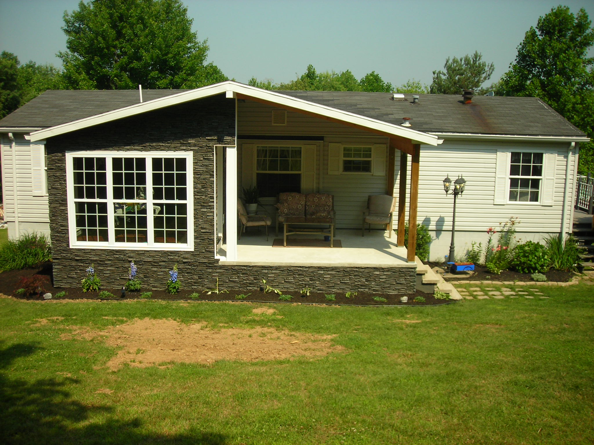

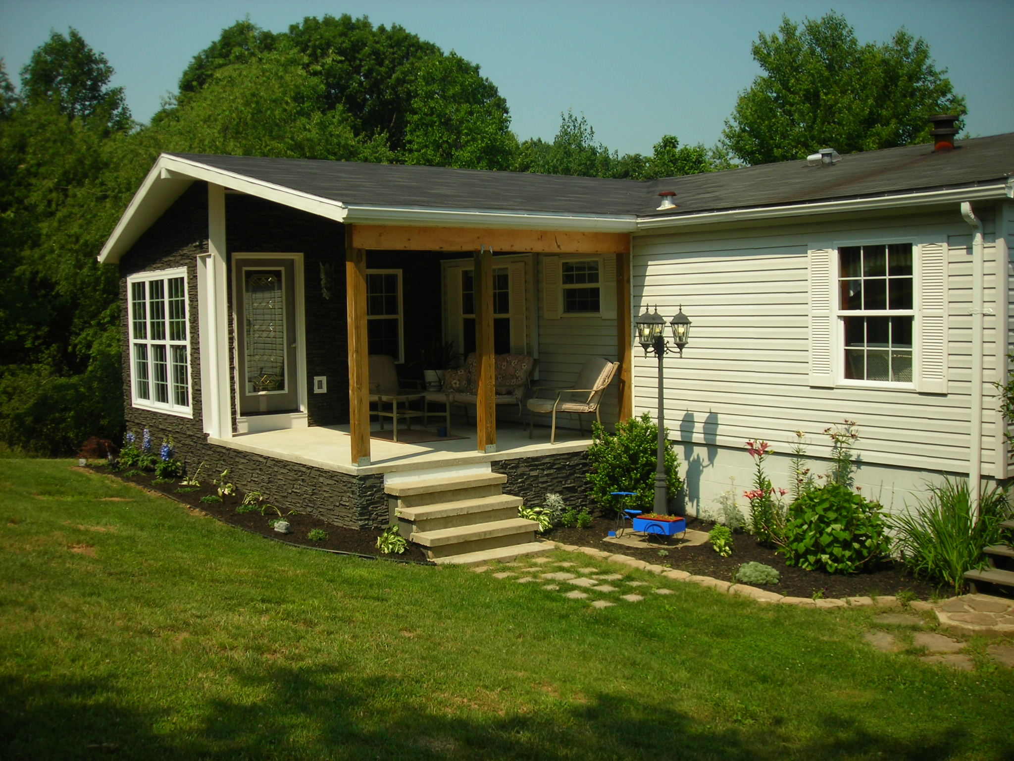

well,we got some landscaping done,we are having a birthday party here tomorrow for my mom,ed gordon and me,lol
in the last pic you might see the carousel horse i painted for lorraine,in the big window,john
