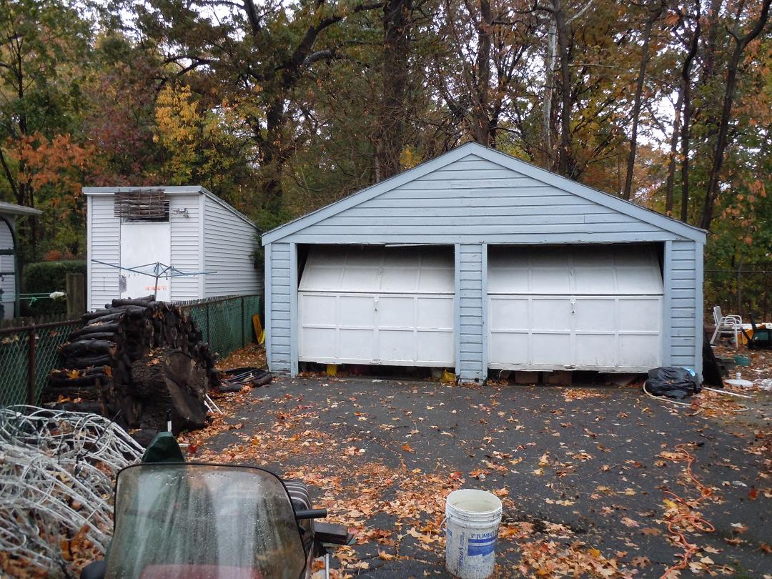

got a guy coming to demo the old 20x20 garage for $2,400, including the 40 yd. container. its rotting all around the bottom. i'm re-building to 20x30 with a 2nd floor if the town approves. got a great price from amish builders in pennsylvania. about 40% less than the lowest estimate i received localy. they're pouring a monolithic slab (first i heard of it)of 4000 lb. fiber reinforced concrete 6" thick. the perimeter will be 12"x12" with 1/2" rebar. no need to go down 3ft. to the frost line. it saves me a ton of money. local mason wanted 10k for the foundation alone. mono slab $4400. i applied for a line of credit in 2004. i have enough left to cover the cost of the project, and at 1.75% i'm nuts not to take it. if the town says no i'll scale it down to what they'll allow. ron

Sounds good Ron. I like the look of your current garage. Good luck with everything. I will keep an eye on this, Mike

The less it cost's to build the happier you should be. Dig a under ground room basement below the thing, that'll show them, lol....Mike
If its not too late perhaps your current garage can be salvaged?
