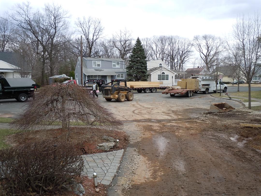

well we got 75% of it out today and covered with 2 tarps. will finish tomorrow. man my back is aching. wish i had a hot tub. ron

this is really starting to p--- me off. the plans have been on the zoning officers desk since monday morning. his secretary tells me he hasn't had time to review them. if it was 30 yrs. ago in this town i would say that he's waiting for a pay-off.

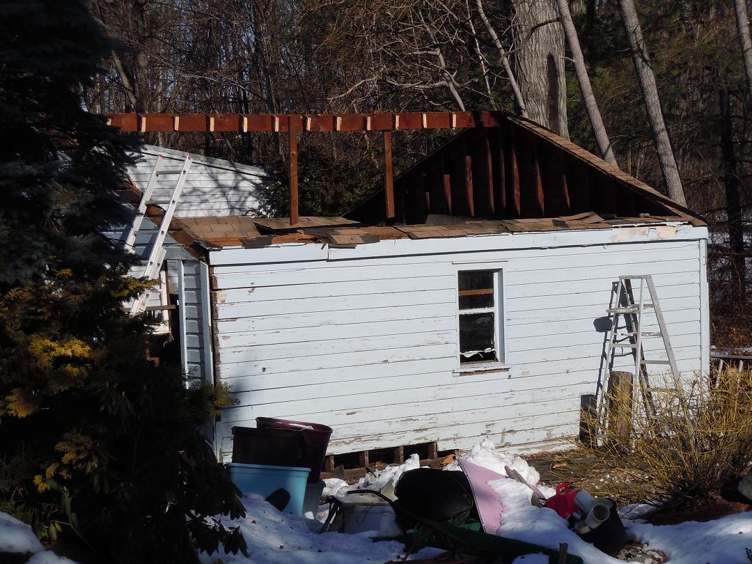

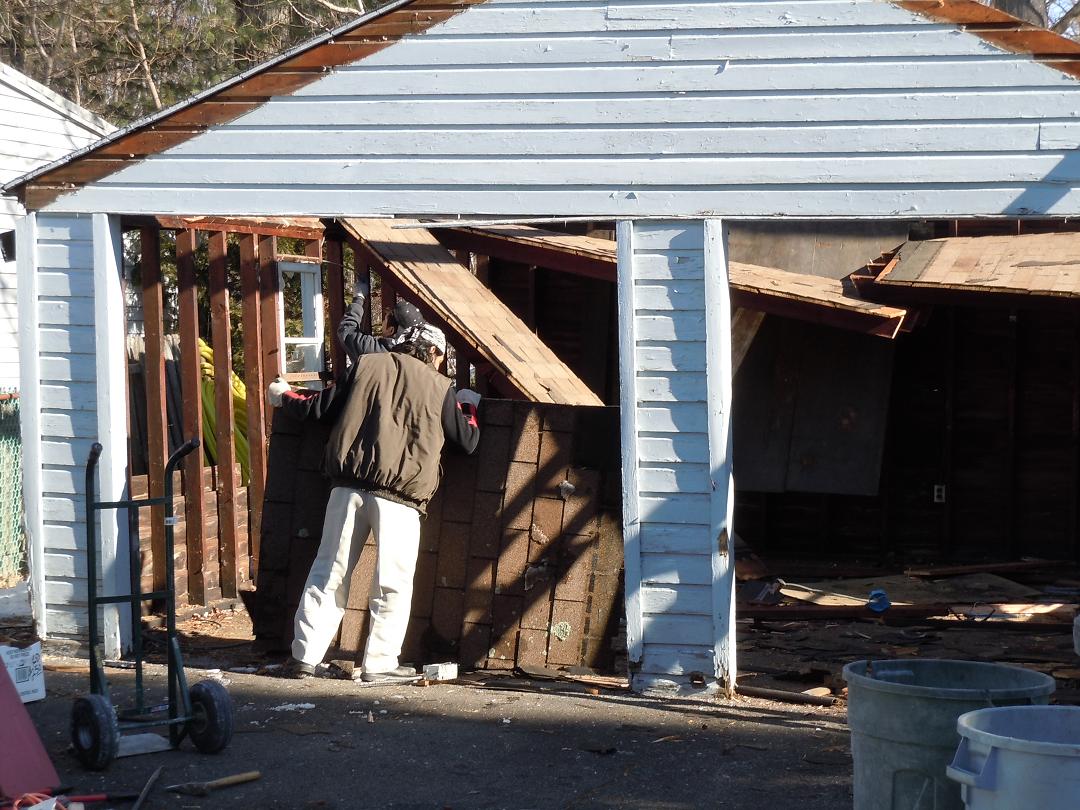

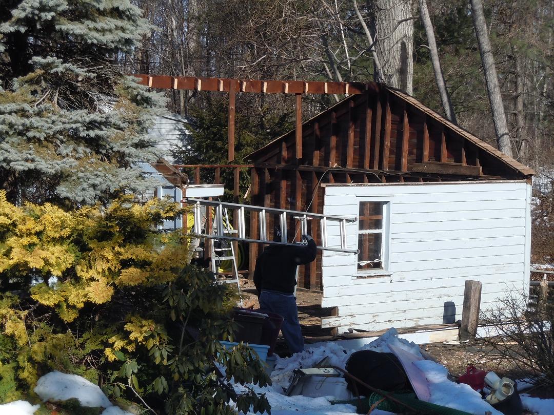

3 feet...i was thinking of doin the demo myself but a container will cost me $640. and a laborer to load it $100..$740.
i got a guy doin it for $900. for $160 bucks i'd be nuts to do it myself being i have never done a demo before.

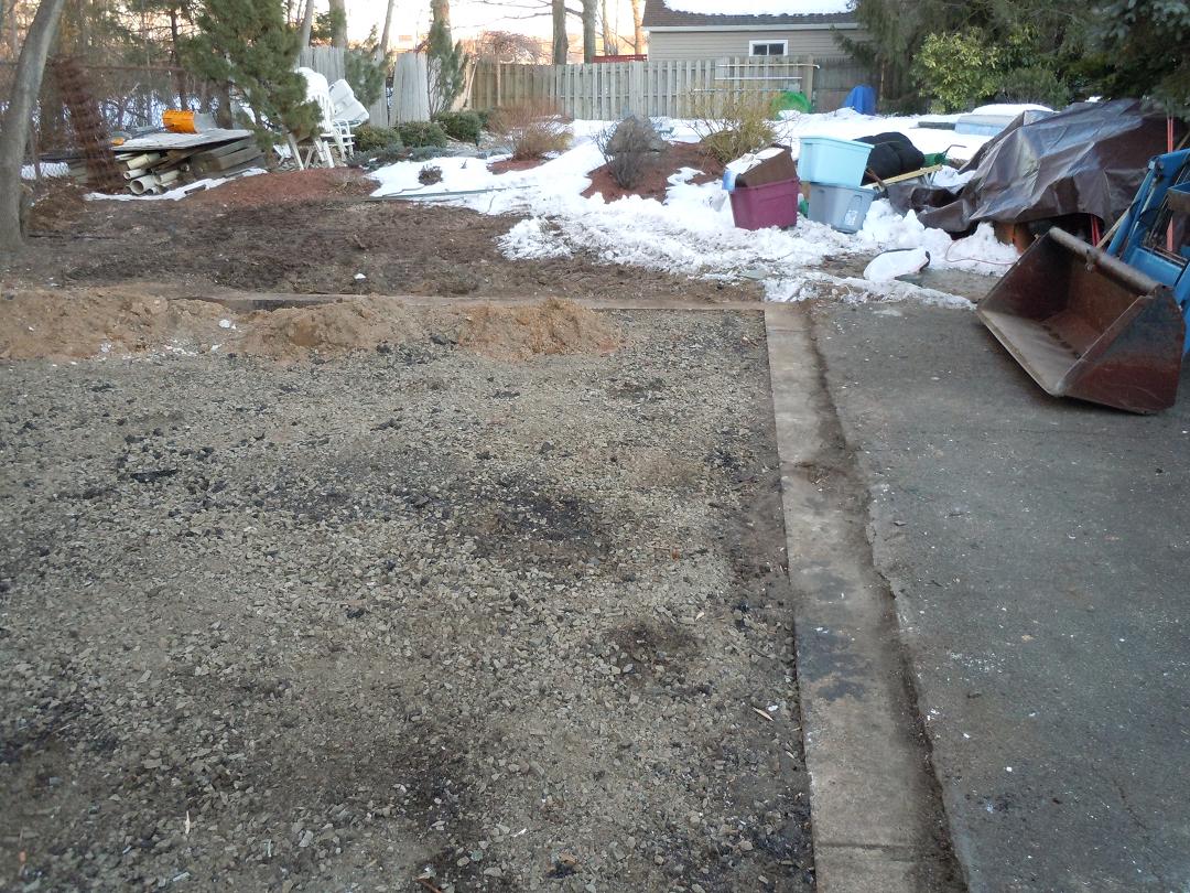

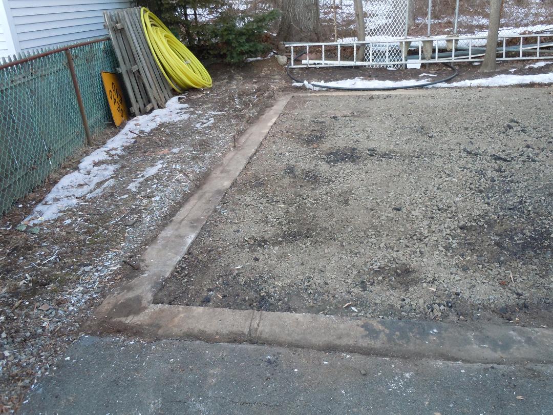

garage gone...finally 15 years 6 months ago #25219
  • vuyosevich
  • Posts: 2910
  • Karma: 76

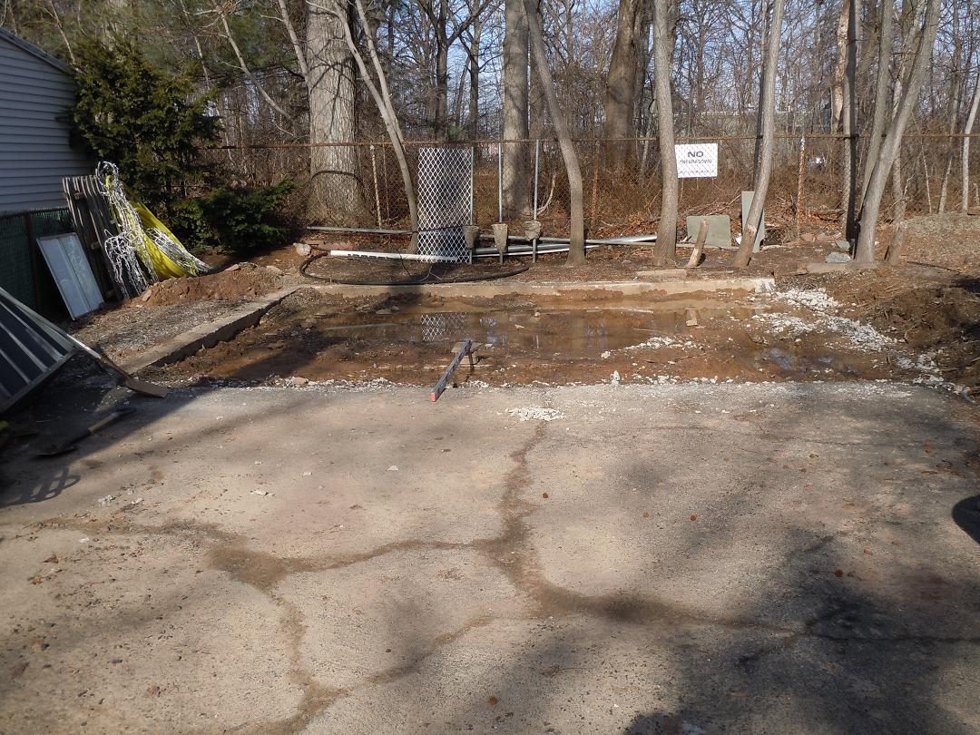

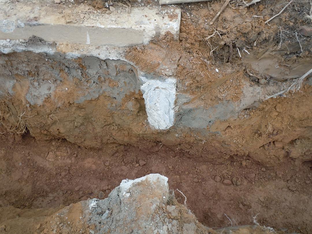

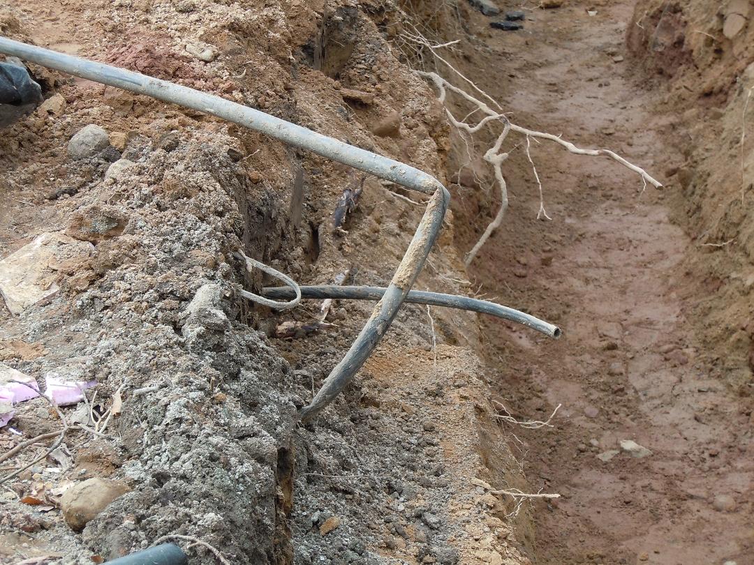

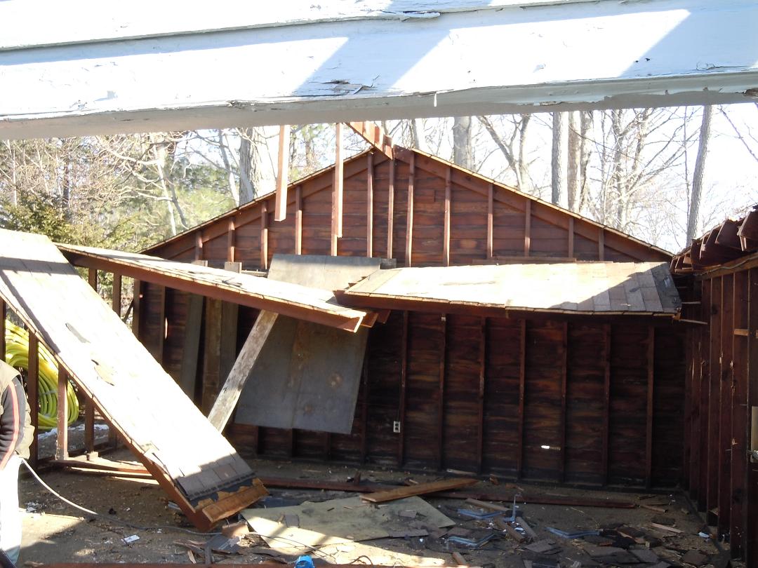

on to the foundation.found a surprise when we pried off the plate. :huh: supposedly it was anchored to asphalt..no such luck. we found a 12" wide x 3 ft. deep poured concrete foundation. :ohmy: after i spent an hour wondering how i was gunna get that out it dawned on me that i could build on top of it (20x20) and just do the extended 10' with a new pour. :) i called the town if they would allow me to do that. no way jose! :angry: but he told me i could leave it and just pour the new foundation alongside it. i would just have to shift the garage over 1' and either forward or back 1', this way the anchor bolts could be installed in the pour. no problem i have plenty of room. pics of the demo and how clean they left it.

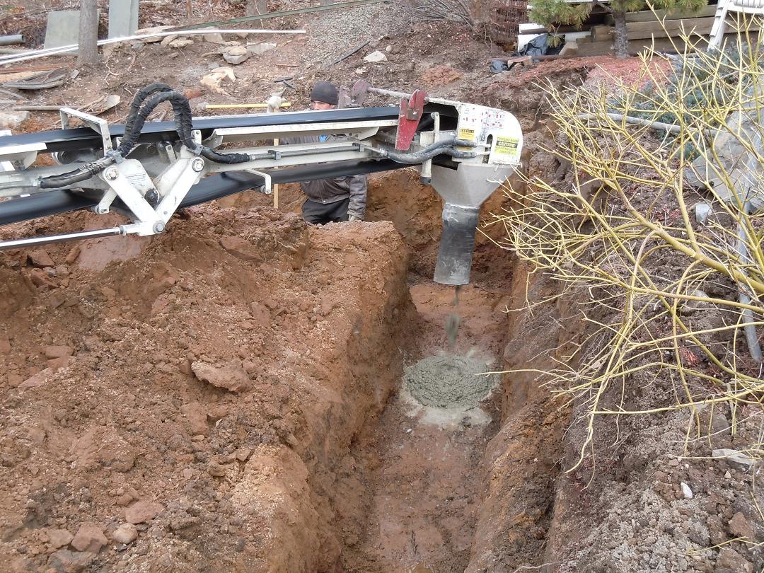

Finally Underway........ 15 years 5 months ago #27344
  • vuyosevich
  • Posts: 2910
  • Karma: 76

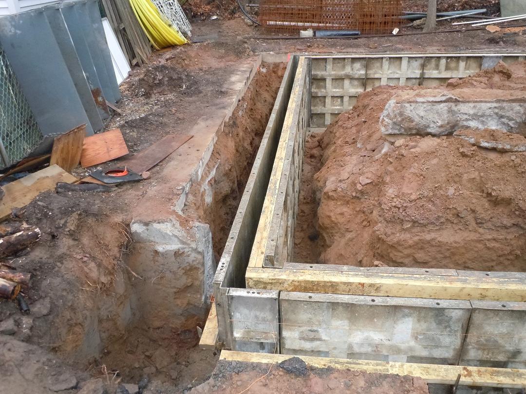

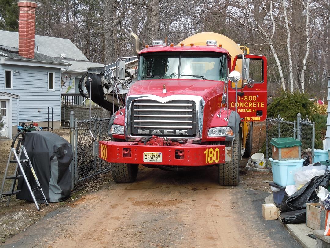

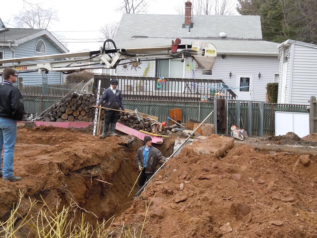

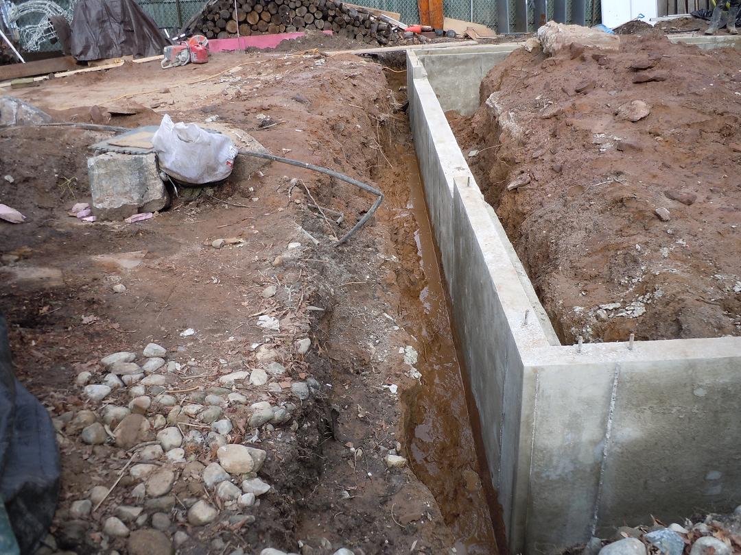

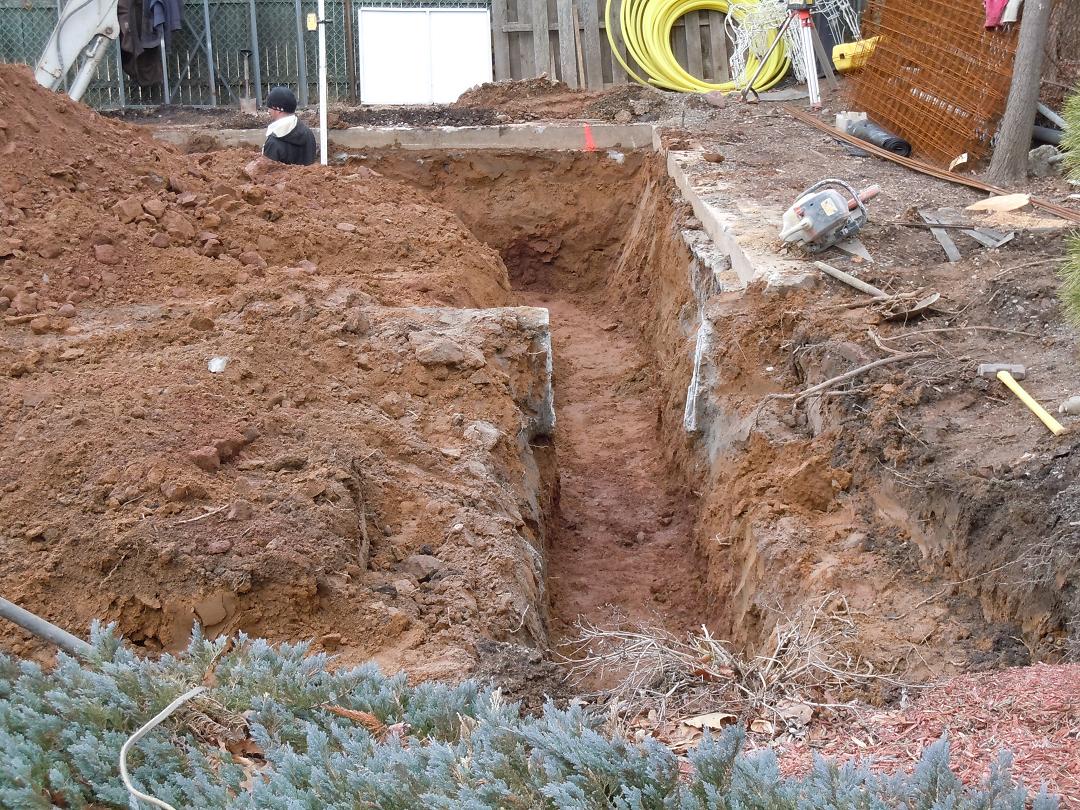

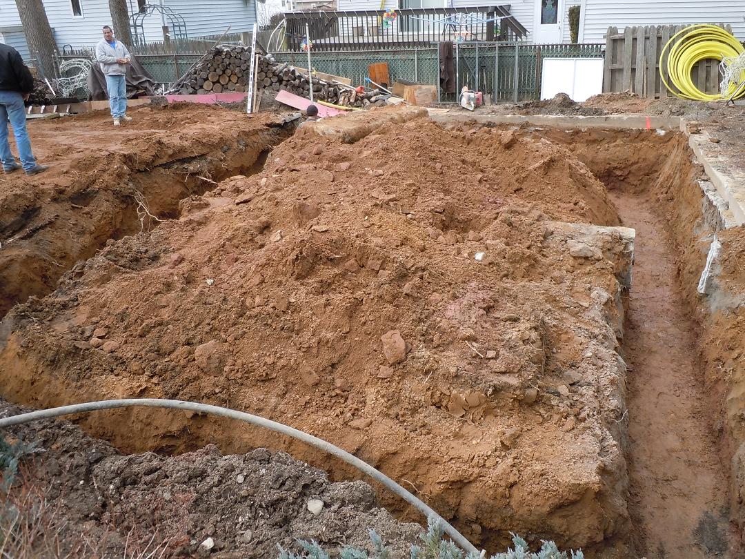

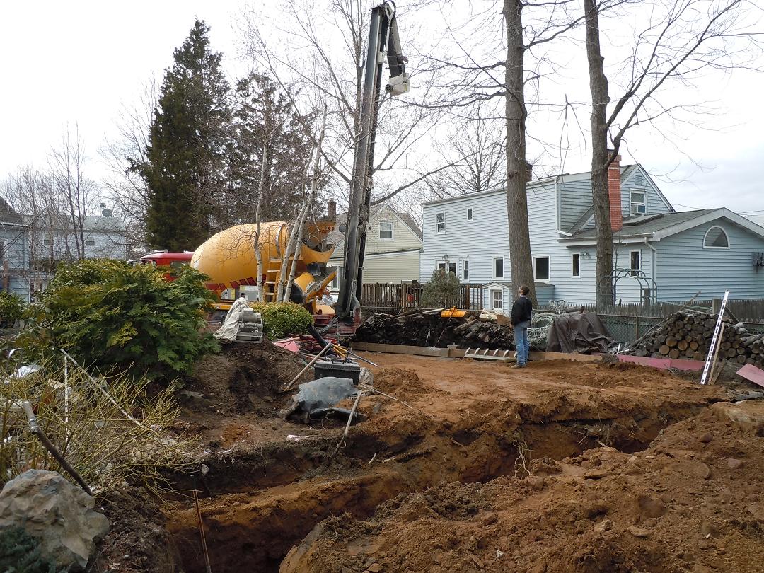

excavation,footer,concrete walls. the rain came the night the walls were poured. 5" of water in trench this morning. sue and broinlaw pumped it out while i was at dys. real troopers..it wasn't easy as every step they would take they would sink in 6" of mud. they're pouring the floor on monday. ron more pics tomorrow......

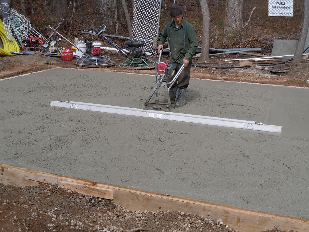

Re:garage demo about a week away.... 15 years 5 months ago #27541
  • vuyosevich
  • Posts: 2910
  • Karma: 76

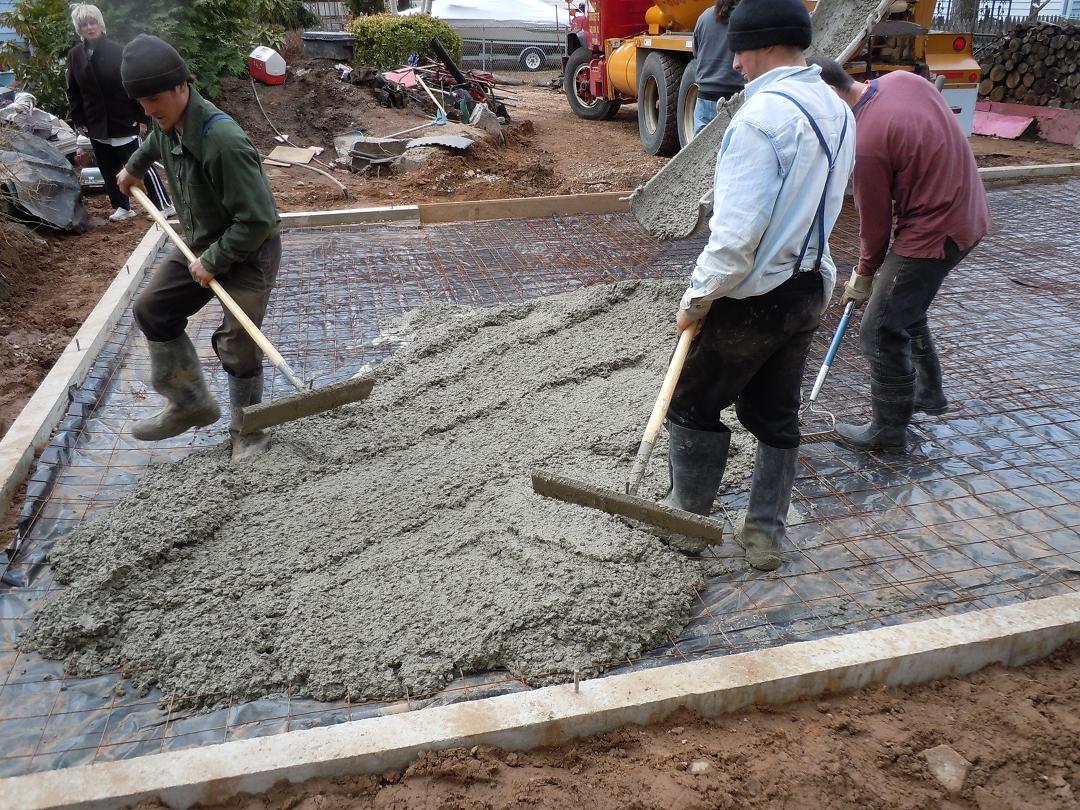

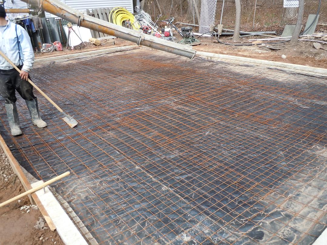

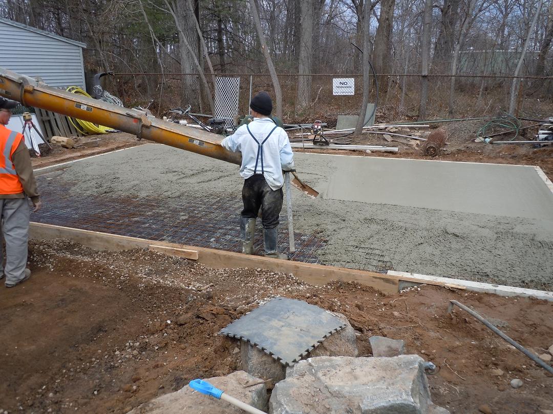

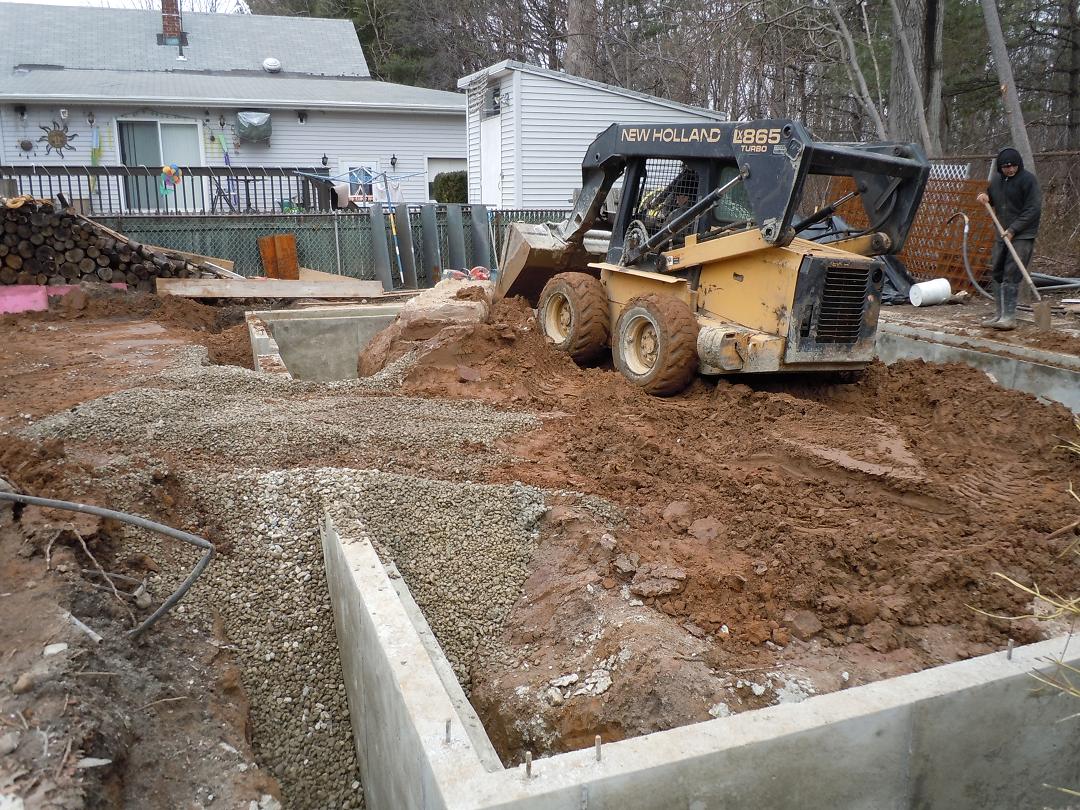

foundation and 7" floor in...
first wall up
Re:garage demo about a week away.... 15 years 5 months ago #27543

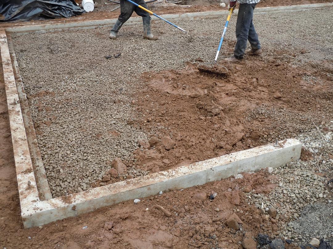

Looks good Ron, but I have a couple questions.
Does the floor float? Or is it tied somehow to the foundation?
For the floor, they just leveled out the dirt, then added how many inches of gravel?
You say the floor is 7" deep? And does it come flush to the top of the foundation?
Is that some kind of black plastic on top of the gravel under the wire mesh?
Frank
Re:garage demo about a week away.... 15 years 5 months ago #27548
  • vuyosevich
  • Posts: 2910
  • Karma: 76

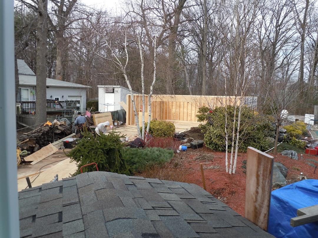

frank, it was explained to me as a "keyway". the floor rests on the inside half of the foundation.
it called for compacted dirt, then 4" of gravel, 1 layer of wire, and 6" of fiber reinforced concrete. they ran short on gravel by 1" so i got a 7" floor that comes flush with the top of the foundation,and they had extra wire so i got 2 layers of wire. the inside walls were backfilled with gravel. the black plastic is a vapor barrier.
you can see the keyway in pic 4.

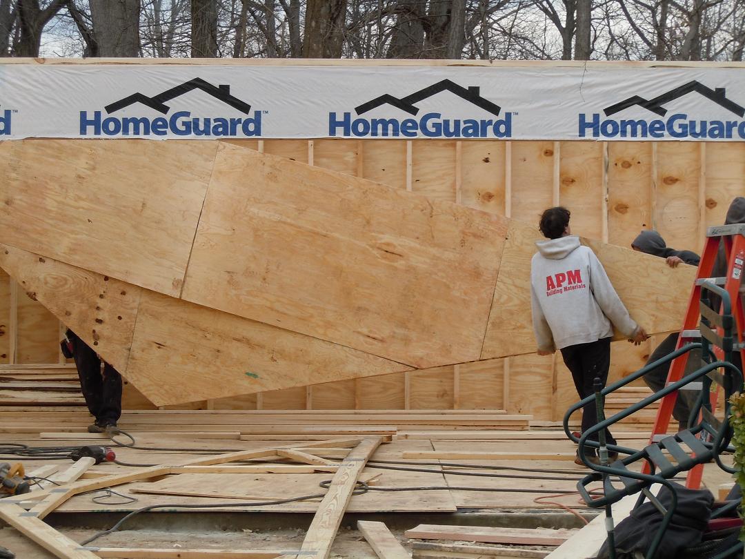

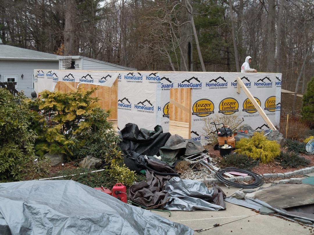

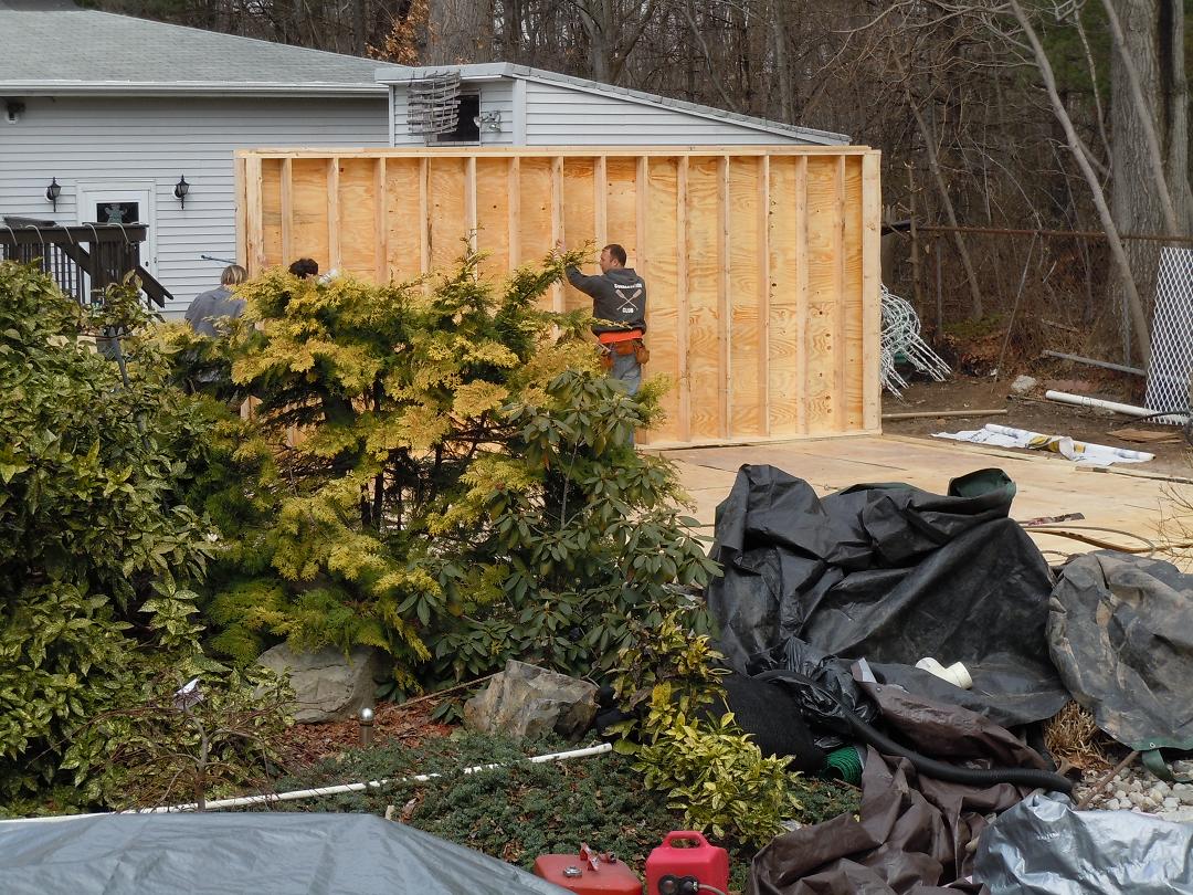

frank, they did make 1 mistake imo. they nailed the plyscore walls up vertically. i made them remove it and nail it horizontally with overlapping seams as you would lay brick. its much stronger that way. they say they only do floors and roofs like that but didn't give me any hassle at all to redo the first wall.the name of this company is pine creek construction and they have crews all up and down the east coast. ron

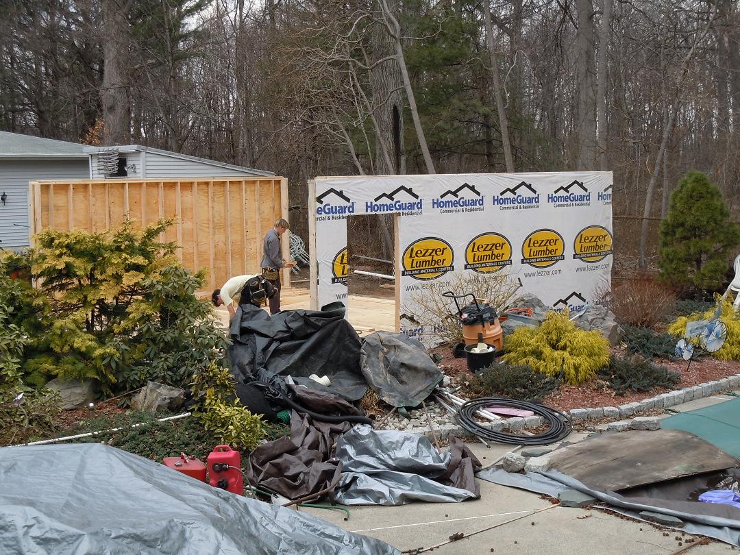

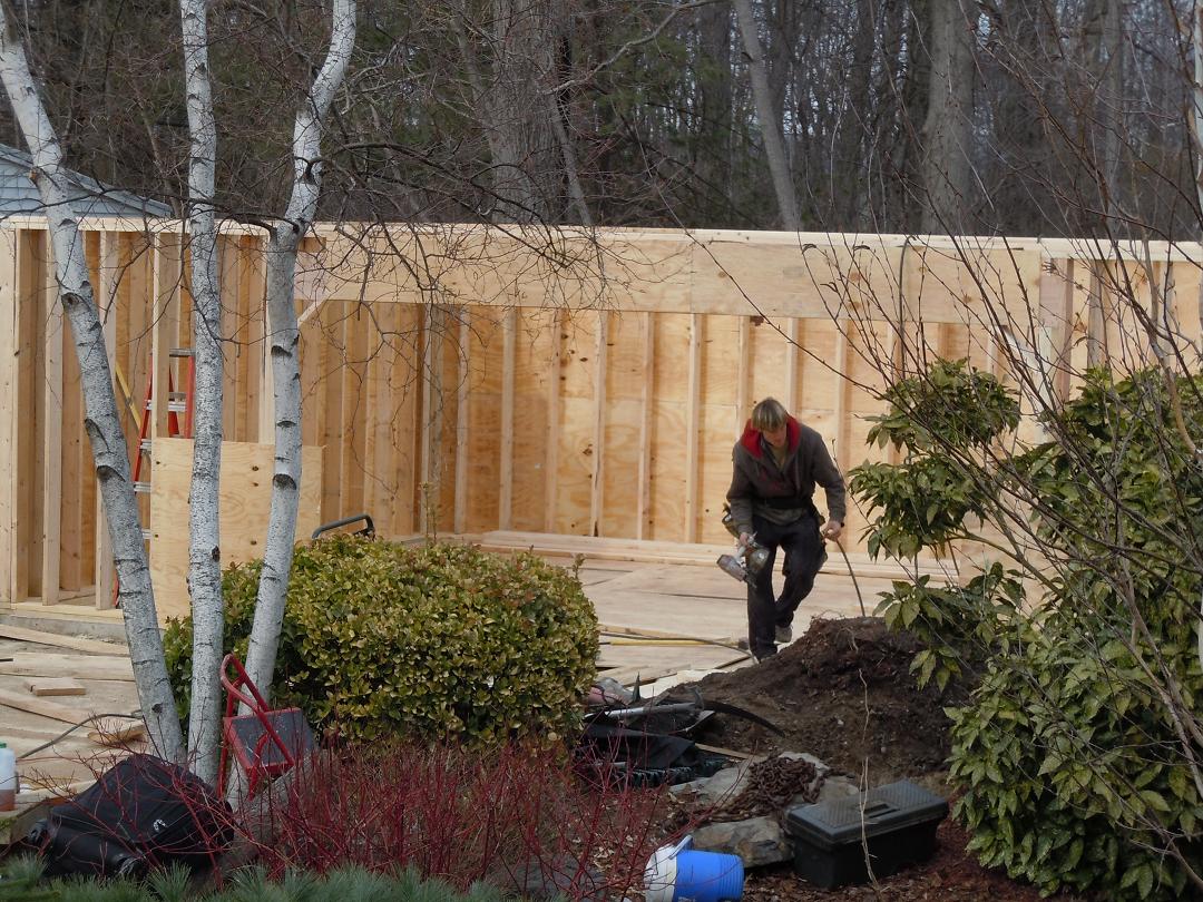

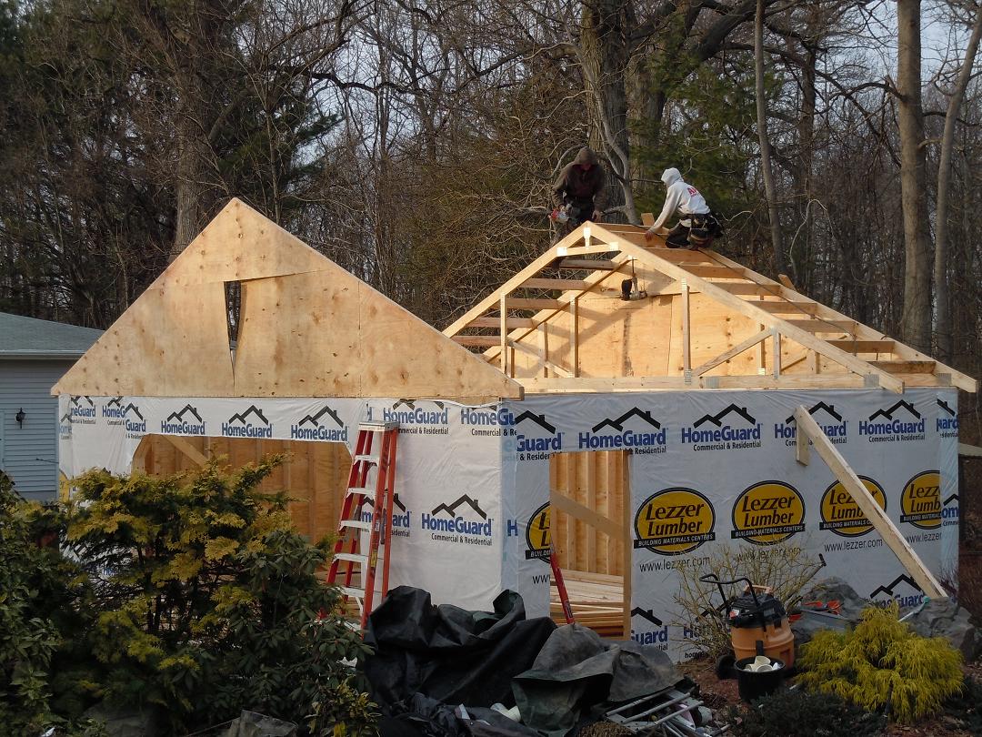

john, the inspector said i have a good crew. i tell ya these amish guys are the best i've ever encountered, and i've worked alongside a lot of builders while landscaping new homes, and so polite. what really stuns me is i haven't heard anyone swear yet. ru kiddin me!
postin more progress pics (9)

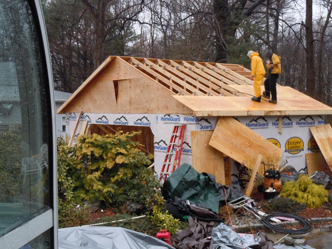

Re:garage demo about a week away.... 15 years 5 months ago #27626
  • vuyosevich
  • Posts: 2910
  • Karma: 76
more progress...... ... ... ... ... ... ... ...
Re:garage demo about a week away.... 15 years 5 months ago #27629
looking good buddy,im guessing there is a window in front above the garage door?,and that they left out a roof truss at the rear of the garage so that you have a 4 foot wide access to the upper floor?
and are they putting ladders in the eves?,so you can put soffit up and for extra strength,ill bet they will because they seem very good,and take pride in their work,looking great ron,im jelous i wish my shop was bigger,lol.john

  • vuyosevich
  • Posts: 2910
  • Karma: 76
john, theres a 3' wide staircase going up in the rear right corner. yes a window is going in above the garage door.
ladders in eave? don't know what they are. lol

Re:garage demo about a week away.... 15 years 5 months ago #27635
ron a ladder is a way to stiffen up your eves on the front and rear gables of your roof,
you see the 2x6 that they have up on the front left side of the garage?what they probably will do is add another 2x6 to the side of the garage with 2x6 pieces every 16 inches,hang on ill see if i can draw it,its hard to explain,but it looks like a ladder under your front and rear eves,other wise all that holds your eves is the plywood.and you have no where to nail up your soffit.
Re:garage demo about a week away.... 15 years 5 months ago #27636
ron here is a website that they are talking about eave ladders,its a little more complicated then it hhas to be,but basicly they are saying that without the ladder,and just having plywood hanging out a foot without it,it will sag ,especially with snowload and time,im still ooking for pics of it,lol,john forums.jlconline.com/forums/archive/index.php/t-7560.html
