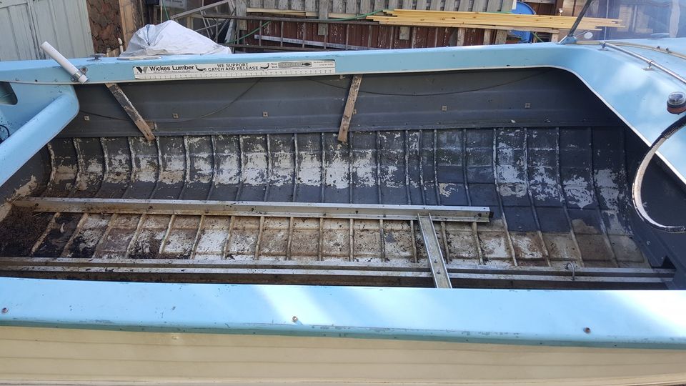

Ok, something doesn't look right with this boat. The aluminum structure in one of the pictures. All of the pictures I've been finding here are glass stringers, looks like someone has been molesting this hull. May just have to make a hard pass and consider this one junk.
'63 MFG, what model? 6 years 2 months ago #143327
I'm thinking the aluminum frames are original. I have a shorter MFG 1960 ? that have similar frames I paid 100 bucks for mine without a motor. www.fiberglassics.com/forum/mfg-owners-group/132049-1959-mfg.html

The boat shown on Facebook Marketplace is a 1961 Edinboro. Without the interior, it's hard to tell for sure, but that style windshield was used in 1961. I have a 1962 Edinboro and that was the first year for the fiberglass stringers and floor, along with the Sun 'N Fun seats.
The boat for sale will need a ton of interior work, including remounting the aluminum stringers, new floor, seats, plus whatever is wrong with the hull and deck. With motor, $350 is fair. Edinboros are 16' 6" long, via centerline.

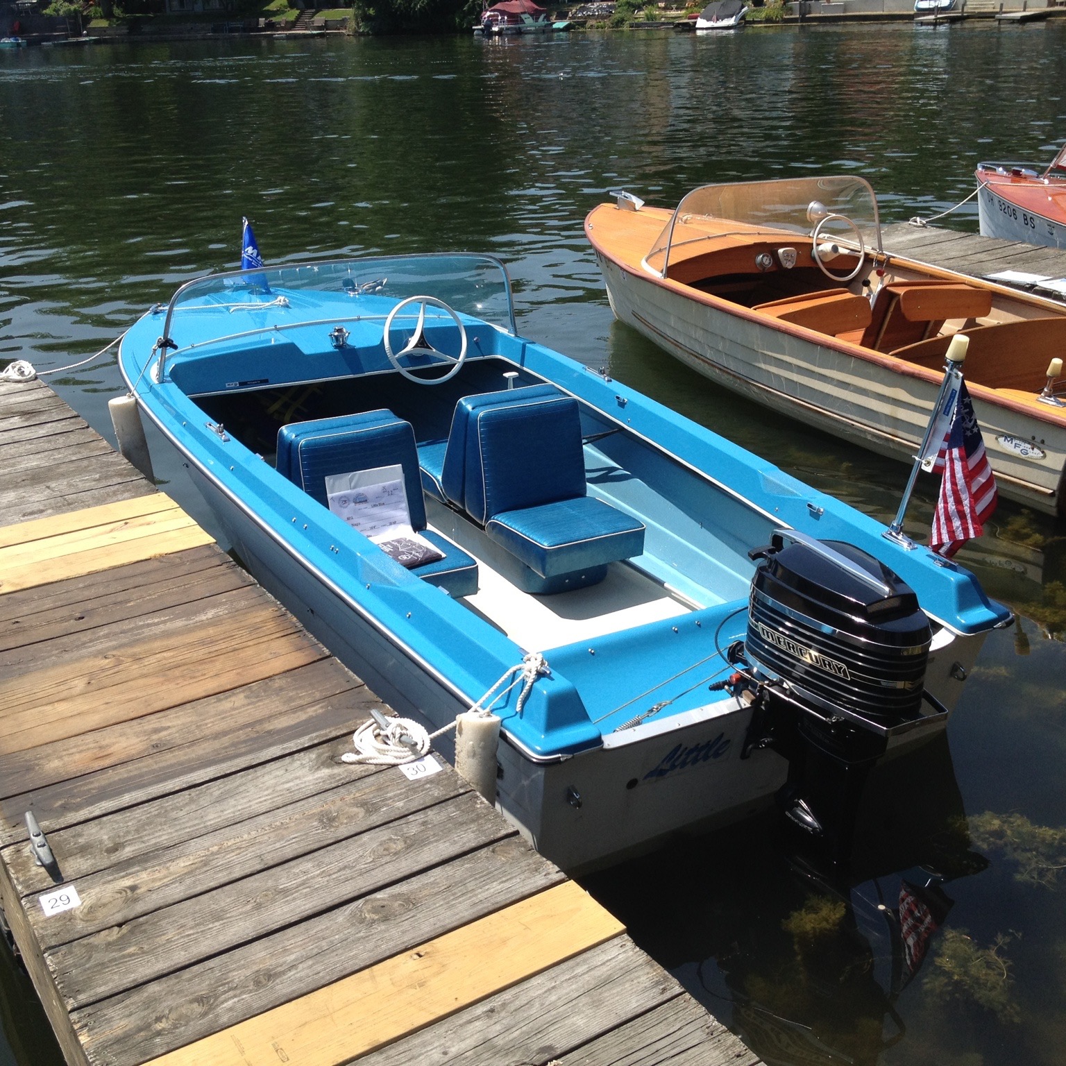

My 1962 Edinboro picture is attached - Big Red. That boat was completely restored, except it does have most of the original seats. Unless you do it all yourself, restorations can be quite expensive.
Also have a 1966 Niagara. Got lucky and that one is original and unrestored - Little Blue. A Niagara is 14' 4" centerline.
