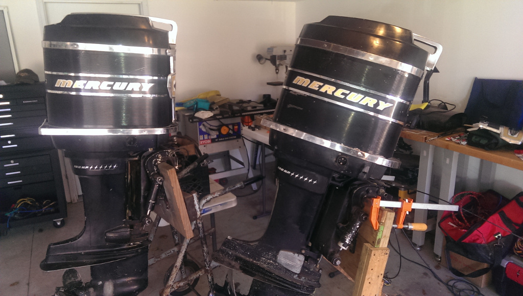

I met Jim this weekend and acquired 2 1965 Merc 1000's with a BUNCH of extra parts.
Beautiful time for a drive through New York and Connecticut.
Looks like i have the foundation for a dual motor setup. Both motors, two sets of power tilt and trim, two controllers with keys, and a bunch of hoses and cables.
Granted they need work, but i think it's a great start.

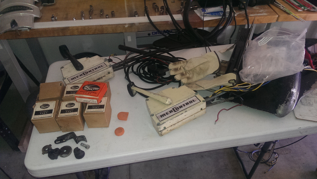

and more...

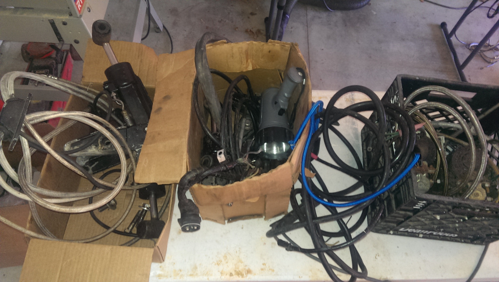

... and more!

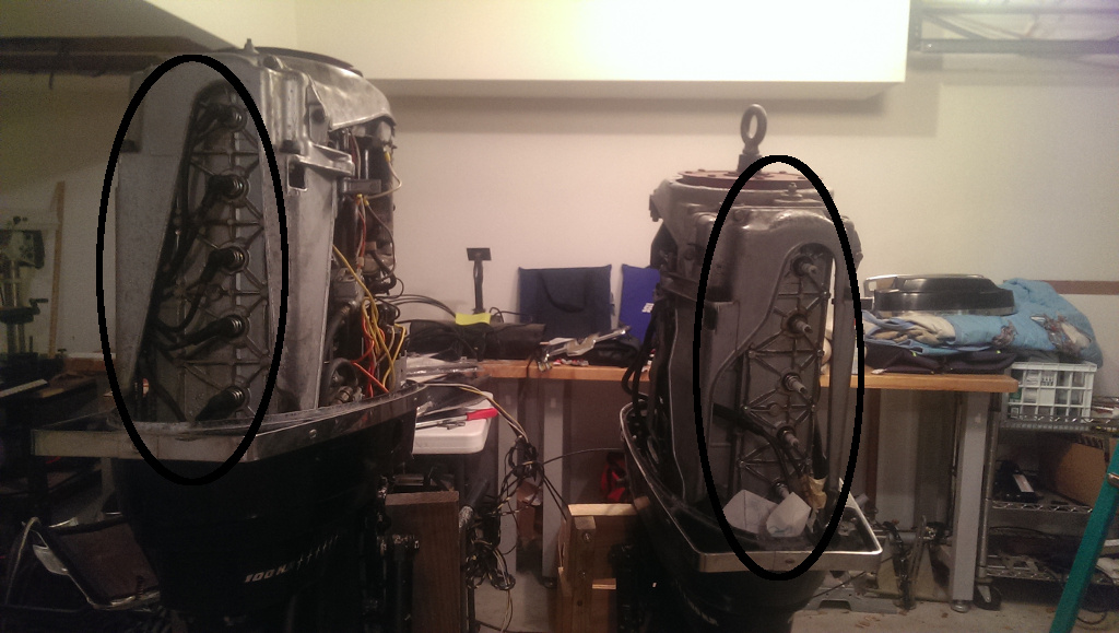

Question: why are these two '65 motors different? notice the angle of the frame to the left of the plugs.

On the Ohio motor I changed on of the back cowl supports because the original had a crack in it.

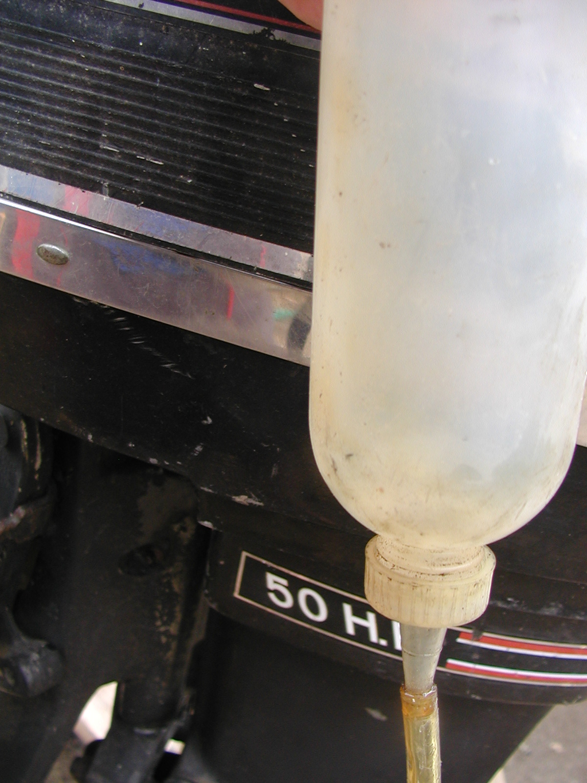

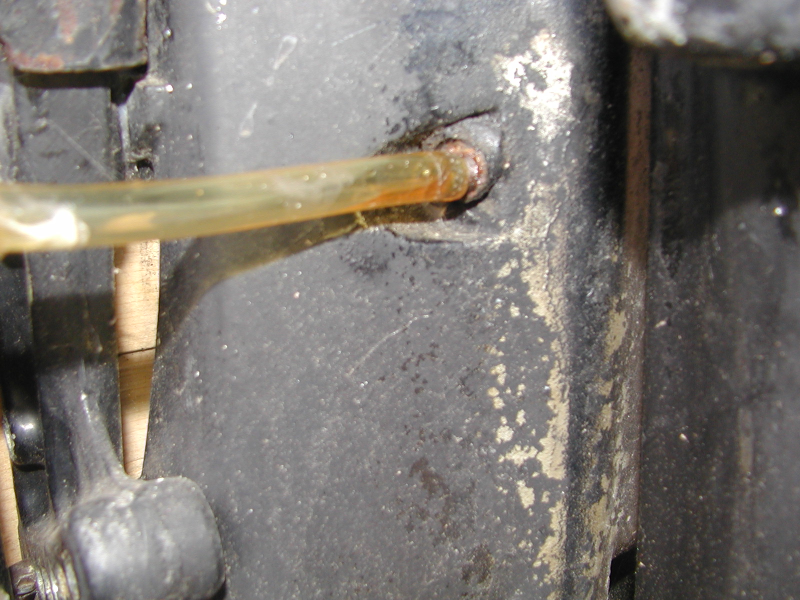

what i have done in the past is set up an IV drip with PB blaster, i take a grease fitting and drill it out to remove the ball and spring and then attach a plastic hose to that using a clamp or zip tie, then at the other end of the hose i attach a squeeze bottle, i then feed the pb blaster down the tube and try to squeeze some through the grease fitting. If it doesn't work right away pour some blaster into the bottle, tip it upside down and leave and it should gravity feed through. Just be careful if you use your torch, PB blaster is flammable.

I started the patient on an IV drip of 100ml of SF Deep Creep!
Only time will tell...

So i spent an hour heating and tapping. Attached a cheater bar, think it was a piece of steel conduit, to the steering attachment and pushed the bar so hard it split.
So i continued to heat it and tap it and attached the clamp you see in the picture. I've tightened it so hard that i needed to use the vise grips to continue to tighten it.
I may be making progress. I think it moved 1/16 of an inch... Also heard some popping coming from the steering shaft. Lots of grease leaking out the bottom bushing.

I like the idea of the clamp to keep presure on the steering arm as you are heating an tapping. As soon as she 'blinks', you'll make fast progress.
Does the other one swivel or is she locked as well.

D. L . : LOnger Leverage .?? If your last pic on the lifting ring chain is your set up (?) I would suggest longer leverage with 2x6 , & 2x4 lumber. . Get a 2x6 thru the transom clamps, & a longer 2 x 4 across the BACK of the pan housing,even sandwich two 2x4 will give the length of the motor leverage... Your wood clamp is very close to the arc bar.... If there is a TENSION bolt on the housing make sure it is loose or remove, add Marvel oil ,or liquid wrench there.
2) We have seen guys with total stuck steering ROD BArs going thru the front of the tube, That get dried grease over time & just like
being submerged in salt water..

Peter,
The other is moving fine. I greased that one and the one on my boat to make sure they stay that way.
