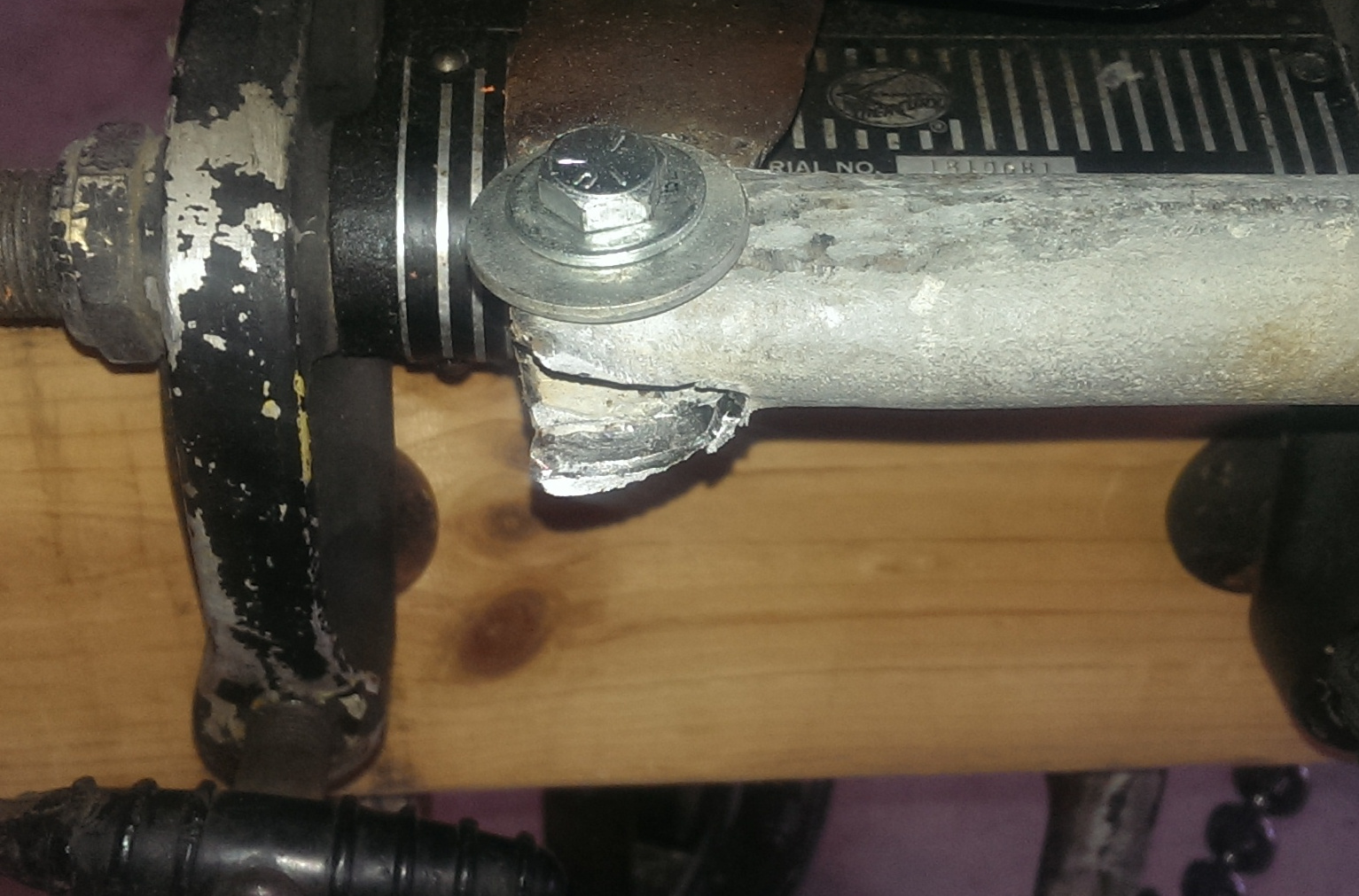

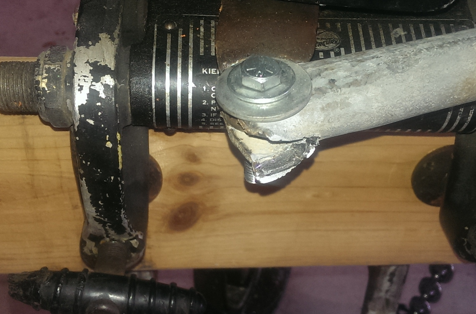

I hung it there so i could get heat to the pivot easily. It normally lives on a stand.
Not sure where you mean to put the 2x4...
Where is the tension bolt?
Thanks for the input!
Dan

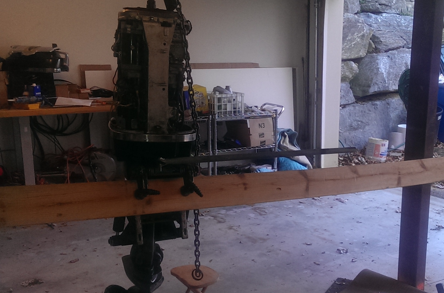

Great pics! Did you have them posted before?
I've been applying heat to it today, and added a bar. Which split in half. I need to go get a cast iron pipe.
Here is my setup.
Dan

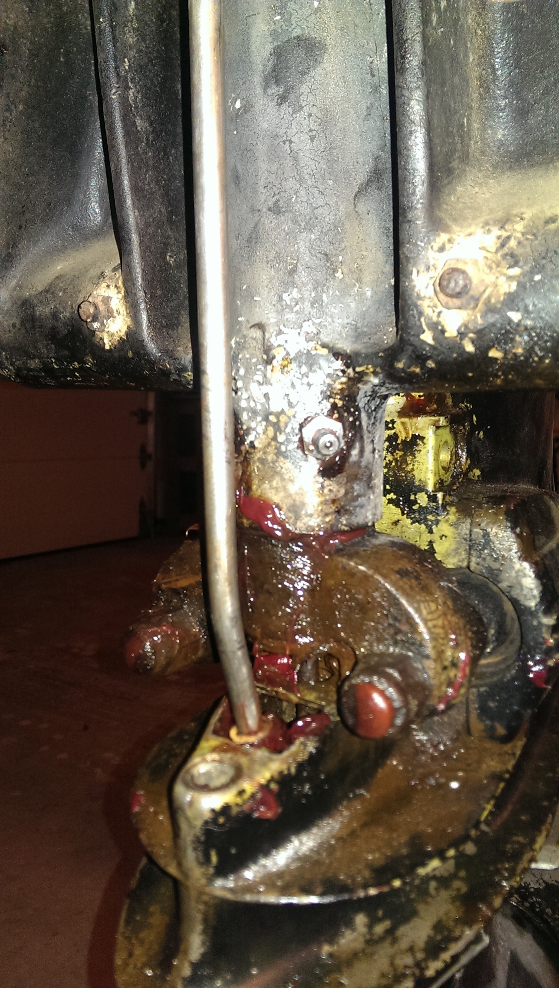

and here is what i've accomplished...
Dan

Had to let the garage clear, the smoke from the grease was getting to me. Sinc that is the second pipe ivw split i'm going out tomorrow to pick up a piece of iron pipe. Hopefully that will hold
Dan

Get a piece of pipe big enough to smack with a big hammer into an oval that will slide further onto the steering rod.
Since you were able to get that 1/2" with the set-up you currently have, I'm betting it won't be long before you'll win this battle.
Doc F

Doc f, your a mind reader.
went and got a piece of iron pipe that was big enough to slide over without even flattening it.
It was 3.42 feel long. Had to pay by the foot! Wanted it today.
With that and clamping the board to the pole i was able to make it move from the starboard side to center! Still can't move it by hand but with the pipe it's getting there.
Is one kind of grease better than another to help it get free?
Also, going to work on getting the prop unstuck. Soaked it with Deep Creep and heated it a bit. Any other pointers?
Cheers!

Spent a couple hours heating and turning today. I noticed in a previous thread the Doc said to grease it when it was centered so the channel lines up inside.
So i got it centered and started pumping grease in. Still no grease out the bottom, but it seemed that less came out the top.
Need to buy some grease, about killed the last tube today!
I can now get it from stop to stop! But only when it is hot and with the 3' bar on it. But it IS easier to get it from side to side.
I'll give it another go or two and if i don't see grease out the bottom i'll put in a zerk for the bottom and start pumping it in there!

Decided to add a zerk. I've not threaded a hole in a while so i practiced on a hard drive. The frame is aluminum so i thought it would be similar.
That went OK so i decided to go ahead and drill the pivot.
After i started the tap it bottomed out on the pin before the threads were cut. So i ground off the end of the tap, the part that has the started thread cutters.
This allowed me to threat it the most of the way in!
So i added the zerk and started pumping in grease. It is coming out of the bottom about 3/4 the way around. That last little bit just won't have grease come out.
I moved it back and forth for about 15 minutes (3 country songs). I still need to use the pipe. But, it seems to be getting better.
So do we still think it'll get better?

Other than that, I suppose that if the threaded hole for one of the grease zerks was too deep, the zerk could now be restricting movement.
This thought comes from personal experience. :-)
Like you noted, I too had to grind off my 1/8"NPT tap to get enough threads in the aluminum to hold the zerk, and then,...That darn zerk threaded itself in too deep.
Doc

Thanks for the input. It helps me to be able to visualize what i'm trying to fix.
I had the same thought about the zerk being in too deep. A client of ours is about 45 minutes away and it give you time to think. Now i gotta take it off the back burner and back out that zerk to see if it's in too far! :)
Dan

dave bernard wrote:
when you swing it make it botton out hard with your handle keep swinging itand bottoming out hard both ways.when heated.
Thanks dave, now i can picture it.
Dan

So i just took the bottom zerk out. It was not seated against the pivot pin inside. Still will not turn cold.
But at least i didn't over-tap it!

While waiting for a computer to reload and one to clean malware i decided to try turning the stuck pivot. While it will not turn without a cheater, it is turning now, cold, with about a foot of cheater pipe!
Now i'm off to bring in the MFG and get started on the floor.
