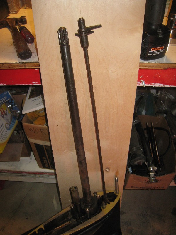

Frank,
When you dropped the lower unit at any time did the shift shaft get stuck in the upper shift shaft coming down from the bottom motor cowl?
If not......
Put the shifter in neutral..... drop the lower unit again with the shifter in neutral.....find neutral on the gear foot (try not to rotate your drive shaft) having someone spin the prop shaft as you find neutral in between forward and reverse.....then put the gear foot back in place in neutral.
As long as the shift shaft in the gear foot did not get pulled upward and come out of position from being stuck in the upper shift shaft when you first took it off the intermediate housing you should be OK "but".......... if the e-clip popped off shift shaft under the shift shaft seal and it came out of position you will need to find another lower to use or take this one down to re set everything.
my 2 cents for a last ditch effort

Thanks for the advice buddy. I'll give that a try a little later today. The shift shaft never moved, other than obviously around its rotation to screw me up! I just want to wait till I get some help. Mama's gone and Gregg is napping. I just may do the same thing, as I've lost plenty of sleep over the last couple days between this boat (and motor) and my old Aveo I'm getting the motor replaced in for one of the kids. I understand what you're getting at and will give it a try. Nothing to lose!

Frank, even though your motor is going forward, your control thinks it is in reverse and it will not go any faster. You have to pull that lower end again and set it in forward gear. Then re assemble with the control cables disconnected. One thing that I found useful is to preload the prop with a bungee cord when it is in forward, it will prevent it from dropping out of gear when you are fiddling with the shift shaft to get it lined up. Once it is back together you can re connect the shift cable and adjust as required. Hang in there. You have one more day of long weekend left. :cheer:

Thanks for the suggestion Dave, lemme see if I can figure this out. I got two exact same lower units and both the shift shafts act the same. I basically can't seem to figure this out, so I have all my merc manuals on the table behind me (pre-65, 65-74, and Glenn's book on mercs), and am going diving this morning to see what pearls I can find in that wonderful merc literature. Got a fresh pot of coffee and a very quiet house.
I played with this for hours yesterday to no avail. Jim Melanson called me offering assistance, and I called him a number of times while screwing around with this. Jim seemed to think I have the LU over-cammed, but my parts motor LU shift shaft acts the same exact way, so I'm completely befuddled. If I could work with someone who's done this before I'd get it, but I guess I'm not intelligent enough to get it just from explanations.
I like the idea of the bungee cord, but can't picture how I'd do that.
Like DelRay says, I deserve a BREAK! :laugh: If nothing else, I have a good attitude about it. We've been so busy trying to figure this out I haven't got any good shots of her sitting at dock. Man o man, she looks fast just sitting still. Her nose sits up in the air a bit and she looks like a cat getting ready to POUNCE! I can't wait to get this shift thing figured out. On the positive side, when we were out yesterday, even though we weren't going fast, the boat came back to dock absolutely dry inside. I figured she would, but that's always a good thing on 1st launch!
Thanks to all of you for you support, help and assistance. I really appreciate it. Of course, if I get lucky here, you'll all know about it...

Re:Boat moves! 16 years 1 month ago #8026
Well Jim, I was able to get it into neutral, forward and reverse.
King Dave (Cummings) emailed me this morning, gave me a picture reference in the 65-74 manual and told me to call him. It's kinda funny, I had just dragged all my manuals upstairs to review them. The pre-65 manual was useless, while the later one is great. We talked a while, and to make a long story short, because of my concern of damaging the shift shaft splines with pliers or vice grips, Dave suggested I pull the female shift shaft out of my parts motor and use it to turn the shift shaft (see pic). Man, that worked like a charm! So we got forward, neutral and reverse, and off to the river we go. We didn't do very well. Motor would die, wouldn't start, then would start and go to 4000 rpm. So off we come home. I call Dave to let him know how weird the motor acted, and the first thing he asked me was "Was the tank vented?" Duh. Nope.
So we'll be off again later to see what sort of a difference that makes soon as my brand new group 27 starting/deep cycle battery is charged up. We pretty much ran it dry during our brief time out.

I took the control cables off Jim, pulled the control box, took it apart to make sure the control box cable ends were okay. Check. Have not re-installed the control box.
Dave Bernard gave me a call earlier, and maybe hit on something. I think the shift shaft pushed up into the lower carb today when we pulled and re-installed the LU at the boat launch after we launched and couldn't get in gear. Motor ran fine at that point, just no gears. I called Dave Cummings and he suggested maybe the LU shift shaft was not mating with the one coming down from the mid-section, and to check that first. I had brought the few tools necessary to drop the LU, so we did, and made sure on re-install that those two shafts mated. That's when the trouble began, though not right away.
Anyways, Dave Bernard said that the shift shaft may have hit the bottom of the carb and either damaged it so the butterfly remained open, or put some sort of pressure on it so it was open when it shouldn't be. there was no question the shaft was up into the bottom of the carb. I tapped the mid-section shift shaft down with a long screwdriver and light hammer.

With the lower unit I would pull it off and make sure the shift shaft can not be moved up and down while in the housing. If it can be lifted with out removing the shift shaft nut, then the retaining clip is missing, and could be causing the problem for you. I know other people have told you to put in to neutral and then put it back together, I am sorry to say I have had more luck making sure they are in forward gear, just touching the neutral gear detent. What I mean by this is find forward, then turn counter clock wise until you just start to feel the detent. Also make sure the shift lever is fully back in postion and the spring clip is in postion at the top of the shift shaft. When installing the lower unit the drive shaft will be going in the block first stop at that point and make sure the shift shaft, upper & lower, is matching up, I use a small screw driver to move the shift shaft around to make sure it is matching up. Then when this is all done make sure the shift lever and the throttle lever is aligned as the book calls for.
As far as the running, if you can turn the motor over now chances are you did not do any damage. I know what you are saying about hte gas oil mixture, but that is not the first place I would go. They may not run well with the wrong mix or different gas or cheap gas, but they normally do run. I would go to the ignition system. I know you are saying you are getting spark, but is it sparking at the correct time, is the spark strong at the plugs. Was the points set properly, was the motor timmed properly. I am not questioning yours or someones capabilties, I have put many these motors together and found out that I either forgot something, or something changed, or did not do it correctly. Easly done. I also have had points set properly and time up great, then found out the motor was running on only one side, replace the point set and did fine. Recently I found a bad dist cap, could not find any cracks nothing, but was causing a mis in the motor. Go to the easy places first with ignition then go else were.

The mid-section shift shaft definitely moves. Once at the boat launch over the weekend I put the boat in and couldn't get anything but neutral. I pulled the boat, trimmed the motor down and had gears. So my mid section shift shaft moves. How can I stop that?
I can put it back in in forward as you suggest. I need to pull the LU anyways, as I forgot to put the o-ring up top last time.
