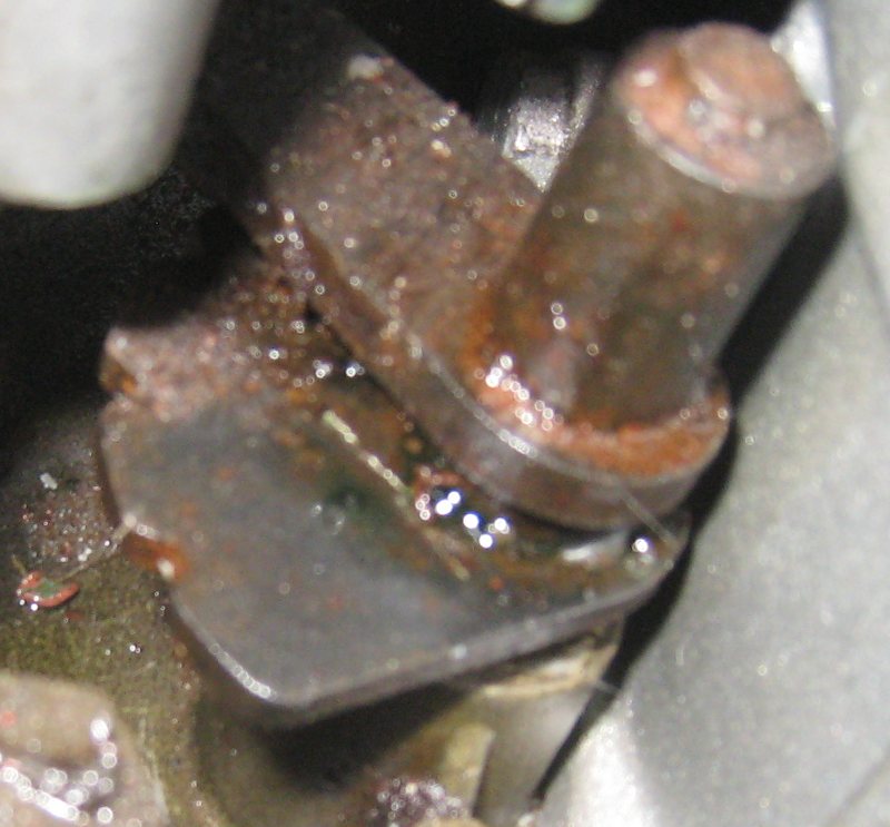

Frank there are a bunch of adjustments you might need to do where everything allignment wise has been disrupted by complete disassembly.
First a question, are you able to move the shift lever all the way forward to where the lever is at least parallel to the floor or does it stop before then? If throttle does not advance than it may be a sign that the high idle shift lock out is misadjusted which is too hard to explain here. The manual does explain it although generally this never needs touching as long as it is still at factory adjustment.
Anyways, on the early GearShift motors it is easiest to do all this with the cables disconnected from the motor, the lower in Neutral which detents in the lower unit.
The shift shaft on the motor also has a neutral detent, look under the bottom carb, there is a cresent shaped arm with a groove that a spring clicks into make sure the spring is clicked into the center groove if there is more than one groove. We will worry about connecting the control cables and getting those adjusted later.
In the lower unit there is a reverse and neutral locking mechanism so the motor does not tilt up when put in reverse. Rather than explain here make sure those pieces are correctly placed by looking at pictures in the manual. There is also a thread spool shaped piece of plastic that slides over the shift shaft splined sleeve at the bottom of the driveshaft housing, I use grease to hold this in place, this spool is what pushs up on the hook mechanism on the clamp bracket that grabs the tilt pin to keep motor from tilting up in reverse. Just make sure all those parts are there and installed correctly.
You need to understand that when the lower slides on three things are lining up, the driveshaft splines, the shift shaft splines and the water tube. the watertube is the easiest as it has the long white guide tube to facilitate that going into place. Just make sure the rubber grommet in the waterpump housing is there and oiled so the tube will slip in and seal. The driveshaft splines will not engage into the crank if the clock position is off. Sometimes you need to rotate the crank when installing. I find it easiest to remove the plugs and the top cowl so I can rotate the flywheel just a smidge to try and get the splines clocked. Lastly the shift shaft splines need to be clocked, you can do this by wiggling the lever on the side of the motor corresponding the the shift. You apply up pressure on the lower unit till the shift lines up then wiggle the crank till the drive splines line up. When all goes up in, if the lower is in neutral the shift shaft should be detented in neutral also. You should be able to snap the shift lever into forward and neutral and reverse although sometimes it jams because the parts are not rotating as they would when motor is idling, so turning the crack helps when moving the shift lever on the motor. Neutrl prop spins freely, forwward prop will "click" when rotated and in reverse it will rotate slightly in each direction hitting a hard stop. The shift dogs for reverse and forward are different internal to the lower hence the difference. Motor whould tilt up freely in forward but when shifted into neutral or reverse it should not tilt up.
If all this is OK then time to install the cables. Shift motor into neutral, listen for the detent, spin prop freely to check. Move driver control lever to neutral this has yet another neutral detent click. Now thread the barrel on the motor end of the cable to line up the fixed mount cable end and the lever stem that the barrel slides onto so the cable matches the spacing on the motor. the throttle cable should be adjusted the same way except the length should match the fixed mount to the throttle lever stem WHEN THE DISTRIBUTOR IS AGAINST THE IDLE STOP SCREW on that front plate with the three screws near the distributor. This insures the throttle forces the distributor to sit against that stop screw, a slight preload is OK, to much will be hard shifting. If you need ot adjust the idle stop screw then the cable will need to be readjusted too maintaining correct slight preload.
I hope this helps some, it's hard to explain in words. I have mastered both the Pre 64 and post 64 setups for this proceedure, it's a little different for each. Once set up the lower can be dropped for impellor service and reinstalled easily if NOTHING is disturbed when replaceing the impellor.
First a question, are you able to move the shift lever all the way forward to where the lever is at least parallel to the floor or does it stop before then? YESIf throttle does not advance than it may be a sign that the high idle shift lock out is misadjusted which is too hard to explain here. The manual does explain it although generally this never needs touching as long as it is still at factory adjustment.
Anyways, on the early GearShift motors it is easiest to do all this with the cables disconnected from the motor, the lower in Neutral which detents in the lower unit.I believe the motor is in neutral, and the cables are disconnected.
The shift shaft on the motor also has a neutral detent, look under the bottom carb, there is a cresent shaped arm with a groove that a spring clicks into make sure the spring is clicked into the center groove if there is more than one groove. See pic, is this what you mean? If so, there is no spring that I can see. We will worry about connecting the control cables and getting those adjusted later.
In the lower unit there is a reverse and neutral locking mechanism so the motor does not tilt up when put in reverse. Rather than explain here make sure those pieces are correctly placed by looking at pictures in the manual.I put PT&T on this motor, so took out that stuff. There is also a thread spool shaped piece of plastic that slides over the shift shaft splined sleeve at the bottom of the driveshaft housing, I use grease to hold this in place, this spool is what pushs up on the hook mechanism on the clamp bracket that grabs the tilt pin to keep motor from tilting up in reverse. Just make sure all those parts are there and installed correctly.
Good luck,
Randy
I stopped after the crescent shaped thing. There is no spring on mine, if I'm looking at the right thing. Is this my problem? I get you on most of the rest of this stuff. I put on new cables and followed the manual exactly. Everything worked fine after that. My problem right now results from something I did or didn't do when I replaced the impeller. Having said that, I understand the detents, how they work, where things are, etc.
Let me know what you think, and thank you very much.
Frank
