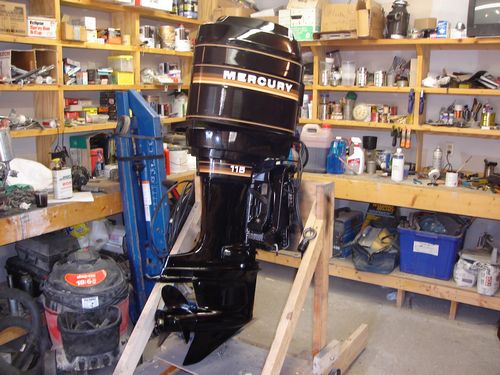

Going to put in a new set of plugs for my 1985 115 IL6.....
NGK or other ??

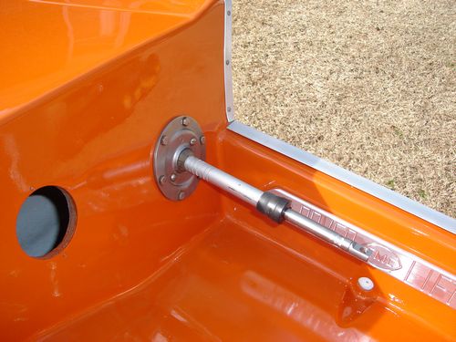

Where did you come across the nifty trim fitting for the steering cable?
lar
Re:Plugs for my 115 ? 16 years 7 months ago #2541
That is actually a type of tube mount. It comes with the tube and bezel as a kit. You can buy them from places like west marine, overtons, etc.

That is the original stainless steel splaswell cable mount that was on the boat when I got it. I have not heard or have I seen another one like it. Somebody must have one. I used the old steeing tube and conected it to the new Teleflex steeering cable assy. The new tube would not fit the old mount.......So now it is back to original! The original hole cut out on the splashwell is smaller also than the new mounts require. I used all new mounts and cable on my '78 Manatee restoration

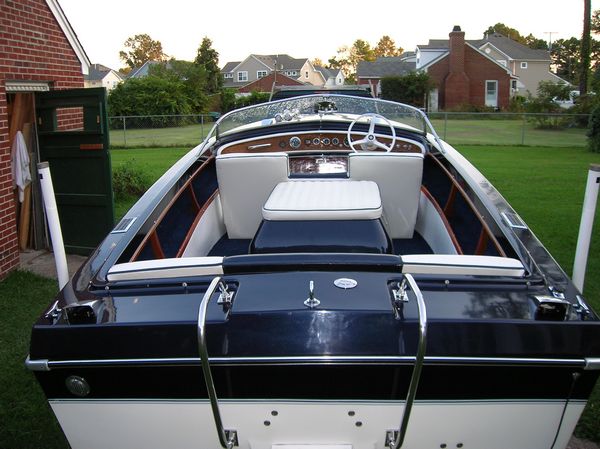

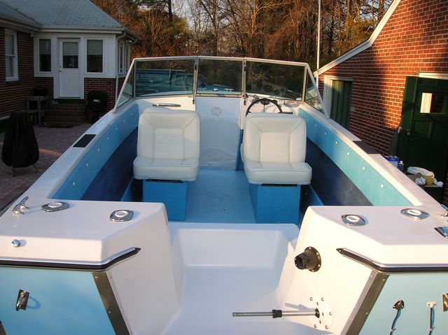

Looking good on both boats, Don! You do nice work. I was stationed at Langley AFB for a while back in the day, remember going to Virginia Beach on the weekends. ("I was gone for a minute, but I'm back now." :silly: )
Re:Plugs for my 115 ? 16 years 7 months ago #2621
I did a 1971 Beuhler Bolero - Thought you might like to take a look.........
Re:Plugs for my 115 ? 16 years 7 months ago #2627
WOW factor 10! Now that is gorgeous, thanks. :cheer:
Re:Plugs for my 115 ? 16 years 7 months ago #2638
Yep, I agree.........Sold it a couple years back.....

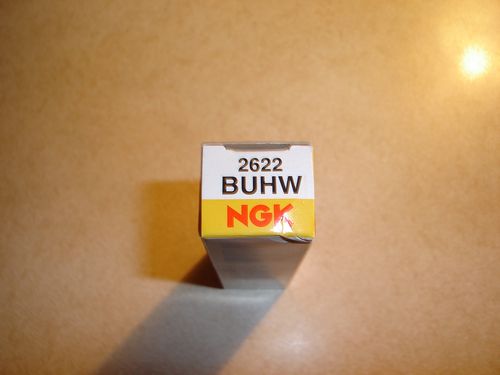

Ordered the plugs - Will get them today..........Maybe get it started this week !
Re:Plugs for my 115 ? 16 years 7 months ago #2724
Glastron_GT160 wrote:
Don,
The OEM plug is NGK-BUHW
Got 'em..........

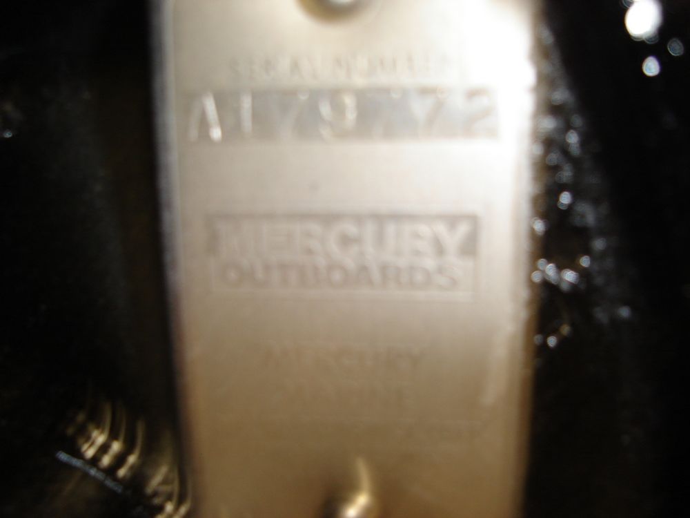

Yup - no thermostat. According to the brown decals in the picture the motor is an '84 or '85 not an '86. See Here
Re:Plugs for my 115 ? 16 years 7 months ago #2974

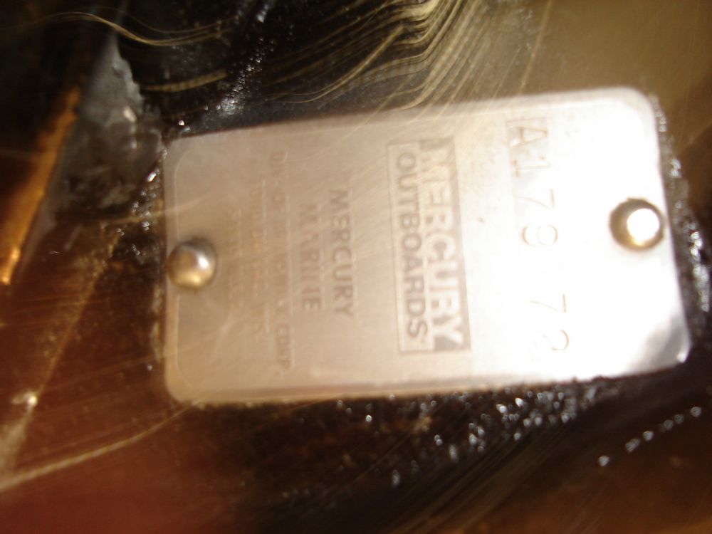

I am sure my Merc is an '85...........
Tried to post pics of the tag not so good but looks like 1985.....
Re:Plugs for my 115 ? 16 years 7 months ago #2981
Definitely a 1985 motor, as we've already discused, here: Re: Just brought home a 1974 GT-160
Doesn't matter though as I believe none of those late model inline 6's had a thermostat.
