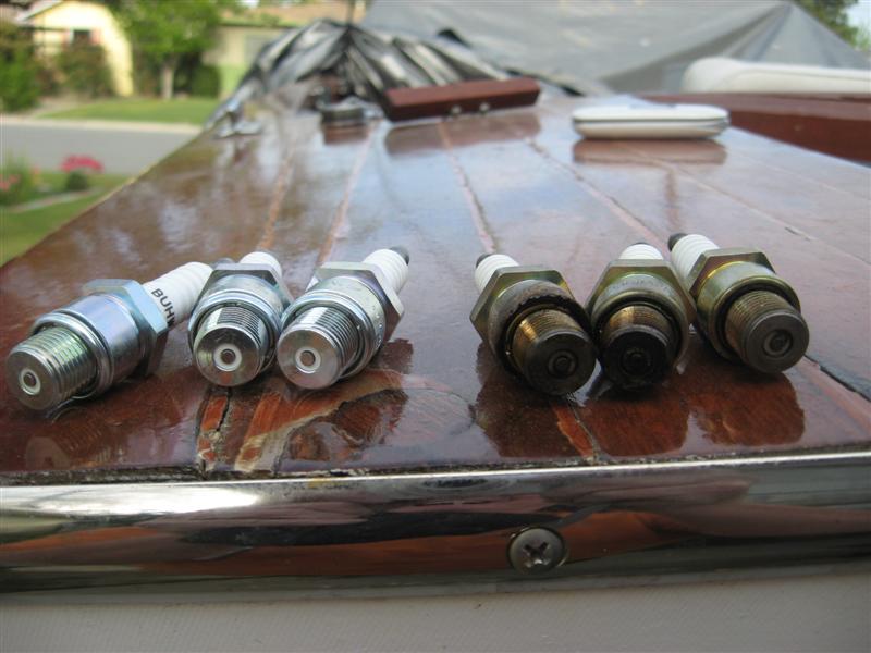

I'm more familar with OMC motors but I was working on my first Merc and saw this thread so I thought I'd chime in cause I just changed my plugs in the same year motor today. 84 I was told. SN is 6480845. Does that make sense? Its hard to read. I also used the NGK plug.
I just bought this wooden boat with this 84 Merc 115 and it runs great. I just want to try and keep it running so here I am. Some of you Merc guys have seen me around here and there so just wanted to give you fair warning I might be lurking with some questions in the future.
I'm not good at posting pics yet and the close up of the old plugs is blurry but you get the idea.
Anyway hopefully it'll be a good runner for me if I treat her right.
Re:Plugs for my 115 ? 16 years 7 months ago #3724
Good morning Jill, and welcome to FG. The good folks around here are more than happy to help you out with whatever you need to ask, so don't be afraid to do so. I've only been around here for a couple of years, but there are plenty who have spent their lifetime at this.

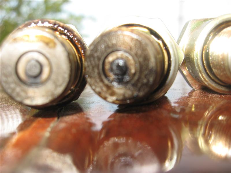

The outer two plugs in you pic look normal, is that carbon or oil deposits in the center plug? (Carbon would be black sooty but dry, oil would be wetter looking).

The middle plugs looked worse than the upper and lower. Its hard to tell. The threads are oily of course. It looks like carbon on the wet side. It had some corrosion like on batteries on the trim solenoids under the cover and I cleaned them up but only could get 2 of nuts off. The other 2 seem seized on the thread and was turning too as I was trying to get the top nut off. I was using a wrench to hold the back nut steady but thread kept turning. Is it OK to let it pull on out of the solenoid or does that mess up the insides? What kind of grease can I put on them to hinder future corrosion? A few grounds look the same too.
