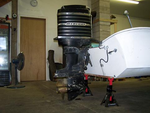

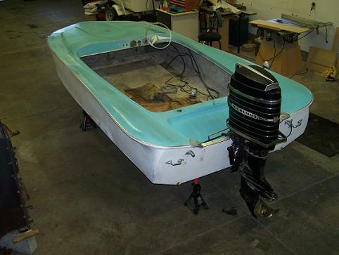

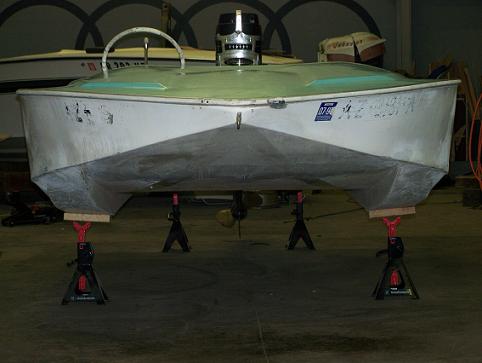

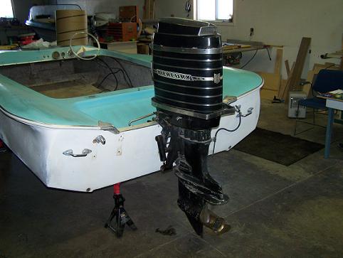

Went shopping over Thanksgiving in the Portland area. I picked up a 1964 Merc 1000 short and a 1964 1000 long shaft with controls. I spent some time on the phone with Thom and he helped me out by answering all my questions. Thank you again Thom. These are my first Towers and I will no doubt be needing some guidance.
Coming from a 1956 30 horse Sea Horse, this should wake the Fantasy up! :)

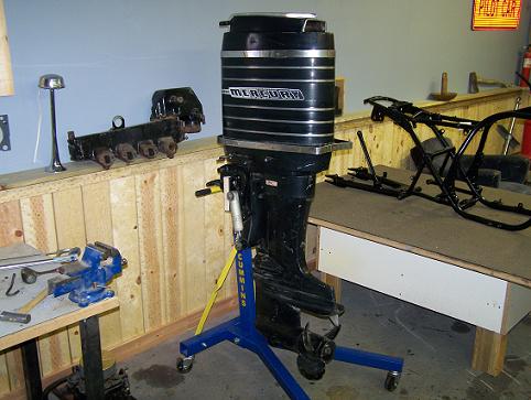

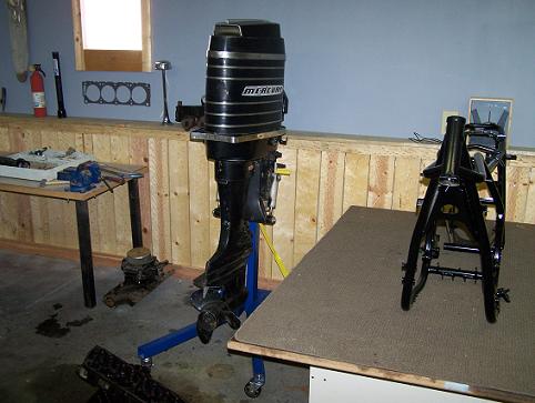

Well I just couldn't wait.
Started the teardown. It has been sitting with Marvel in the holes for about a week. I did another com. test and they were all within 5 to six lbs. of the first check. Hole #4 had me puzzled. When I got the exhaust side tore off, I found a pretty significant groove in the wall of #4. At 46 years old I myself had a few "grooves in the walls" :) I ran out of time. The rotating assembly is next. I will keep the pics coming.
Neil and Mary Ousnamer

Looks like your ahead of me. I guess I'll be watching yours. LOL Yours is definitely in better shape compression wise. I think I may just do what Conrad and Thom said and see if I can get mine running to losen up the rings and see what I get.

I have been watching your progress and reading along. I am learning plenty. I removed the lower and opened up the water pump first. One broken stud, easy fix. The housing itself has a couple little dings but only cosmetic stuff. I removed the drain plug and it was bone dry. Lots of old gear lube leaked out over the years of sitting. Inspection and reseal are in order there.
When I picked up this motor I also snagged a long shaft same year, one will die as a donor. Learning, learning, learning. Lots of fun.
I am not sure of hole #4 yet, hoping for good news when I get inside the case.
