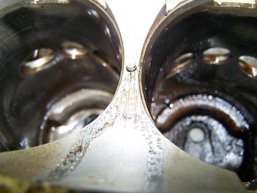

I opened the case on the shorty powerhead and was curious as to what caused the groove in the #4 hole.
The bleed restrictor in the center reed cage had been helicoiled. I suspect that a piece of the thread had gotten into the cylinder and caused the damage.
The rings were fine and the piston also. ??
I will get some pics posted of what I am seeing and we can go from there. I do have questions.

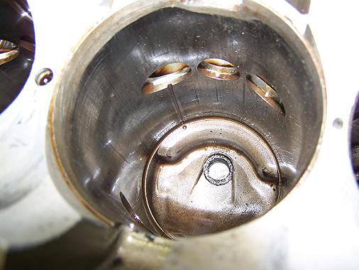

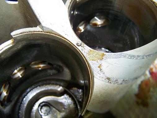

Ok guys here is what I found;
This is the #4 hole. Pretty deep groove.
I found no marks at all on the #4 piston and the rings are all intact. I suspect that it was apart and someone put another piston and rings in without touching the cylinder. I also found that the lands that the reed cages sit in were knurled with what looks like a hammer and punch. The reed cages also.
The helicoil that I believe caused the issue is in the center reed cage. Looks like a hack job, get it running again, and get rid of it job.
I gave $200 for the motor and it is a shorty, so the short mid and the other parts are worth it to me. This block may be salvagable depending on piston oversize availablity and if it will clean up.
Heck of a long post, but what do you gentlemen think?
Neil with Merc guts on his bench!
Neil and Mary Ousnamer

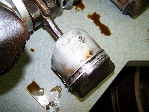

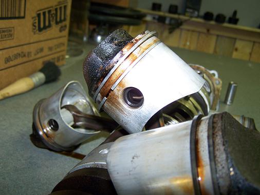

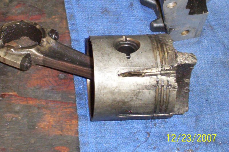

Re:Shopping 8 First tower(s) Here we go!! 15 years 9 months ago #23216
Hum-m-m-m??? #4 cylinder wall looks pretty terminal to me - even if the compression reading was okay this sort of damage wouldn't let a piston have a very long life as compressed ignition repeatedly escapes down the unwanted groove or void.
I doubt you'll find an over-sized piston, but eBay has pulled rabbits from the hat before.
I would like a closer look at all the piston tops, skirts, and where the ring pins are located.
I would suggest stripping the crankshaft clear down, carefully keeping track of which needle bearings went where (just in case you can't score new ones and this crankshaft and these needle bearings check out okay)
You will want to carefully inspect the crank journals for pits, both ends of each rod for pits, carefully clean and inspect all needle bearings for pits or flat spots (ugh - the end would be near)
Then carefully remove the rings - keeping track of which side is up and which ring went where on each piston (the wide rings required by these pistons are harder to find).
I doubt you will re-use this block, but treat it as if you will as you disassemble. It is good practice even if in the end it is not going to be used.
I have some reed blocks that aren't all beat up, so remind me if/when you discover you need some as you reassemble whatever you decide to build.
Nice thing about the old 1000,...There are still quite a few of them floating around with lots of good parts hiding here and there within their discarded carcasses & they sound just too sweet when they are up and running happy.
Thom
