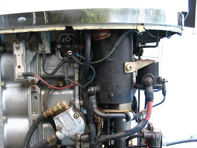

Ron: Your initial post says the motor turns over fine. So there has to be ONE path not making good contact . Like the ROTOR inside the distributer , may be dirty / pitted or top clip broke off .
Another common issue would be the shut off switch , just not opening up any more ,... inside the key ignition switch may have gotten corroded. (Happened with my lawn tractor.).
. I see two round coils in photo , so two can not go bad together . .Had many Mark 350's & Mk 55 where the SQUARE coil inside the dist would melt down & get soft like putty after a hard weekend run. . Maybe a break in some common ground black wire .
. Let us know what you find.

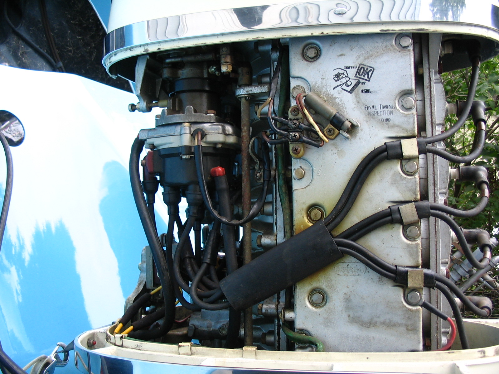

Also, picture #3 shows your mercury switch, to eliminate that quickly, jumper the 2 screws and see if it pops off......

jim,, whaddya mean jumper the 2 screws. ya know i'm a dummy. i see 5 screws. i assume you mean the 2 the wires are attached to. how do you jumper them? ron
Re:ok guys heres the problem... 16 years 1 day ago #19304
ron,he means use a jumper wire ,all that is ,is a wire that is bare at both ends,and touch one end to a screw connection,and the other end to the other conection,bypassing your mercury switch.
Re:ok guys heres the problem... 16 years 1 day ago #19319

Re:ok guys heres the problem... 16 years 5 hours ago #19379
Correct Ron, the screws with the wires. This will bypass the mercury switch.

By the cutoff switch, I'm assuming you mean the mercury switch in picture #3? If it's not hot on both leads, the switch is open and causing your problem. Try tapping on the switch with the handle of a screw driver, or jumper the 2 screws as I suggested. After you jump the leads, try starting your engine. Yes, the resistors get hot.

i guess the switch(mercury) is open jim. only lites up on 1 of the screws. will try tapping it tomorrow. i did jump the leads and nuthin happened.
