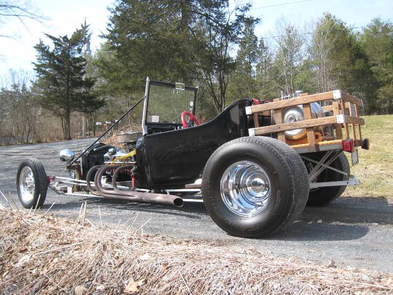

I did the same with my 23t. I run a 406 sbc and have the ford solenoid under my dash, not too far from my MSD box. Built it like that right from the start. Never had a problem with a hot start.
Also had an '86 GMC pickup with a small block and headers with a ford solenoid mounted on the chassis rail forward of the starter.
Frank

Cute T bucket. What boat do you tow with it? ;)

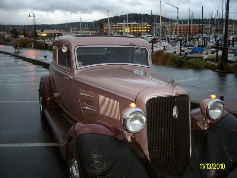

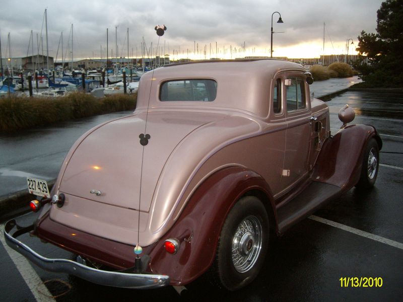

Here's our daily driver when the weather permits.It pulls a matching teardrop trailer.Slightly warmed over 350 sbc/ 2spd PG powered.
Re:ok guys heres the problem... 15 years 11 months ago #19890
No problem towing much with that little car, it has lots of torque. Problem is getting those rear tires on a wet, algae covered boat ramp...
Nice hot rod ya got there. One of these days, I'm gonna build a tear drop.
