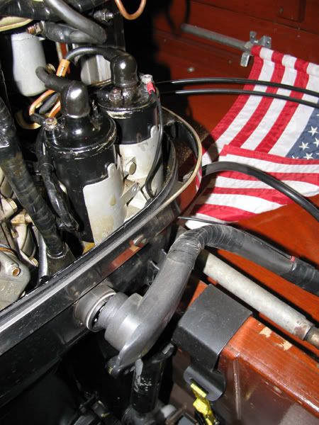

Top view of how the cables are ran
Looks like the top cable would be the throttle linkage and the bottom cable would be for shifting?
I'm also not sure what connection point to disassemble to disconnect the steering.
Looks like it should be connected from here in order to free up the motor and allow it to be removed?
Just as a reference. These are the manusls I have to use. Pretty good information in there but nothing that is really specific. Seems like they try and cover all models with one book.
Re:Off boat storage and rebuild for '65 Merc 1000? 15 years 10 months ago #18778
See attached pictures for instructions.
It would be helpful if better pictures were posted of the way the outer steering cable housing is designed as it looks odd.
Here ya go - hope the pixs help.
Thom

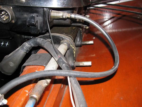

Thom, thank you so much those pictures! That helps tremendously. It seems to make sense. The only question I have is what exactly is the tilt tube? Is that the housing (part of motor mount) that the outer steering cable housing slides in and out of? Looks like one end is the steering cable with the male threads you mentioned to remove. (Starboard side) and the other end is what the steering link attaches to. (Port Side) is that correct?
This is the only other photo that has the outer steering cable housing in it. I can take some more tonight. Any certain parts of it you're wanting to see?
Re:Off boat storage and rebuild for '65 Merc 1000? 15 years 10 months ago #18793
"Is that the housing (part of motor mount) that the outer steering cable housing slides in and out of?"
In a word - yes!

Ok had some success last night. Throttle and shift cables removed easily. Removed steering link without any issues.
The only thing in question now is that outer steering cable housing. It does spin on the male threaded end of the tilt tube but since the outer steering cable housing is connected to the steering cable there is no way to spin it more than 1/4 turn or so before the cable twists tight and won't allow it to turn any more.
Do I need to detach the steering cable from another point (steering assembly on the steering wheel?) and fish it out of the back of the boat so I can spin the whole cable assembly?
Re:Off boat storage and rebuild for '65 Merc 1000? 15 years 10 months ago #18874
I don't believe it is a good idea to run the Merc while the hose is connected to that fitting.
I am of the understanding that when attached to that fitting you are by-passing the water pump impeller with the intention of flushing the motor without it running.
I 'think' that you may have damaged the water pump impeller and housing and next time you should use a set of 'muffs' that feed water directly into the water intake holes found on both sides of the gearcase in a vertical row.
If I'm full of cr*p on the flshing device someone will call me on it - I hope.
Now,...Back to the steering cable.
Can you hold the outer housing of the steering cable starboard of the Merc so that it doesn't rotate as you rotate the nut holding it onto the tilt tube?
I wrap a rag around the housing to protect it and keep it from rotating with a firm grip by use of vise-grip pliers.
Once the nut has backed clear off the tilt tube you should be able to pull the steering cable out of the tilt tube.
(the tilt tube is the piece of 1" pipe that the steering cable slides through and the motor tilts on as a 'hinge' as the Merc is tilted up for trailering, etc).
A good clear picture of that steering cable on the starboard side of the Merc would be helpful as the system looks different than what I'm used to seeing.
Thom

The flexible outer cable housing looks like it has a male fitting pressed onto it that has grease fitting. That male fitting then threads into the metal outer cable housing you guys have been referring to which has female threads on both ends. Then on the motor side of that metal outer cable housing it threads onto the male end of the tilt tube.
I don't have a picture right but did this quick sketch of what I remember of it. It looks like it would come apart this way. Click on the image to make it larger.

I got my lift ring in yesterday and it threaded in by hand all the way so I was happy about that!
Back to the steering. The piece that has the female ends on both sides spins freely on the tilt tube's male end. I can turn it by hand with no effort. Like I said before though, the flexible part of the steering cable will only twist 1/4 turn before I can no longer turn the metal tube.
I'm wondering if I can un-thread the male end of the steering cable while threading the "metal coupler" further onto the tilt tube. That way the steering cable isn't twisting. I just have to hope there are enough extra threads on the tilt tube to allow me to back out the male fitting on the steering cable.
