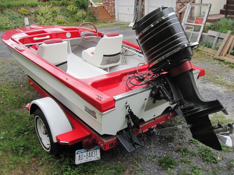

I have attached a picture of my 1961 Merc with mid'70s power trim installed.
Works great.
Thom

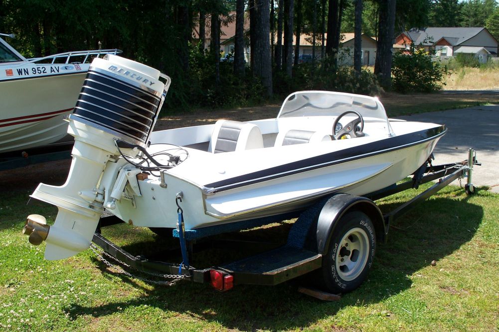

Here's a pic of my '62 Power Cat 14T with my '63 Merc1000 and early merc trim attached.

The PC looking mighty fine Frank. Those seats look good. Comfy too.
Doc what is the extra hose or cable I see going into the M 800?
What prop is on that Merc? Looks wicked! You guys have me droolin over here :kiss:
Re:Off boat storage and rebuild for '65 Merc 1000? 15 years 8 months ago #19001
That is an 18P Merc Vengeance 3 blade ss cupped prop. It, along with the PT&T, makes my boat perform at the top of it's class for the vintage of the set-up. Gets me to 46 mph on gps.

Jim,
That extra line holds the lanyard safety kill switch wires.
As you might recall - I have converted this 800FGS to solid state ignition so wiring the lanyard kill switch in this case has (2) wires. One to engine ground and the other goes to the brown terminal on the port side of the switchbox. (same terminal that the Mercury kill switch is wired to when one is used.
Thom
