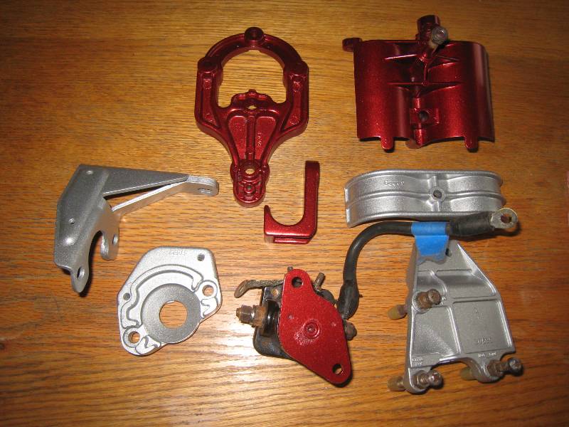

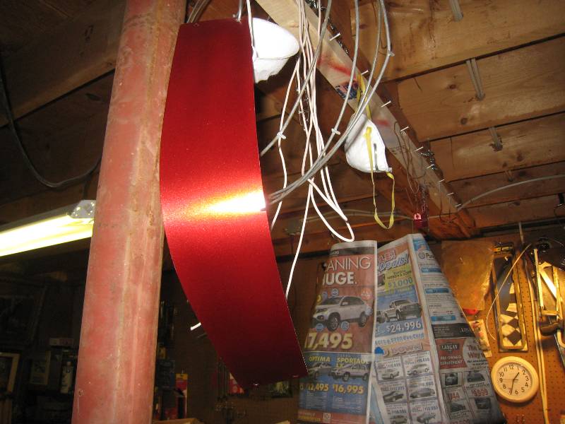

Thanks Doc. Gave it a bit of touch-up with primer this a.m., will do 1st coat final color (black metallic) tomorrow a.m. Camera is with the little woman, she's over in VT for a skiing weekend.
Motor brackets all came out looking real good, a mix of red and silver metallic. All the exterior pieces will get a couple coats of clear too. Got the cowl and bonnet in 1st coat of clear this a.m.

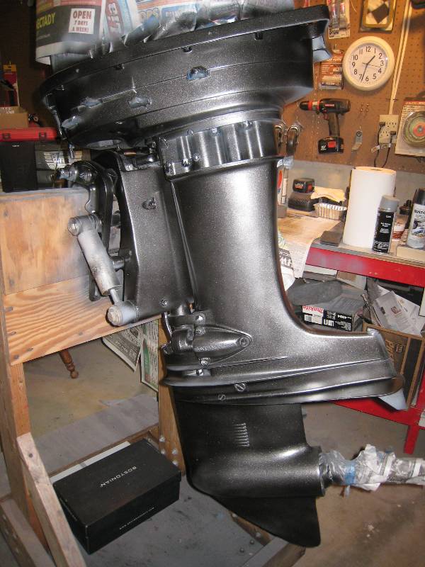

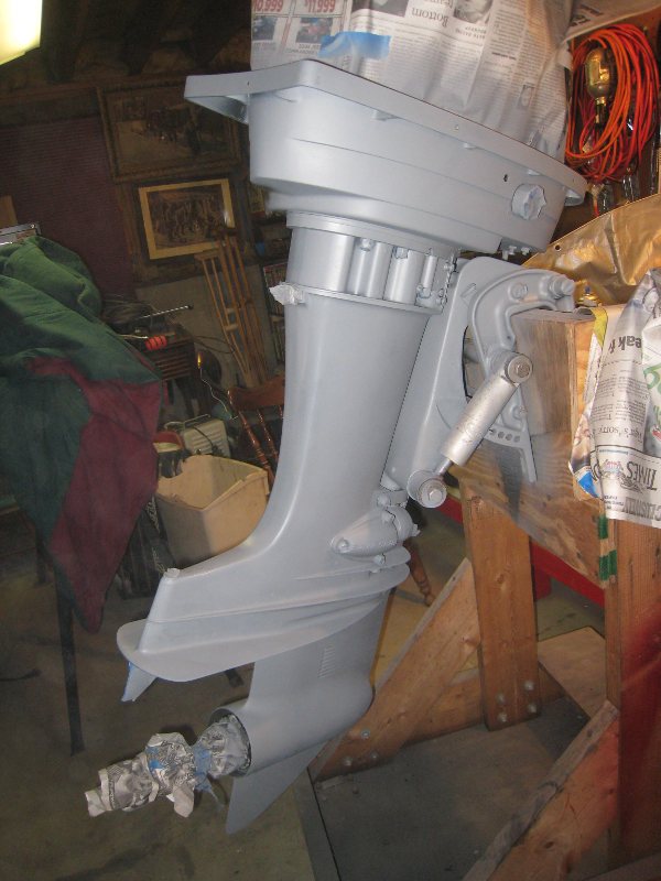

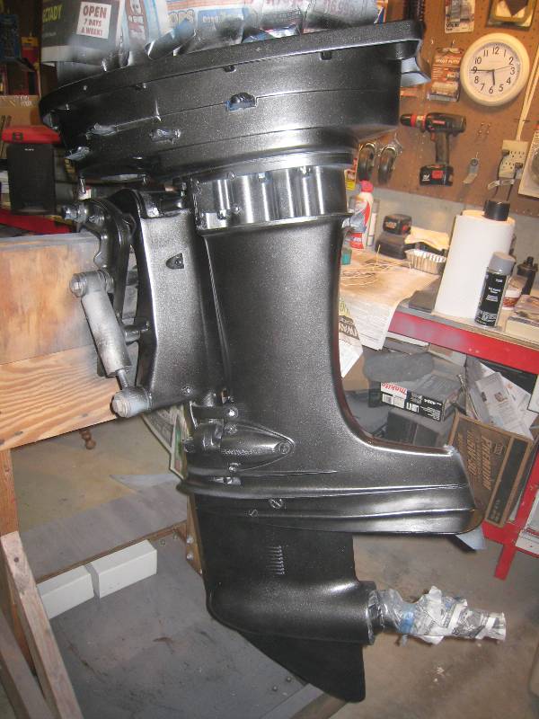

2nd coat final color lower unit 16 years 8 months ago #1903
Look any different? Sure does to me, but I'm not sure the pic reflects the change...
Frank
Re:2nd coat final color lower unit 16 years 8 months ago #1937
Frank,
What color is that? Is it a black metallic or a charcoal? Looks good whatever it is!
Doug
Re:Progress on my '63 1000 16 years 8 months ago #1946
Good morning Doug,
It is Rustoleum #7250 Black Night Metallic. The silver and red metallics I'm using, as well as the clear, are Dupli-color. I like Dupli-color cause I can get it at NAPA, but they don't have a black metallic in that line. I get the black metallic at Home Depot.
3rd coat this a.m. on the LU and it's ready for two or three coats of clear.
Frank

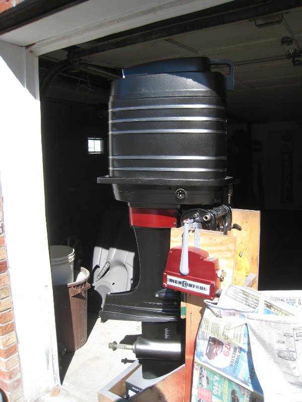

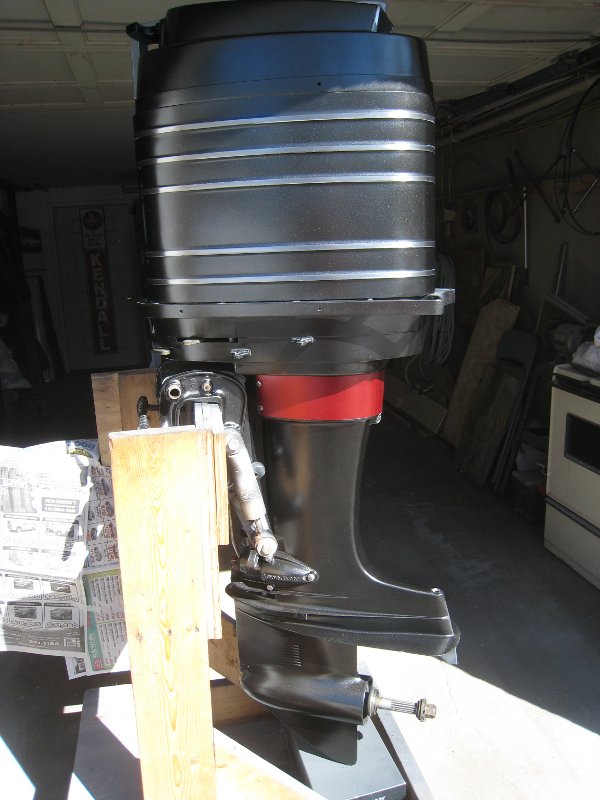

Pics of new paint in sunlight 16 years 8 months ago #2218

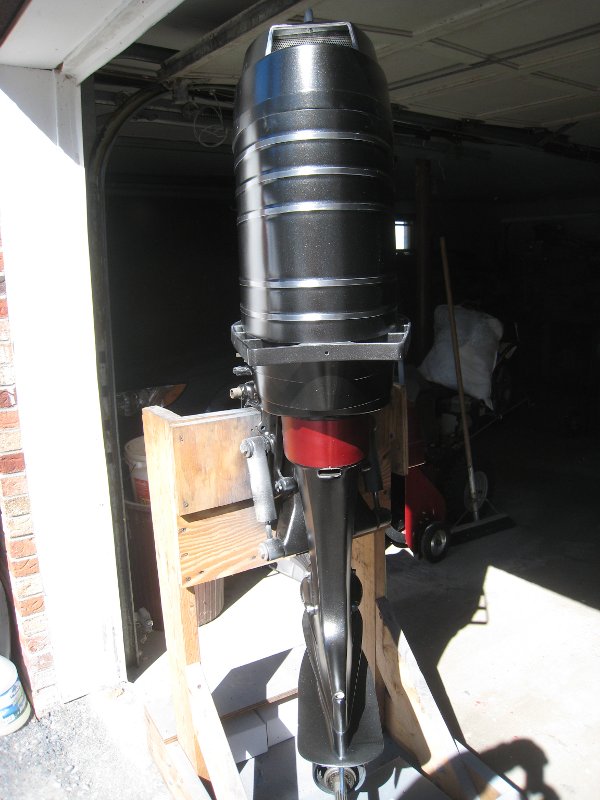

Just stripped all the tape, newspapers, and paper towels from stuff that was being protected, assembled the bonnet, held the cowl on with electrical cord (latches aren't ready just yet - tomorrow) and rolled the motor out to the edge of my south facing garage to see how she looks in sunlight. I don't have the face shield done yet, but this gives you an idea of where I am. Next I will start re-assembling the motor brackets with the starter, solenoid and new coils. Got more snow to shovel.
Frank
Re:Progress on my '63 1000 16 years 8 months ago #2225
  • Bigfoot
  • Bigfoot's Avatar
  • Posts: 282
  • Karma: 22
wow,I hope when I do that to my motor It looks so good. I like it :) Frank, nicely done. I cant wait to see it on a boat. What's it going on????Mike
Re:Progress on my '63 1000 16 years 8 months ago #2226
Thanks Mike. Just a lot of prep, that's about it. Painting is easy.

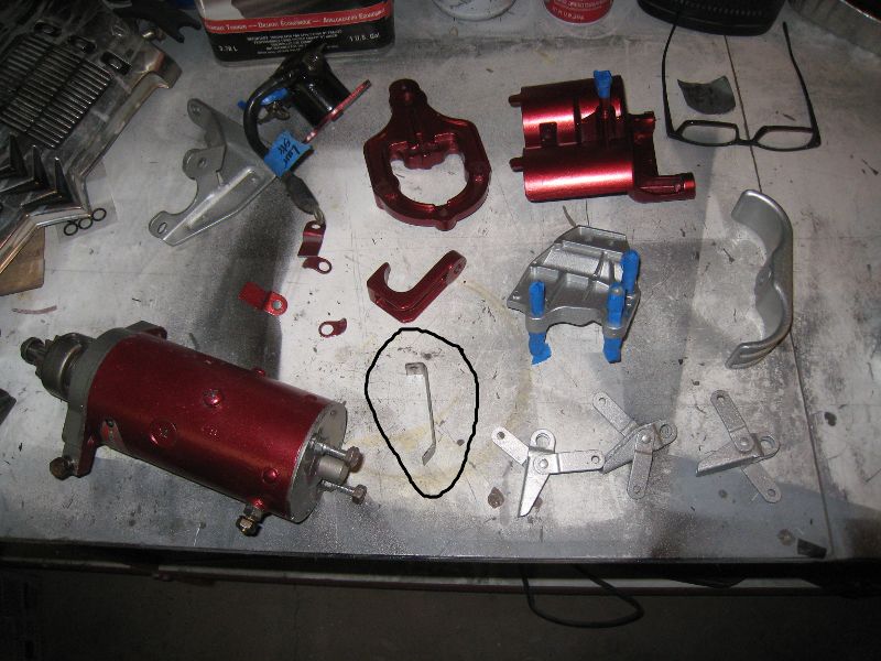

Little set-back 16 years 8 months ago #2252

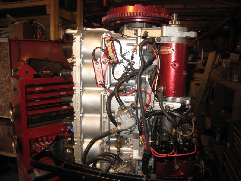

Got everything out to start re-assembly, ran into a little problem. I had 2 of these motors, same year, same model, and to make a long story short, only one of the 2 solenoid brackets I have (even though they look the same) works with my good starter. Guess which one I painted? You guessed it. So it will be a few more days till I get my starter & solenoid brackets on.
What is this little thing circled in the first pic? It's about 3/4" wide, and I think goes inside the bonnet maybe?
Frank
Re:Progress on my '63 1000 16 years 8 months ago #2254
looks like the link for the manual choke.
Re:Progress on my '63 1000 16 years 8 months ago #2255
I agree Dave, the end with the 90 degree bend looks just like where the choke knob link comes down from the top bonnet on my 700, the rod from the carbs goes thru the hole and gets cotter pinned. I'm not familiar with what the other end looks like, never took that part apart tho.....
PS She is looking FINE, Frank!
Update on NOT selling Cutter - I'm getting at least a temporary reprieve. My boss is going to submit the medicals to workman's comp since it DID happen at work, I did give up a beautiful Saturday to ride with her to visit her mother (causing much discomfort to my tender groin), and the analogy of keeping my first 'Glassic similar to keeping one's first car may just do it! I'm a happy boy, I'm a happy happy boy! :lol:
Re:Progress on my '63 1000 16 years 8 months ago #2266
Thanks Mike. Just came up from spraying a bit of primer on the chrome piece that goes on the bonnet and the correct solenoid bracket. Two coats will do it. Then I'm going to experiment a bit with some chrome paint on that bonnet piece, see what happens. If I don't like it, I'll do it in silver metallic.
Yes, both you and Dave are correct, that is a choke piece. Dave called last night and jarred my memory. Once the paint fumes settle, I'll go install that little do-hickey.

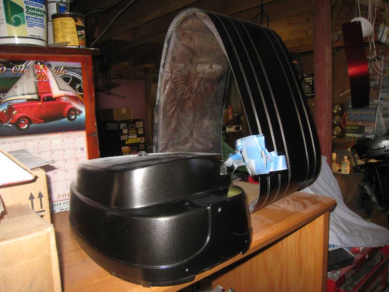

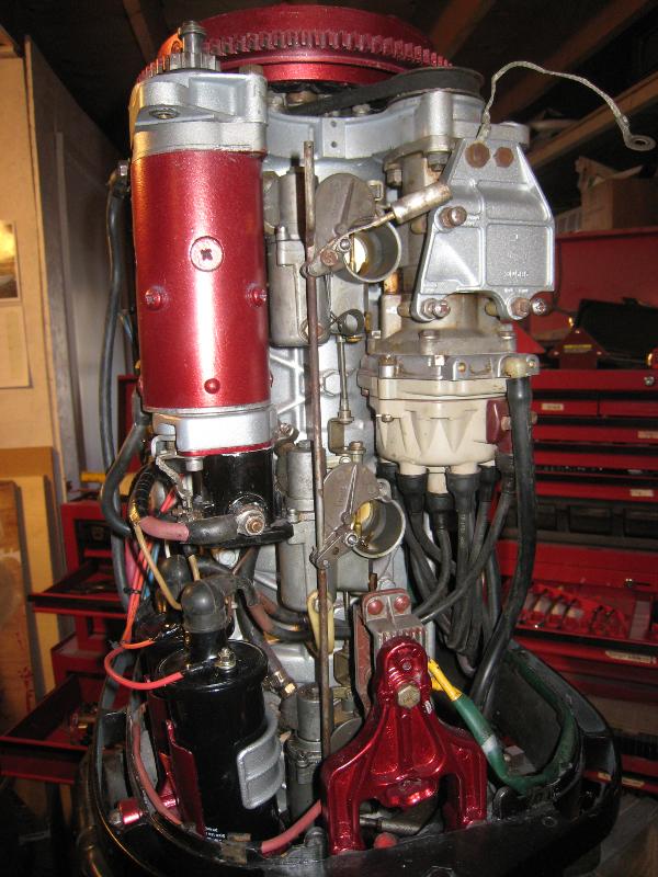

Under the cowl DONE! 16 years 8 months ago #2290
Came out okay folks.
Frank
Re:Progress on my '63 1000 16 years 8 months ago #2291
Absolutely gorgeous Frank, I love it. I promise you there isn't another one in the world that color scheme. (Although there may be soon.) Nice work buddy!
Re:Progress on my '63 1000 16 years 8 months ago #2292
Thanks Mark. As anybody knows that's been following along, I painted this the way I wanted to, I was NOT trying to restore it. It's mine and I can do what I want.
I'm done for the day. Back is problematic. Wish I could call that a workers comp thing. Someday it may get me disability for social security, the only problem being I really won't be able to do anything.
Frank
Re:Progress on my '63 1000 16 years 8 months ago #2293
  • g3jim
  • g3jim's Avatar
  • Posts: 1009
  • Karma: -27
looks good from here Frank. Best of all it is going to look good on your boat. Nice work
J
Re:Progress on my '63 1000 16 years 8 months ago #2294
Thanks Jim. I'm a little doozey from paint fumes. I better have a beer.
You can check it out when you come over. I hope all is well with the in-laws.
Frank
Re:Progress on my '63 1000 16 years 8 months ago #2296

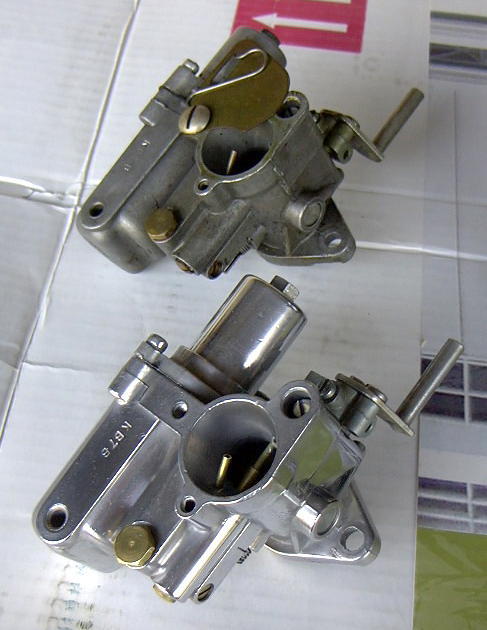

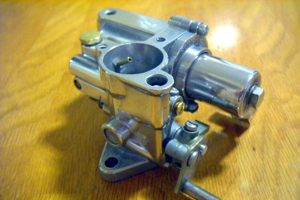

Looks great Frank... very custom.
Next time you have those carbs off, I'd recommend polishing them up. It would compliment your flashy color scheme. Not too hard to the back, especially if you have a buffing wheel. Purely cosmetic, but I like bling..lol
An example of my 3.9hp carb before/after attached for reference.
:cheer:

Thats very detailed Frank. It looks so clean, it really highlights the motor.
Hey gt160, those polished carbs look good, great idea, Mike

Good idea on the carbs Chris. Same thing could be done with the fuel pumps couldn't it?
I never thought I'd be doing this, so back when I had these motors apart, polishing anything didn't seem to make much sense. Now, I have another whole set of carbs (and fuel pumps) that I could play around with - after this boat is done & I'm on the water!
Frank
Re:Progress on my '63 1000 16 years 8 months ago #2305
Its addicting Frank. On my 115 Merc I polished every bolt head on the motor, the large aluminum plate -hidden- behind the electronics, and the brass fuel enrichment solenoid, and.... lol
