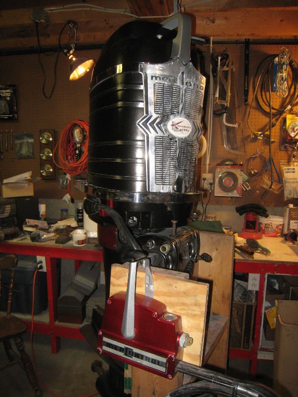

Boy, it sure is a good thing I have a parts motor. Went to install my newly painted latches on the cowl and couldn't find the steel rod they swing on. Got an extra real banged up cowl, but it had a good rod.
This is pretty much it, although I still need to tackle the face plate. It is thin stainless or aluminum and had etched in stains on it, almost like somebody spilled orange juice on it on a hot day and didn't bother cleaning it off. I can't afford to chrome it, so it will no doubt end up like the former chrome piece on top of the bonnet.
Got a defective coil from NAPA (terminal post snapped off), gonna get a new replacement tomorrow and then maybe tomorrow will see if the motor starts. Wish me luck!
Frank

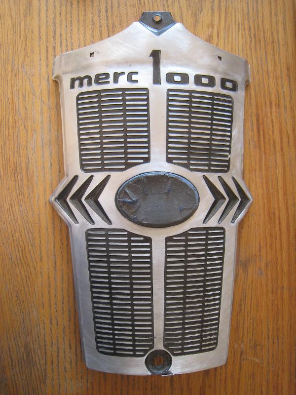

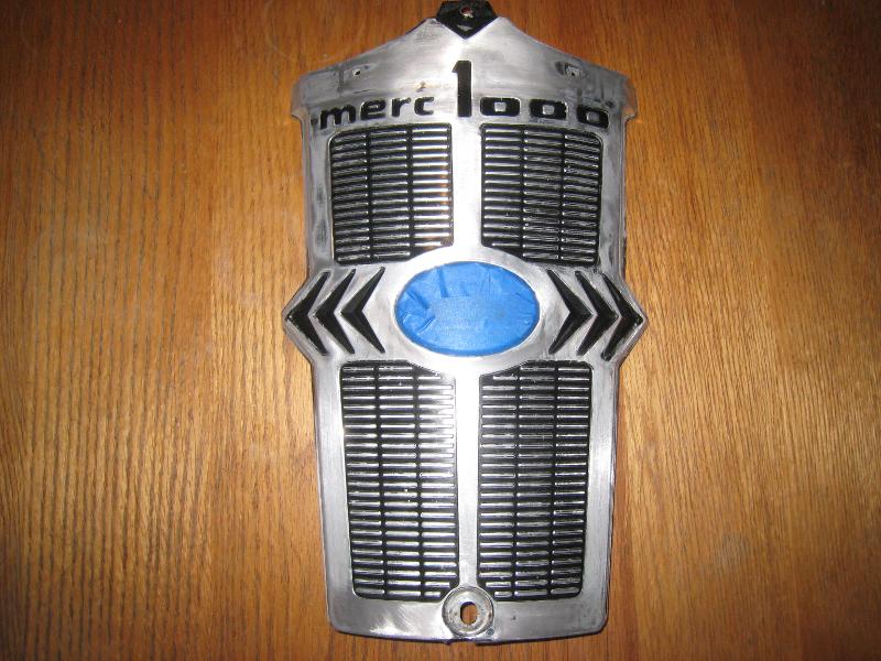

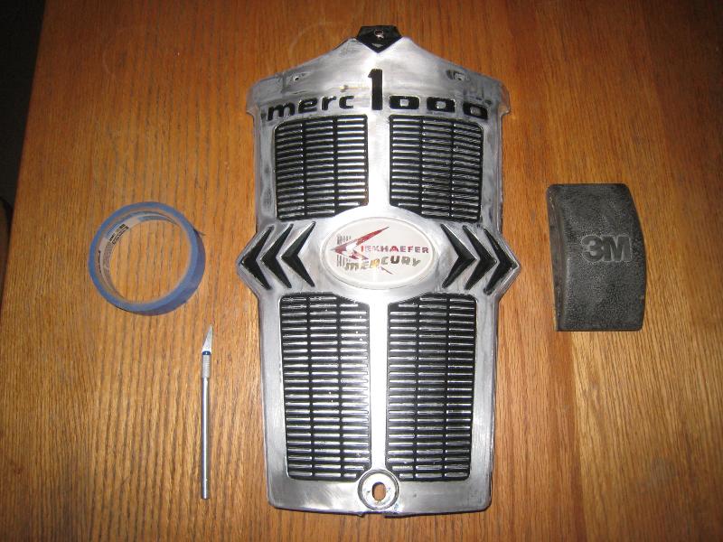

'63 1000 faceplate budget renovation 16 years 7 months ago #2614
Can't afford chrome, and faceplate looked so bad, had to try something. Actually I tried a whole bunch of ideas before coming down to this. I ended up sanding the whole thing with 220, and even that took a while to get the etched in stains out. Cleaned it real well (toothbrush clean) with KLeanz-Easy, then primed it. Primer shot looks glossy just because I took the pic right after priming the piece.
Later today I will give it a couple coats of black metallic to match the motor, then sand it again. I'll start with 220, then move to finer grits and see how it looks. I'm going to get to a point where I'll be done, then give it 2 or 3 coats of clear and call it a day. This is the last thing I needed to deal with to put a wrap on the motor. Soon as I get some cash ahead, I hope to get decals for it, but that's not critical right now.
Frank

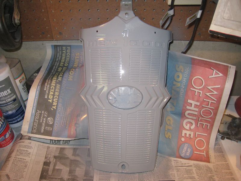

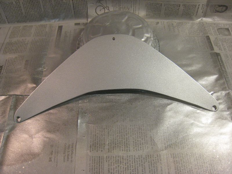

Merc faceplate 16 years 7 months ago #2728
Primed it, painted it black metallic, then sanded all the raised stuff off with 180, then just cleaned it up with 220. Probably will go to finer grits, but I'm home sick with a bad cold and can't keep working on it. Maybe do a bit more later today. I'll get it best I can, then hit it with 2 or 3 coats of clear. I could do that now and it would look better than it did!
Frank

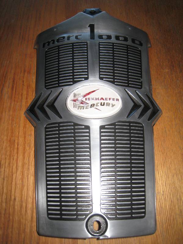

Merc faceplate done! 16 years 7 months ago #2739
Took it to 1000 grit (180, 220, 320, 400, 500, 600, 1000), then rubbing compound, then extreme cleaning, then 3 coats of clear.
Frank

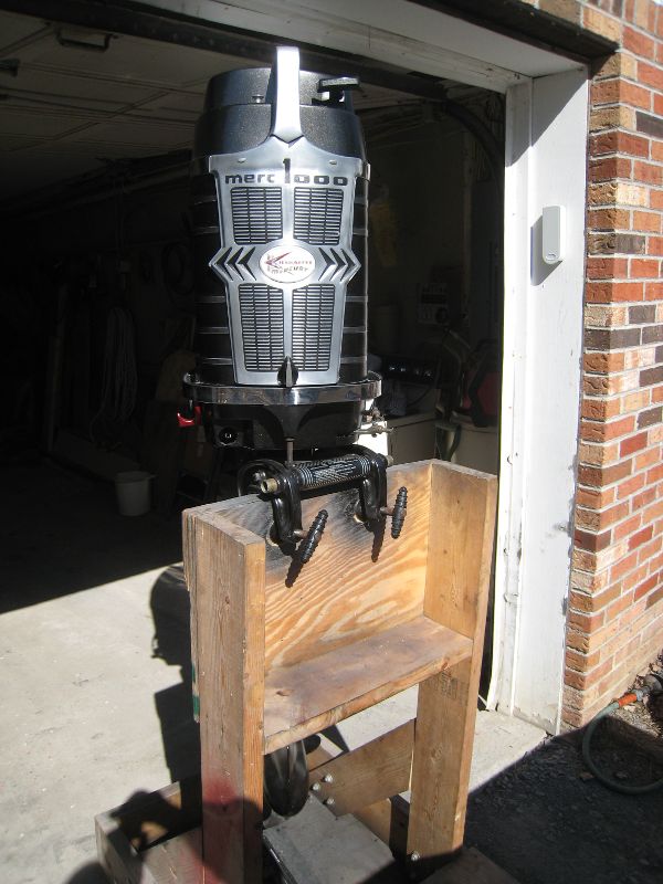

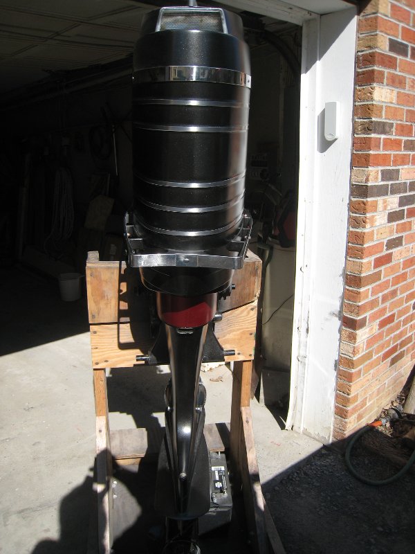

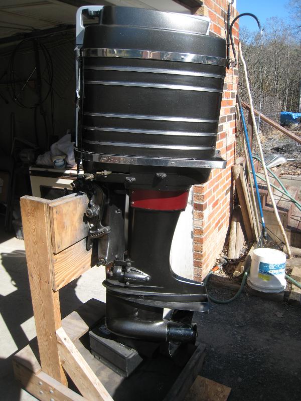

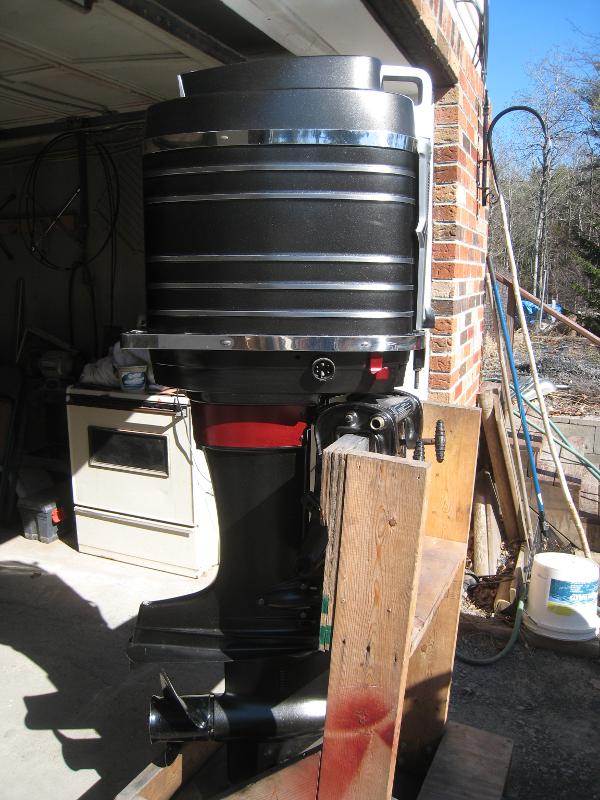

Final '63 1000 paint pics 16 years 7 months ago #2840
Here ya go, DONE!
Re:Progress on my '63 1000 16 years 7 months ago #2844
Don't get much better'n that Frank!!! Awsome!
Re:Progress on my '63 1000 16 years 7 months ago #2846
Thanks Jim. Good to see ya aboard buddy! You were my inspiration for what I did with this old Merc.

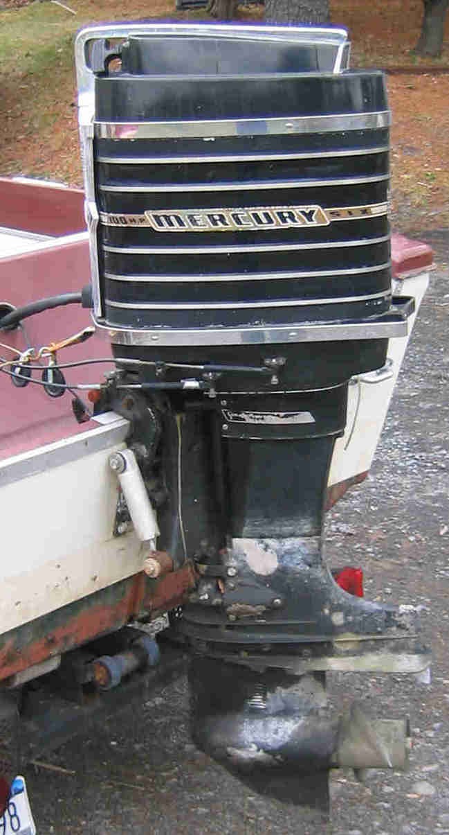

Here's that merc on the boat I took it off of. Long time ago.

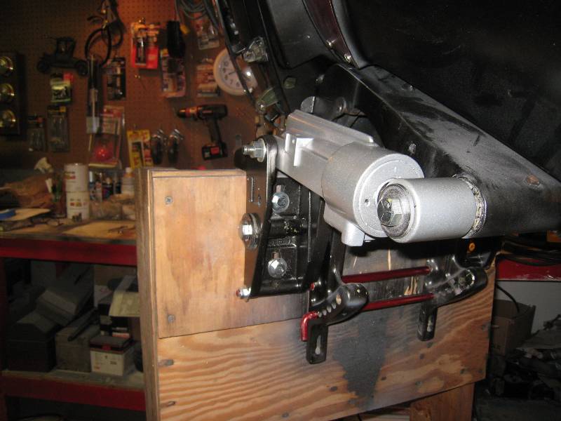

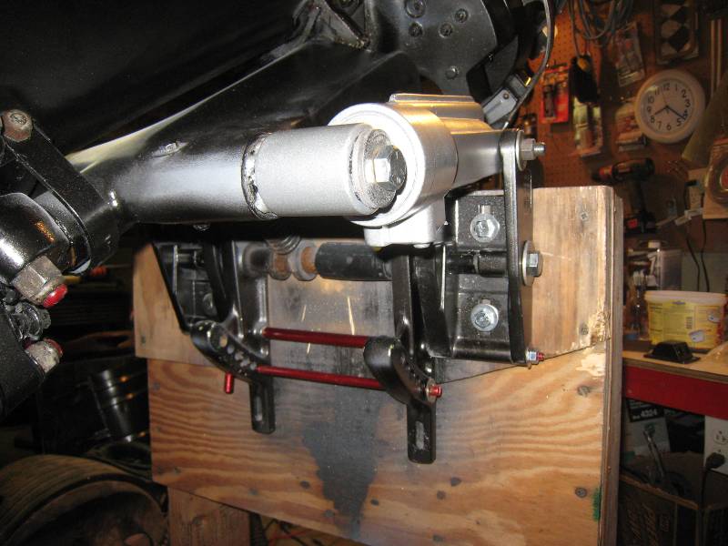

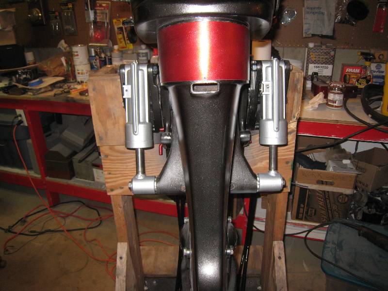

Trim cylinders & brackets mounted 16 years 7 months ago #3212
See pics. Next plumbing, then electrical.
Re:Trim cylinders & brackets mounted 16 years 7 months ago #3226
Frank,
I see that you have longer than 3.5" capscrews installed at the top of the rams to their brackets and that you have put these capscrews end 'backwards' from original.
It will work okay as long as everything is uncorroded and well kept, but if the brackets get corroded to the shaft that that the 1/2" fine thread capscrews thread into you won't be able to remove a ram if ever needed to for repairs/replacement without first removing the entire bracket and over time the brackets can become very difficult to remove.
Make sense?
Sorry to be a poop, but I mean well.
:huh:
Thom
Re:Progress on my '63 1000 16 years 7 months ago #3234
Makes perfect sense Thom, and of course, that is why I wanted to know what yours measured. This is mocked up solely for a shop test with plain steel "stuff." Having too long a bolt here is a real pain, as it has to get put on first. If I need to disassemble it, I will mark these and cut them off before re-installing. I may end up doing that anyways if I have trouble getting the hoses on.
I have correct length 1/2" fine stuff in stainless coming from www.mcmaster.com , and will be getting the 7/16 X 3 1/2 in stainless here locally, as well as the 3/8 stuff I need to mount it to the transom. All this plain steel will be going away soon I hope!
Thanks again for all the help Doc. Take care of yourself and get better!
