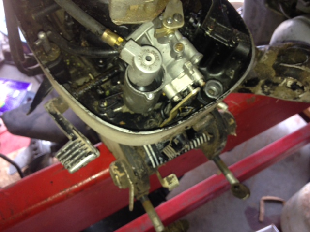

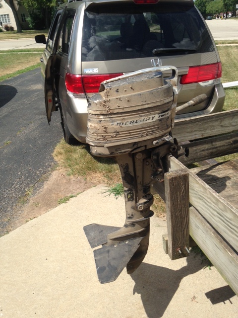

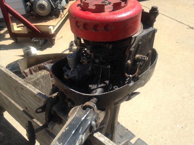

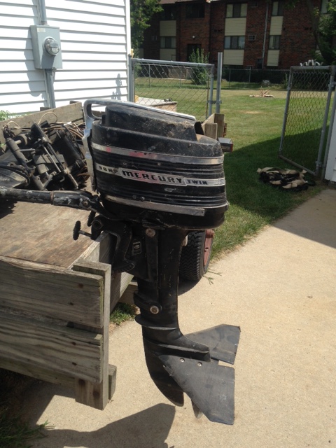

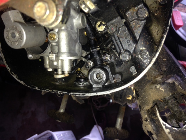

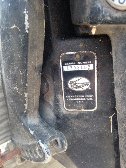

Not sure of the year, but it looks like it is in the first range of serial numbers on Marineengine. Popped the top and it looks like I am missing part of the carb and maybe the fuel fittings.
Merc experts????
Missing part of the carb??
Missing something here?

It's a '64 model.
store.oldmercs.com/category_s/839.htm
www.marineengine.com/parts/mercury-outboard-parts/110/1470349-thru-1865778
The missing part on the carb is the float bowl top. This contains the float needle/seat and the float needle arm. It's sealed to the filter housing on top by a cork or fiber gasket, and a small gasket between the top itself and the float bowl.
Fortunately, this is a very common part and you could use one from pretty much any old Merc with the same carb design.
You'll also need the filter since it's missing. Not to mention the 1/4-28 bolt for the top, and the plastic or metal washer that seals the bolt. And a few screws as well!
If you have an old scrap Merc carb kicking around, it'd make an excellent donor for these parts.
You can see the parts breakdown at Marineengine.com diagrams, here's the carb:
www.marineengine.com/parts/mercury-outboard-parts/110/1470349-thru-1865778/carburetor-assembly
Here's the carb packing kit which would have all the gaskets/pieces you'd need to service the carb:
www.marineengine.com/newparts/part_details.php?pnum=SIE18-7006-1
The fuel fitting is smaller than the standard Merc item and quite expensive. You may find a deal on eBay from a seller who doesn't know what they have.
Here's a new 30635T3 fitting on eBay for $28.35 shipped, not bad if you find out the motor's a good one:
Meanwhile, when you get to the point of running it, you could just stick a hose over the end of the male fitting, for tesing purposes.
You'll need an impeller which is specific to this motor, as I expect it'll have the old "pin drive". The Plus to this is, a lot easier to get the impeller installed!
The ign will no doubt need servicing, just pull the flywheel, remove both sets of points, clean them with a points file or medium-grit sandpaper, and burnish with crocus cloth. Gap the points to .020".
The fuel pumps on these are a bit persnickety, if there is any little bit of fluff in the check valve it won't pump at idle. The pump must be scrupulously clean and I'd recommend installing a small-engine fuel filter ahead of the pump (along with new fuel hoses, of course).
Fortunately the diaphragm kit is still available and inexpensive. Otherwise you can retrofit with a cheap eBay Briggs & Stratton fuel pump (under $10).
Check the gearcase for water, if the oil looks milky, replace the driveshaft seal when you're in there servicing the water pump.
Of course, all the above is moot if the innards are shot, oil 'er up, spin a few times to distribute the oil, and do a compression check.
Have Fun!

Re:Merc 110 - free to me with the Merc 1500 10 years 2 months ago #125668

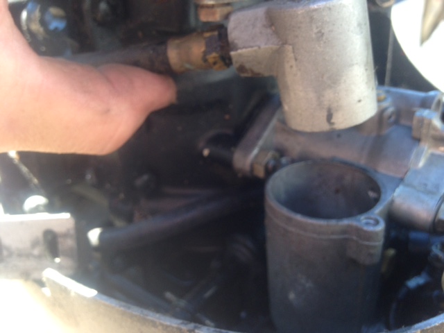

Once you steal the float chamber top off one of the 650-4 carburetors, don't simply discard those carburetors. They are very desirable to vintage racers.

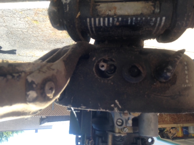

Based on your picture #9, I agreed with Ed, that you just need the external fitting he sent a link to.

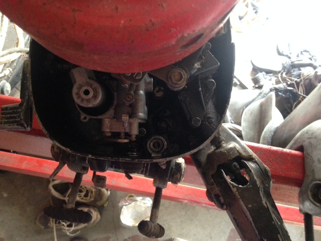

I must confess,...The last picture you posted has me stumped?
Can you back off a few feet and snap a picture of that area???
If you find that you need anything other than the somewhat rare female bayonet, please post & I'll pull that rabbit out of the hat for you.
doc

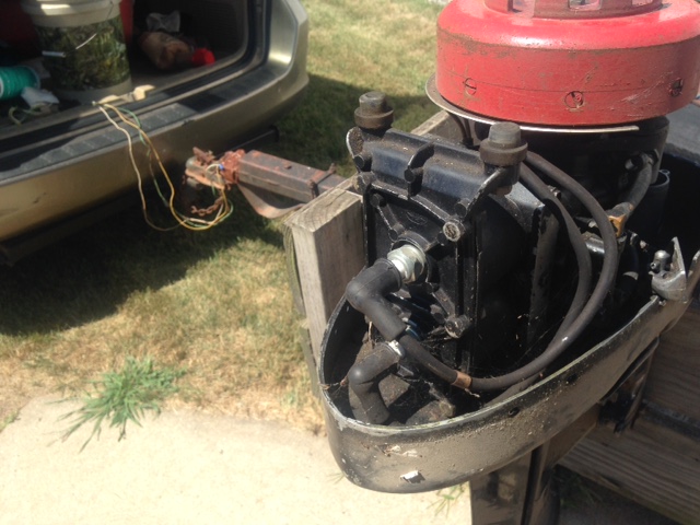

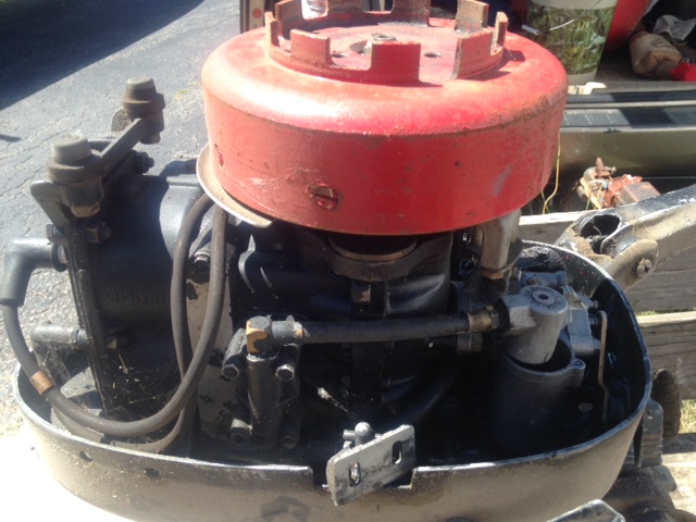

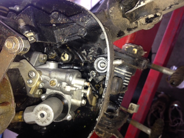

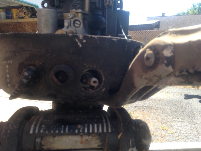

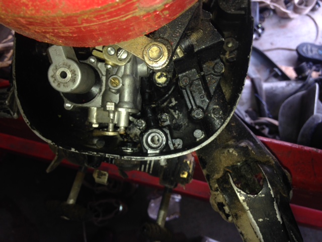

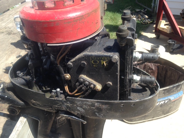

Here are some more pics of the mystery fuel fitting and the missing part.
Probably the best picture of what I am looking at. You can see it lined up with the external fuel fitting. FYI - I now have 5 old Mercs and Zero fuel lines to hook up to them!!

That is just the hole where the bumper for the top cowl fits. The fuel pump is on the Stbd side of the powerhead.

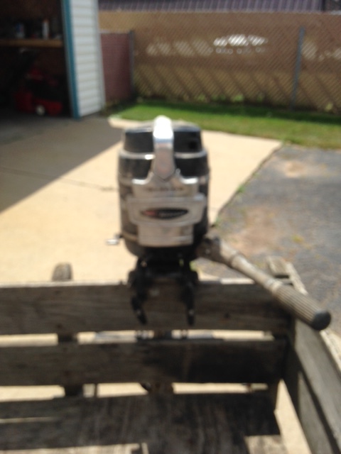

One last question - I am assuming this is a 10 hp, but it is the lighest 10 I've seen I swear that the cover is the heaviest compenent. What is the rated output?
Now to the real question - I know with OMC 9.9s the difference between a 9.9 and a 15 is the carb. Can I assume the same with the 110? If I swap carbs, what can I boost it up to without additional modifications to the engine? Is there a timing change needed?
We have a pair of '80s something Johnsons at the a cottage - a 9.9 long shaft with electric start that weighs just over a ton and a 15 short shaft manual start that weighs just under a ton. Usually the Dingo (14 ft tin rowboat) has the 15 on the back. If I can get the 110 closer to 15, bet the weight difference will make up the rest and the Merc would look nice on the back.
Only issue is that someone might want to "borrow" it after I get it all polished up. Maybe I should save it for a future cedar strip project.
Re:Merc 110 - free to me with the Merc 1500 10 years 2 months ago #125747
IT IS A 9.8 THAT IS THE BIGGEST HP IN THT COFIGUREATION FOR MERC. THE 7.5 CAN BE UPPED TO THE 9.8. THE CUBES ARE ABOUT 11CID. SO 1 HP PER CUBIC INCH.

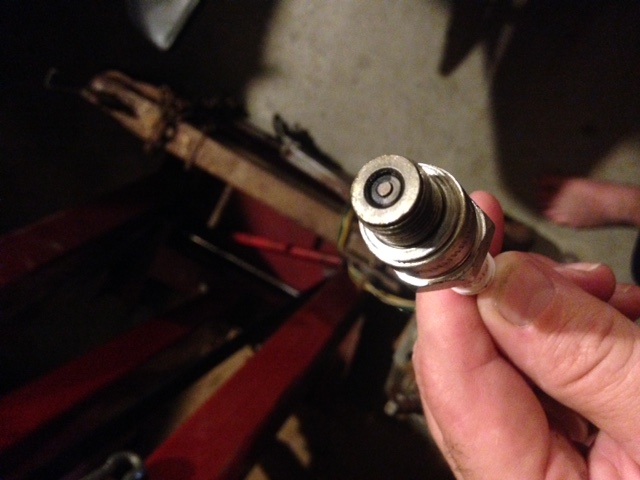

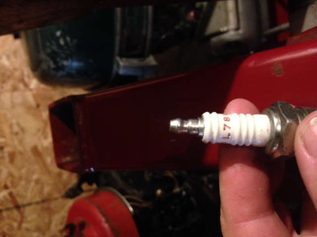

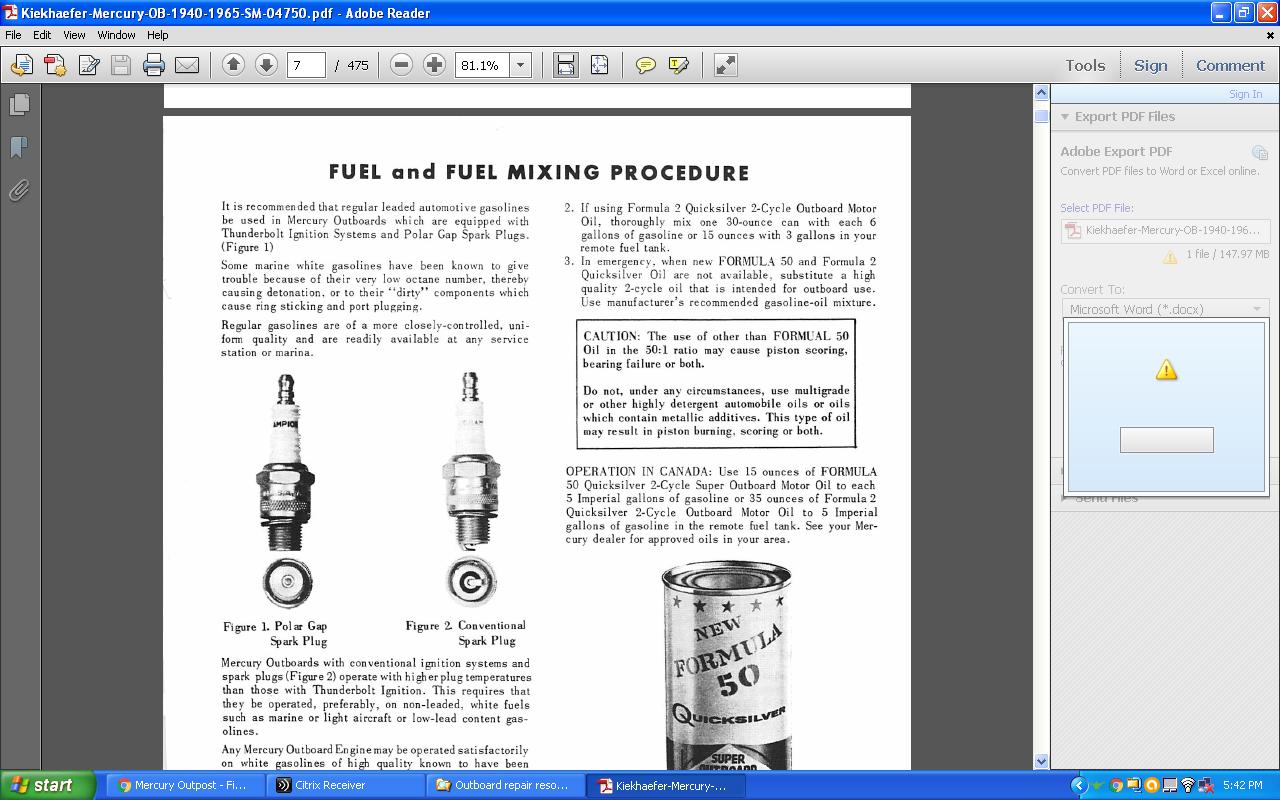

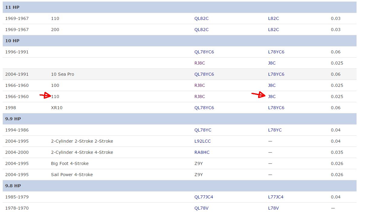

With the polar plugs, is there anything you can do to "freshen" them up that is like cleaning the electrodes on a "normal" plug? Or just get new plugs? I am wondering if that is part of the problem. Or, do you think the spark is too weak initially? It seems to run fine once its going, so I am tempted to let sleeping dogs lie with the points.
Again, thanks for the input.

That motor won't run Permagap plugs properly, it doesn't develop high enough voltage to fire them consistently under load. They are also too long (1/2" reach) for that motor.
At least I assume that's what you meant by "polar plugs".
Your 10hp should take standard-electrode plugs in J8C flavor (stock # 841). Or, if you're feeling really froggy, you probably could find some NOS J7J plugs on eBay.
But the J8C copper core has a wider heat range than the original plug and that's probably why Champion discontinued the J7J.
BTW using those Permagaps is likely a great part of the poor running, besides a bit lean idle mixture. Poor spark will mimic carburetor problems.

Ed,
It came with Champion L78V permagap plugs, so I assumed those were correct. Guess that's just my bias that the previous owners really knew what they were doing. Here's the plug from the top cylinder -

63LStriton wrote:
Ed, It came with Champion L78 permagap plugs, so I assumed those were correct. Guess thats just my bias that the previous owners really knew what they were doing. Here's the plug from the top cylinder -
I guess they were cornfused, 'cause later-model Merc 7.5 & 9.8 Twins with electronic ign use the L78V plugs.
It'll definitely run better with the correct spark plugs in it!

Fix one thing, find another problem, or 2. Got the new plugs in and it seemed to like them. Was messing around with running it in forward in the barrel, and it was having a little trouble under load. I was going to adjust the carb when I noticed problem # 1 - fuel leak.
Fuel is leaking out of the top of the fuel pump and running down the fuel line and then down the side of the carb. Pretty good leak as I noticed it right away. Probably need a new gasket that was messed up with shimmying everything around to get the carb on after the rebuild.
Decided to keep and eye on that and tried to give her a little more throttle. Then discovered problem # 2 - for some reason the linkage that keeps it at idle when not in gear is not disengaging. You only get "starting throttle", and thats it. It is hitting a hard stop, even when cycling from forward through reverse and back. It was working before, so something must have got out of adjustment.
I can probably figure it out looking at the Merc manual and Marineengine.com, but always open to tips and tricks..

I knew I wasn't crazy with the Polar plug reference. I saw it in the Merc manual - Section 1 page, page 3. I'm not smart enough to make that one up.
You'll have to trust me - i got tired of trying to upload the picture. Kept hitting limits!!! :angry:
Re:Merc 110 - free to me with the Merc 1500 10 years 2 months ago #126124
It looks to me like Ed's got this one right. Below is a screen capture from the Champion Marine application guide, and the link goes to the ignition parts for a 1964 110.
What manual are you using?
store.oldmercs.com/category_s/1230.htm

Sorry for the sidetrack - Ed was totally right on the plugs. Put in the new ones and it relatively purrs.
I was talking about my reference to Polar plugs regarding the Merc permagap plugs. I knew that I had seen them referenced as polar plugs. Thats what I was referring to. Sorry for the confusion.

Looks like #18 on MarineEngine might be the culprit for the throttle limiter. Probably just needs to be adjusted and tightened.
Didn't see anything on Marinengine indicating a gasket or O-ring for the line coming out of the top of the fuel pump. Just a little teflon tape and tighten it down more?
Perfect time for a guru to tune in for some advice on angles and torque settings.
