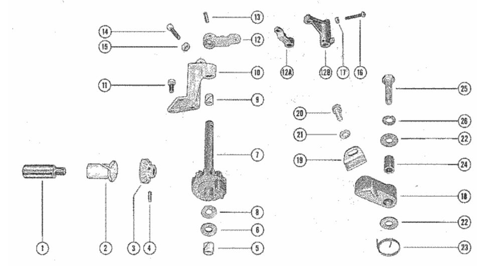

Yeah, #18, 19, 20, 21 are for the neutral limiting function, so you don't rev it up too much when it's in neutral.
The stop is adjustable so you'll just have to fiddle with it until it doesn't interfere with the throttle-up in gear.

I was looking at the throttle linkage diagram and one thing that hits me is the spring (part #23) for the neutral speed limiter follower (part #18).
From what I recollect about how this works, if the shift linkage isn't pushing on the follower, it's spring-loaded to move and interfere with full throttle when in Neutral.
When you shift, the gear on the shift rod pushes the follower out of the way and you'll get full throttle.
Or maybe it's the other way around and the gear pushes the follower into the throttle mechanism until you shift to forward.
I've attached diagrams for both throttle & shift, to aid the discussion.........ed

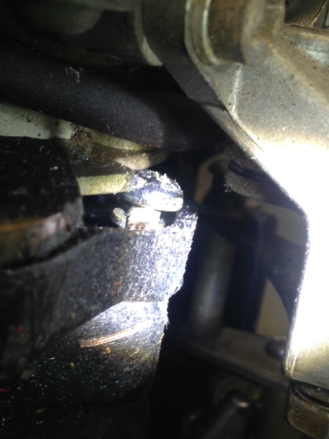

Mystery solved!!! Popped the top last night so I could get a better look. Pretty much saw the problem right away, just needed to figure out how to fix it.
Turned out that a screw under the stator plate had come loose and rotated itself out. I had to disconnect the condenser and coil wires, and I had just enough room to slide in a skinny phillips to tighten everything down. I didn't pull everything apart because I am a big believer in the "if it ain't broke don't fix it!" mantra - especially with 50 year old iginition systems. Everything looked to be in really good shape. I don't think there are a lot of hours on this motor.

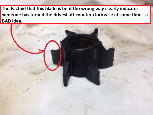

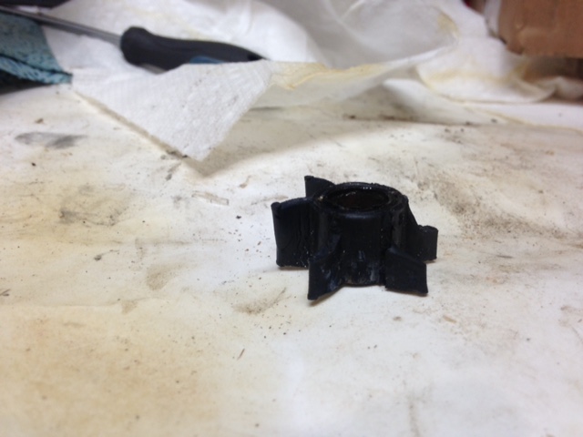

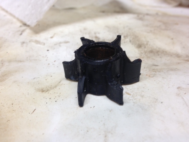

Finally got back to the 110 after having it staring at me forlornly for the last month. Dropped the LU and changed the impeller. After looking at the old one, probably didn't have to worry about it at all!! :ohmy: :ohmy:
Good thing I didn't run it too much and that the water pick up tube is too small for the impeller chunks to move through! I think all of the broken pieces were in the corner of the water pump and at the bottom of the pick up tube. (crossing my fingers!!!)

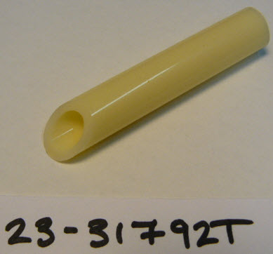

You might have missed the water tube into the pump. There is supposed to be a plastic guide tube that inserts into the pump discharge, it just slides in right on top of the rubber water tube grommet.
This guide tube lets you 'catch' the copper water supply tube as you're inserting the L/U. It'd be just about impossible to get the water tube in the pump without the guide tube in place.
With the L/U off you can blow a little air or flow water up the tube to check for circulation thru the block.

Here is one question that doesn't seem to be addressed in the manual - which way do the blades of the impeller need to be pointed? I matched what direction they seemed to be pointed when I pulled out the old one, but I am wondering if that is my problem. Should they be pointed for a clockwise leading rotation? If you look at my prior pictures of the old impeller, it is sitting in the correct orientation with the pin-hole on the bottom. It seems that the blades are pointing in a counter-clockwise leading rotation, so that is how I set it up.
I spent some time last night re-reading the manual for the install and looking at how the top of the water pump was set up. It seems like the blades should be set up for a clockwise leading rotation so that is how I set it up this time. Seems like a simple / stupid thing, but could that be the cause of my woes?

On the impeller, runs clockwise looking down at it. What I do is simple when putting on the body, turn it COUNTER clockwise and slam it home.
Re:Merc 110 10 years 1 month ago #127615
Mark, you know I'm not a Mercaholic but if the motor runs clockwise turn the shaft clockwise while you struggle with the impeller insertions. I always found it easier to do if you lube up the impeller with lots of dish soap right out of the bottle, sorta greases it up (keeps your hands clean also).
