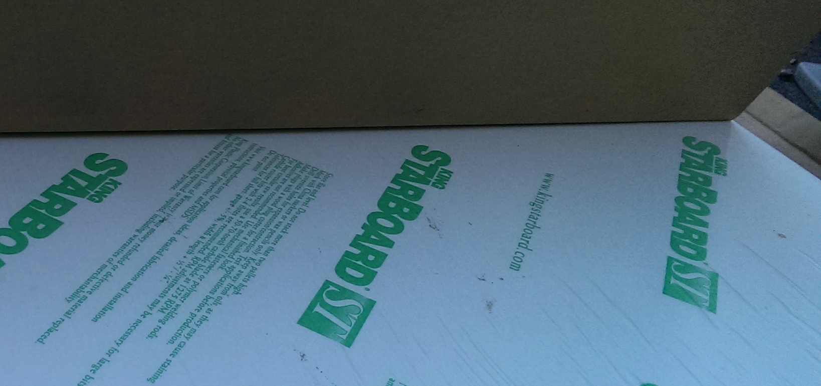

The floor is rotted on my mfg and this winter I'm replacing it.
Here is what I'm going to use. 1/2 inch plastic sheet. Wanted 3/8 but they only had 1/4 and 1/2.
Not bad for "free", huh?
Dan
68 MFG Chevron
61 Power Cat 18DC Tahitian
Re:1968 MFG Chevron New Sole 13 years 3 weeks ago #85023
how are you going to attach it to the boat nothing will stick to it
not even 5200

I started testing adhesives on this King Starboard.
I know nothing sticks to it, and the manufacturer says to use mechanical fasteners. But i wanted to see if i can make it work, even if i do not use it for the floor.
So i cut off a 2 inch strip and started playing. I had some 5200 on hand so i started with that.
Here is what they suggest if you need to use an adhesive.
1. sand with 120 grit
2. clean with acetone or similar
3. heat with torch, don't burn or warp just kiss it with the flame
4. let cool and apply adhesive.
So that's what i did. The directions on the 5200 say to wait a week after application. I've had it clamped for a week until today. I did 2 test points. One with plastic to plastic and one with plastic to wood.
Here is what i've found.
Dan
68 MFG Chevron

After a week the 5200 is cured around the edges where it seeped out. But, between the plastic it is still wet.
It took my weight leaning on the wood to part the bond between the plastics. About 210#.
Dan

So i tried prying apart the wood and plastic. It stayed together.
So i attached a pair of vice grips to the plastic and leaned on the handle.
The wood twisted but even putting my weight on the vice grips the bond did not let go! But the wood was about to snap. It's a red oak slat i had left over from building our kid's crib.
Dan
