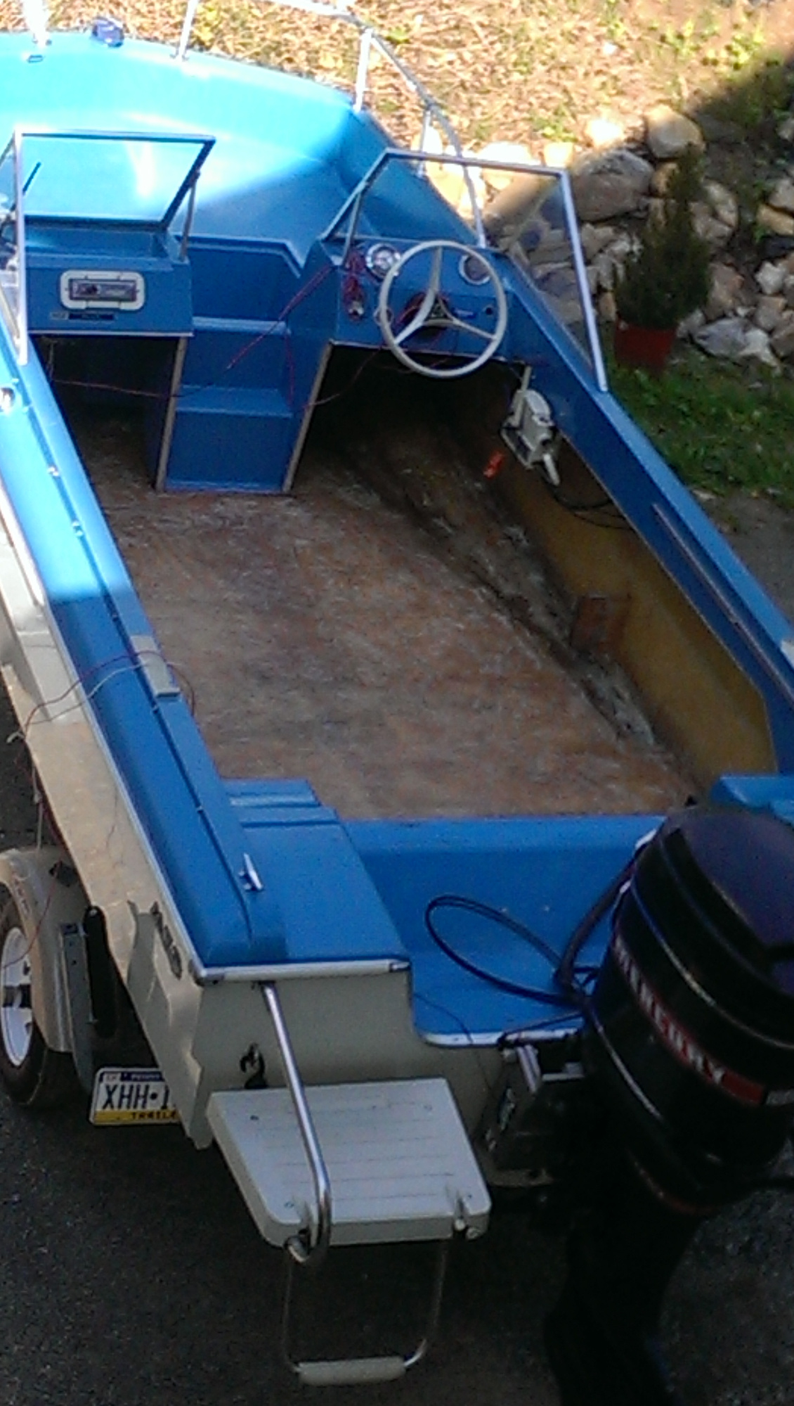

So the floor is attached! Did glass roving between any wood joins before i screwed it down. Then did roving around the edges of the plywood after it was screwed down.
The after it was dry i hit it with a sander to take off high spots and the wax.
But my fiberglass mat and started pouring resin today! As you can see it's all covered. After it kicked and set i went back with my grinder and scuffed it up for the carpet adhesive. Also took down any sharp or high spots.
Oh, and the wood blocks the side bulkheads attach to were not glassed, just tabbed to the hull. So i glassed those and made sure to cover the end grain.
I took everything out of the boat and power washed it. Got 99% of the dust and other junk off. Once it dries i'll put down the carpet!
Almost there!!!

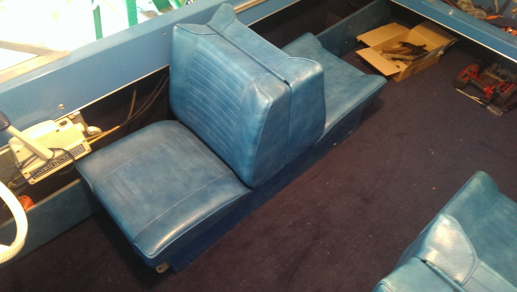

Cleaned the surface again before laying carpet. The carpet was a lot easier than i thought it would be. I ordered the marine carpet from online, and it was darker than i thought it would be. But i like the two-tone effect. Just hope it's not too hot. It's a dark blue, but not as dark as the pic.

Here we are a little further along. The gas tank is in under the port side seat. I bedded the screws and fasteners in 5200. Pushed some down the screw hole, and cut the carpet away from the area the fasteners sit and covered that with 5200, then screwed them down.
