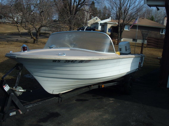

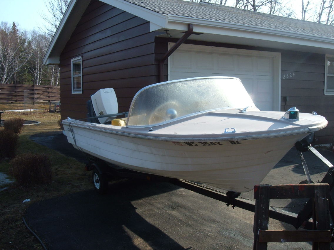

Here's some pics. I will post more as I go along.
1963 Starcraft 14' Ranger

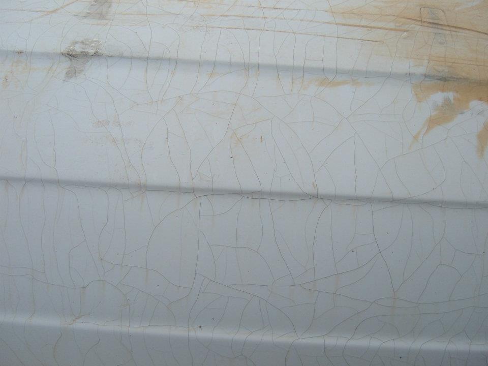

Thanks, 1969 Johnson 55hp Commercial.
I've been out sanding down the crazing and gel-coat. Just about ready to apply the filler, as soon as the temps get into the 60's.

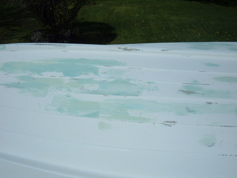

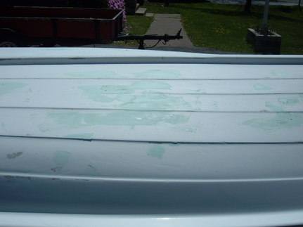

If you don't know how to use filler,.....You will learn fast!
Mix, Apply, Sand all of it off, and try again. REPEAT!!!!

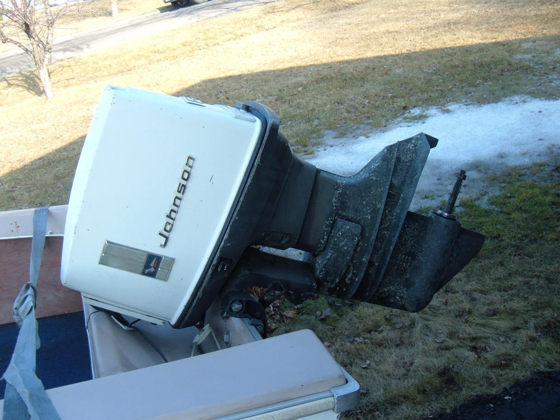

As for the 69 Johnson 55 hp. Well we did some wiring. Then replace impeller and some seals. Sanded down the ICKY white stuff, and sprayed some sealer on it.
Its probably not worth the effort (or money) to fix it, but I want to at lest try it out before I trash can it. If it works well enough then it will get the treatment later.

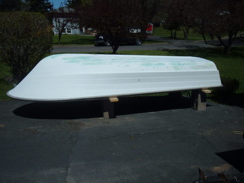

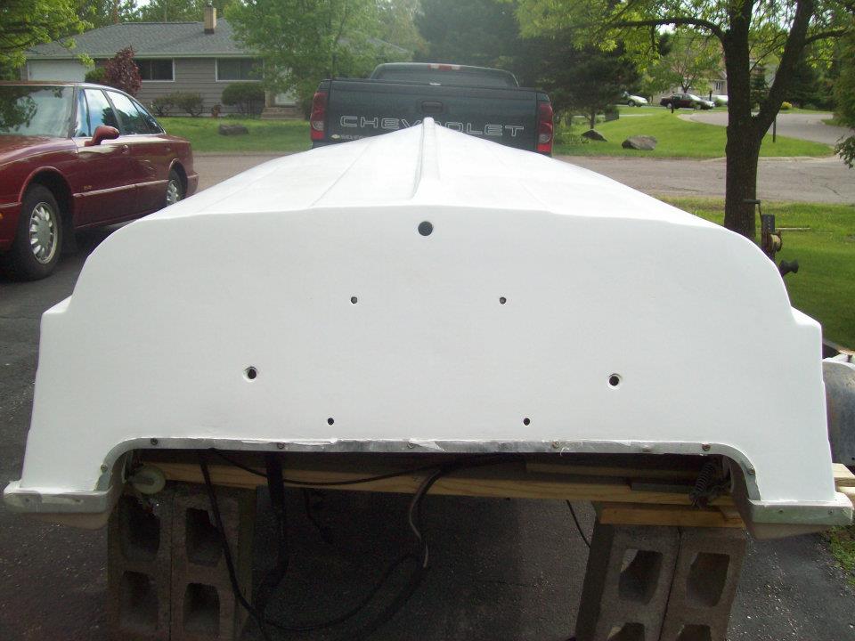

Finally a coat of GEL. Man do I suck at this. I thought the gel-coat would cover up some of the pin-holes and small scratches, but once again I am WRONG.
Remember kids ANYTHING you can see or feel WILL show up after the gel-coat. If you want it to go away you have to work harder at it.
P.S. Gel-coating with a roller and brush in direct sun light is a NO-NO..... Live and learn. Its only money and time.
Here's the proof. NO I'm not a proud boat owner. SHAME on me.
WANTED: Any extra Gel-Coat and Sand-paper I can get my hands on.

Good news I noticed this morning that the Gel-coat is starting to flatten out. The really bad areas are looking a heck of a lot better.
My spirits are much better after seeing this.....so back online to order more Gel-coat. Never give up....NEVER!

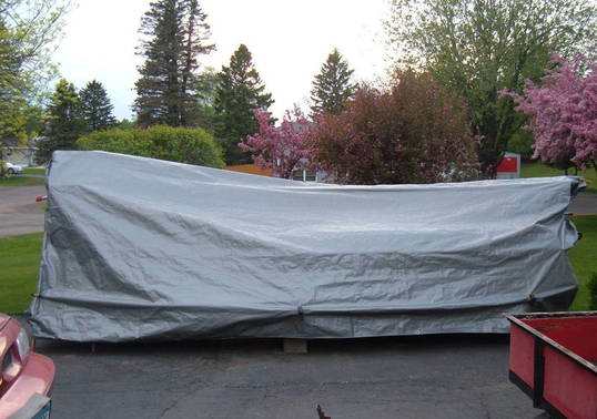

It's 85 degrees out no wind, and NO RAIN in sight! Looks to be a perfect time to apply another coat of Gel-Coat to the Starcraft.
Mix it up, brush it on. Step back. Admire my work. Then NEEEERTTT!
NEEERRRTT! The NOEL Weather Station in Duluth is under a Sever Weather Alert. Strong winds, hail, and heavy rain, are due in the area with in the hour.
WHAT????? Panic sets in. Run in the garage and grab the step ladder and dolly. Slip old conduit together to make a long pole. DUCK TAPE it to the ladder and dolly. Scream to the wife COME HELP!!!
Toss the tarp over it and clamp everything I can down. The temp drops to 65 degrees in 20 min. The skies turn UGLY!!! Please let the Gel-Coat set up enough so the tarp doesn't stick to the boat. Winds start to pick up a lot. Please, Please let the Gel-Coat hold up.
Scary Stuff!
15 Min. before
Man Lake Superior can suck at times.
Stay Tuned!!!

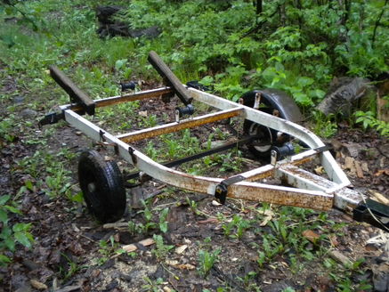

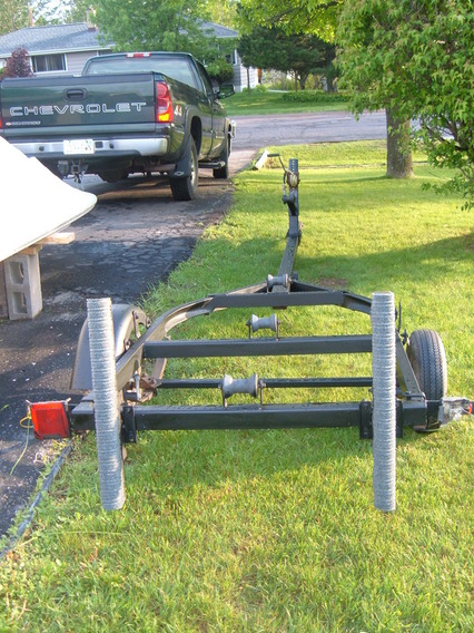

Made it through the storms, no damage to anything YEAH!!

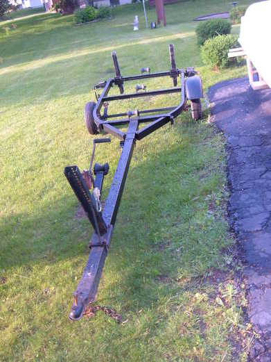

Found a trailer locally for $100. Not perfect, but not to bad.

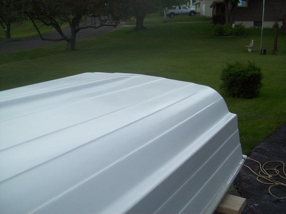

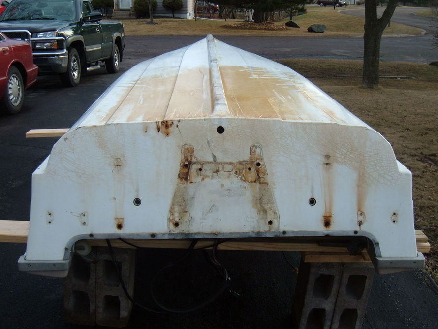

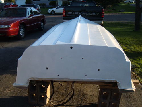

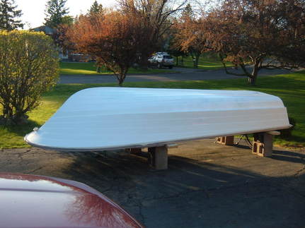

The start of the final polish on the Gel-coat for the bottom before flipping. Once again not perfect, but a heck of a lot better than it was.
CLICK ON THE PICS FOR FULL EFFECT!!
Before
After
Now I have to get fixin on the trailer so I can finely move it around. I'm like a kid at Christmas. I just can't wait to start on the upper parts. Those are the parts that people can see what you have done.
Never give up, NEVER.

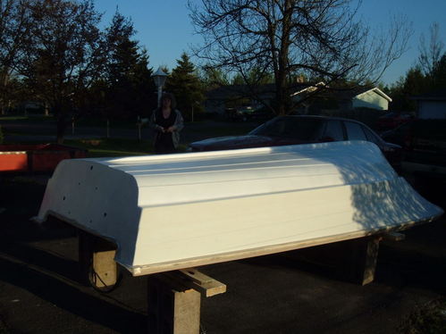

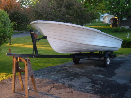

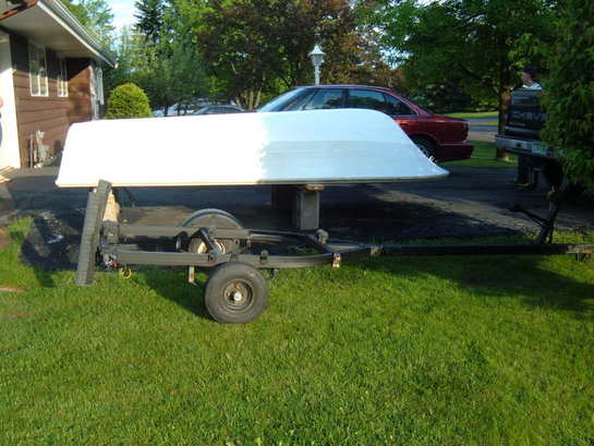

Starcraft date 06/04/12
The flipping fairies showed up!!!!!!
Not quite as nice as WaterWings. But once its underwater.......
Before the fairies:
After:
Thanks to Dan, Felicia, Cheryl & Don, and Heidi, The Flipping Crew

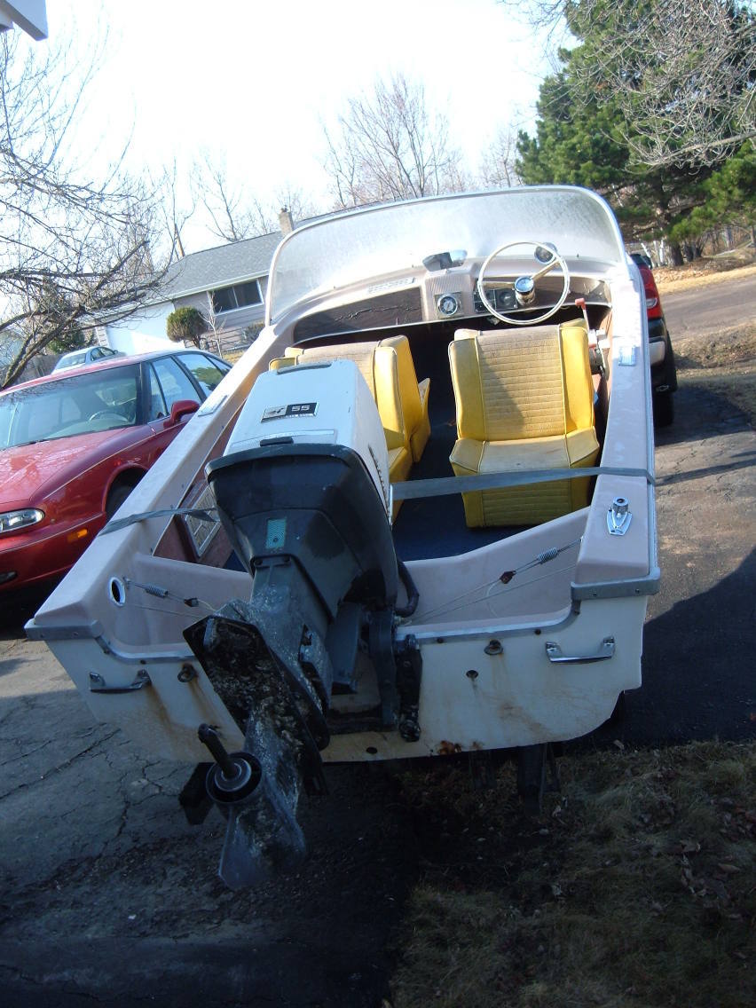

Update:
Mounted up my 1969 Johnson 55hp Electric Shift. I tipped it up and stuck the scag in the soft dirt and had my wife balance it as I tipped the boat up and backed it up to the motor.
Fit right up to the holes right away. No little blonde girls where hurt in the making of this boat (YET).
I got everything connected the next night. Then borrowed my neighbors water muffs and fired it up. It started up in about two revolutions and ran like new.
I couldn't get it to shift, but I found that I had a bad vacuum switch that sends power to the shift solenoids in the lower unit. Ordered up a new one, and its on its way.
I next bypassed the switch and found it still wouldn't shift, it just stays in forward default mode. Then I tested the wires for current and all was good. Then I tested the solenoids and they checked out good. Now I was just a little confused.
Went back in and read the repair manual again. Now it tells me I might have not lined up the rods in the solenoids right. DANG IT!! Now I have to pull the lower unit of again (3rd time) and reset them.
Well this time I think I will try and do it blind folded, that way if it still doesn't work I will have a better excuse as to why.
Stay tuned kids....... This could get ugly.
P.S. If this Johnny doesn't start behaving soon I might have to send it to Uncle Neil's, so he can use it for target practice.
