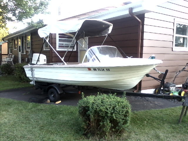

Star-Date: Aug 02,2012.
I cut the width of this Bimini top down a foot to fit on the Starcraft.
Should I just leave the cloth this way, or have a foot taken out of it also? :unsure:

littlefin, don't those tops catch alot of air? sure would be nice to be under one of those on a hot sunny day tho. frog

Yes they do! But you can use them as a extra power source if the wind is blowing.LOL.
We have only been out long enough to use it once, but it sure was nice to get out of the sun.

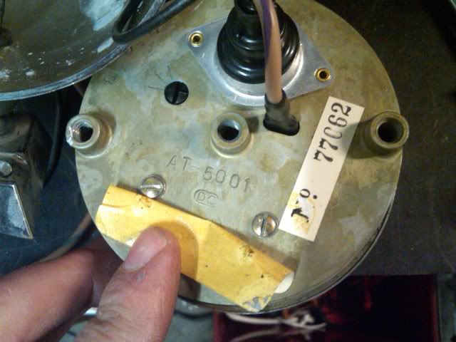

Littlefin, Do you know what # is on your tach? I ran into the same problem that you are haveing with yours. It is next to impossible to find the correct tach for 68/69 jonnyrudes. The one that most people get is the wrong one even though it is advertised for that yr. It only reads about half the RPM. so when you are going flat out it may only read 2200/2400 rpm or there about. As far as I have found out these are suppossed to be the only 2 yrs that have a hard to find tach. Skip.

Re:1963 Starcraft 14' Ranger Project 14 years 3 months ago #66504
  • littlefin
  • littlefin's Avatar Topic Author
  • Posts: 397
  • Karma: 14

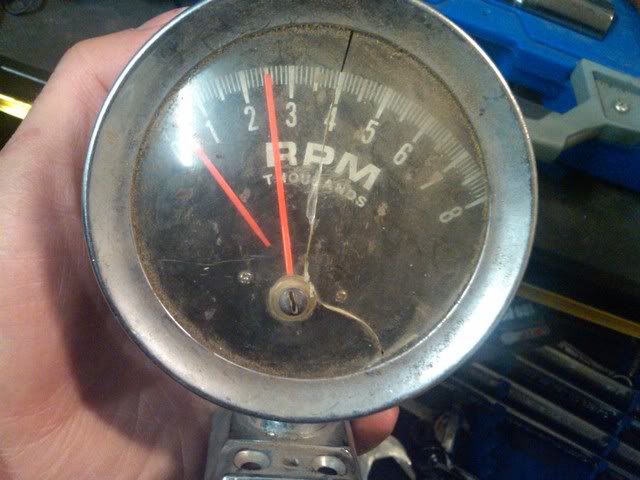

Okay. I found the little switch for 4-6-8 Cyl. on the back of the tach. (Didn't think to take it apart last time DUHH!)
It is a Leece-Neville AT-5001 tachometer (also know as Dixco). The switch is set for 6 Cyl. I have a 3 Cyl 1969 Johnson 55 hp. The tach reads 2000 rpm when the engine is going around 4000 rpm.
Anyone see the problem here yet? Logic would state that you should use the 6 Cyl setting for a three cylinder, BUT logic would be wrong.
Do I need a different tach, or does someone know a way around this little problem?
Lost in the Land of 10,000 Lakes, 25,000 rivers, 50,000 swamps, and one heck of a lot of wet feet.
Mine looks like this one. (Only a little bit better)
Re:1963 Starcraft 14' Ranger Project 14 years 3 months ago #66519
Littlefin, I don,t think that will work for you. I have a Airguide Model 1029-1039 Series 10 style tach that I was told by a evinrude mech was the right one for 68-69 rudes and johnsons. Well aftre I asked him why it only reads 200rpm wide open he said first off I didn't know how to read a tach and then that my tack was not wired right. I have finnally figured out that it will only work on 1976 and up 55 hp. engines. The idea that a 6cly should work on a 3 cly just dont work.I am chasing down another leed on a tach that is suposedto be the right one. If it pans out I will let you know. One thing I havefound out about this tach problem is that there are very few people out there that will talk about them, I guess they are ashamed of owning one. Have fun, i know I do at 30 mph and 1850 rpm. :P Skip.
Re:1963 Starcraft 14' Ranger Project 14 years 3 months ago #66524
Here is a list of years that my tach the 1029 is supposed to fit.
55E76-77, 55EL76-77, 50ES71-72,-73,-74,-75. I can't find any info on your tach at this time. Maybe someone out there may know which tack you need for your motor. Skip.
Re:1963 Starcraft 14' Ranger Project 14 years 3 months ago #66548

Thanks for the help Skip. I think I will just take it off, and patch the holes in the dash.

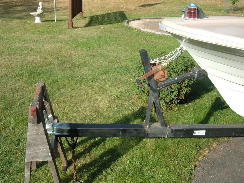

Update:

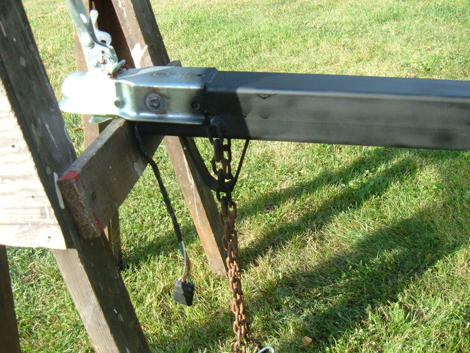

Just went over to my nephew's place and had him replace the tongue end of the boat trailer. He did a perfect job as usual. But I forgot that we were going to lengthen it by about a foot. When I ran the electrical back through the frame it came out about 6" to short.
My boss Jerry had a good idea to get a short jumper harness so if the end gets messed up I can just switch it out. I like that idea, so now I can tell everyone that is how I had planned to do it from the start. :laugh:
Here are the pics:

Re:1963 Starcraft 14' Ranger Project 14 years 1 month ago #68931
Beautiful weld job! My welding technique requires a lot of grinding after.
Re:1963 Starcraft 14' Ranger Project 14 years 1 month ago #68932

You do that Frog! :)
Sabre;
I agree with the welding. But he is the foreman for a very large crew of welders. Other wise we all know I could do just about as go of a job myself. Or maybe NOT!

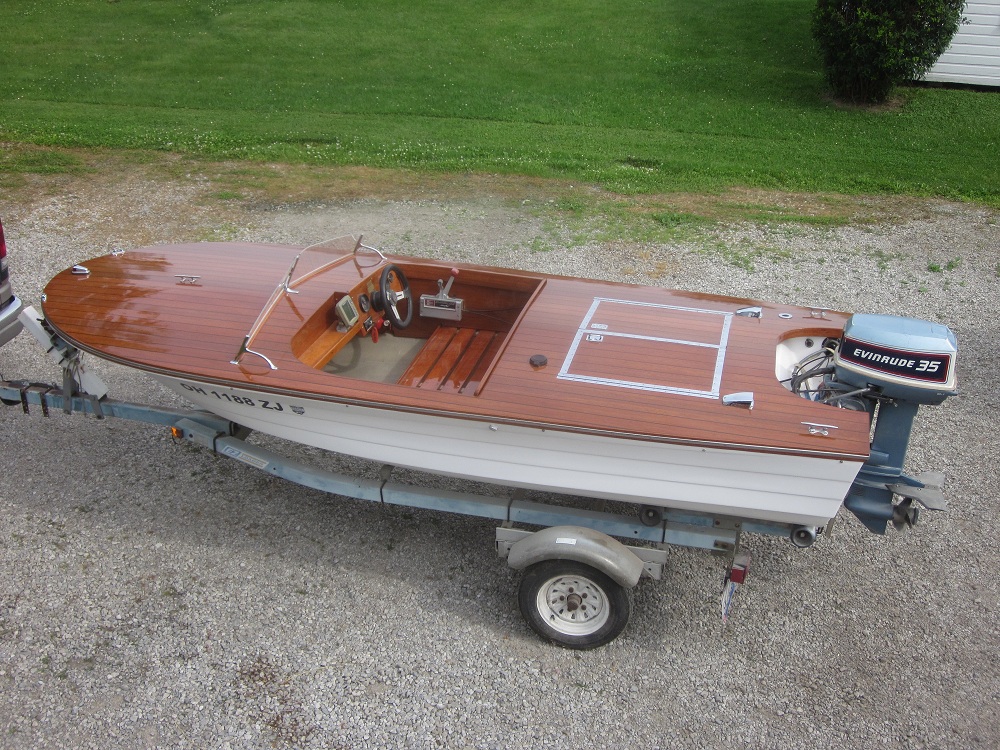

Re:1963 Starcraft 14' Ranger Project 14 years 1 month ago #69047
My Dad and I did a project on a similar Starcraft about 20 years ago. his idea was to make a cute little boat that reminded him of a classic mahogany runabout. We found the Starcraft hull in a scrap yard, and went at it. After some 20 years, a complete rebuild was in order, and I did the work by myself since my Dad has since passed away. I completed the project last spring, and we are still having a blast with the cute little thing!
Re:1963 Starcraft 14' Ranger Project 14 years 1 month ago #69048

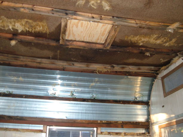

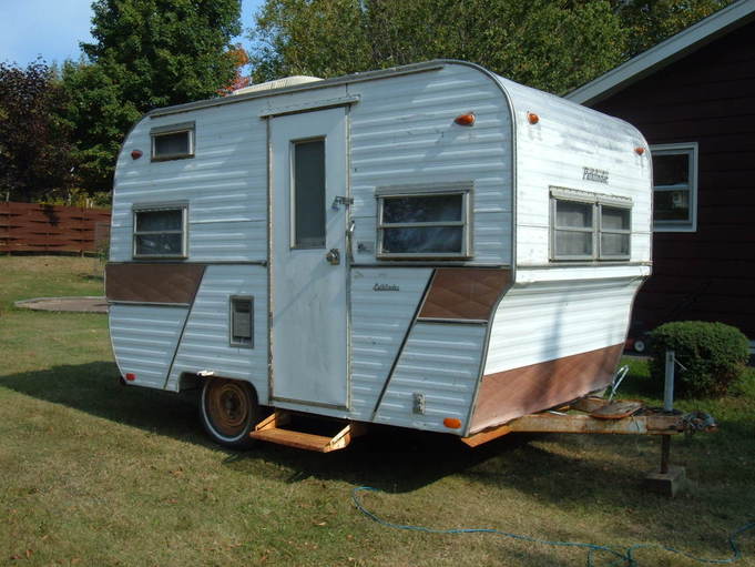

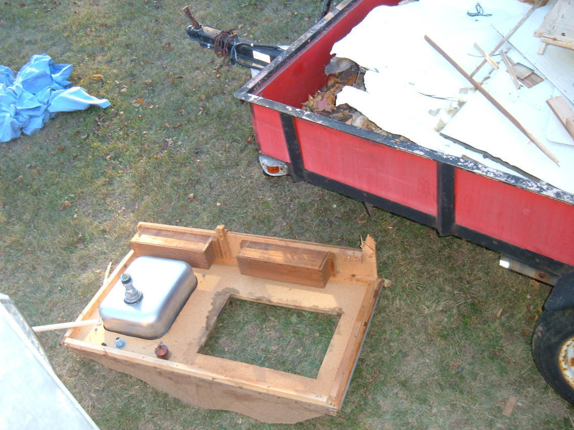

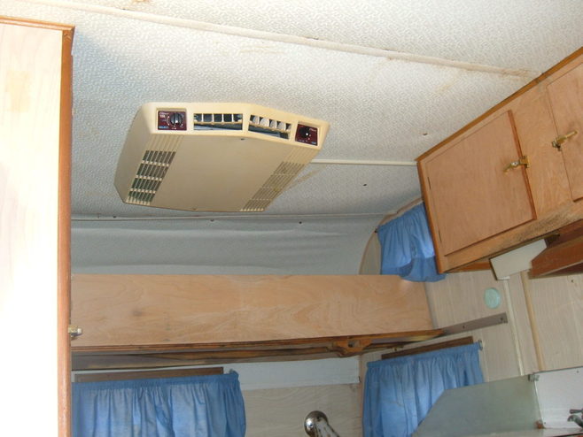

Blue-gill. You won't need anymore inspiration. Once you start seeing everything come together, you start to work faster and longer so you can use it. Just don't get going to fast and get sloppy.
Oh yea. I bought a 12' Pull Behind camper to redo. Its a total gut out. The roof A/C someone added on, was to heavy and collapse the roof. A total P.O.S. but just the kind of challenge I like to take on. It will look real cool sitting next to the StarCraft.
To many projects, so little time until freeze up.
I just built a roof over the StarCraft and tarped it off for the winter. Snow load ya know.
Well I will be back on soon. But for now wish me luck. If you ever seen me shoot a bow you would know why I need the luck.
Here's some pics of the trailer:
1971? 12' Pathfinder Travel Trailer Camper
Even the Kitchen Sink.
Ever so slight redo of ceiling.
