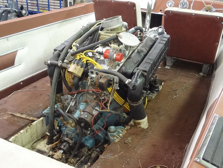

I finally got to put in a long day on the little Resorter I picked up about a month ago.. The little boat mostly needs a lot of TLC, replace old original rotted hoses, repair some rotted seat bases and give the gelcoat a good buffing..
Here's a few pics taken on the rainy day that I brought her home..
100_2645 by cc_john67 , on Flickr
100_2646 by cc_john67 , on Flickr
100_2647 by cc_john67 , on Flickr
100_2648 by cc_john67 , on Flickr
Today all the seats & bases came out along with the gas tank & support platform.. The tank had to be removed to access the bolts for the swim platform brackets and the exhaust connections at the transom.. One of the platform brackets was loose because the plywood backer had rotted out.. I also plan on removing the exhaust fittings from the transom and everything else below waterline in order to replace the old 40+ year old bedding compound..
The boat had a bent rudder from a driveway strike, so after the tank was removed, I dropped the rudder & pulled the rudder port.. The rudder has a pretty healthy bend in the stock right at the blade and the rudder port had the spigot snapped off.. Tried to straighten the rudder in the press but the stock ended up cracking right where it enters the blade.. Looks like I get to order a new rudder & port from A&A Marine to the tune of $775.. :( I also pulled the propshaft out so I can replace the original rotted stuffing box hose and cutless bearing.. The prop, shaft, & coupling will be headed to the prop shop to be reconditioned before being reinstalled.. And the trailer will be getting the bunks readjusted to give the boat a bit more ground clearance before the drivetrain is put back..
100_2657 by cc_john67 , on Flickr
100_2659 by cc_john67 , on Flickr
Got a couple of small electrical problems fixed too.. The bow light was in really bad shape internally and didn't work, the rear flagpole/sternlight was missing and a cheezy looking LED light had been installed on the transom.. My first of what will probably be many orders from A&A Marine came in last night, I got a new OEM bow light and sternpole, along with the parts to rebuild the sternpole socket.. I got the sternpole socket refurbished and reconnected to the boat's harness, then moved forward to replace the crumbling bow light.. After installing the new bowlight, I plugged the sternpole into it's socket and turned on the navigation lights.. Every thing worked without even the slightest hint of smoke.. ;) :laugh:
All in all a very productive day..

Pulled the little Century over to the shop Saturday morning, backed it under the overhead gantry and pulled the engine out of it.. Loaded the engine in the back of my service truck and brought it home to tear it down so I can replace all the old, failing seals & gaskets in it and give it a fresh coat of paint.. Once I got it home, I picked it out of the back of the truck with my engine hoist, removed the transmission & bellhousing and bolted it to the engine stand for the teardown..
Here's where it's at as of Sunday night..
100_2679 by cc_john67 , on Flickr
100_2678 by cc_john67 , on Flickr
100_2677 by cc_john67 , on Flickr
100_2676 by cc_john67 , on Flickr
100_2680 by cc_john67 , on Flickr
The old engine doesn't look too bad inside for having just over 700 hours on it.. The cylinders still have visible "cross hatch" from when they were originally honed, and have no sign of a ridge at the top of the bore.. The timing chain & gears have been replaced recently and a high quality full double roller chain & gear set were installed.. As soon as I drain the oil, the oil pan will be pulled and the crankshaft removed to replace the rear main bearing seal..
The engine wiring harness had some damage from a shorted diode in the alternator, the alternator output wire had melted and burned thru the loom wrapping the harness.. I stripped the loom and the fried output wire from the harness, I'll install new wire to replace the damaged circuits and add a couple of new circuits for the electronic ignition conversion and electric choke before rewrapping the harness..
