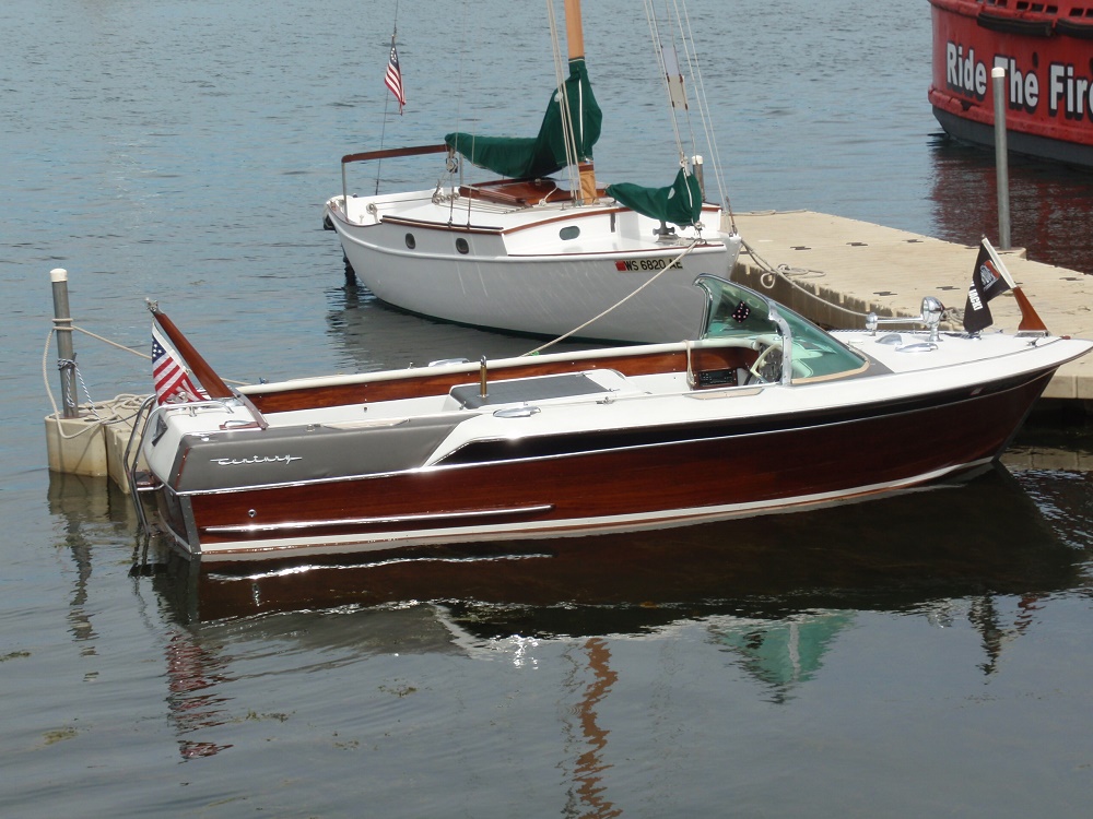

Larsspar wrote: That's beautful work! I agree....I love the cleaner lines and the MOPAR badge personalizes it nicely.
I appreciate you sharing your materials and techniques.
Can't imagine how you can ever let go of it.......
You're more than welcome!
I don't ever plan on getting rid of it, this little Resorter is my "forever boat". It's going back down to a great fiberglass shop down in Kemah, TX in the fall to get all the really bad dock dings, battle scars from a previous trailer, and all mounting holes for the now removed swim platform repaired, Once they finish glassing up all the holes and matching the gelcoat, I'm also gonna have them strip the old boot stripes off and cut and buff the entire boat before installing a new set of stripes. Once my bank account recovers from that hit, I'll be getting a reproduction upholstery kit from A&A Marine , to get the interior restored to original condition.
I'm not much of a fan of modern boats or vehicles, if anything I just tolerate them.. Anything built in the last 30 years is just too homogenized for my tastes and loaded with more technology than is needed for a long, trouble free life.. To me, most modern vehicles and boats have all the personality of a cheap toaster from Walmart. :sick:
I wanted this boat to be my "time machine" to take me back to my childhood in the early/mid 1970's when I remember these boats when they were brand new. It does exactly what I want it to do every time I sit behind the wheel, turn the key and hear that little Mopar bark to life.. B)
And there is just something so entertaining and satisfying when cruising along at 25-30MPH, snap the throttle wide open, hear those secondaries open up on the 4-barrel carburetor and feel the seat back try to force its way through your spine while watching the speedometer rocket towards 50+ MPH! :P
CC-John
1973 Century Resorter 16, 225HP Chrysler LM318
1978 Chris Craft 251 Catalina Express, 330HP Pleasurecraft 350 (383 Stroker)

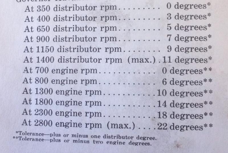

From my experience with small block Fords over the years, with the compression you have, you'll be feeding that little Windsor premium fuel to keep detonation at bay. Depending on how many hours you'll actually run the boat every season, it may be worth feeding it 100LL (low lead) AvGas. Here in Texas, there's no restrictions on using AvGas in any other off road vehicles, the only restriction is being able to stomach the buck or two per gallon more than premium unleaded from the corner gas station. I'm seriously considering feeding my old Chrysler 100LL as I'm growing weary of all the additives that have to be added to automotive gas to stabilize it and to protect the fuel system components from the corrosive effects of ethanol. Based on what I've been able to find out, 100LL Avgas is the closest thing available to the gasolines these old marine engines were designed to run on back in the late 60's and through the late 70's. You can find a local FBO in your area, with current prices at this website.
> www.100ll.com/
If you're gonna stick with booze laced fuels, get your mixture dialed in FIRST before messing with any timing adjustments. Set the ignition timing by whatever MerCruiser's specs were and make a few runs, read the plugs and get the mixture dialed in. Also, these engines were setup a bit on the rich side from the factory because of the heavy loading these engines see in marine use. Most were setup with an A/F ratio of 12.5 to 13:1 compared to the common 14.5 to 15:1 in automotive applications. A slightly rich mixture not only burns "cooler", but it's more resistant to detonation under heavy loads. On your old Holley carburetor, if it has the thin metering plate instead of a full metering block on the secondary side you may have to invest in a set of jet drills to enlarge the "jets' in the bottom of the plate.
Once you get the mixture where you want it and the engine will accelerate under load without any "lean bog", then start playing with the spark advance. More than likely, you have an old Prestolite distributor same as my Chrysler, you might be able to use the same advance limiter plate I use in mine to limit total advance without having to permanently modify the distributor by welding up the advance slots. I got mine from FBO Ignition . Might give them a shout and see if their plate will fit your distributor. When dialing in the timing, bump it up in two degree increments to creep up on the proper amount of advance to give you crisp acceleration without any "laziness". That will become your new "initial" advance setting when checking it at idle speed.
Here's the distributor timing curve from my Chrysler Marine service manual for my LM318. Most small block marine engines will run a similar advance curve.
While having a distributor machine is nice, a good digital advance timing light will tell you all you need to know. As my grandpa used to say, "We ain't sending it to the moon son"..:lol:
Most marine engines run a 160 degree thermostat on closed cooled engines, the 140/145 degree is generally for "open" cooling systems as the cooler temp prevents scale buildup in the water jackets when the engine is operated in salt or brackish water. Check your service manual as some marinizers specified a cooler heat range spark plug for engines equipped with closed cooling. My Chrysler manual specifies a plug that's a couple heat ranges cooler than the plug listed for the open cooling systems.
The "max RPM" listed for these engines in the manuals is just for sizing propellers so the engine is properly loaded. The designed continuous "cruising" RPM for most of these old engines is 3000 to 3500 RPM, the cam grinds in these engines were chosen with that in mind. Also, on your first outing to break in the engine, make a note of your WOT RPM. If your max RPM is a few hundred RPM over the max, you'll need to either get that prop repitched or source a higher pitch prop to bring down the RPM's before diving into fine tuning the engine. A good rule of thumb is one inch of pitch is good for a 250 RPM change. My old Century's OEM prop (13x13 3-blade nibral) was pretty close to spot on before I "massaged" the heads and manifolds. The first trip out, it spooled up to 5100 RPM before any jetting or timing changes, max WOT range for my Chrysler is 4000-4400. Added 2" of pitch and heavy cup to the original prop and that pulled it down to around 4500 WOT so I could begin dialing in the mixture and timing. After getting everything dialed in, I've picked up another 300 RPM at WOT, maxing out at 4800 now. Fixing to order a 13x17 3-blade Nibral so I can dial in the Max RPM to about 43-4400 RPM lightly loaded..
Oof.... Didn't mean to write a friggin novel! :blink: :laugh:
Hope some of this helps!
