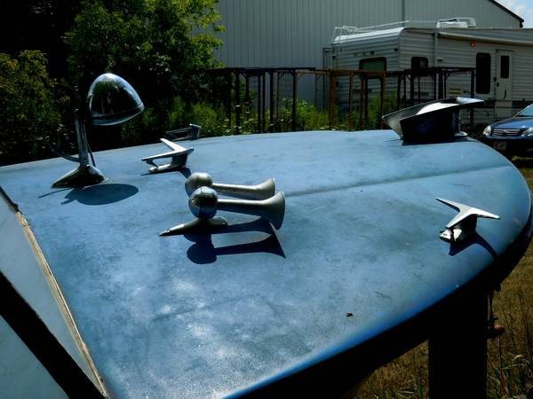

Here's a pic of the jet/rocket deck fittings. They have silver paint on them which seems to flake off with a fingernail, hopefully the paint stripper will do the job nicely. Chrome underneath, not perfect but with some "patina" . . .

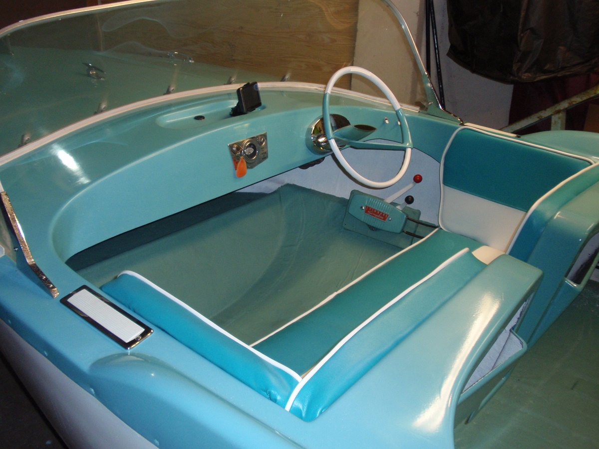

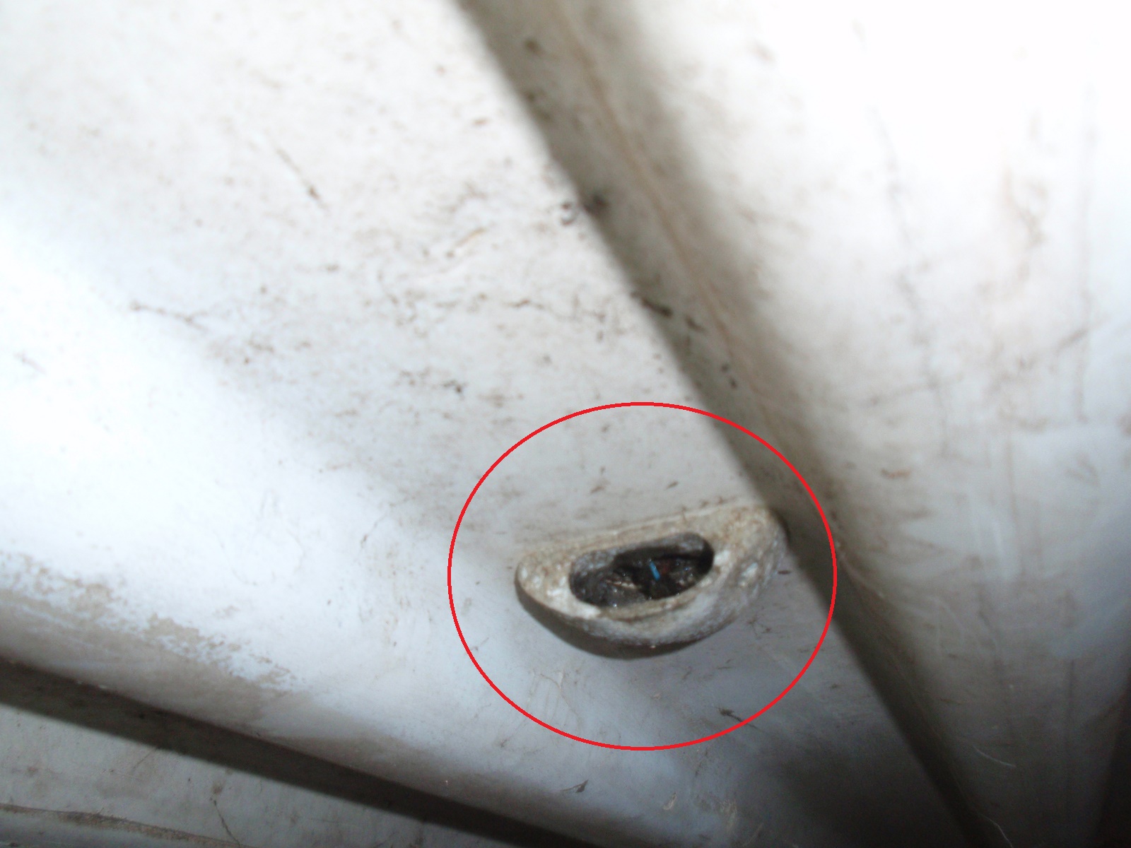

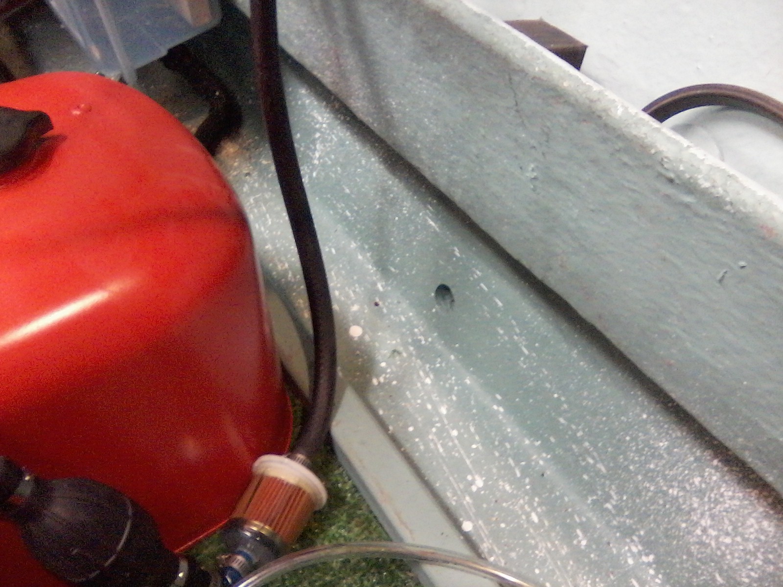

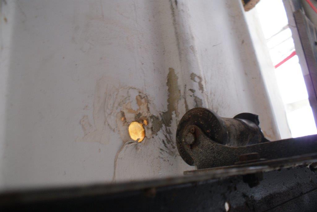

OK, So I finally have the Rocket home and am able to do some closer inspection. I think I need a little anatomy lesson. There is a drain at he bottom of the transom. There is no corresponding opening on the inside. There is a raised portion of the floor the extends from the transom to under the rear seat. Is this a foam floatation compartment? Also across the inside of the transom is an elevated tray that extends from side to side. Is this a splash tray? I did find 2 drains in the bottom of it, I assume that is original construction, along with the floor elevation? Why would there be a drain hole that leads into a flotation compartment? The transom seems to have been re-enforced with a steel strap (3" wide, 1/4 " thick) and a "plank" reaching across the whole transom across a cut out, perhaps to accommodate a long shaft engine? I'll get some pictures...
Re:60 Rocket Restore 9 years 8 months ago #130781
Lets see if we can help you out here. Yes there are three sealed chambers on that boat for flotation. One in the bow area floor, one under the front seat area and the last is that portion that you described under the rear seat towards the transom. There are two drain holes. One would be what you described on the lower transom, this drains any water that would accumulate in the aft area by your fuel tanks etc. It should be transom floor level. Lower center red circle.
The other two smaller holes lead from the motor splash well area, yes that is your splash "tray", these drain any water that would back up over the transom say while you were backing up in rough water, these stay unplugged.
There is no drain leading into the flotation area. There should be on the floor just about under the port rear seat a brass screw plug that leads directly through the bilge to the water. This would be like an auto baler that would suck out any water in the boat while you ARE UNDER WAY ONLY!! or if you are trailer-ed.
Can't help you with the "plank". A long shaft motor would take a 20" transom measured from the top of the transom to the bottom of the outside. Short shaft would be around 15". It could be different in some areas, might be it just needed reinforcement for the PO's peace of mind.

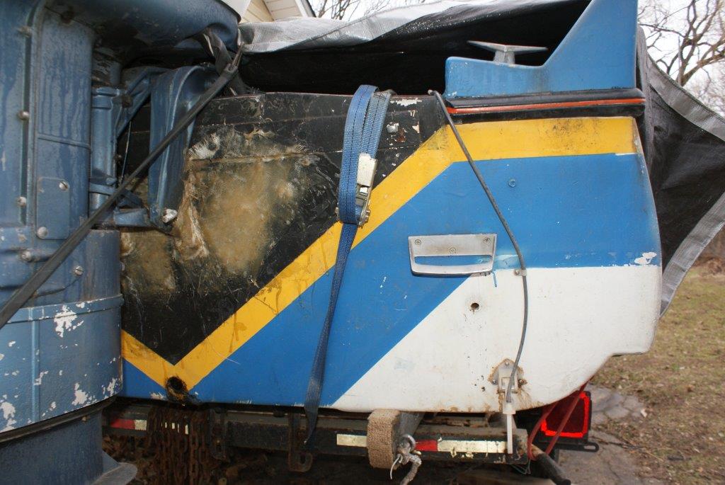

OK, Thanks for the great info and pics, awesome! This is getting very interesting. The profile of my transom is just a straight line, no ribs on the bottom as on yours. I'll look for a "tunnel" drain hole under the rear seat. Now for a little problem, there is a hole in that rear elevated area, water has definitely been allowed to enter... Pictures will help...I don't recall the ribs on the bottom, maybe a different model year? The rear seat/brass plug/auto bailer, seems to have been removed and glassed over. And in another thread, you mentioned a hull number plate on the transom, I suspect mine may be under the plank. Again, I'll send some pictures . . . but I'm not home now...
Re:60 Rocket Restore 9 years 8 months ago #130784

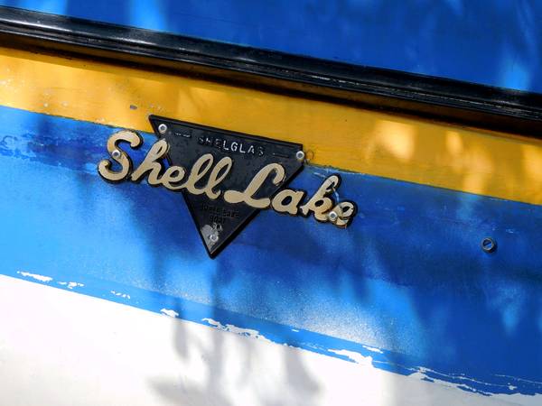

The Rocket that I have is a 1960 model. Late 50's to early 60 had very similar designs with some subtle changes. Mine was originally registered and titled as a 1958. After doing the research I found out that the only year they offered the "azure blue" color and the bow light/chock/cleat setup was 1960 and that is what I had. So I can give you some generality info but details might be different.
Go to the Glassic Library above and page through the brochures for the years and models, that will probably nail it down better. If you had maybe a '58 it could have originally been set up for a short shaft.
follow this link.
www.fiberglassics.com/library/Shell_Lake#1957
Re:60 Rocket Restore 9 years 8 months ago #130785
I was thinking 1960 because of the azure blue color under the pained surface, but now that it is home I see some chafe/wear spots and under the azure blue it seems to be white. I'll have to get to the bottom of this as well. I assume the azure blue in 1960 was the gelcoat color, not just a surface paint. And again thanks for your responses. My bowlight is different also, a red/blue lens combination, with a 'finned' chrome housing. see pic.
Re:60 Rocket Restore 9 years 8 months ago #130788
Boat manufacturers used different hardware through the years. That bow light is cool, definitely a keeper.

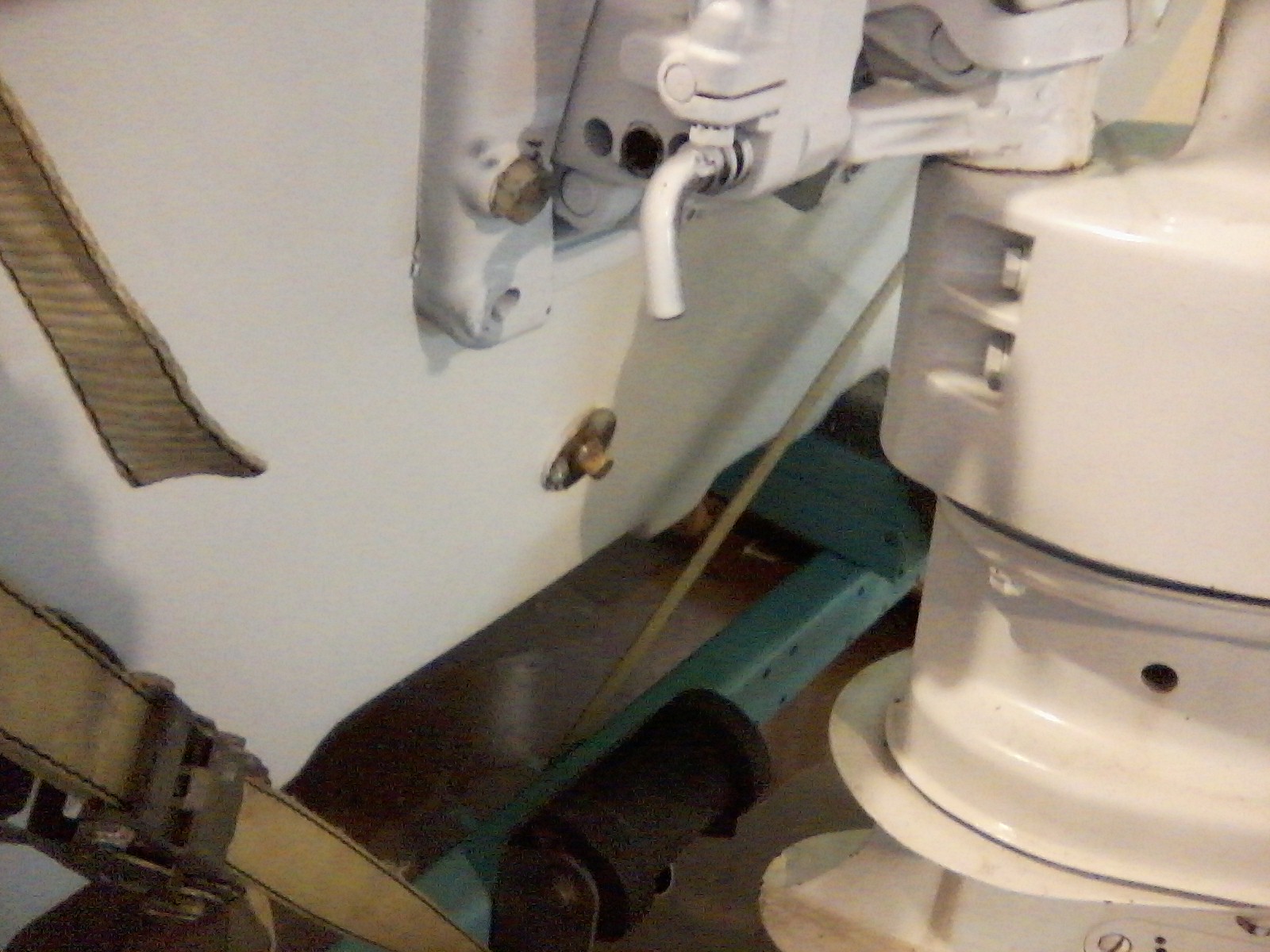

transom

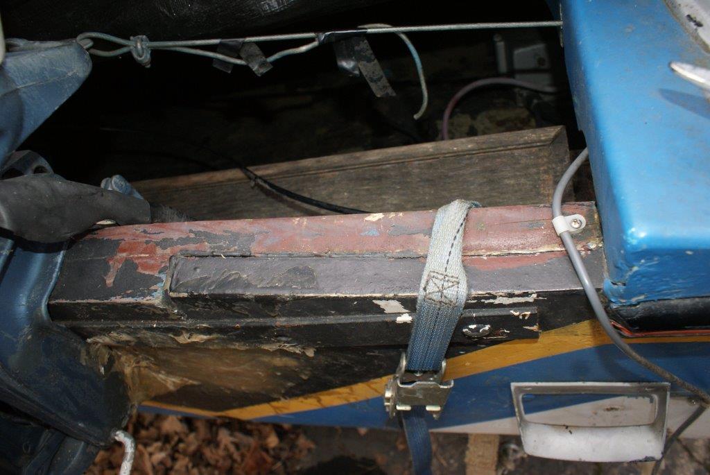

Looks like someone increased the height of what looks like a 15" short shaft transom so that a long shaft motor could be used (and perhaps helped them keep water from coming over the back with increased height). Maybe that is where the patching and bracing came from. It doesn't look like they didn't quite make a 20" transom to fit the industry standard long shaft height...however, depending on one's own ideas or needs, people play with mounting heights (within sensible and mathematical reasons mostly) to best suit their own specific circumstances. That is another topic for the experts to weigh in on.

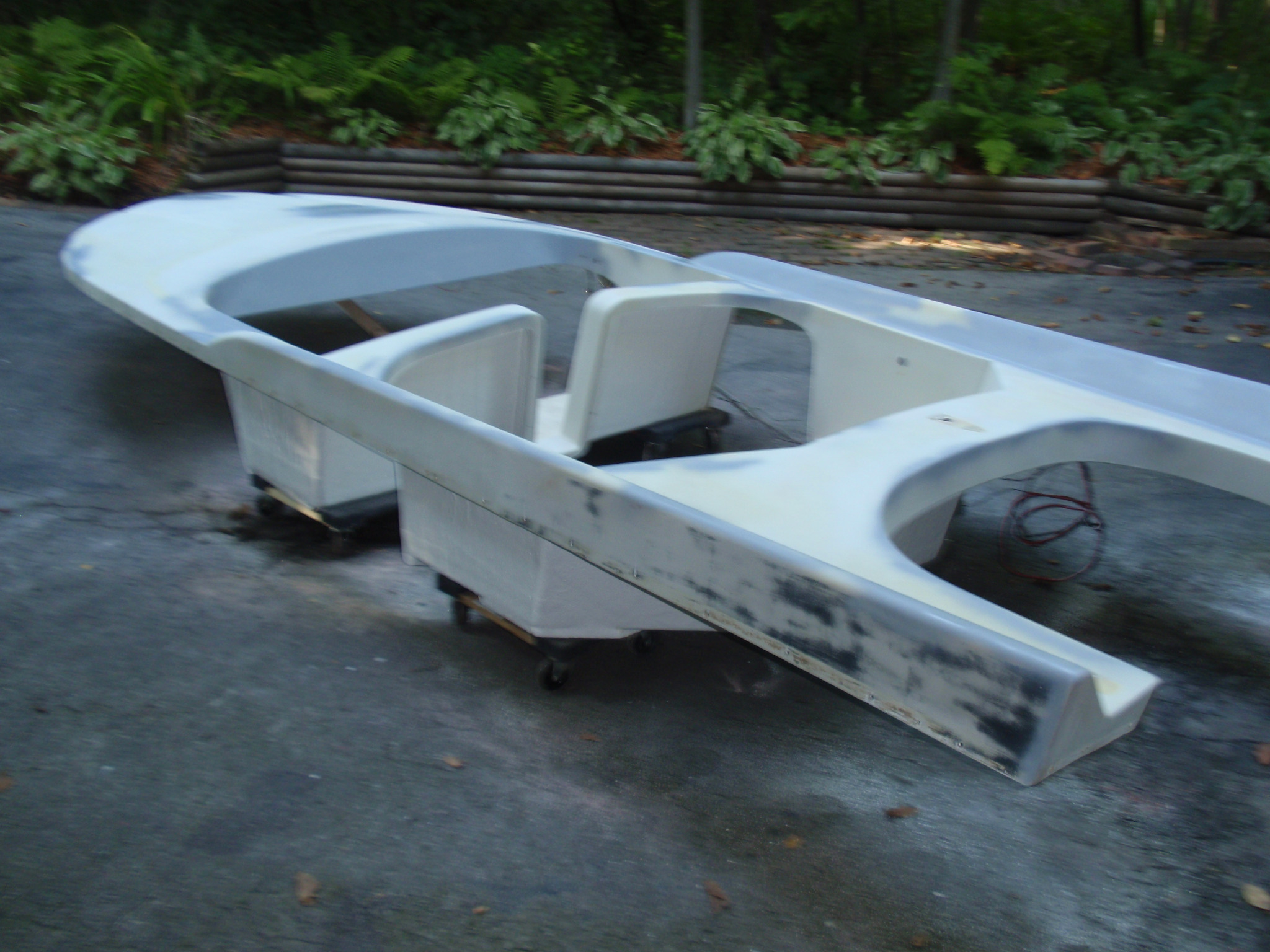

I have noticed the '60 Rocket has 3 ribs on each side of the bottom, and they extend into the transom profile. MY Rocket, has only 1 rib on each side and the keel in the center. The ribs and keel are tapered toward the aft and only show a small "bump" in the transom profile. Does anyone have info about what year ('57,58,59) this would be? Also, a PO tried to put a drain hole in, but only drilled into the flotation compartment. There is no drain in the aft bilge area (unless it has been filled and covered over), nor under the front seat. Let me know. The library does not have these details posted. Also there was a self draining scupper amidships that has been removed.

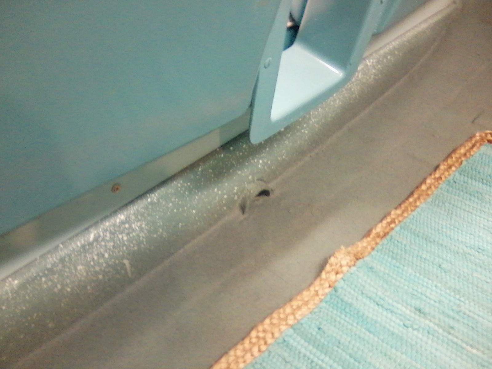

Re:60 Rocket Restore 9 years 6 months ago #131268
I did some responses in the other posting that you answered for me about the generator output.
Here are the pictures I was talking about. The "culvert" under the front seat leading to the back seat area. The rear seat scupper that would bail under way or while on the trailer. The inside of the transom drain hole and where it is located on the outside.
I do believe you have a '58 since yellow was a color for that year.

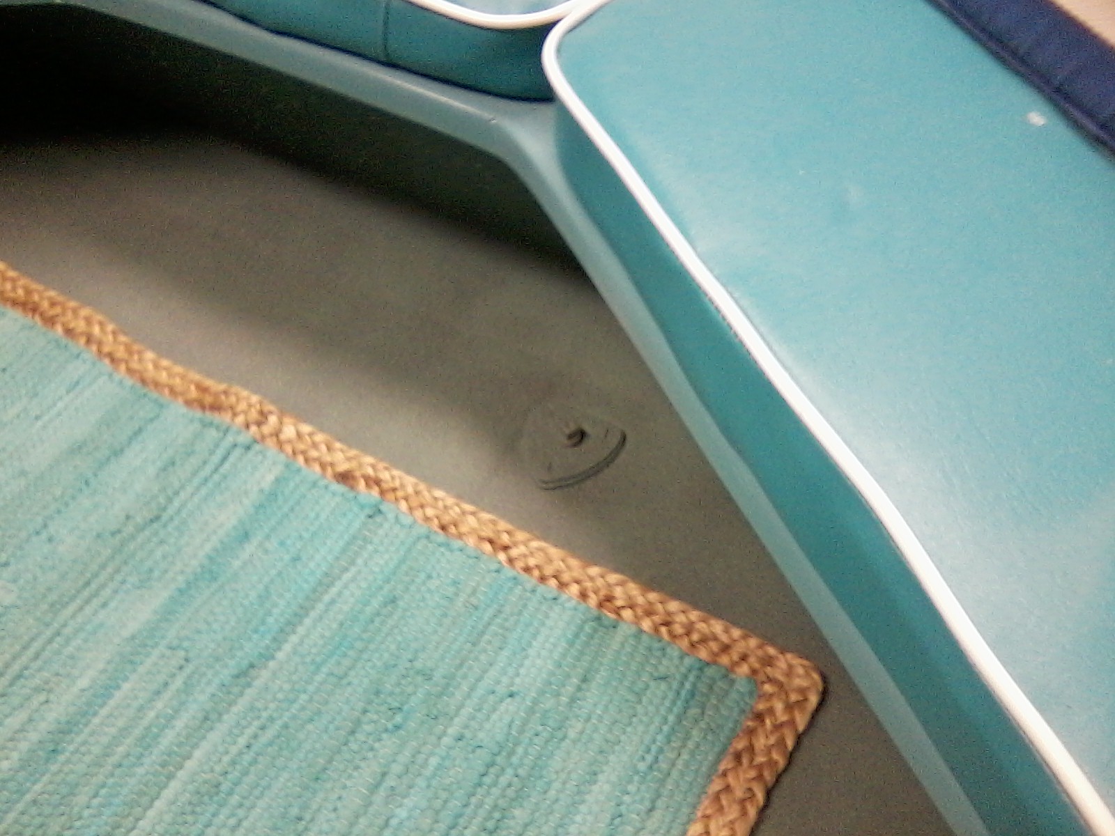

ok, the boat floats, and the engine runs (not perfect but...). So as previously mentioned, there is no drain in my boat. the original fitting in the bottom ahead of the "trilateral seat" has been removed and glassed over. the patch does leak a little and does not seem secure. I would like to return to the original fitting in the bottom. Does anyone know where to find one? I don't see it on ebay or google/bing searches. let me know if you know something. Thanks!
60 Rocket Restore 9 years 2 months ago #133780
Maybe craigslist for a parts boat? Two weeks ago I found another rocket about 35 miles from me that was sitting by a cornfield for almost 30 years. (avatar) Now it's in the process of a complete restore again. Lucky it was sitting on the ground and didn't develope any crooked hull issues. Last registered in '81.
