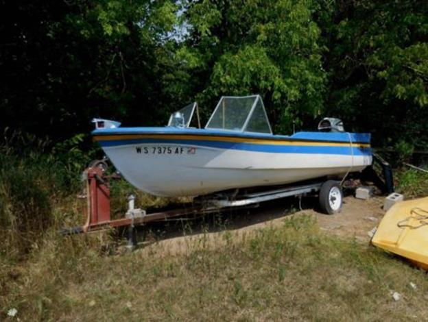

Hello All, This is my first go fast boat. I've been a sailor for many years. I thought it would be fun to restore something special, then the 1960 Rocket popped up on craigslist( 40 hp Evinrude and trailer). The blue deck is the same color as my '71 Pearson sailboat(26 ft, 6,000 lbs, Lake Michigan). Fate I think. The azure blue is under the dk blue paint.
I have read the Shell Lake stuff in the Library, awesome resource, thank you! Do we know how many were produced? How many are actually still around? My boat seems to have all the original upholstery and appointments. Wood planks on the floor, and sides of the hull next to the front seats. Was there astroturf on the inside of the hull and those pockets on the back of the front seats or would that be a later addition?(are we calling those pockets lazarettes or mini beverage coolers?)Any additional comments or info will be appreciated. I do not have possession yet(it's frozen in, but I have paid for it)so the pics are scarce. I'll have to plan the project, I see some articles in the research section. Hopefully something there. I'll be cataloging and bagging the parts, with pics to document how it fits.
Wish me luck, and let me know what you know, thanks!

Welcome aboard and nice find. Sorry I don't have any info on the rocket but I'm betting the astroturf was put in by the previous owner and not nothing the manufacturer installed.
