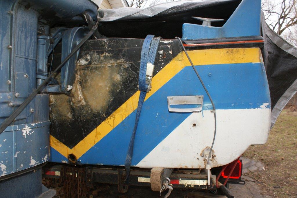

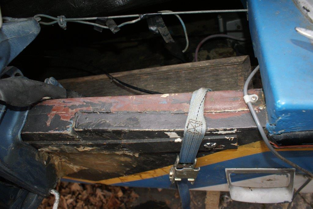

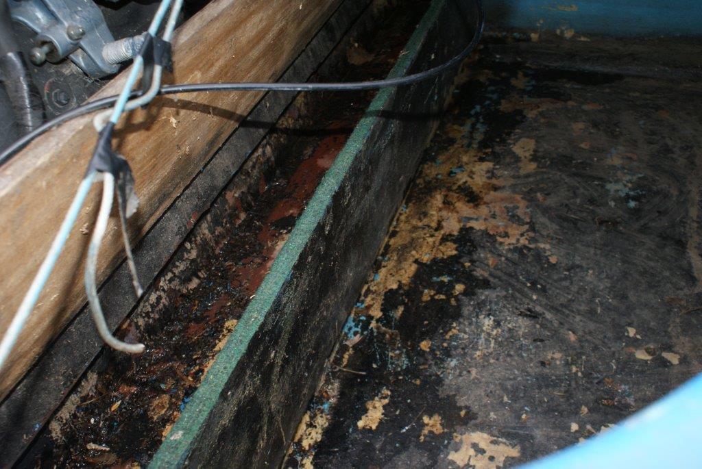

Here are some pics of the transom. There was some unfinished glass 'slapped' on around the engine clamp to try covering the filler block seam. That peeled right off. The bolts that have been pulled out are necked down due to rust, the wood around the hole is brown and soft. The other pic is the rocket and my '71 Pearson 26 ft sailboat behind me in the background.
