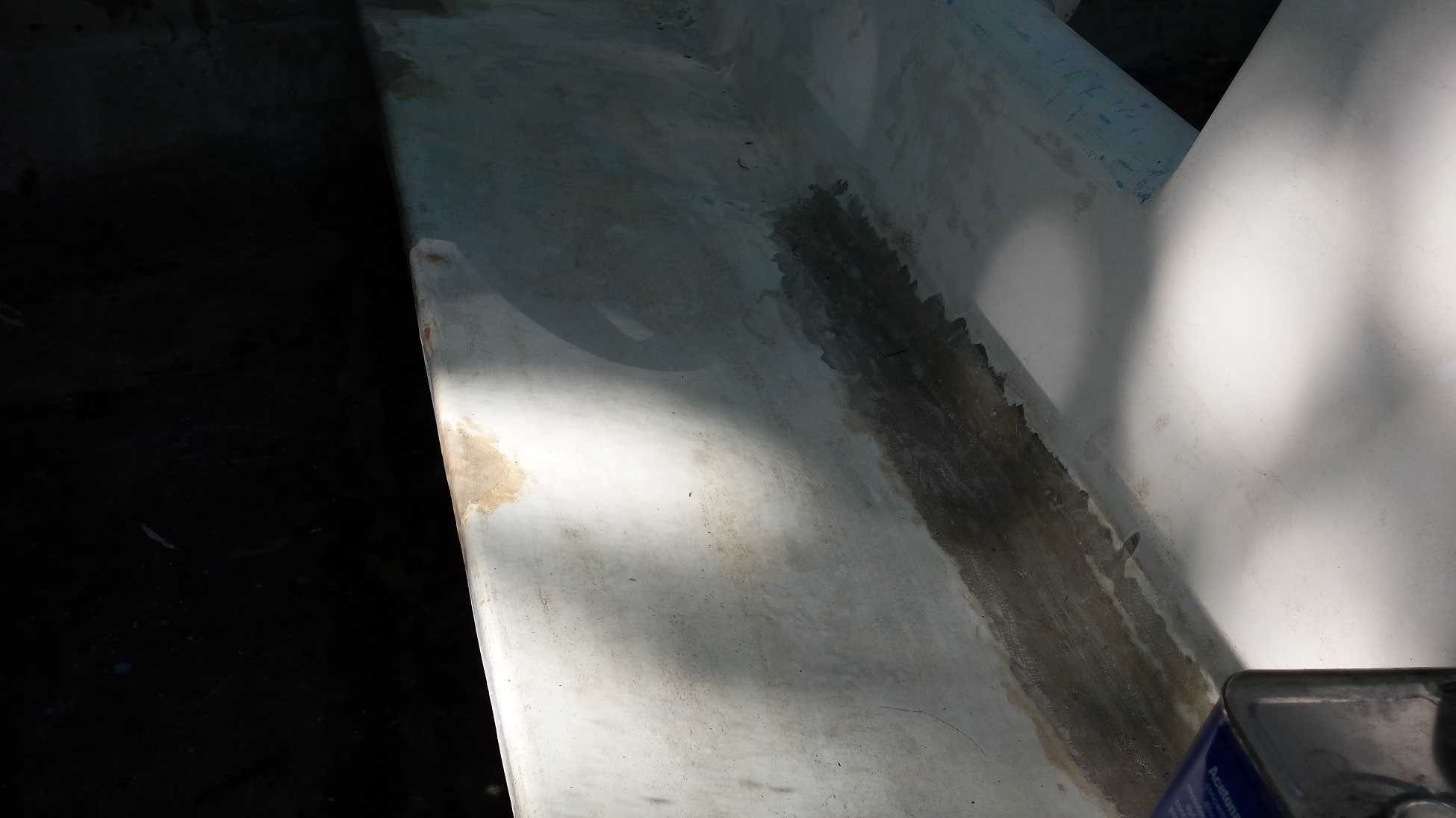

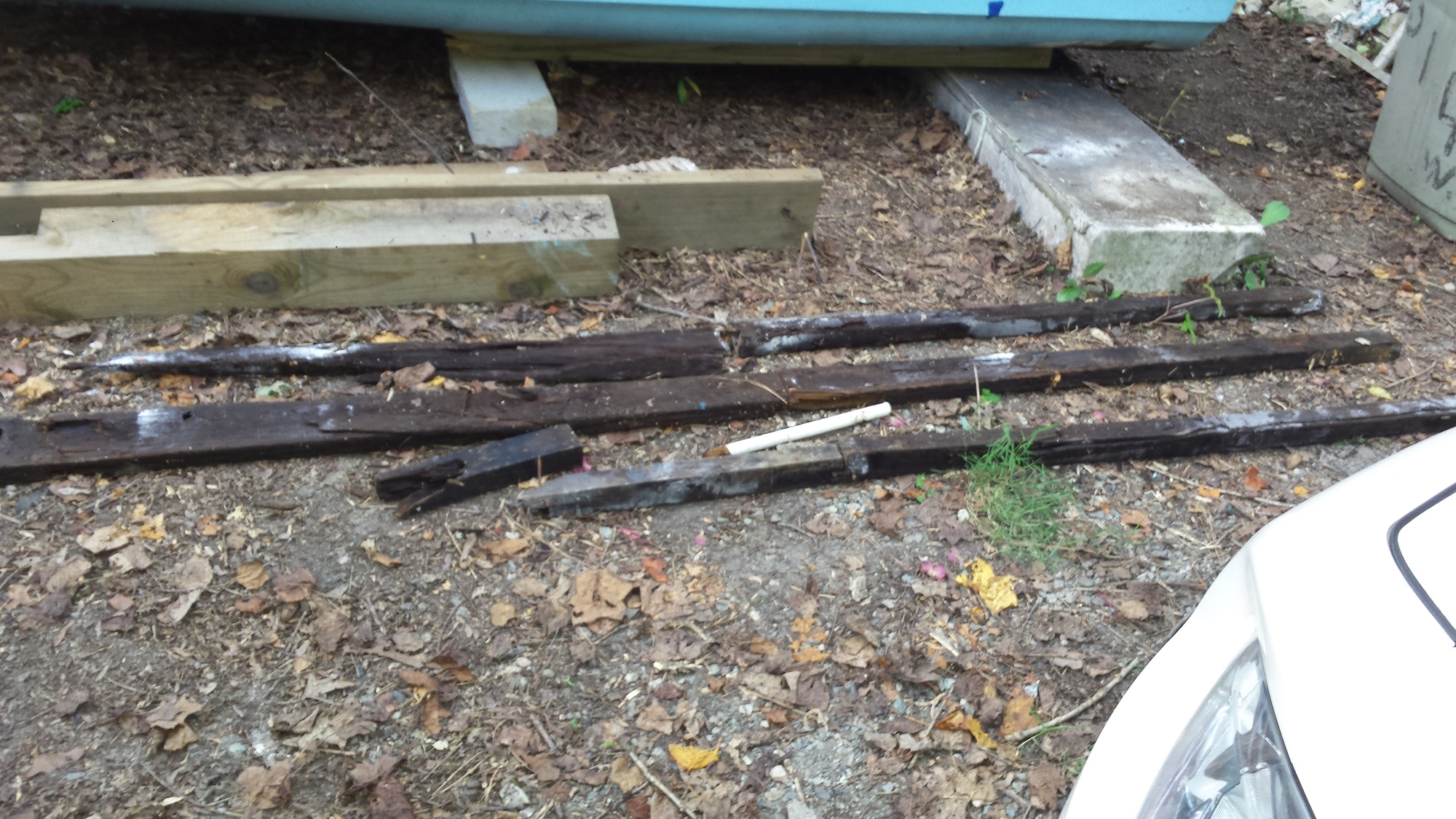

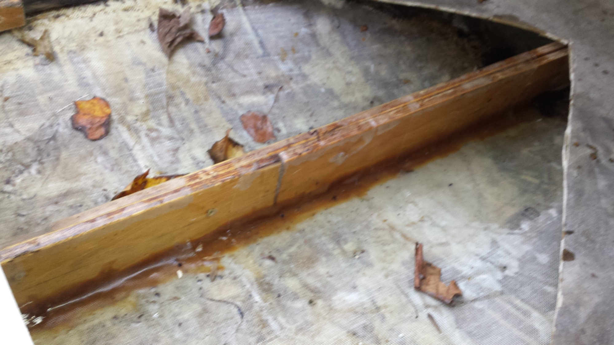

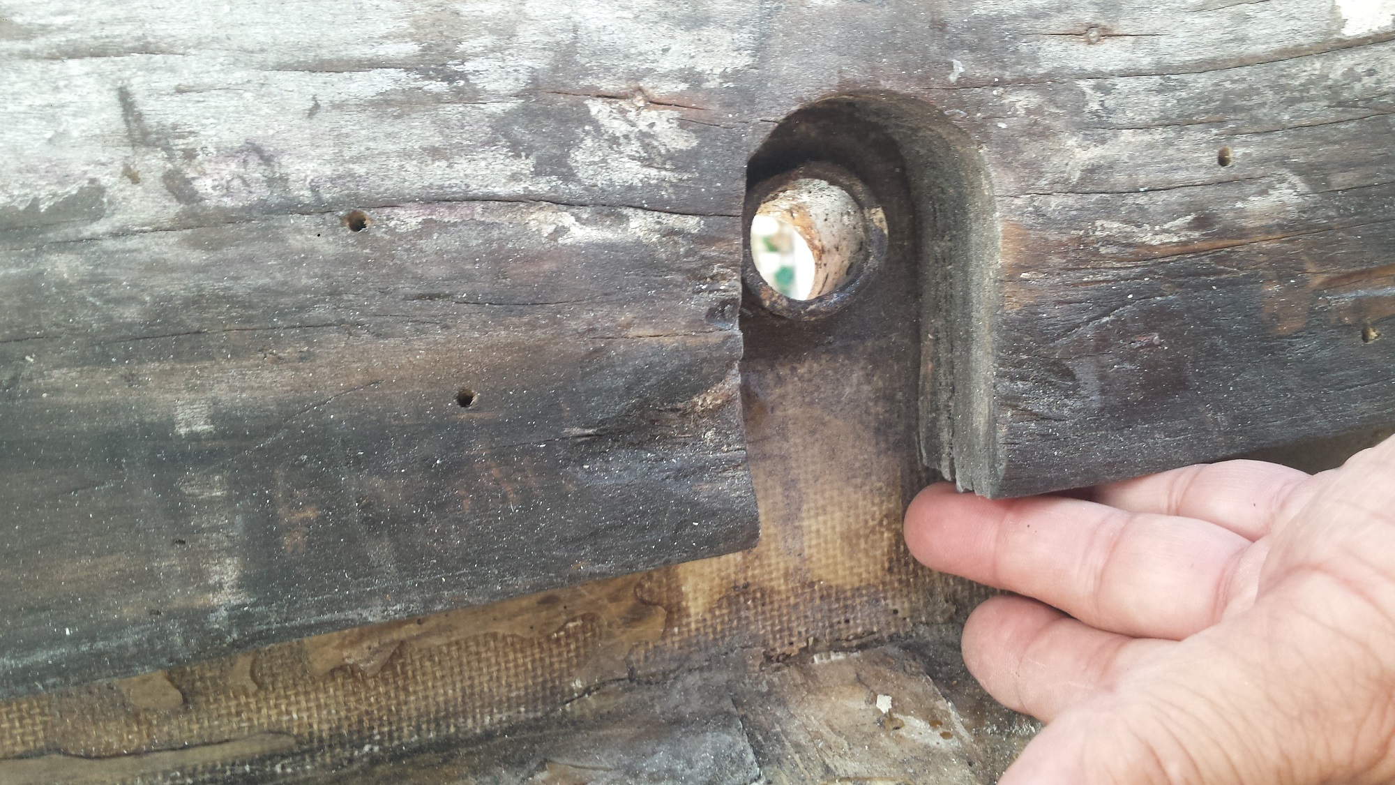

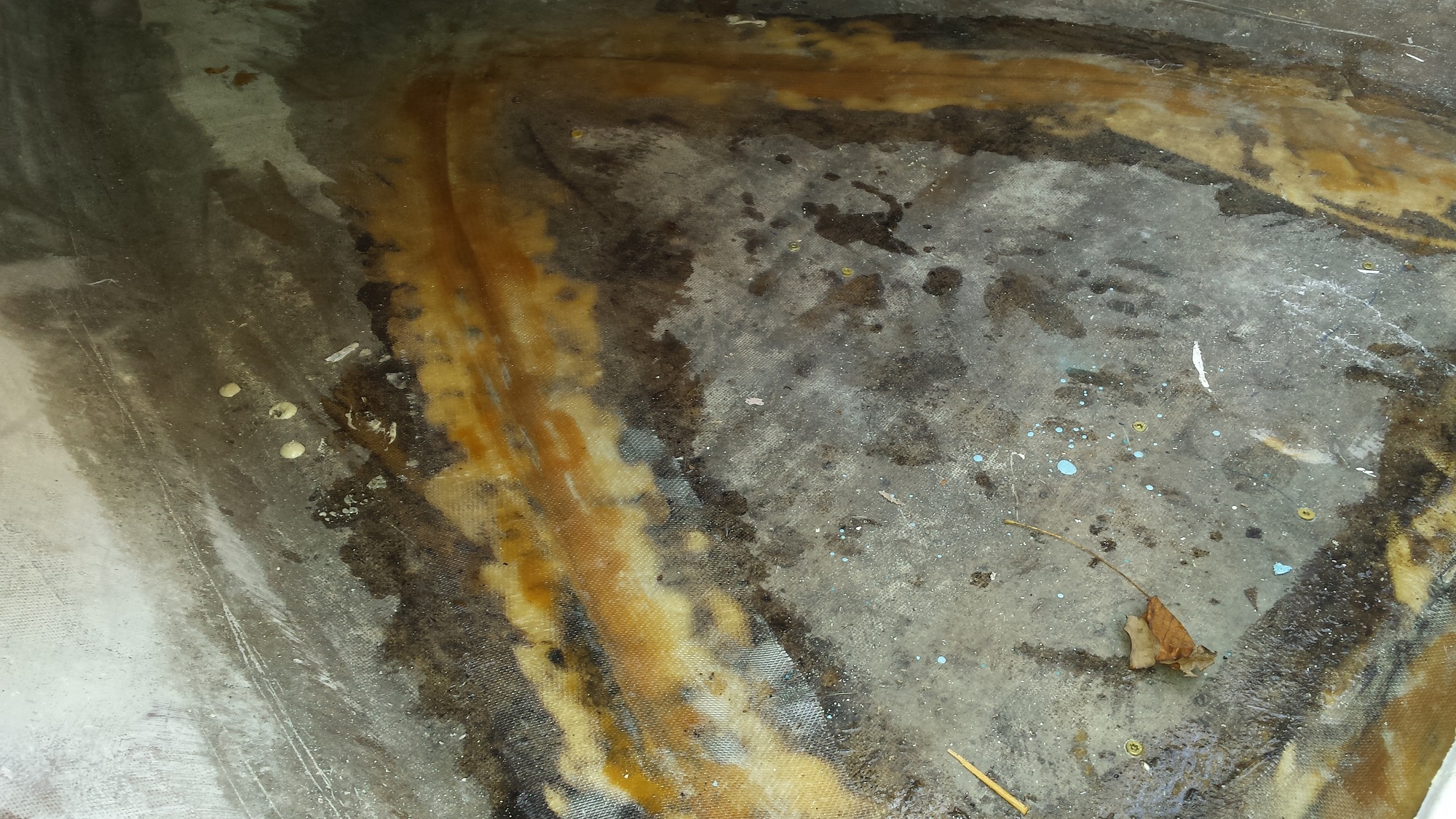

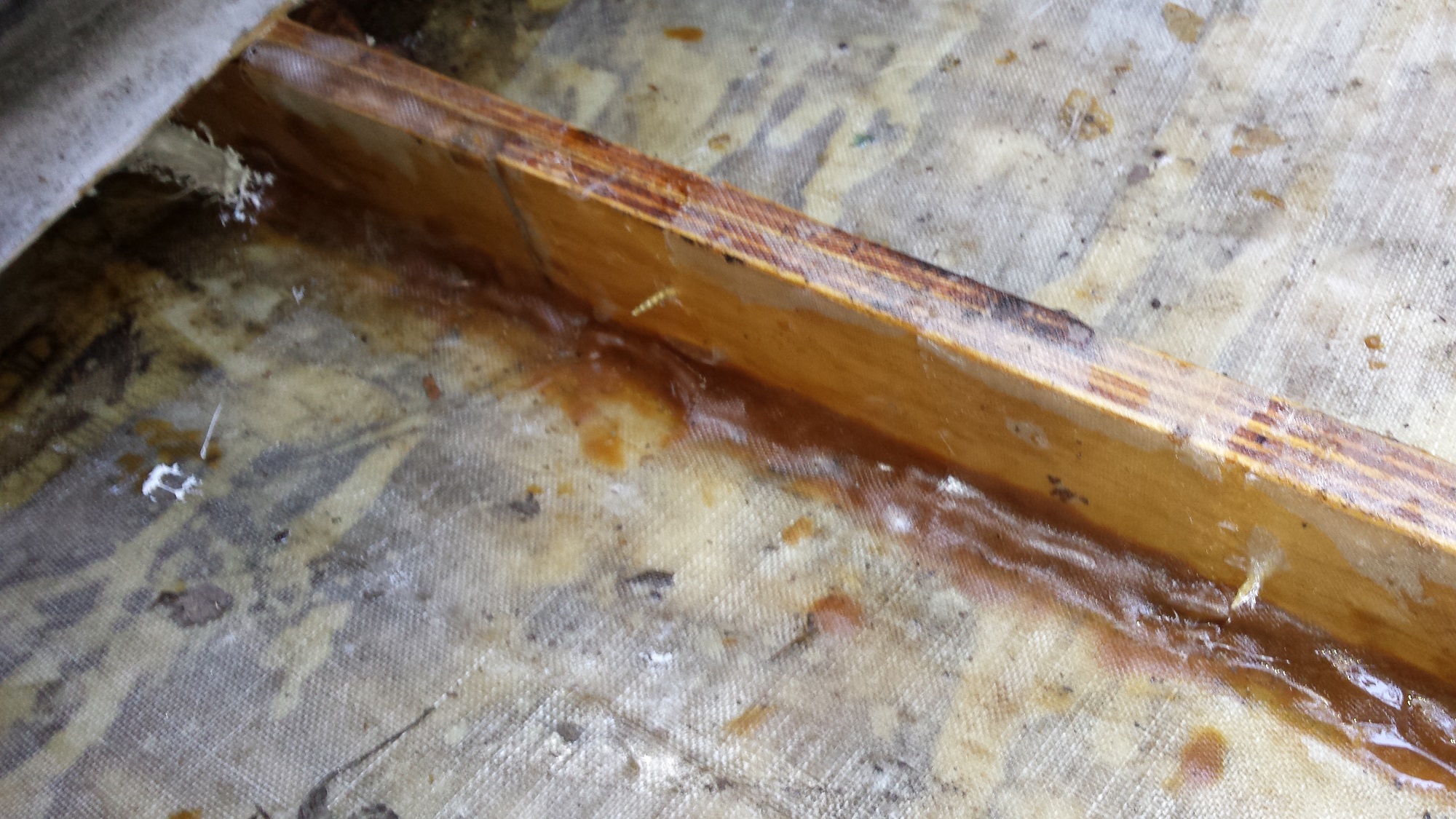

Re:lake n sea project for a newbe 10 years 1 month ago #127556
a few more pics i started a blog on a site called bateau2 because i bought some materials from a related site then i stumbled onto this site. i think you guys are a little more friendly to rebuilding they seem to be into build from scratch, and not thinking mine was worth the trouble to fix up. anyway i have been getting good advice there, i'm sure you guys have lots of experience too.
So i will also post here seems more related to the boat i have started on, and i really like seeing these old style boats that need work :)

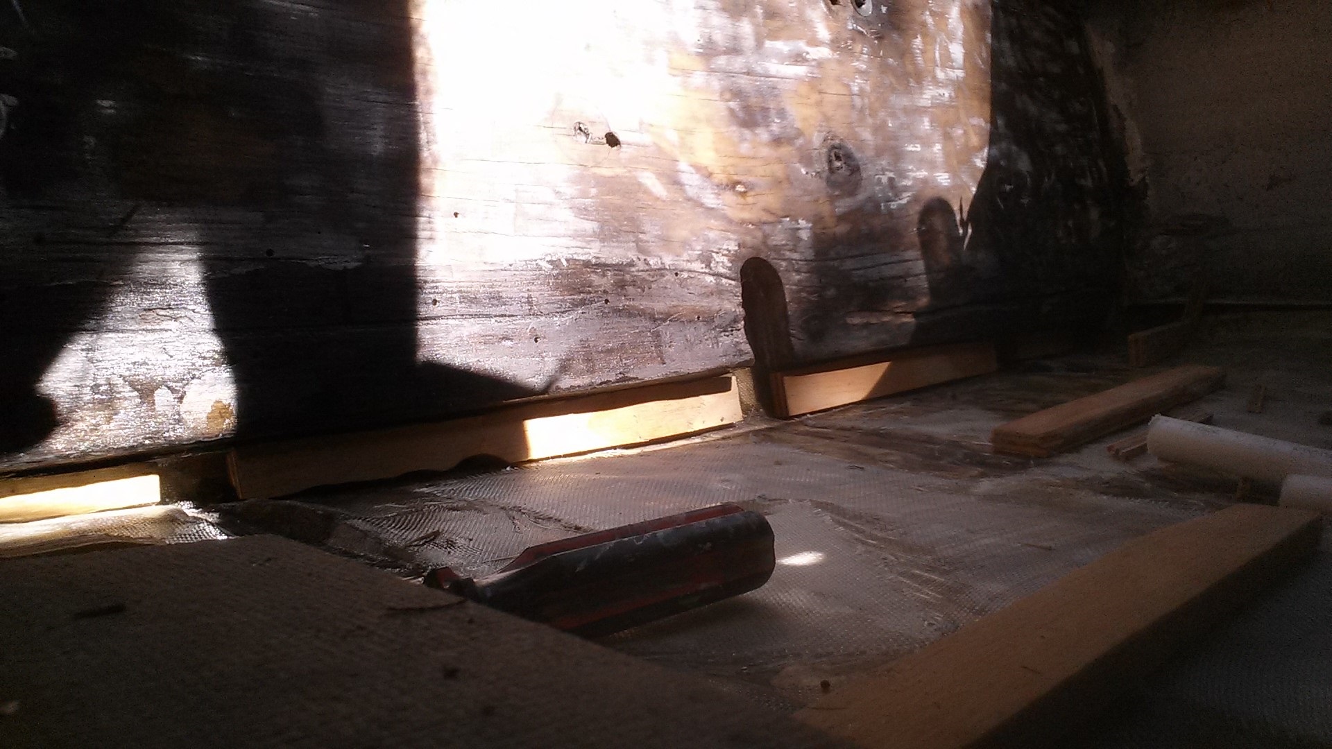

i'm new to boats all together only been on a small boat a few times lol , but i'm looking to have some fun doing this
cutting into because i could tell it had water inside
got what was left of the stringers out, water logged and rotten for sure
cutting in new stringers ( ok it's not going to be perfect)

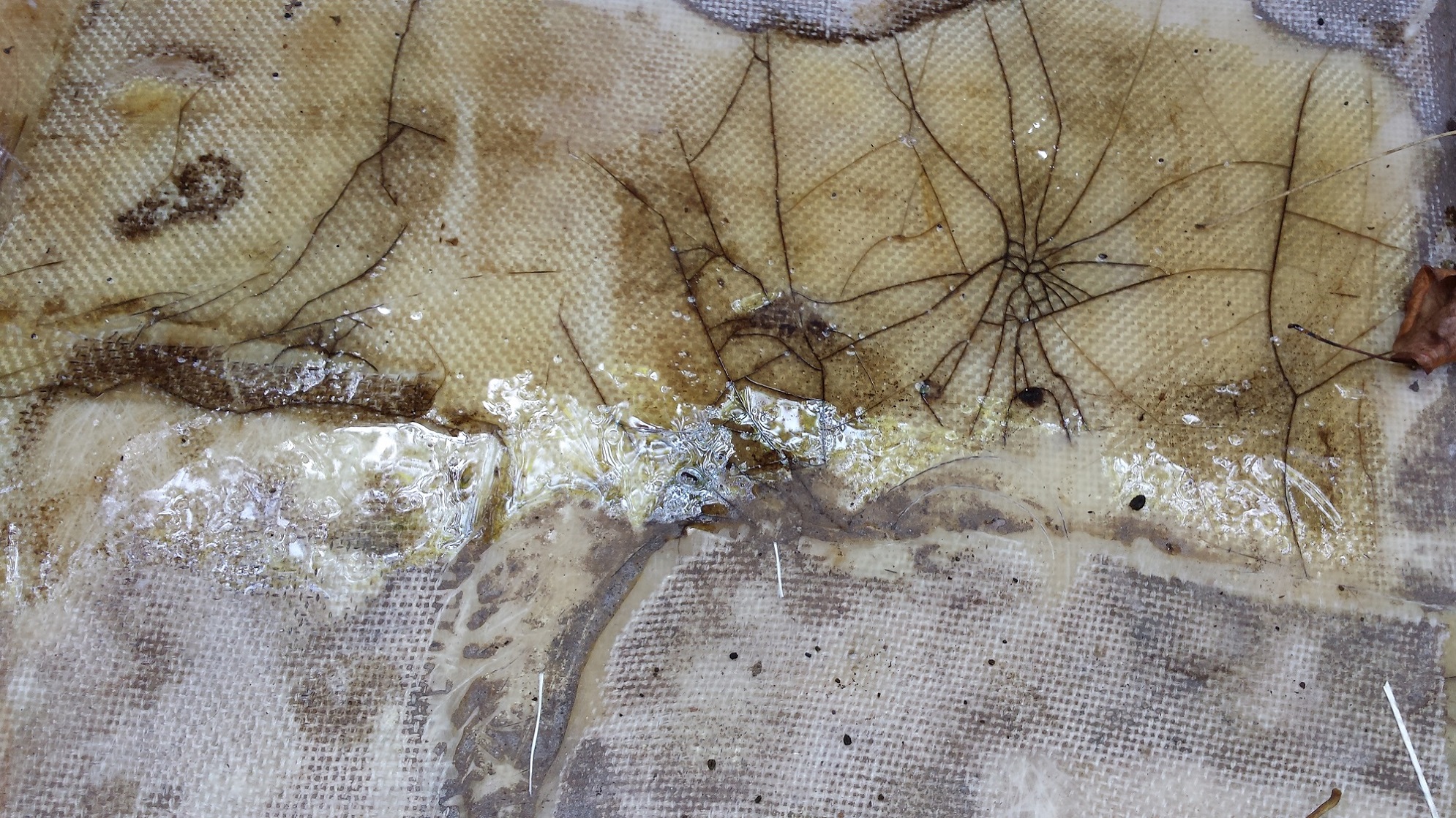

Re:lake n sea project for a newbe 10 years 1 month ago #127564
thanks for the hello,
I really have enjoyed looking at all the unique boats and the effort folks have put into them. I'm not aiming for perfection on this first one, just experience.

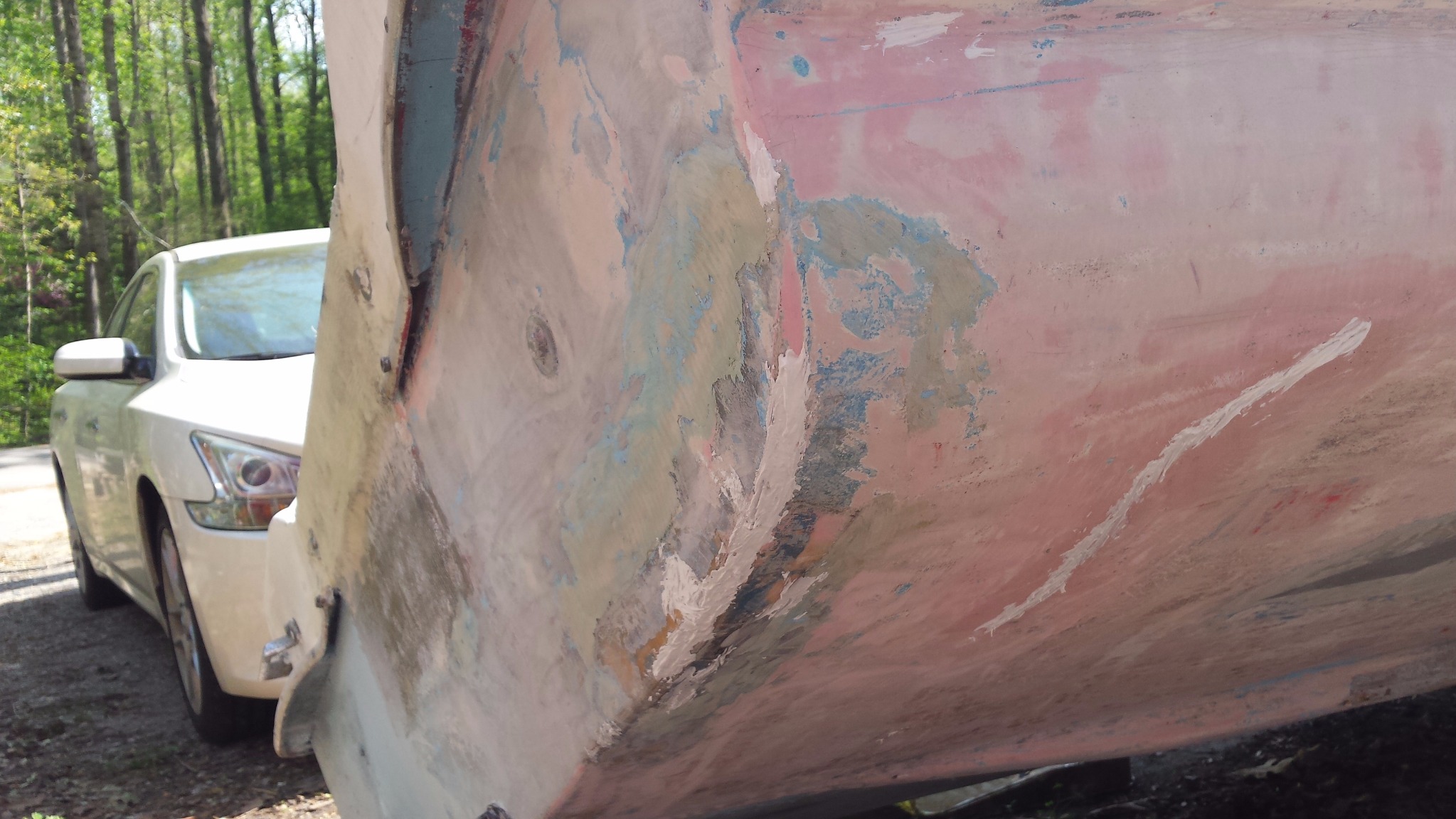

Just to let you know i am replacing the whole length of the stringers but as i have to work outside and have limited tools i only cut the floor out where i could get to it. I did not want to have to cut out the seats and then the whole floor. SO working around and under them, maybe not the best option, but .....
And thats not half the problems with it. anyway it will be a good learning experience and fun, i hope. I like tearing things up a little and putting them back together but I try not to go too crazy.
THe former owner put in a transom but did a half backed job as i have learned from reading and looking at youtube vids. I going to try and reinforce it only.
lots of spider type cracks in the bottom of the hull. I am fiber-glassing over the bottom to help ( i hope it helps)
And he painted it with latex house paint. I have read pro's and con's about doing that. I do like the nice smooth and shinny look myself, so thats going to take some time. lol

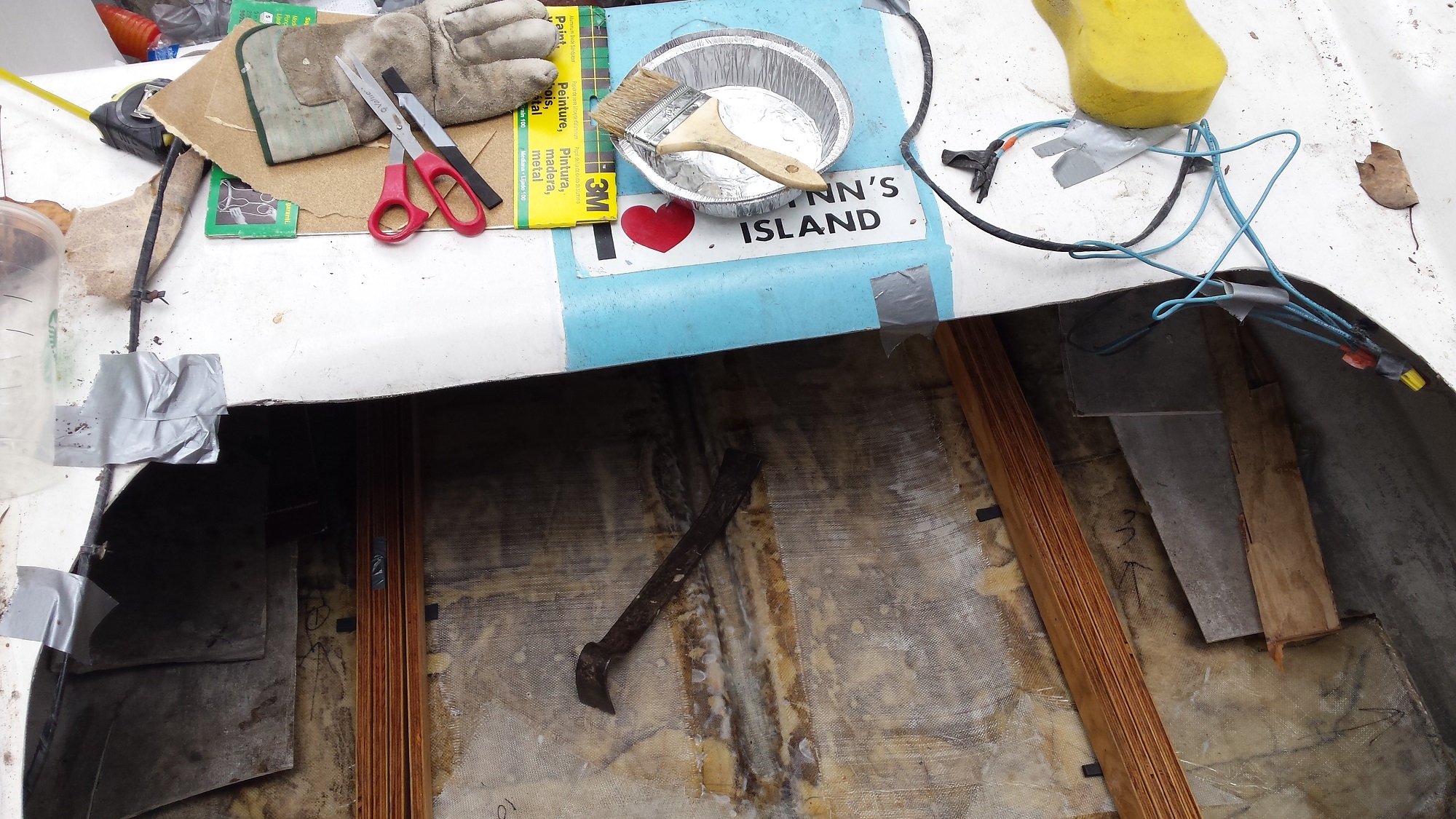

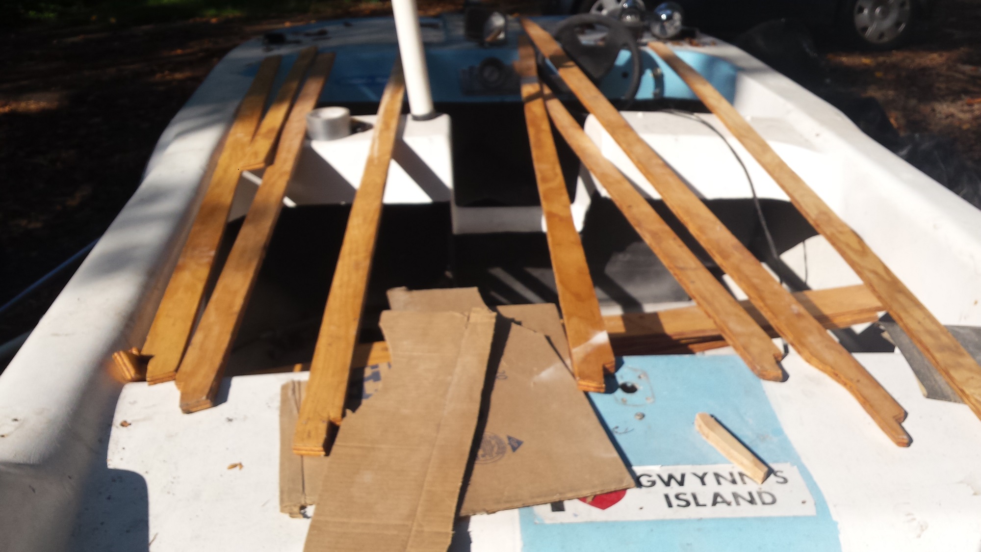

Re:lake n sea project for a newbe 10 years 1 month ago #127745

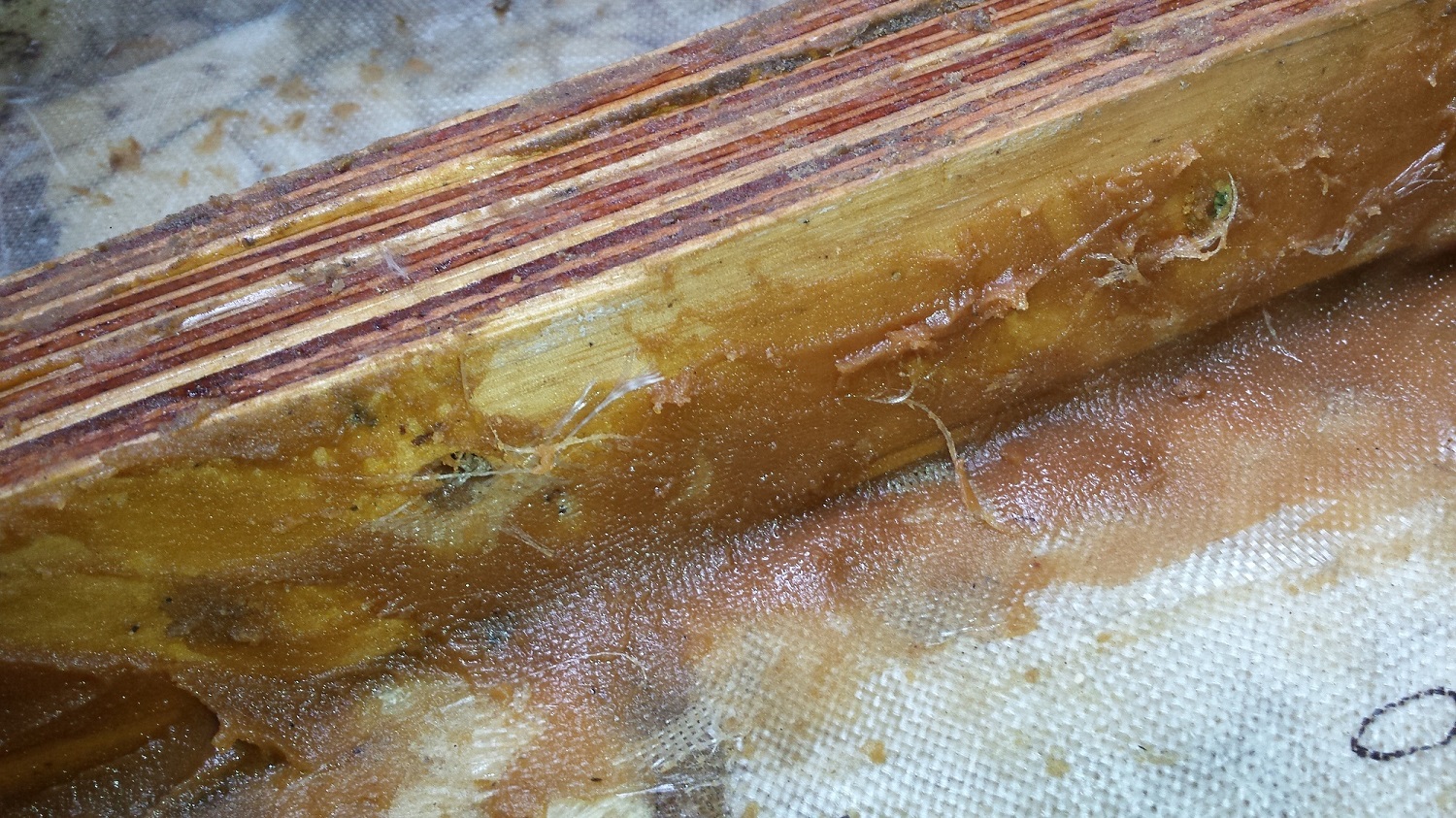

I did a little more with the stringers it is sloppy but i epoxied together plywood strips then used deck screws to "clap" them together.
Then made my peanut butter and was going to use a cake thing to do the fillets but it burst so i had to apply the mix with my fingers and spoon.
after that i also put a thin strip of fiberglass on top of the fillet.
later I will cover the stringers with fiberglass.
as messy as it looks i seems very strong?
Re:lake n sea project for a newbe 10 years 1 month ago #127746

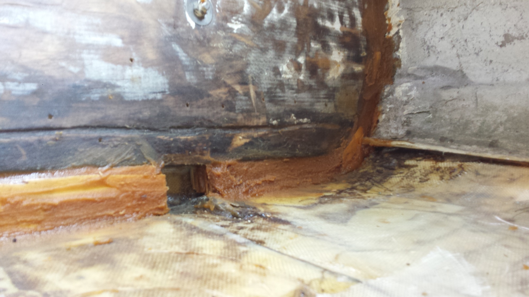

working on strengthening the transom to the hull
i think it's ready for the foam

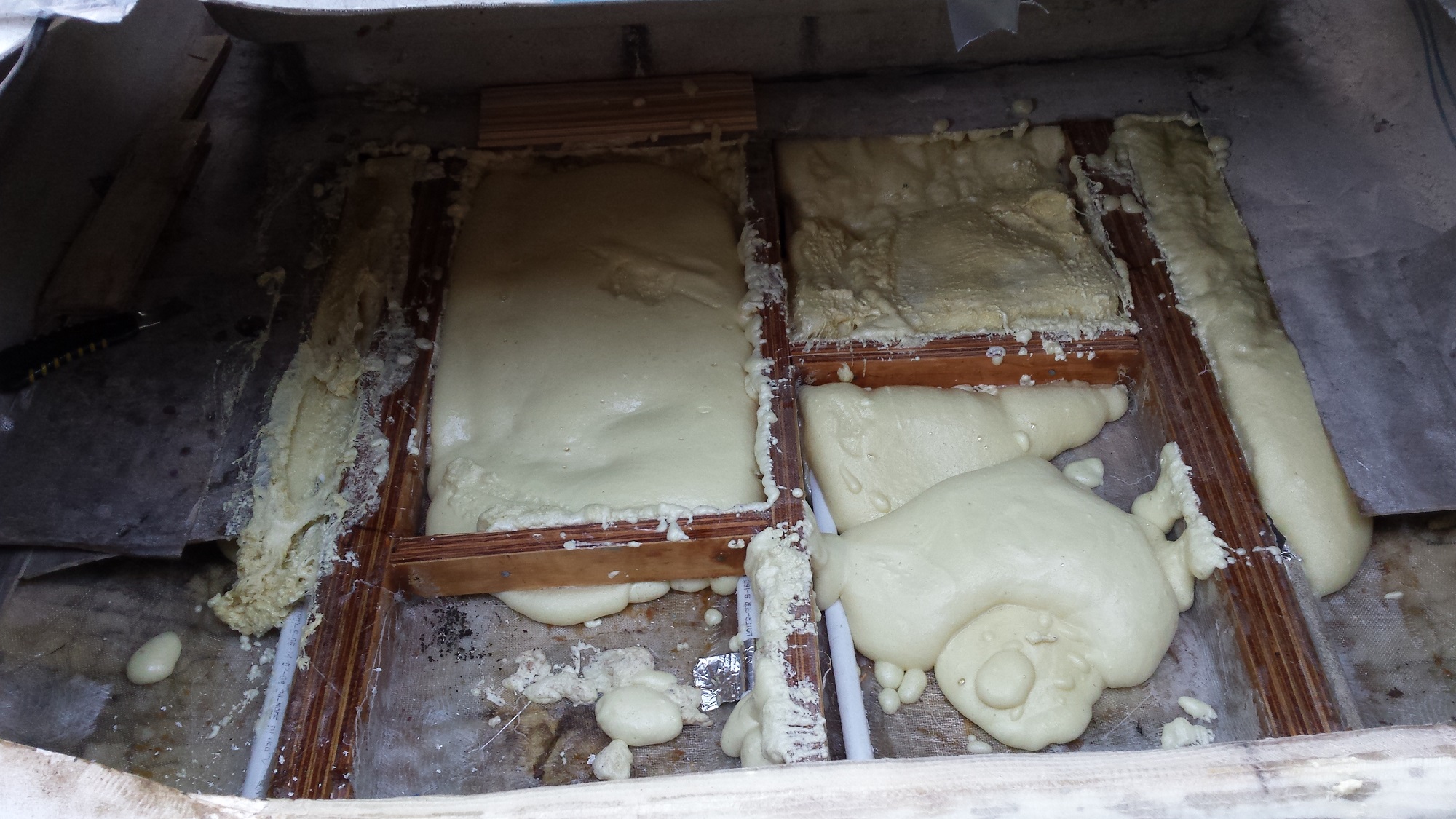

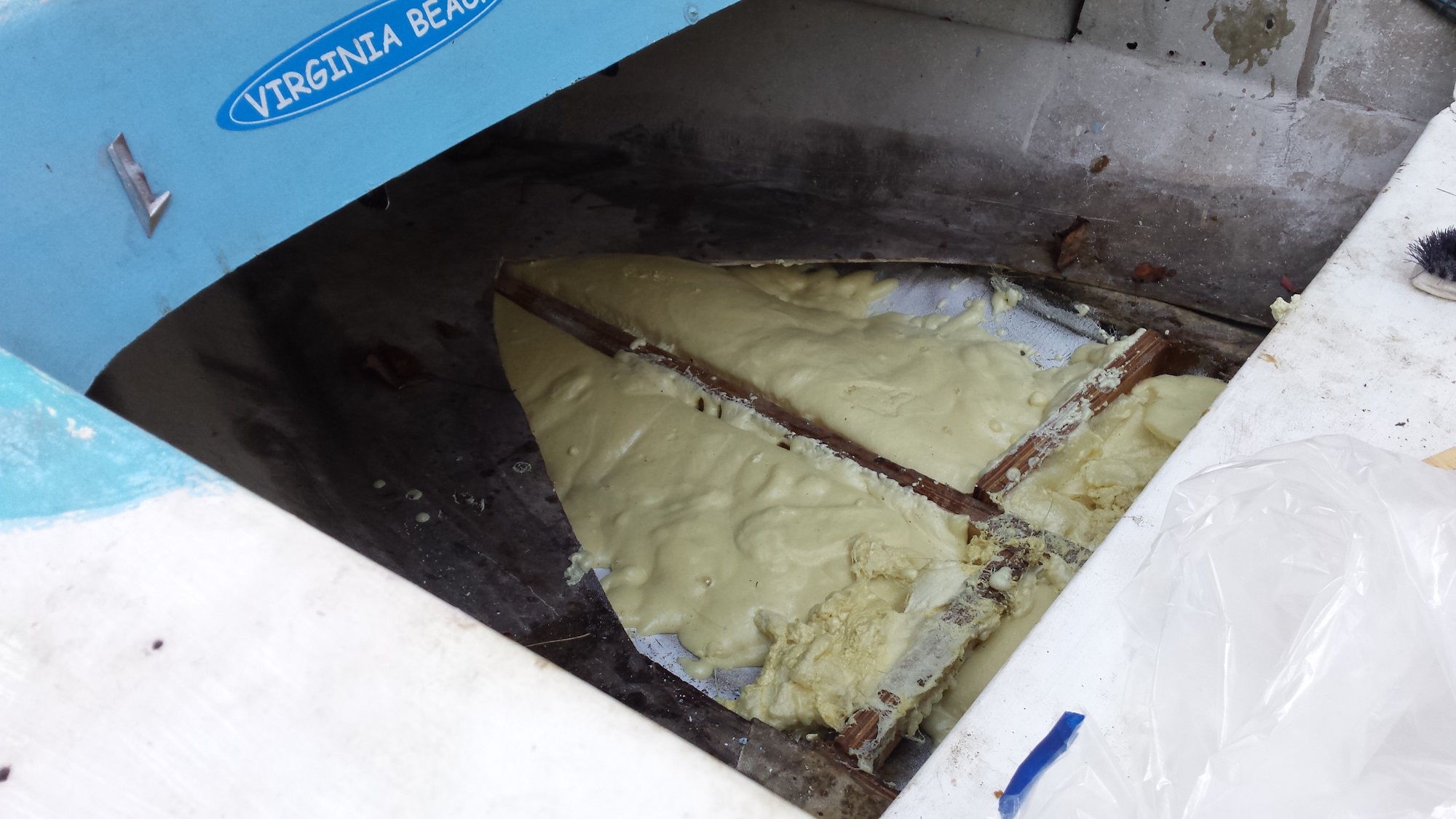

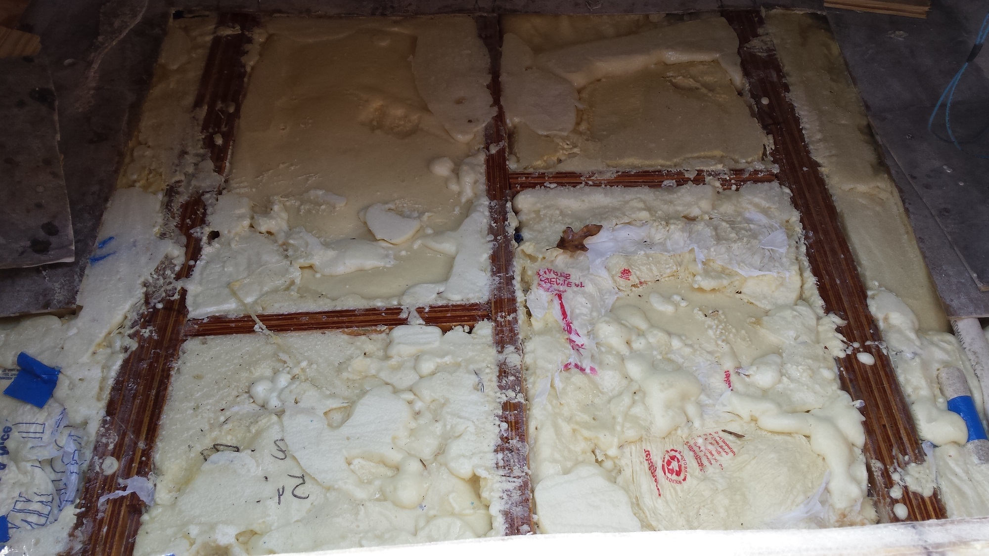

this is sloppy but i'm getting some foam in, and i hope it helps keep it floating. very interesting stuff to work with
ok to finish off the foaming
i'm going to add more to the 3 exposed sections of the floor i cut out. but as soon as i pour it around the remaining low spots, im going to put the floor on top of it right away . than as the foam expands hopefully it will expand sideways, as there are open spaces because the floor will keep it from just rising upwards.
Then for the sections where the seats are and the floor is not open. i will drill holes and pour in some foam then cover the hole and hopefully again it will expand sideways and fill in the open spaces under the floor and seats that i could not get to directly from above.

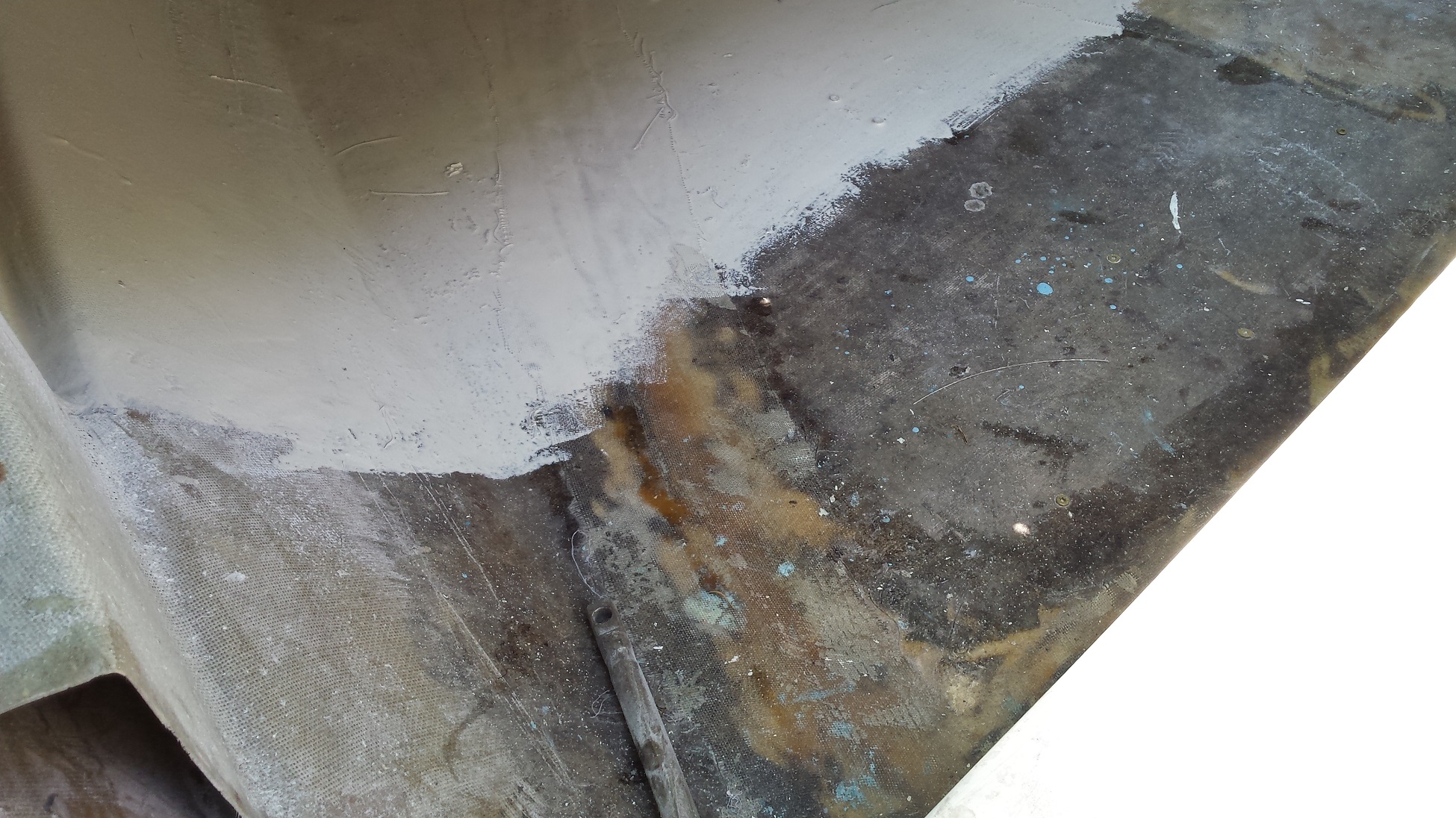

ust an update:
I got the foam in. and i sealed the cut parts with epoxy. I did learn a lot on how to use it and i'm sure next time i will have a much better result.
So i'm ready to put the floor back on, I will screw the fiberglass pieces down onto the stringers and fiberglass over the cuts maybe even fill them in with a little wood flower first.
Pictures of the floor pieces, I did remove/sand down the fiberglass pieces that were covering the original stringers

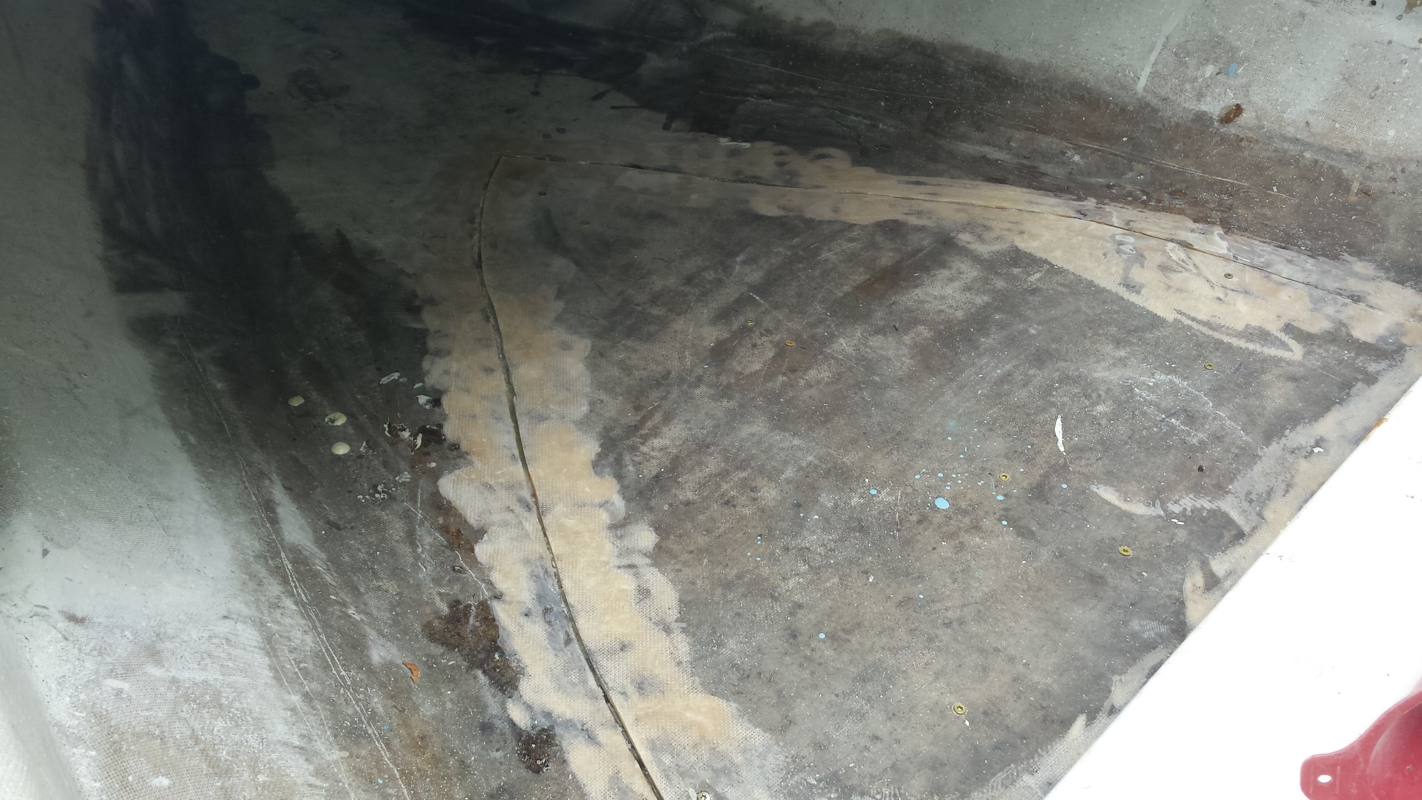

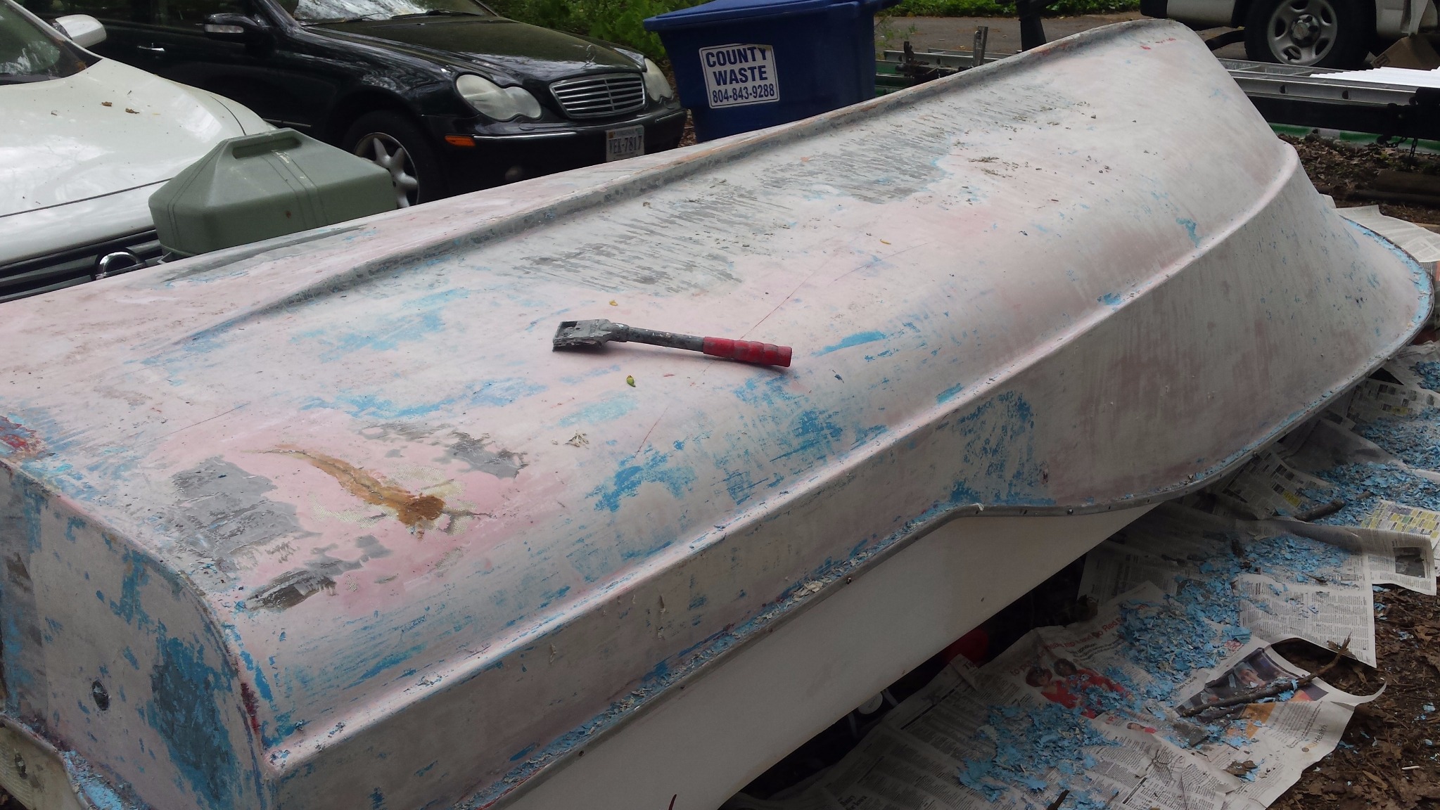

A little more progress getting the floor back on
Screwed in the floor to the stringers, used woodflour to fill in the cuts then put fiberglass over the wood flower.
For the transom i put in a filet of woodflower and i will add more fiberglass.
I might not get too much more done in my outside workshop depending on the weather.
I would like to start to strip it, the guy painted it with exterior house paint

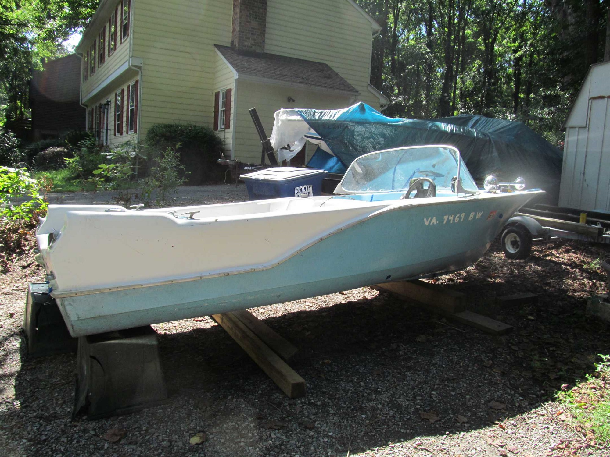

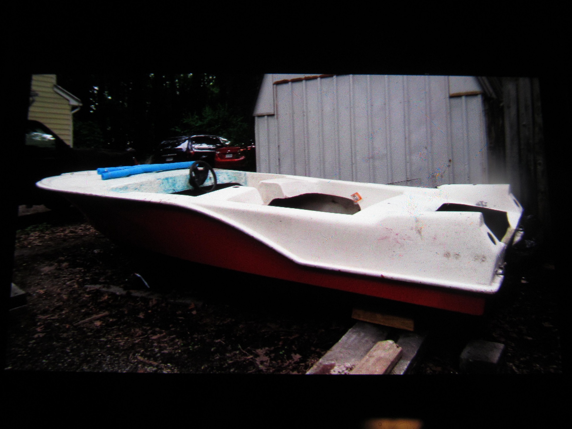

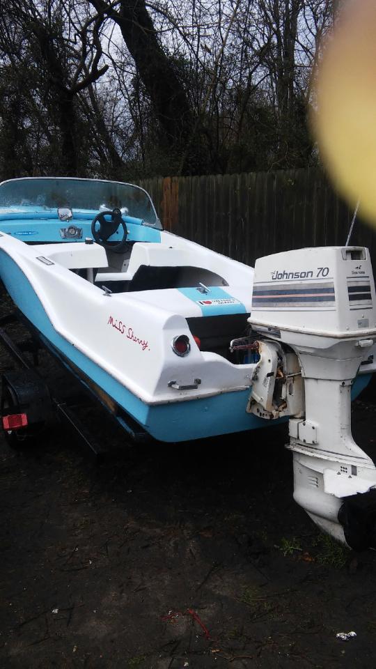

Is this the L & S from craigs list in Richmond, VA ? $250 w/o the trailer?
If so I almost bought it. The guy (Doug) sent me to the wrong address - his fathers house in Mathews, VA.I got there and no L & S !
Found this picture in my texts from July-
Re:lake n sea project for a newbe 9 years 10 months ago #129646
not sure whats going on but that is what i bought this summer from a craigs list ad. it was in much worse shape then it looks in that pic no engine no trailer.
as you can see from my posts here
maybe you lucked out on all the work and cost that it is taking but i'm learning, it's my first time experience. i'm a newbie boater

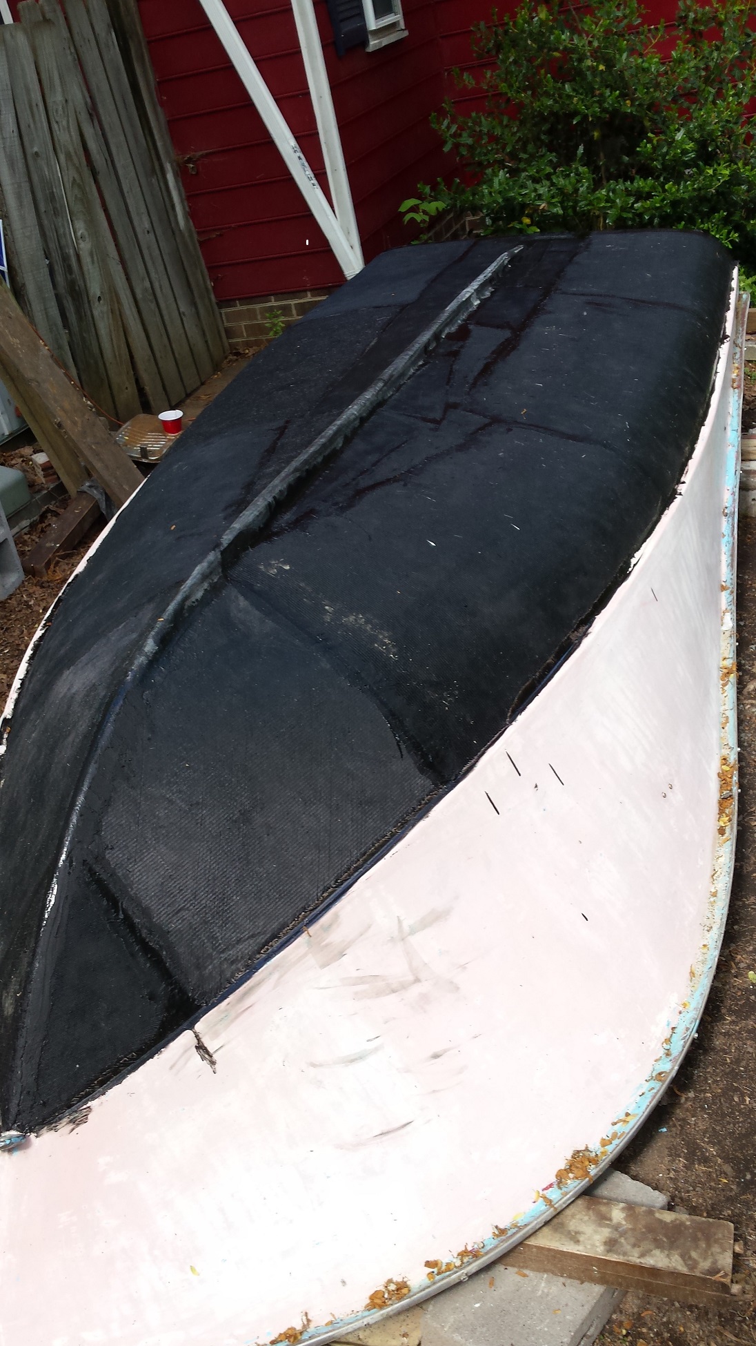

Re:lake n sea project for a newbe 9 years 6 months ago #131400

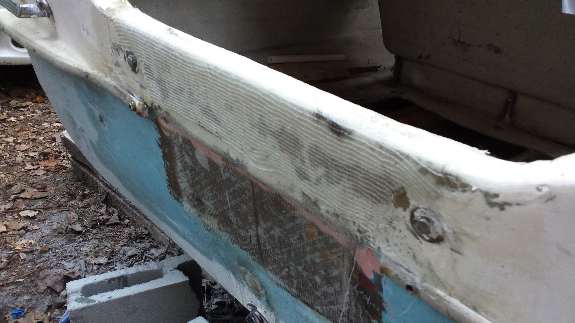

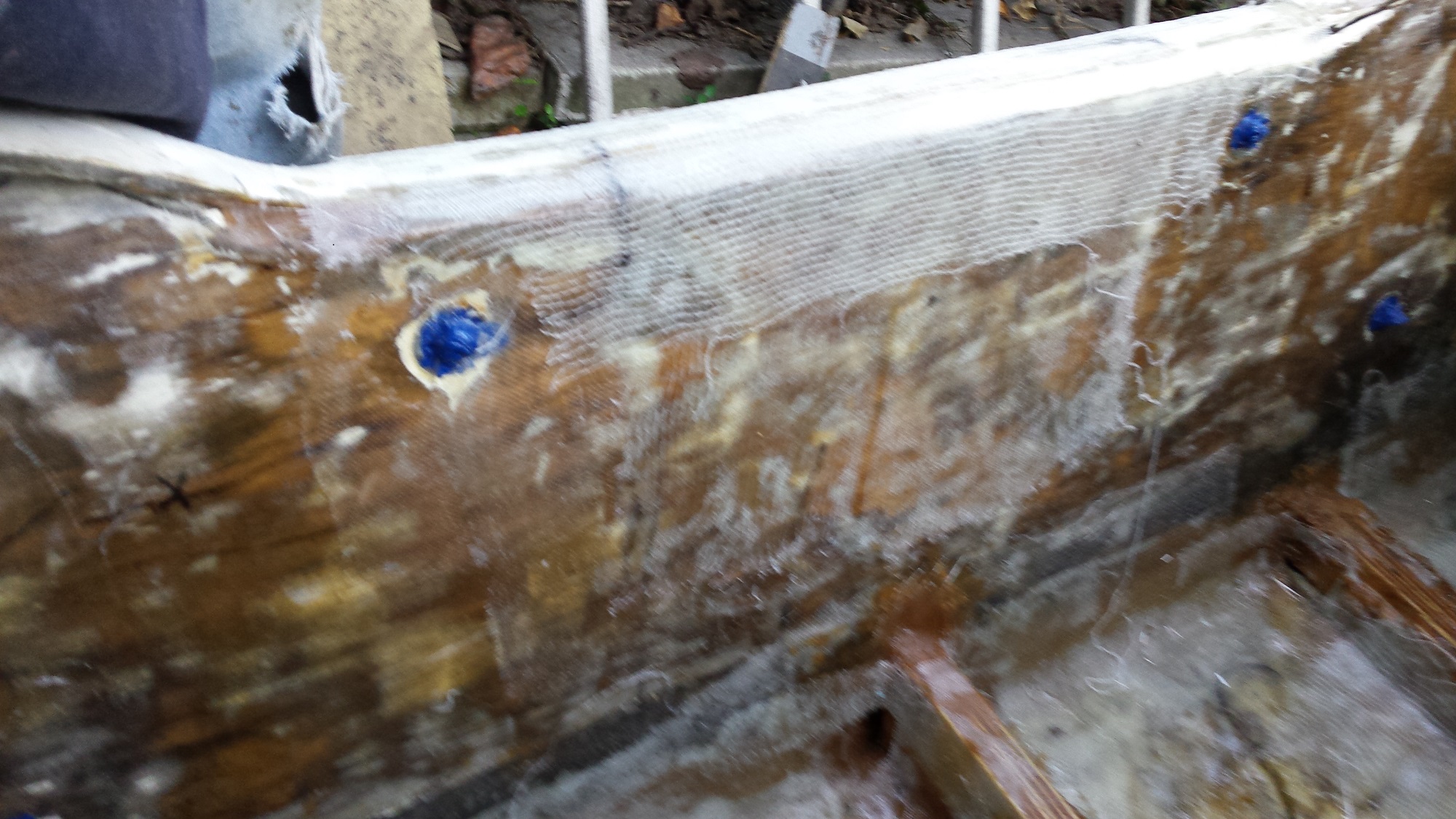

April 2017 and i am starting to work on the boat again, with help from one of my sons we turned it upside down. so i can strip off the exterior house paint on it . SURPRISE, this thing has had some issues over the years WOW! so i'm going to strip it ( used some orange citrus stripper) and add some fiberglass to make sure it doesn't leak lol. I bought fiberglass and some epoxy off craigs list adds and a good price. The epoxy is PPG america something ( you mix equal parts , i like the way it works, It is a black color but I also got a white color too.
now lets see how easy it is to post pics

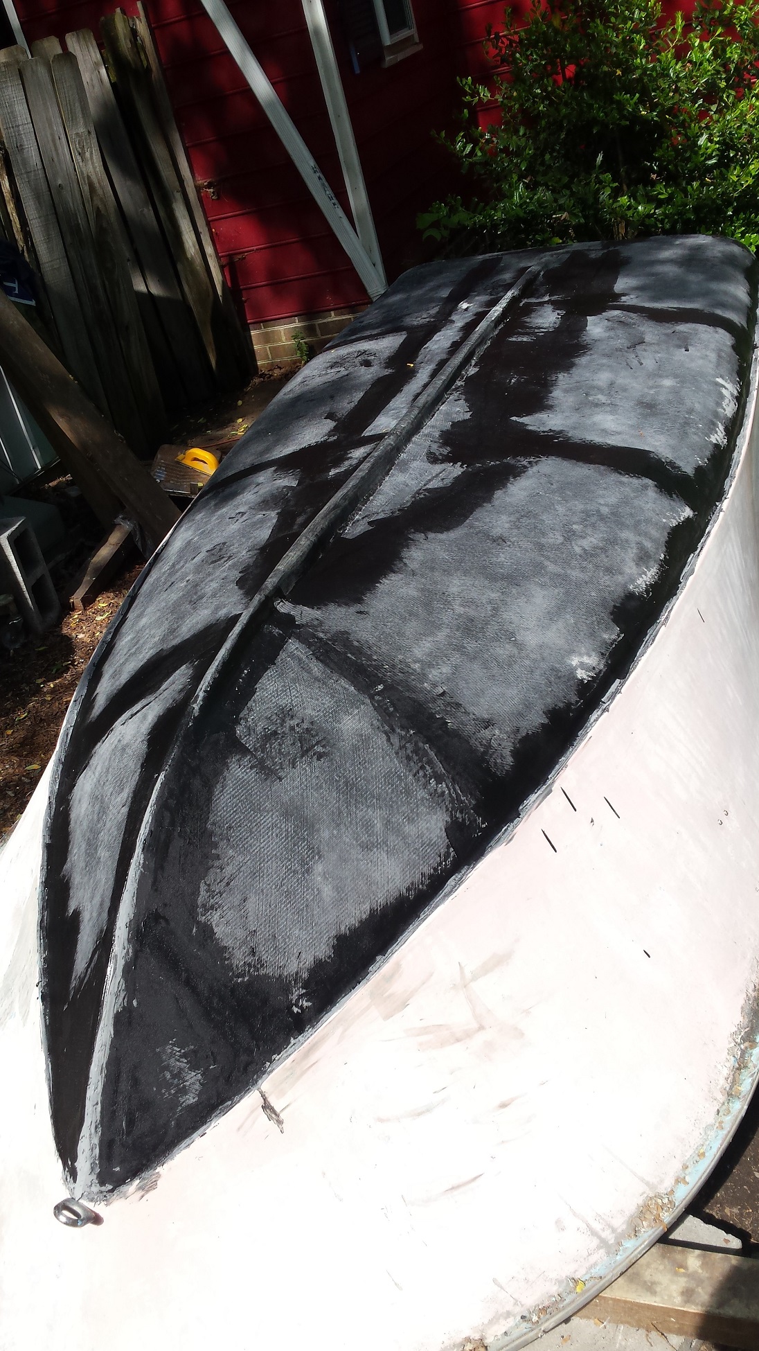

lake n sea project for a newbe 9 years 6 months ago #131514

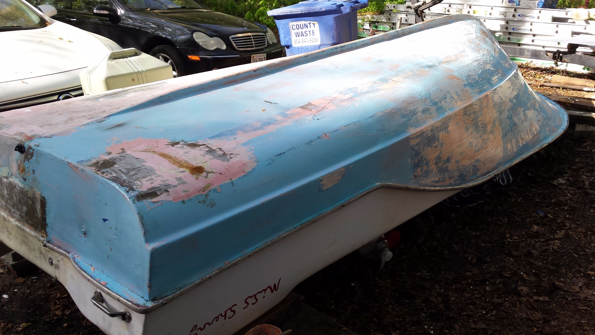

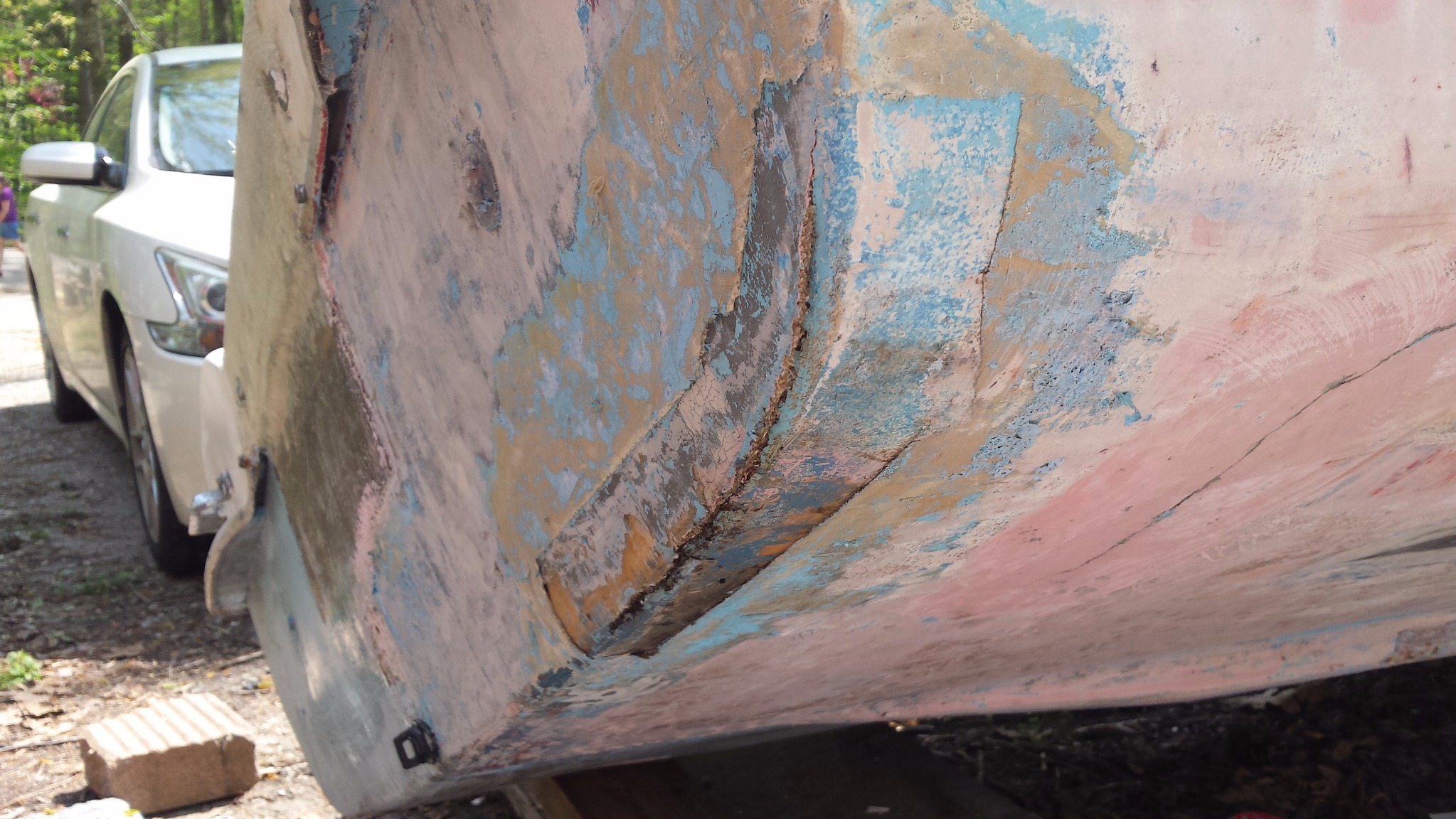

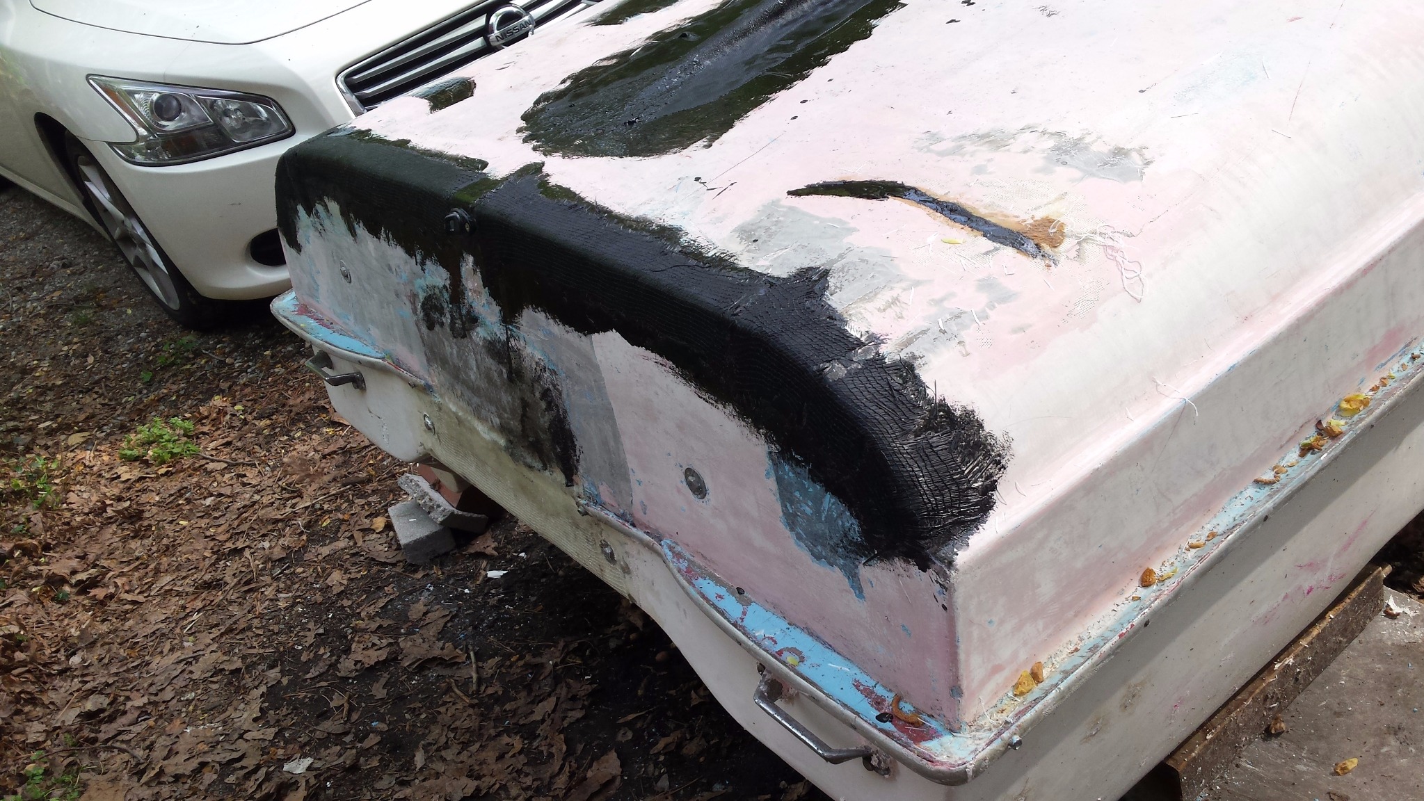

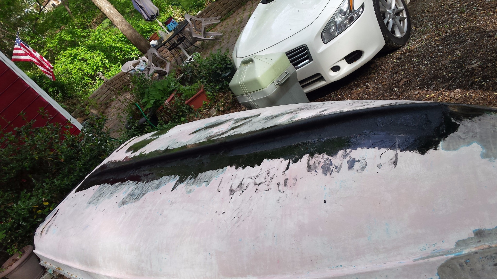

covering the whole bottom with 1708 i got cheep on craigs list filling in the gaps with woodflower peanut butter. I think that will solve any leaking or soft spot problems lol. Now, I am tempted to sand a little, then just paint over everything BUT>>>>>>> i think the 1708 mesh might still show thru the paint? DAM! I guess I will have to do the whole bottom in a slight woodflower paste then sand to get a smooth finish. I am not going for perfection, like a lot of you guys on here, I want to get this in the water. It's hard to believe the former owner took this boat out for an evening Christmas parade of lights in the water and did not sink lol
lake n sea project for a newbe 9 years 6 months ago #131517
Great progress. Pretty sure you have the leak problems solved. Just goes to show no one has to spend a fortune to do a refurbish job...after my own heart.
Waiting to see more progress.

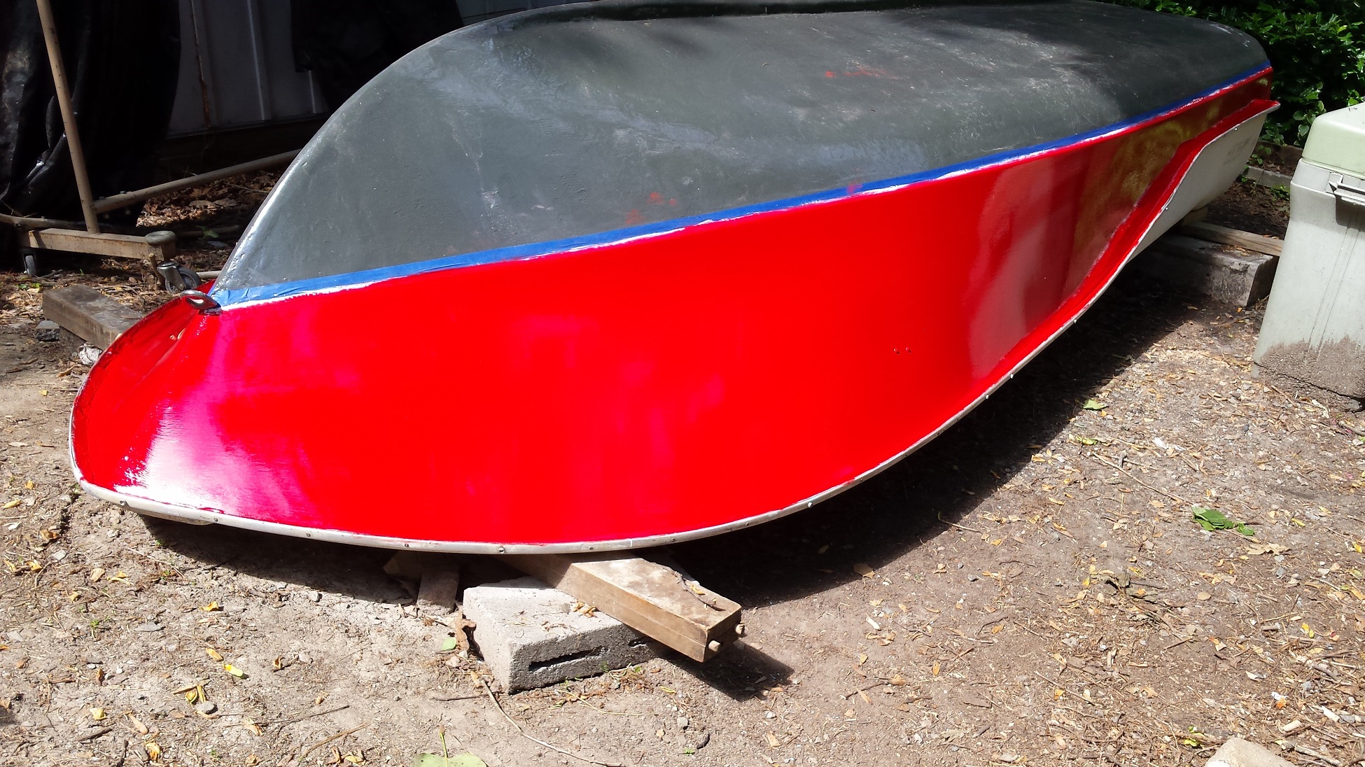

lake n sea project for a newbe 9 years 6 months ago #131593
ok , I think the bottom is nice and solid, I have put the final coat of silver epoxy on.however, I did not try to get it smoooooooth smooth. especially after all the fiberglass i covered it with. Now I'm planing a fire engine red on the hull and then the top, a rich blue :). We will see how this goes
lake n sea project for a newbe 9 years 6 months ago #131771
ok starting to get the red on it, just the first coat, going to try and get it on as smooth as possible with no dripping, maybe 3 coats. just a heads up im going to paint the top a rich shinny blue and throw in a little white in a few places. I have noticed a lot of the boats seem to have just one color along with white.

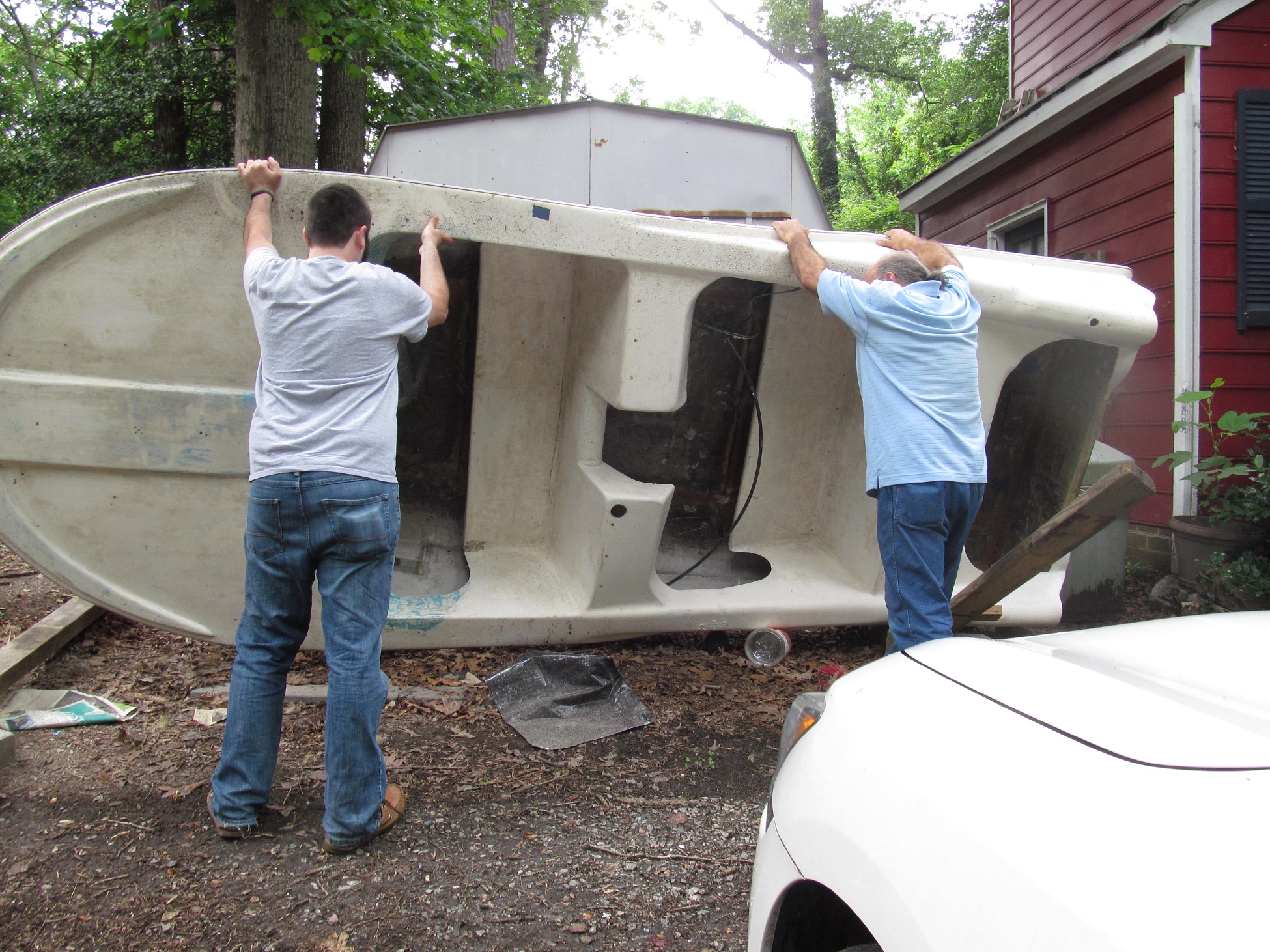

just a quick pic finaly got one of my sons to help get ot fliped back over lots of work still.
Just curious, I would like to paint what is showing as white now, a navy blue. My wife is saying leave that white but maybe blue on the inside ????
Any comments i might try to do Microsoft paint and see what it looks like lol
lake n sea project for a newbe 9 years 5 months ago #132113
Good progress. You're lucky to have a son to help, just trying to call mine is a chore.

lake n sea project for a newbe 9 years 5 months ago #132199
Some of us on the site have used old tires, old mattresses, old chair cushions, and just about anything available to soften the fall during a flip.
This boat was painted 100% with Rustoleum enamel not even the "marine" stuff. Just the gloss in a can, mixed some different colors together, blue, white, green and let the chips fall where the color landed.
Let it dry and then sand it with 2000 grit sandpaper which you can get at most auto stores and then used a power buffer and Meguires polish.
lake n sea project for a newbe 9 years 5 months ago #132229
thought I responded to your boat and paint job earlier . WOW looks great i will give the rustoleum a try. i did just start to paint the inside hull and floor with the craigs list epoxy i bought cheep, just to clean it up the inside some. I'm not sure what to do with the floor non skid paint or something ?? And I have been sanding the top and fiber glassing a few small spots on the seats getting ready for the paint.
