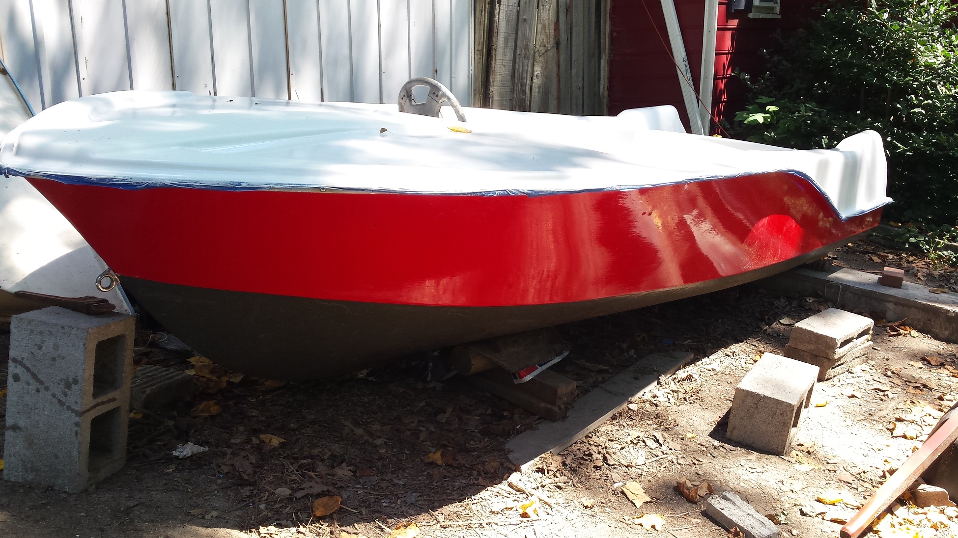

Sabre, i got the rustoleum for the white and blue and i am using it, pictures soon, MY QUESTION; how many coats did you use and how is it holding up?
I'm not going to go the the extra fine polishing you did, I want to get it in the water this summer lol
lake n sea project for a newbe 9 years 4 months ago #132543
late june using Rustoleum for the white and blue starting to get in on. I like the way it is working so far and MUCH cheaper.

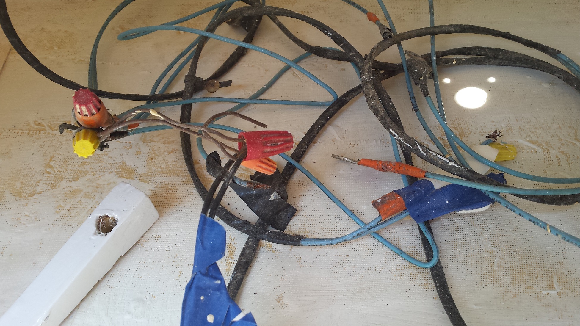

But now im thinking about conecting things back up. LOL, looked at a few wireing vid. Now look at how it was done when i bought it. Unbelievable. I am going to go with a prewired plug it harness I found, for a small boat basic wiring

I've never had a problem with the Rustoleum peeling off or chipping. I do add a hardening agent to it. Google "roll and tip painting" and there are numerous sites explaining the process.

i watched a few vids on wiring small boats worrisome lol so I found ezacdc.com makes things very simple and safe it looks like. charts instructions for basic setup. compared to how it was wired

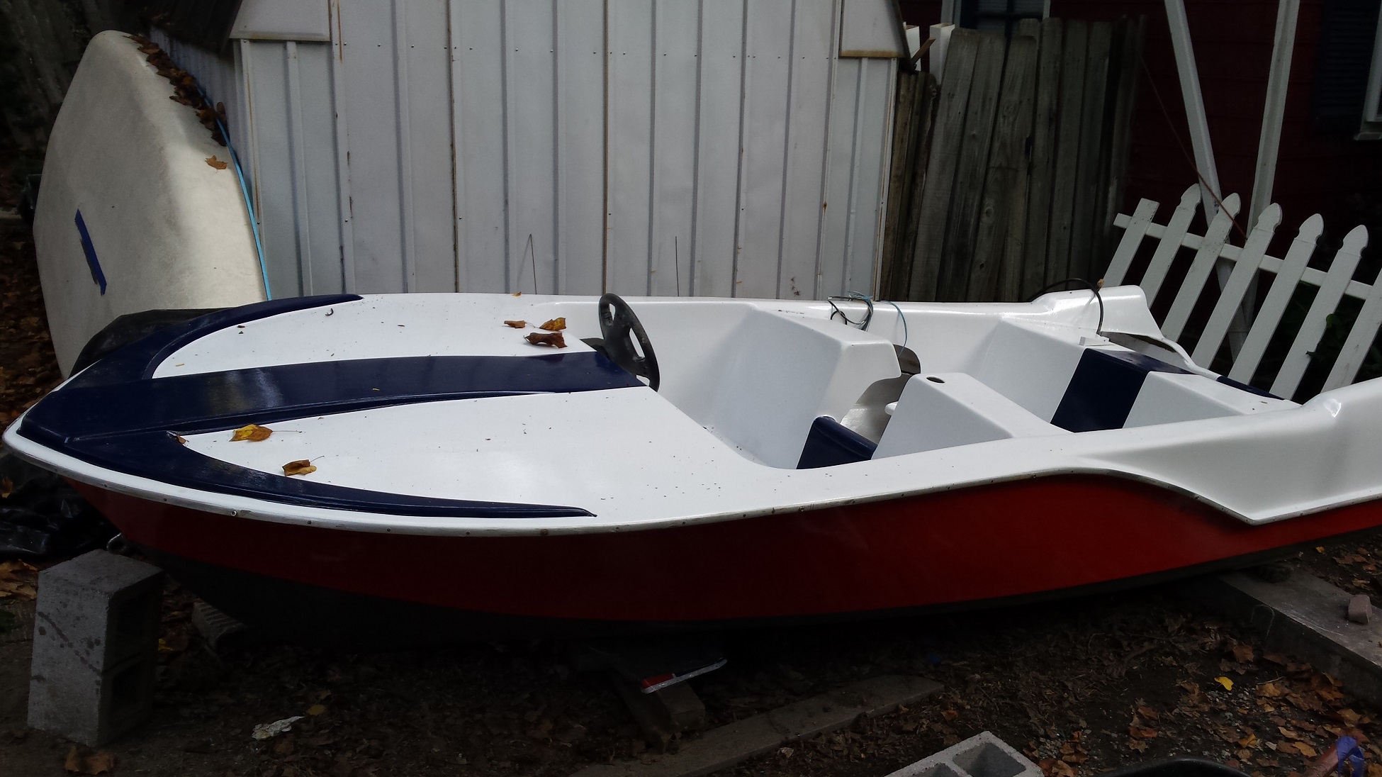

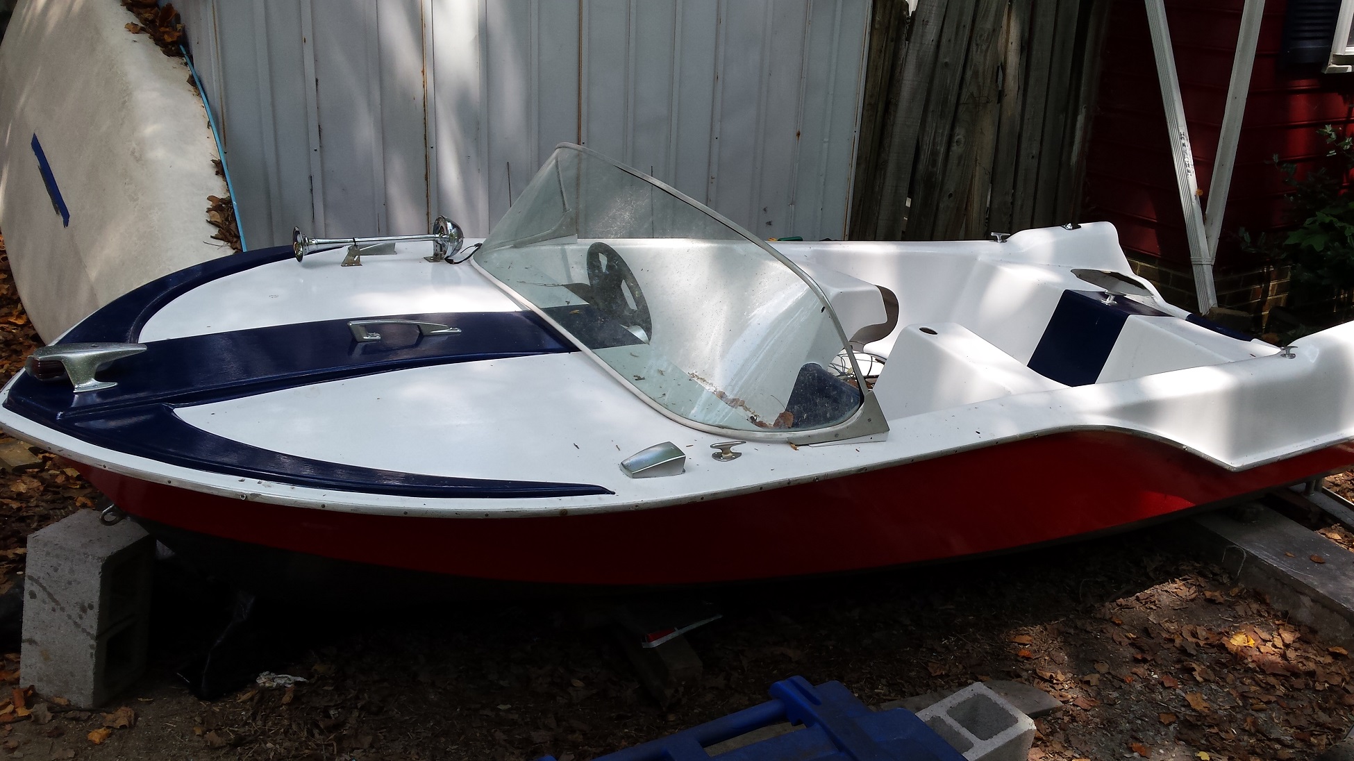

more or less finished with the paint job. might try to polish up the chrome strip. need to get the wire harness and start to put on the hardware . lights, cleats etc. And i may splurge and look for a 50ish style steering wheel that plastic one just is not very nice i think

looks great! if you want to bring that trim up nicely pick up a tube of autosol works wonders with minimal effort

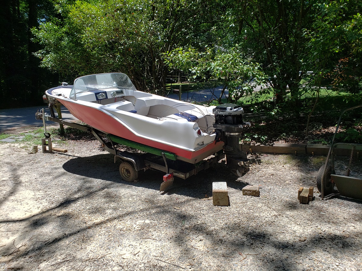

lake n sea project for a newbe 7 years 4 months ago #140216
Not that everone here is holding their breath about my project but .... OHHH it is going so slow to get this moving along . I put in a wiring harness which has way more features than i needed but..... and i dont have a picture of that, not everything is connected anyway.
I bought a used merc 35 hp ( old 70's or 80's ) "as is" I'm not even sure it would do anything and after watching some vids I did get it to crank. I had to get a gas line and connections that fit that motor I also bought a impeller, battery gas tank. It is very hard to find a Mechanic that works on motors, on the side at your house. SO, I broke down and took it to a local boat repair shop. It was the first time I had ever towed a boat on a trailer. I also bought a rear view camera on amazon to help with seeing the boat and trailer, as my truck has a tool camper in the bed. I had to get the boat on the trailer and the motor on the boat as he said thats the way they like to have then come in for work, just leave the boat and motor with them. I hope they don't take the rest of the summer to get to it.

My eyes aren’t the best, but zooming in on your motor, the lower decals look like maybe 1967 or possibly 66. I couldn’t remember what year had the 2 hashes on the bracket rail. Seems like I am seeing the chrome foil look. Didn’t have that in 65 or earlier and I believe red color was introduced in 1968. The real Merc experts can tell you for sure and a serial number will tell the story.
Dr.Go!

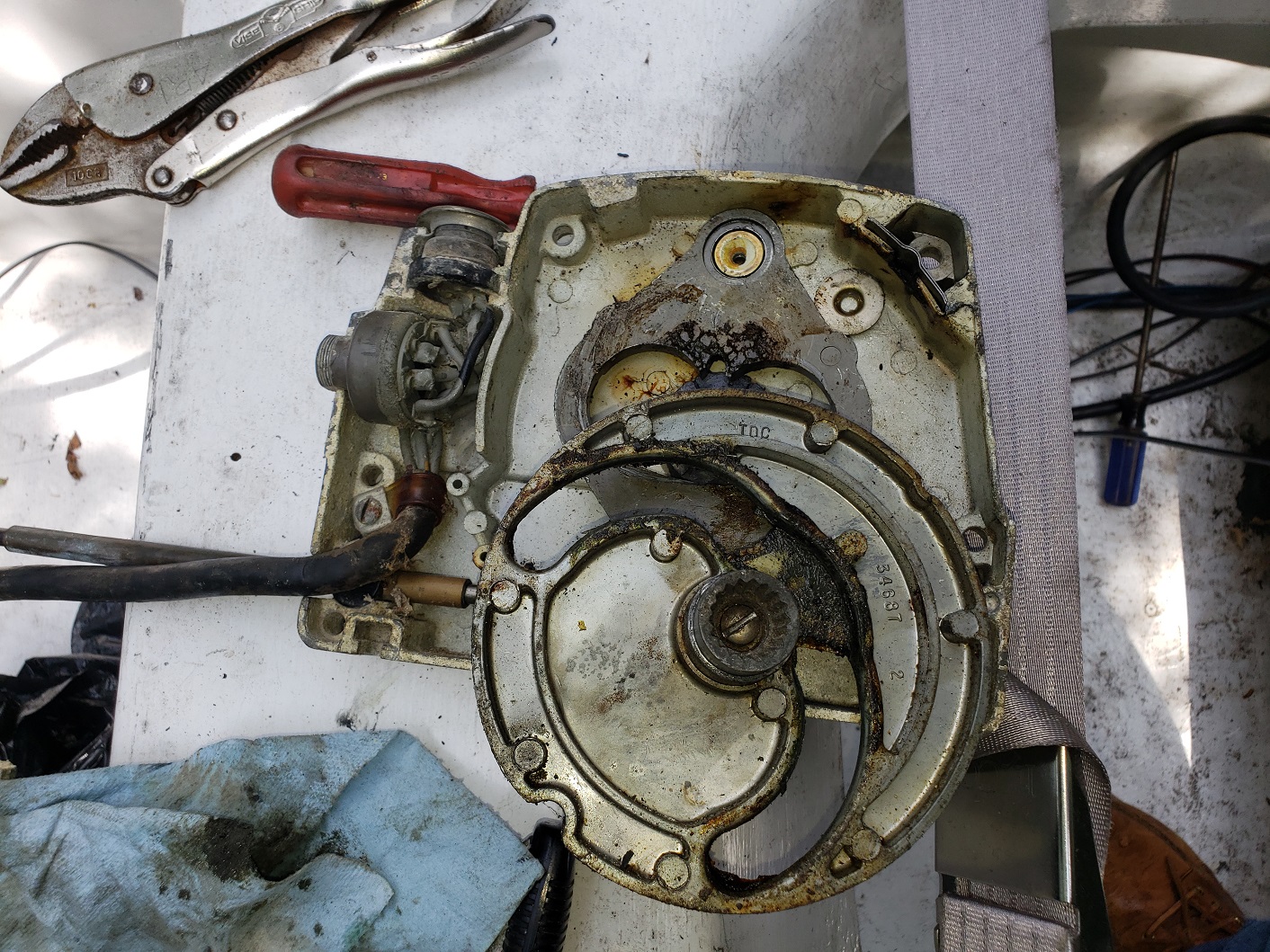

long in coming but a little update. found a 50.00 motor did not know if it even worked. 35hp mercury I found out it's a 1966. I posted some comments about it in the mercury forum
titled: outboard merc350 35hp mid 1960's need fuel lines
short vid after some tinkering ( new impeller)
of the motor runing
it had control box and cables, cables need to be longer the control box needed a few parts found joe Poole at www.fergusonpoolemarine.com very very helpful and with lots of unique insights to repairs etc.

lake n sea project for a newbe 7 years 1 month ago #141058
making progress on the motor . I'm just very lucky too, it seems to run pretty good. I only paid $50.00 for motor cables and control box ( did not know if it would even run ) and needed a few parts which I got from Ferguson -Poole Inc.

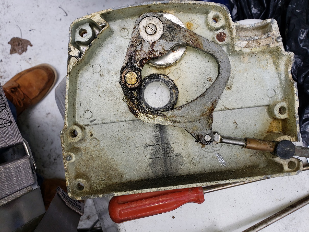

1. i did have to buy longer control box cables and one of the leavers ( cleaned and lubed the box) got lots of good help form Joe Poole
2. the steering cable was too long so i reversed the side of the boat it ran along to the back and that took up the slack, also had to spend a lot of time freeing up the sliding arm at the end of the cable
3. the tube on the motor was too small for the sliding arm on the cable, so i found a tube attachment that screws onto the transom
4. had a guy help me take of the lower unit and replace the impeller
5. bought a battery
Now, the engine is cranking up and running and the lights and horn work :)

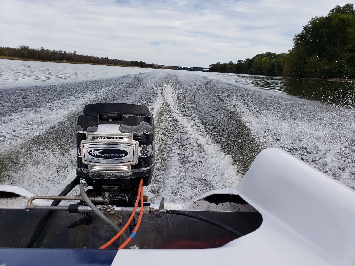

lake n sea project for a newbe 7 years 3 weeks ago #141218

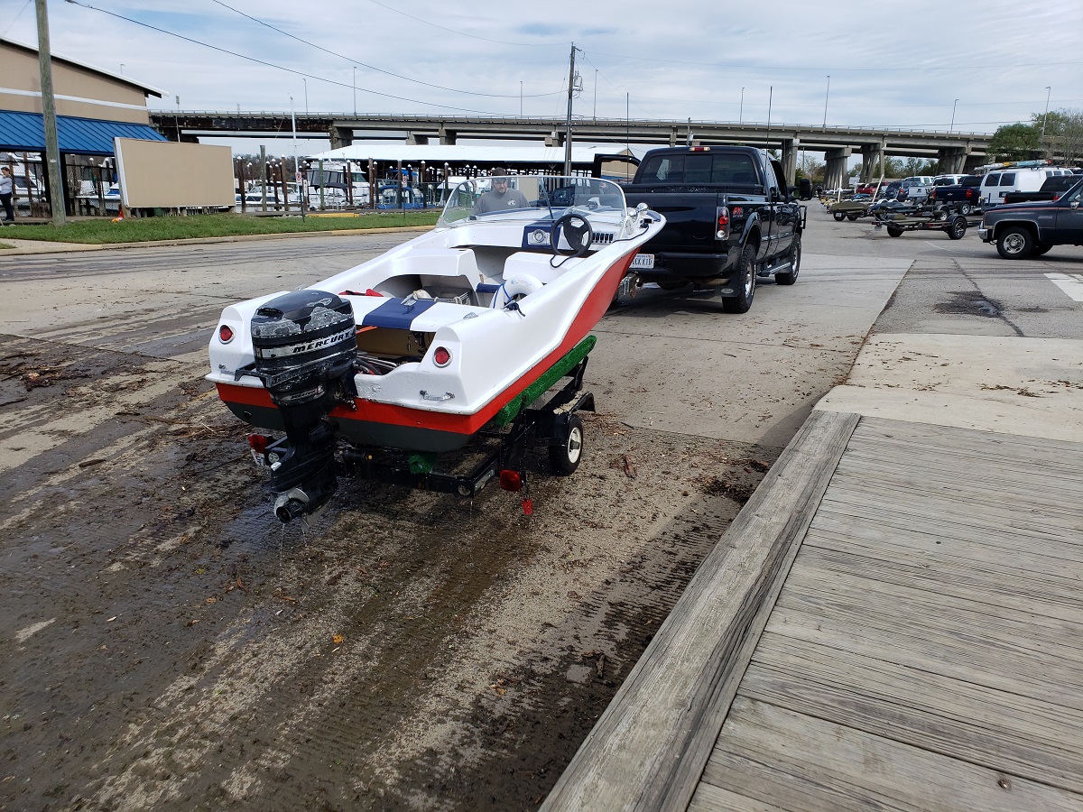

FINALY a test run....... got it in......It Floats........ motor works ( did not leave us stranded for the short test run)...got it back on the trailer. A couple of pics and videos
I could not get the videos to post but here is a link to view them in dropbox.com
www.dropbox.com/sh/tn9vxwcrtfddbrd/AAA6vgqIEHDWnLbDClvYNnZLa?dl=0

Looking great. Worth all the effort. Good job.
Problem keeping my laptop keyboard dry....all the water kept draining out from the sideways pics :)
