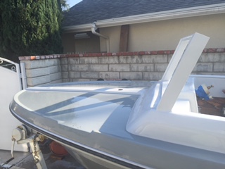

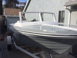

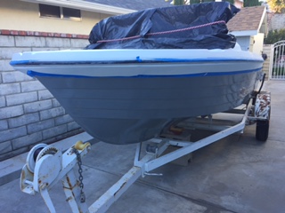

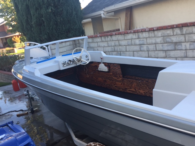

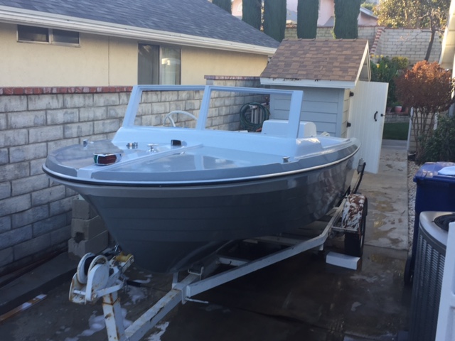

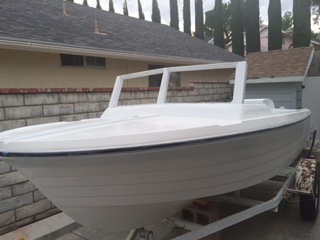

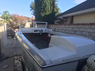

Hey there, New member here, stumbled upon this gem of a site when I was trying to figure out what exact model I, restoring! My great uncles boat- Arkansas Traveler (or Stanray Corp) actually I have had a heck of a time referencing any info on this boat. Think it may be an Atlas, but then again most Atlas models seem to have an outboard of some sort. Anyhoo, This boat sat at my Uncs dock for a lonnggg time, and he passed away, and left it to my Gramps. He eventually had the carbs rebuilt, new water pump and tune up. started doing the hull and topside restoration and pulled the plug.

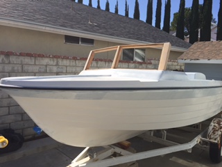

I Took it down almost to the fiberglass darn near the entire boat because of spider cracks and dings and boo boos every where.. Filled with new fiber glass, west systems epoxy and 404 high density filler. uses awlgrip 2 part finishing primer took about three coats. then roll and tip awlgrip battleship gray and whisper gray. all done solo first time ever touching a boat and just finished the last coat of whisper grey yesterday. Took about 6 months steady after work. now on the re installing the hard wear and fuel system up keep and then maden voyage. Oh yeah, Gramps broke the windshield so this one is fabricated from red oak. shouls have used a lot more resin, and a lot more elbow grease but hey, gotta move on. Thanks for any info on this wonderful and mystil boat. family boat for 2 or three generationa If you know what this is or have any info- fire away Folks. Thanks!, Kevin C.

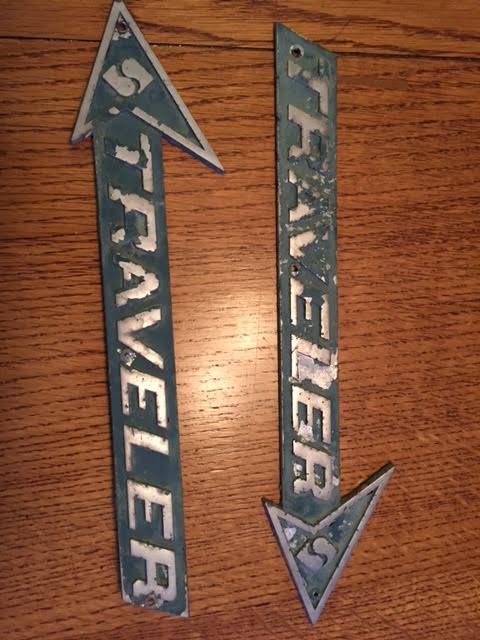

Great job! I am in the process of restoring a 1960 Arkansas Traveler Rocket, she is coming along nicely. I'll post before and after when completed. In my quest for her badges, I found an old Atlas Traveler and negotiated the removal of the Traveler badges/emblems aluminum. Would you be interested in these?
Re:My first boat project, Great uncles 66 Traveler 9 years 5 months ago #130436
Hello there. Thanks. In fact just took the boat for her maiden voyage toss weekend. The sweet smell of victory. Yes I am interested. Any idea what they came off of? I believe my gramps has the badges for my old altlas somewhere. But we cannot find them. I would gladly take those. How much are you asking for them? And why aren't you needing them?
