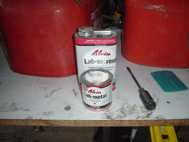

You really can't remove dents. I've used "lab metal" to fill small dents, but you can find tanks on Craigslist for $25.
