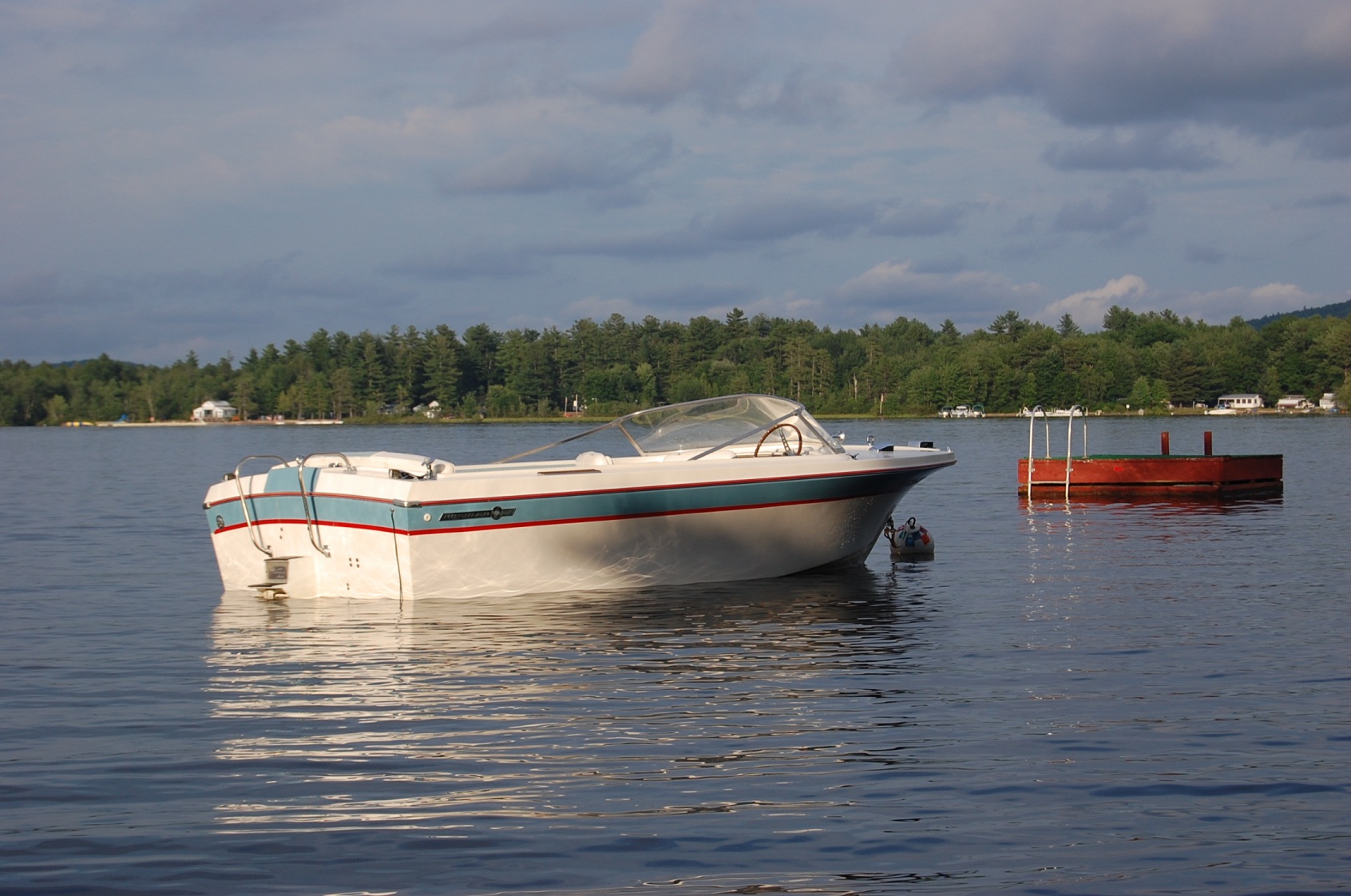

Here's the options page of the '69 brochure. I was mistaken in recalling that it actually noted the wheel as being specific to a Mustang. Just says "wood grain". The center cap on the wheel (under the Buehler logo) is, however, the plastic mustang logo.
I think you're exactly right.....when doing some searches online, I think I concluded that it's a GT wheel.

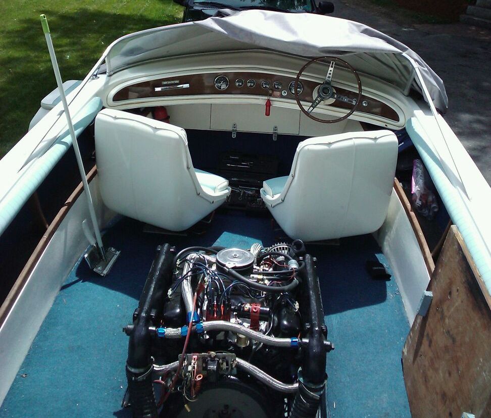

Here's another pic. I'll try to dig up some better interior shots.

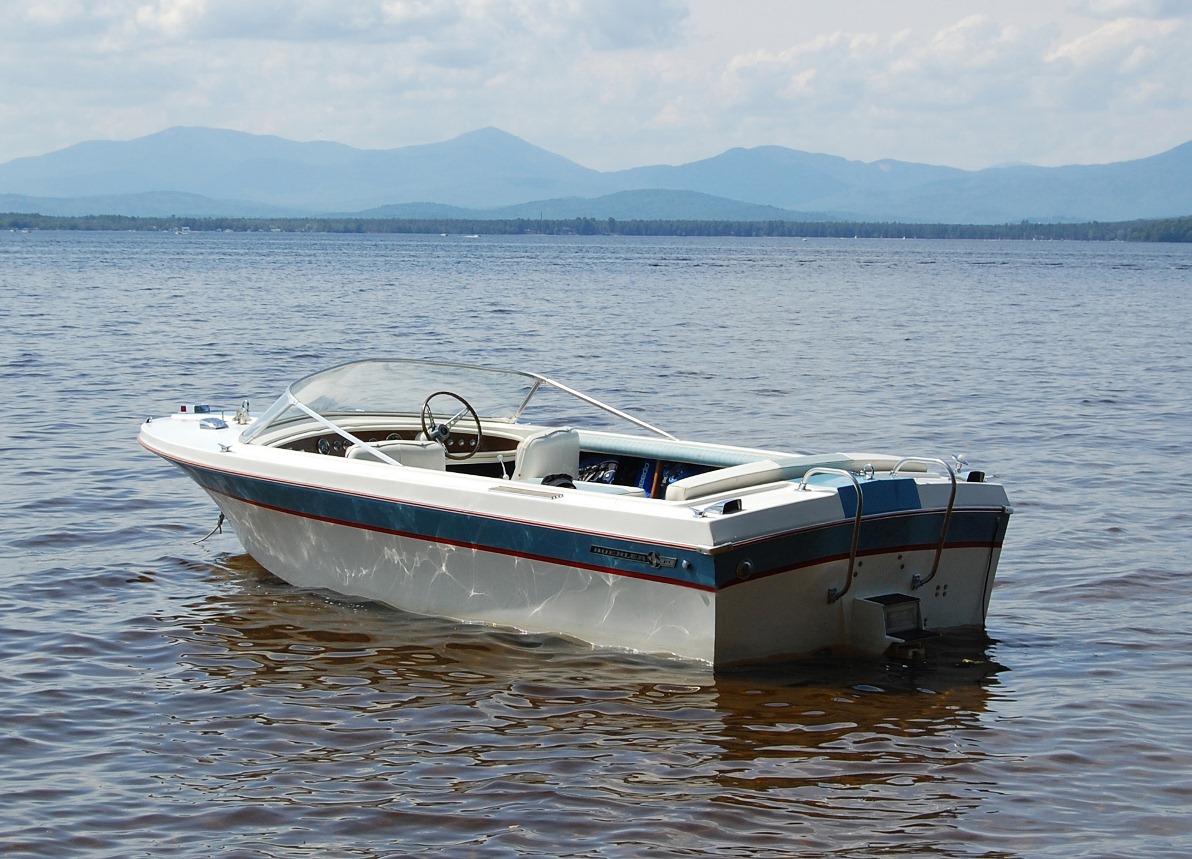

My dad just gave me my childhood boat (A 69 buehler jet bolero). But i cannot find any info or pics of the 69. Any ideas for my as i am in North Carolina and the boat is in Michigan. My dad has taken care of it like it was his baby since it arrived in our family in 1974.
Re:1962 Buehler Turbocraft Jet 35 Windshield 14 years 1 month ago #67332
Chameleon, The picture of the Bolero in this link would be just like yours. To the best of my knowledge, Buehler did not change the hull design during production. They may have changed the color options, but nothing major in hull design.

As for your drive, what you’re describing is the standard Buehler pump design as of the mid-late 60’s. The “Z” simply denotes a specific impeller……not a unique drive unit/pump. That cover you refer to was added in later years so that one could remove a ski rope, etc. that had been sucked up through the grate.
Toward the rear of the pump, angled toward the right if you’re looking to the stern, you’ll see a 2-3” circle protruding from the pump. At one time (pre Chrysler power), Buehler’s cooled their engines via the jet drive (Hornet’s may be like this). The center of that circle is where they would have tapped it for the plumbing. When they switched over to Chrysler engines, Chrysler Marine said they wouldn’t warranty the engines if they were cooled via the pump……hence the Sherwood raw water pumps on the later, Chrysler powered, models. You can still tap that hole and ditch your Sherwood. It’s actually more reliable than a RW impeller because, as long as the jet’s spinning, you’re getting water. The only downside is that, depending on where you’re boating, anything you’re sucking into the pump (sand, weeds, etc.) may be delivered through the engine.
A note about your 360 install. It’s a good call, however, if you want to get the most out of it, performance wise, you may want to consider having your impellers tweaked for the engine’s specs (cam/RPM, HP, etc.). 360's generally don’t build-out to spin as high as 318’s and 340’s so, RMP wise, you may be close to what that 273 would have done. Also, if you’ve done the heads, etc. you might want to consider some Hitek exhaust manifolds (the only company, to my knowledge, that makes a performance exhaust for a small block Chrysler). The stock Chrysler marine manifolds will limit/choke a built-up engine.

So I have a question for you? Where does your engine RPM at full throttle? Or whats the highest RPM you see at wide open throttle? What rpm is a typical cruise? How long does it take to get to full speed?
Since I have not had my boat out I am curious. Do you have the older Three stage jet or the later two stage Z drive?
Re:1962 Buehler Turbocraft Jet 35 Windshield 14 years 1 month ago #67651
I looked at this Video on You Tube......Was this your grandfathers boat? If you are it looks like you did not know what he did to the impellers?
The Z drive is a two stage. It does not have 3 impellers only two. I have mine apart now. One large bronze impeller and one small stainless.
On antique boat .com there is a three stage for sale that comes with optional impellers from Buehler that were offered. Maybe you have those.
I would like to know if you have a clean out on your drive?
Re:1962 Buehler Turbocraft Jet 35 Windshield 14 years 1 month ago #67671
Taking in to account that the tech that is in the boat is 40+ years old the motor tops around 5200rpm and a good cruising rpm is 3500 to 3600 rpm. to get to full speed is around 1/4 to 1/2 mile, these distances are base on the fact the Ohio river is around 1 mile wide where I use the boat.It pop right out of the water 150/200 yards. I have a two stage pump. Since you have your pump apart, Between the bronze and stainless impellers inside the main housing is a rubber cutlass bearing (it is removable) it is the only real problem I have had with mine, the previous owner started it out of the water and ruined it, I could not find anything out about it 20 years ago so I had a shoe cobbler make me one out of a piece shoe sole worked for 15 years, 2 years ago I found a 69 bolero on craigslist (free) in Tampa Fl. it still had the 2 stage pump in so I made the trip to Fl. and picked it up So I have all the parts for another pump. The boat itself was toast after being in the Fl. sun for 40 years But I still have just in case I might need something. My boat looks just like the pic. BogdenZ posted a couple of weeks ago. Thanks
