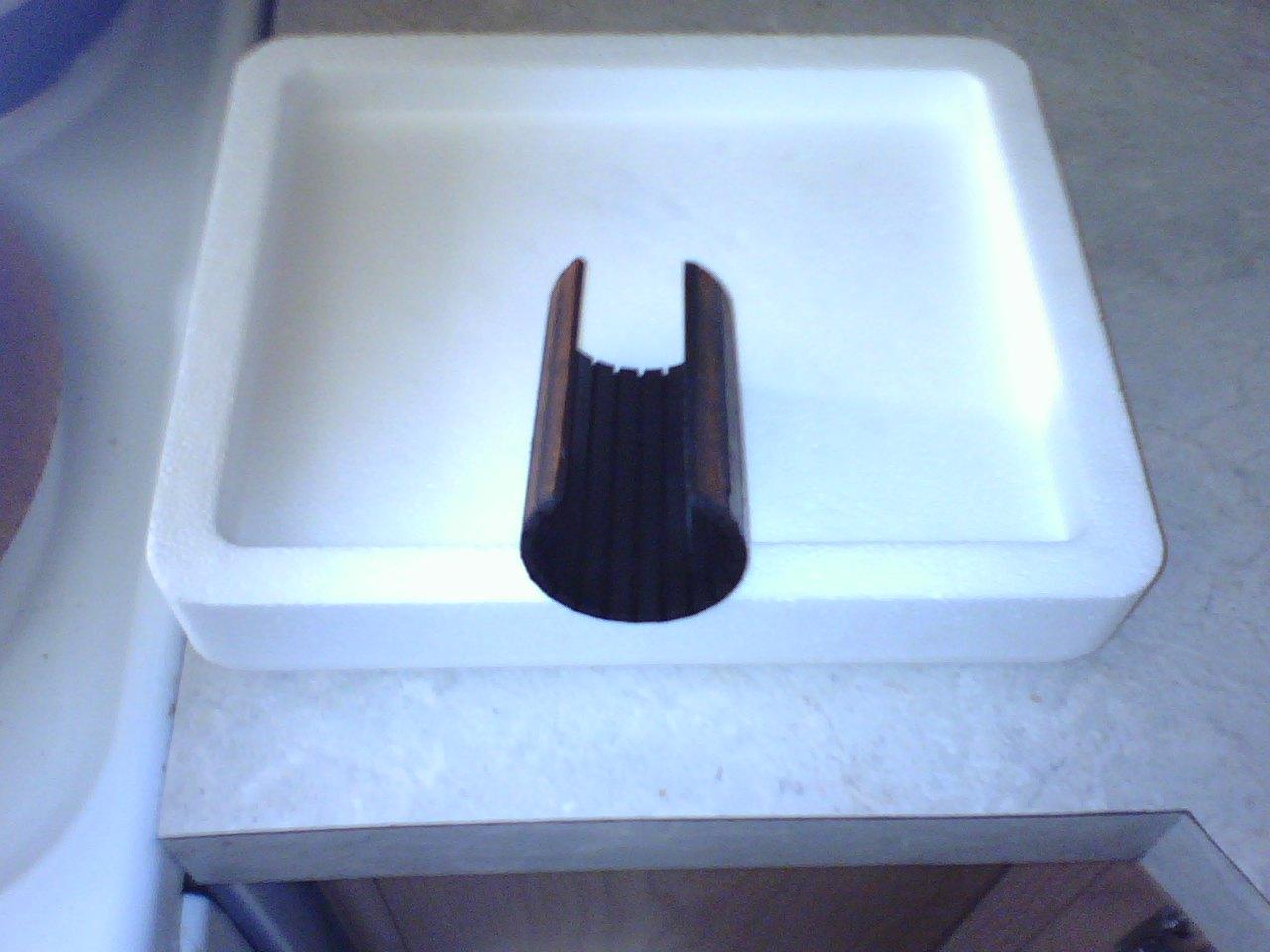

How big is the cutlass bearing.....I am wondering if you could ditch that bearing and run a ceramic bearing and water cool it...dont have to take the driveshaft off then to run the engine.
Do you have a picture of that bearing?

I have tried to attach a couple of Pictures I have of the cutlass bearing and where it is located in the housing. The only drawing I have is of the 3 stage pump. If you have the tapered piece off it is easy to take the rest of the pump apart. Take the castle nut off the main shaft remove the stainless impeller, unbolt the main housing and in should slide right off the shaft. I looked at some notes I have, the bearing is only .125 thick 4.135 long. the shaft has a stainless sleeve on it that is also removeable. I have in my notes the the running clearance in my pump is .035 I have a file with pictures of my pump all apart. I can't attach it as it is to large. As to how fast the boat goes at top end (no gps) is around 42 to 45 mph, that is based on the speed of other boats my friends have. I still cool my motor with the sherwood water pump. Had to replace the impellers twice in 20 years, engine temp is between 165 to 185, depends on the outside water temp. I have a tapered rear housing with the fitting in it to cool the motor, I picked it up a couple of years ago just so I would have it. I could take a picure of it if it would help you. When I had trouble finding the bearing I was going to bore out the main housing a install a morse brass shell marine bearing, part no. Q5570.Instead I used the bearing out of the pump I got out of Fl. so I didn't have to go that route, still like to find someone to make me that bearing so I would a spare.

Johnny - based on what you're saying about your pump and it's play, it couldn't hurt to check the bearings (there are actaully two sandwhiched together). You can still buy them. It's also important to make sure the castle nut on the front of the pump (on the shaft) is tight. When people who don't know jets mess with these pumps, they often go finger-tight on that nut (the way you would on a trailer wheel bearing, for example). That's not the case with these nuts. I want to say it should be 150'ish ft lbs.

I decided not to install a new cutlass bearing.even though there is SOME movement, I don't think it is enough to warrant removal at this time. We have the same pump it looks like..I sent you some pictures. My serial number is 5794Z Same Model and Assembly however. Do you have the cleanout? And from what I gathered your last assembly is not tapered?
