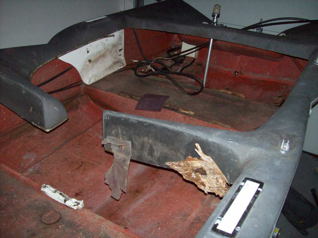

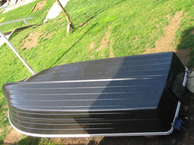

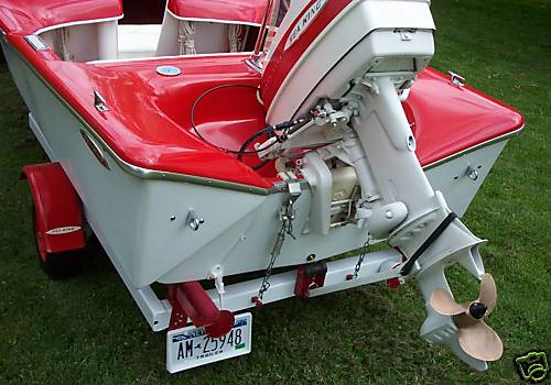

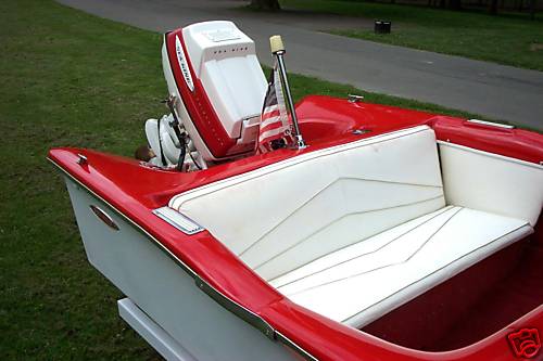

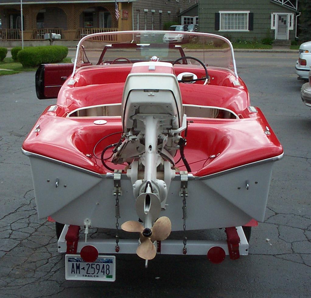

Another pic of the rear. Right now the deck is off and I'm sanding away so I can get it prepped for paint. The ply is delaminating in the transom, so after I get the deck painted I have to replace the wood in the seats and in the transom. I happen to pick up a 1960 evinrude 40hp lark II and a whole ton of parts for $10. The guy put a snap ring in the wrong place when he installed a new clutch dog. He also couldn't get the shift rods to realign, so he gave up. I went through it, and put it back together and everything lined right back up for me. He even put a brand new impeller and housing in it. It was running last season, so I'm hopeful. Then I ran into a guy selling an early 60's Chrysler 50hp. Turns out he just needed a router table minus the router. I had one he could have and now I have that motor as well... controls and all. It's all free, but a few mud dobbers have made some nests. Luckily, not in the carb.
Re:A little help for a Span sea king 16 years 9 months ago #654

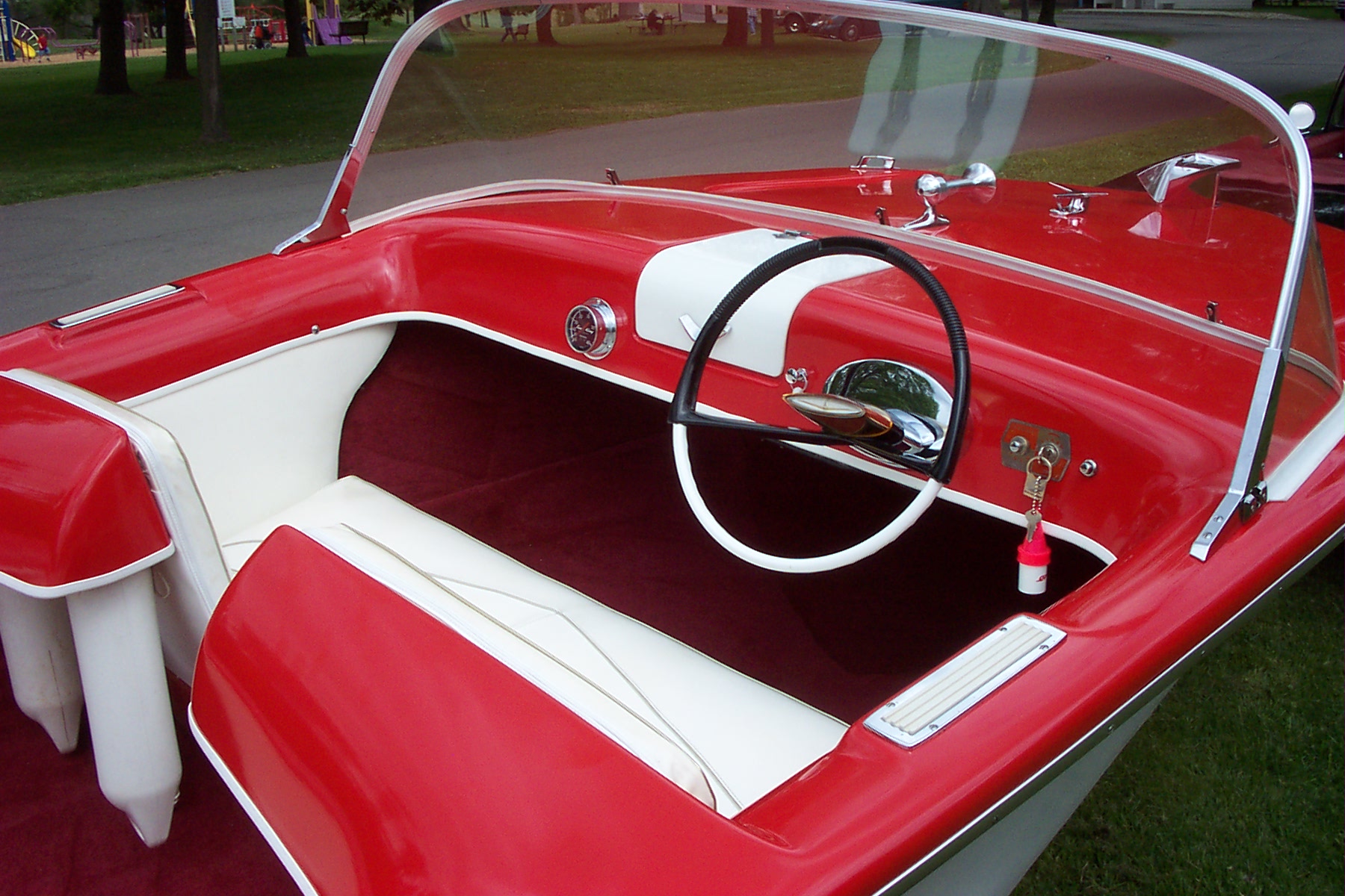

You seem to be a good scrounger which is a useful talent to have if interested in old boats. Or maybe the interest in old boats comes from that talent?
Anyhow, I am quite sure the steering wheel is an Attwood Seaflite. Very classy steering wheel and very much a 1950's design. Too often these were replaced when the steering was upgraded from pulley and cable to rack and pinion or other modern type.
From the one rope chock clearly visible in the first image, I would guess you at least some Attwood hardware. Classicfins is right about cost- if you have this little into your boat already, it might be good to keep scrounging for good used hardware either locally, here in the Glassifieds, or on the 'bay. Replating makes for a very nice but comparatively expensive finishing touch to a boat and is often best complemented by a professional-quality paint job.

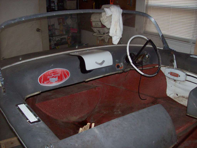

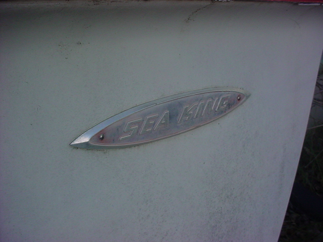

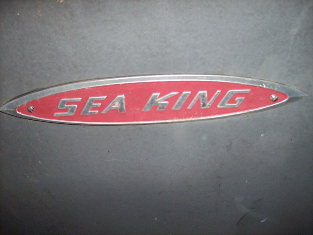

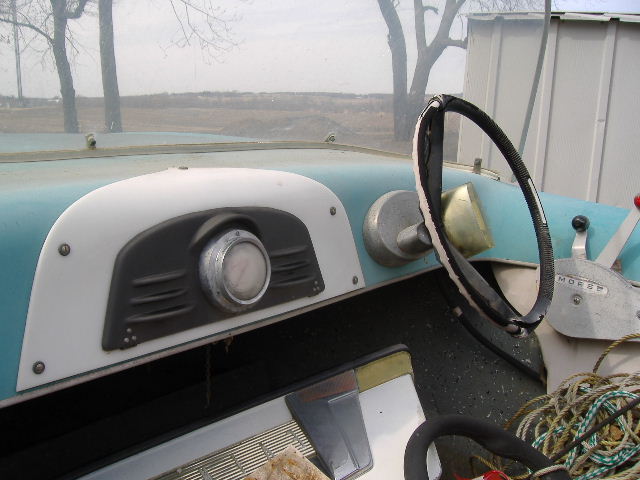

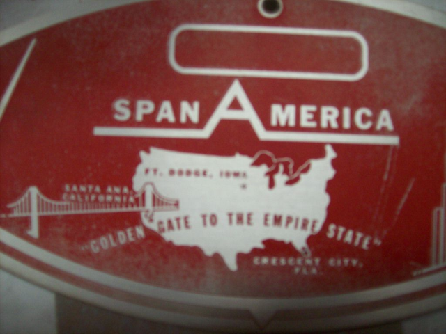

I'd love to see a close up and detailed photo of the logo on the dashboard. Is there any indication on the boat that it's a SeaKing?
I am researching the history of Span America Boat Co. and Span Boats, Inc. for an eventual article along with related boat firms.

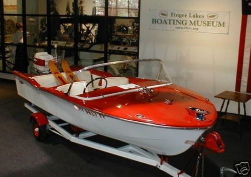

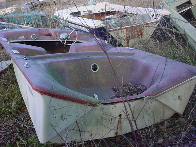

Sea King built one with the same body style as the Span American. It was probably more like Span Amercian built them for Sea King. I've seen 3 of them with the sea king badge. 2 of the ones I saw had a rounder nose than the model he has, and looked to be more like 16 or 17 footers. But one had the sharp nose just like his. There was a beautiful teal and white Span America posted here a couple of years back.
Here's one of the larger Sea Kings with the round nose that I found at Captain Hook's. I can't find the photos of the teal teal Span American, but it was a perfect match to this Sea King. It would be interesting to know if there was a connection between the two companies.

I think you have a nice boat. There are many old bowlights out there and most would look great. I would go with what you think looks best. Tell your wife that this is a safe non-addicting hobby. There is no danger that you will get sucked into Classic boating. She'll forgive for lying to her one day. :kiss: :lol:

Thanks for the close up photos.
Montgomery Ward's Sea King did NOT make boats. They bought boats from existing boat builders and they were badged with the Sea King brand name. Same goes for the Sea King outboard motos and trailers. It was just like Sears and their Elgin brand of boats, motors and trailers. Sears did not make these products. Western Auto had a Wizard brand of outboard mtoors and boats but they did not make 'em. Gambles Skogmo sold their own brand of outboard motors but did not make 'em.
Sea King had wooden strip-built boats made for them by Chetek Boat Corp. for a number of years. Cruisers, Inc. sold about 1,000 lapstrake boats to Sea King/Monkey Wards one year.
I am surprised that Wards/Sea King would allow Span America to put their own logo on the boat.
Span America Boat Co. combined with Fort Dodge Boat Co. to make boats for Monkey Wards. The two boat firms were within spitting distance (literally) of one another in Fort Dodge, Iowa. One firm made the hull and the other made the deck. They must have had 'em assembled and finished off by one of the firms.
Same old story, but this deal with Monkey Wards was a major contributor to Span America ending up in bankruptcy in 1961/62. They ignorned their regular dealers and concentrated on the large Monkey Wards contract. Their dealers jumped ship and took up other brands. Once the deal with Wards was over, Span America did not have any customer base. Deals with the big retailers put many boat builders out of business.
Andreas

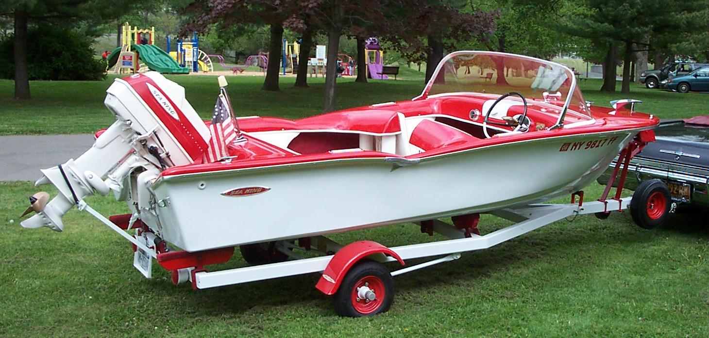

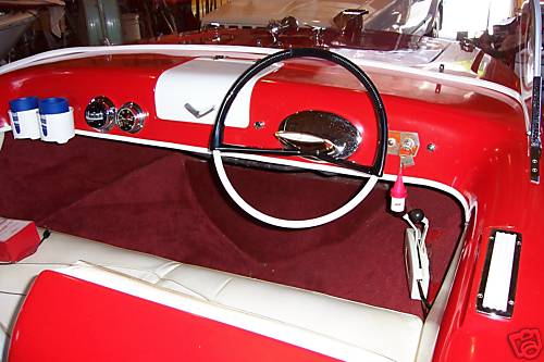

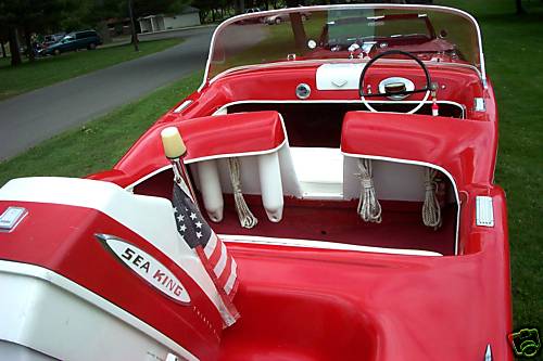

Well what you have looks exactly the same as the boat I’m restoring. My boat is a 1960 Sea king runabout. As others have said Span America made the hull, Atwood the hardware, Gale produced the motors for Sea king at that time. My boat is & was a total mess! All of the hardware is damaged or missing, no motor, broken trailer ect. Much of this has been replace/found or in the process of repair. I have found everything I have needed on Ebay. The only part that is expensive to replace is the steering wheel asy. It took me a long time to find one under $200.00. Every time one pops up it goes for top dollar!!!! A member here by the name of Bob had the same boat, fully restored & all original. Very nice piece!!! I have used pictures of his boat as a reference & inspiration for mine. I had emailed him & he gave me some info on the boat ect. Here are some pictures of Bob’s old boat.. See my post's for my boat pic's.

What a beautiful boat. Simply sexy. My thousand dollar question is how are the front seats built? I know that they are attached to the seat backs that are fiberglass (and flimsy) but I'm every bit of 225 and I'm afraid that I'll lean back and snap off the fiberglass.
Re:A little help for a Span sea king 16 years 9 months ago #830
Well here is a picture of what was in place on my boat. I’m planning on doing a slightly different approach but similar. Then making a removable seat back & bottoms. I’m 235+ some days, hahaah! So I know what you mean.
Ok… the picture isn’t posting for what ever reason. Basically there is a piece of ½” plywood that runs from the top of the seat back & attaches to the seat bottom.

FIrst Related to HP for these little babies they were rated at 60 HP. SO go ahead and put the Chrysler on it. If you need any parts for that I have a buddy that has parts to know end. I am a member of the Chrysler Crew too so I can get almost anything you may need for them. Regarding the Red boat well what can I say that sure is Purdy. I have pics of a all original 59 vip and the interior looks very different than that one but as I have seen on spans they are different boat to boat. The later years had deluxe interior packages that are really nice but cost a small fortune to restore. I have a vendor for the fabric and best do some saving up for that one if your all about original. BUT you can save HUndreds of bucks but using off the shelf colors and they look just fine.
Just some Span America Trivia for ya all. In 58 they didn't have the glove box option and in 59 they had the flat one with the big V on it and in 60 it changed to the picture below so when you try to figure out what year you have you can by the glove box design. As for the Sea King name on the Spans that only was one year from what I have found in the last few days and that was 59. They did make more boats for Monkey Wards but with the Span America name in 60. Andreas is very right with his comment that this contract with Span America was to kill the boat company. The had 3 plants around the US and just plain grew to fast. They couldn't produe what they sold do to to small of factories. Another interesting thing is the Hull shape, Designed by the Musick Brothers in 58 never really changed. Adding the Lapstrike design to the side was in 61 but the bottom stayed the same all the way to 68. The design just plan worked, they handle well. They are fast and corner very well. I really hope that Andreas gets time to finish what he worked so hard on last summer regarding this company because its a amazing story.
Cowboy
Once you bolt the seat back to the fiberglass part they won't be near as flimsy. I'm 300 lbs and have a couple of boats with that style seat and have no worries. If you want to, bolt some wood into place as the seats would be, flip the entire boat over and set up on some saw horses. Then glass in some extra layers of fiberglass to strenghten them up. Just make sure they are bolted up as the will be in use so that everything fits back together right once it all dries.

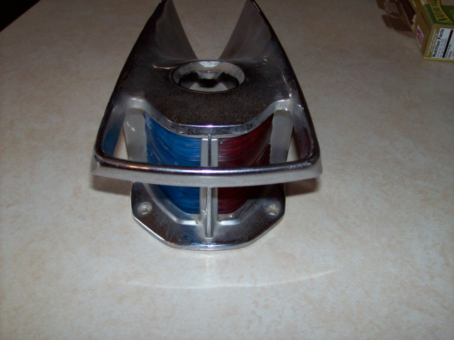

Well, a quick update... Found this bow light locally a boat place that turns out to have a whole used section of parts... If you are local in Kansas City; KC Boatworks has quite a nice selection. Anyway, picked up the light for $40. Not exactly a steal, but it's what I was looking for and just lucky that I ran across it. My only prob is that the top part is missing. If anyone has, or has seen one, let me know. Got the top deck final sanded today and hopefully will get paint going within the week. Thanks for all the interior pic too!

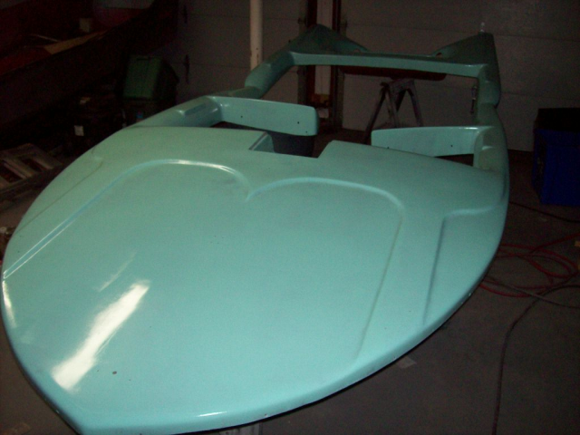

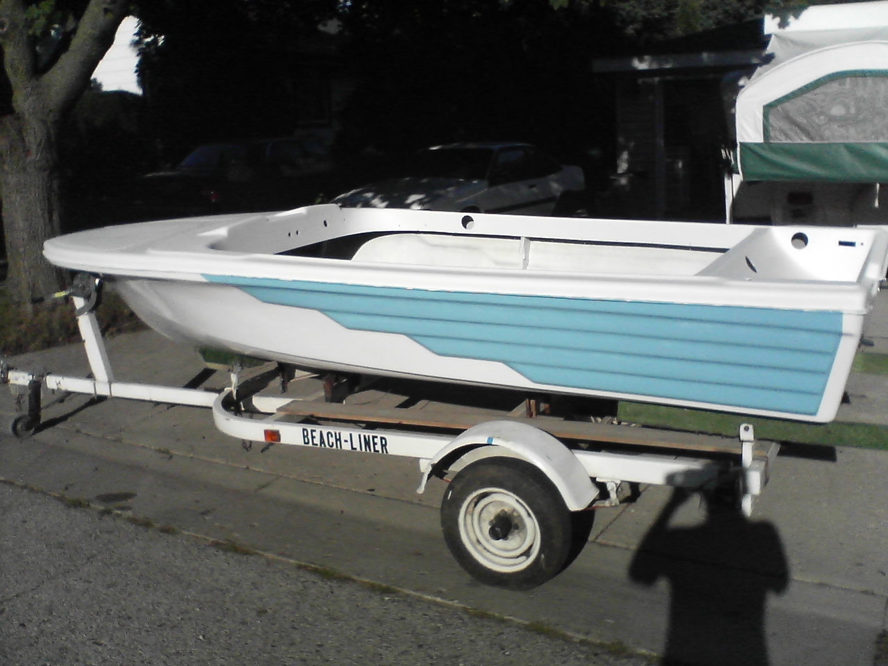

Here are some more pics after this afternoon's bout with some paint. It's the first coat... The paint is about $35 a Gallon. Sherwin Williams offers a Industrial and Marine Alkyd enamel paint. I used the roll/roll method with a foam roller. So far it's been worth the money. Boats have been painted with this type of paint for many years it turns out. Hopefully 2 more coats and the topside will be finished with all the hard work. If feel like it was a success for two reasons: 1) I didn't flip the paint tray over or step in it and 2) it looks pretty decent on the darker side of the garage.
I've got a flag pole that fits that light that I was going to list in the glassifieds once I dug it out and took some pictures. I used to have one of the plain covers, but I will have to look to see if I still have it.
Re:A little help for a Span sea king 16 years 8 months ago #1111
Cool stuff! I’m guessing your existing gel coat is in much better condition then mine is in. I’m going to need to sand my deck to bare glass & rewrap it in 6oz cloth. The gel coat on my boat is totally beat! I would get that flag pole classicfins is talking about. It is going to be hard to find that cover on its own. The light you got is the one that belongs on the boat. They normally sell for $35-75 on eBay depending on the condition & who is looking for that light at the time. So it would defiantly be better than starting over.

Re:A little help for a Span sea king 16 years 8 months ago #1590
I also used the foam roller method of applying my top and botom coats. Worked fantastic. Actually had people ask where I had the new gel coat put on, haha. Makes you feel good when you get comments like that.
