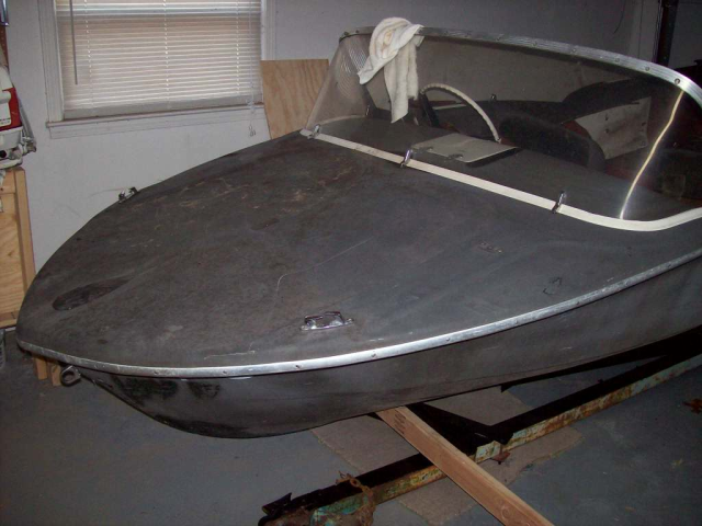

First off this forum is great! I aquired this Sea king/Span America 14 ft boat early this winter to fix up for the summer. I'm a young guy and (cough) didn't quite grow up until 20 years after my boat was made. My question is about the unique bow light this boat once had and how I can aquire another? Mine is missing, but most of the rest of the boat is still there. If I were to find another light, can they be taken apart to have the chrome replated?
Thanks to anyone on this board that can help.

You seem to be a good scrounger which is a useful talent to have if interested in old boats. Or maybe the interest in old boats comes from that talent?
Anyhow, I am quite sure the steering wheel is an Attwood Seaflite. Very classy steering wheel and very much a 1950's design. Too often these were replaced when the steering was upgraded from pulley and cable to rack and pinion or other modern type.
From the one rope chock clearly visible in the first image, I would guess you at least some Attwood hardware. Classicfins is right about cost- if you have this little into your boat already, it might be good to keep scrounging for good used hardware either locally, here in the Glassifieds, or on the 'bay. Replating makes for a very nice but comparatively expensive finishing touch to a boat and is often best complemented by a professional-quality paint job.
