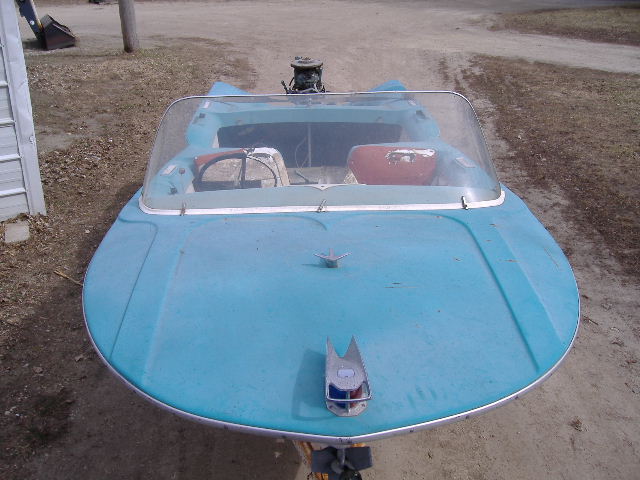

Eriks boat is smaller and has a different windshield than the VIP. Here is a pic of my 1960 VIP Hardtop, well with the top off that is. If you want diamemtions I can get them for you. I can't wait to see pics of yours too. These are really rare and there is only a hand full left in the world today. The VIPs were quite the boat in the day.

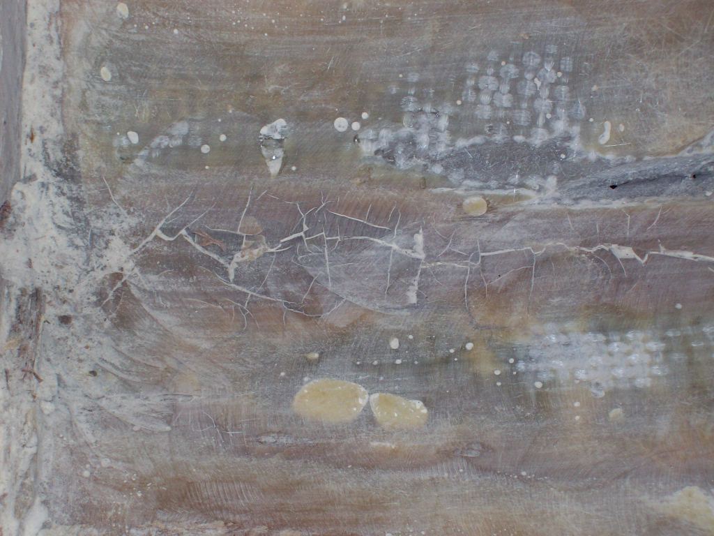

What kind of marine primer did you use? I am shocked that the cracks didn't come back most do. I do have some boats here that will never see he water again and be display only that I could use a cheaper way to restore them. Gel coating all boats I have is just not financially realistic. I would still use top grade top coat paint.

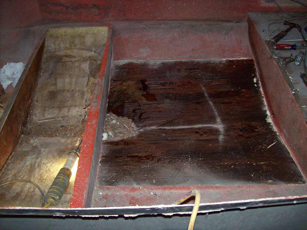

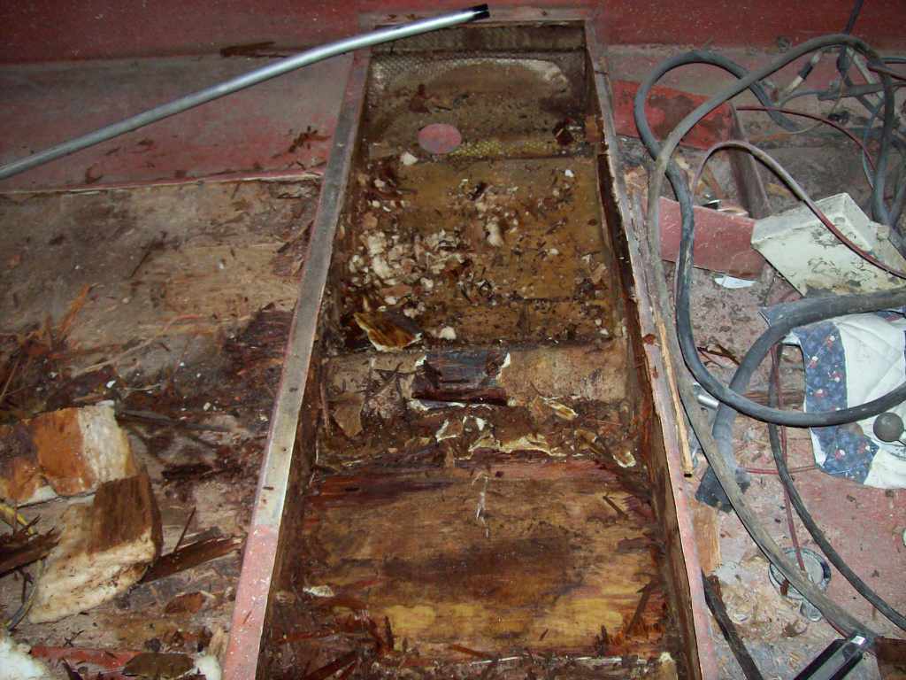

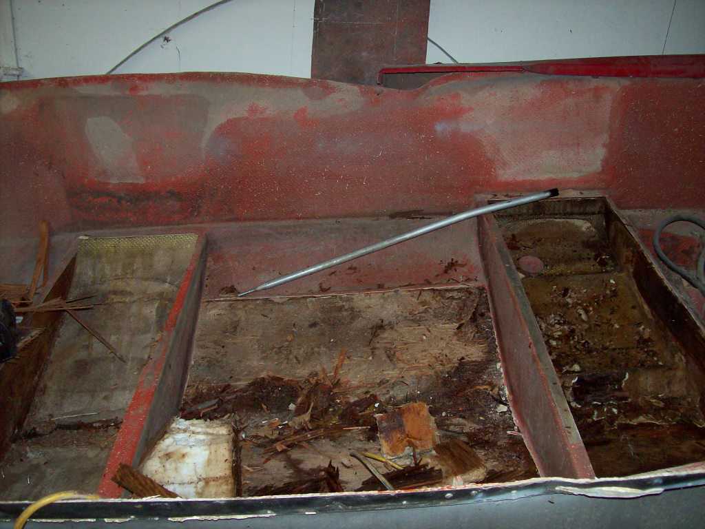

Well, the middle seat is out and the floor between the two seats is out. The pic shows a soggy 1/4" ply but it's made into 4 strips. I plan to just cut two pieces for the floor and butt them together and then glass them together. I'm just going to set the old fiberglass floor back in and glass it back in as well. I plan on rolling on some no-slip paint inside. I'm still considering bracing the seats differently than the way it was.

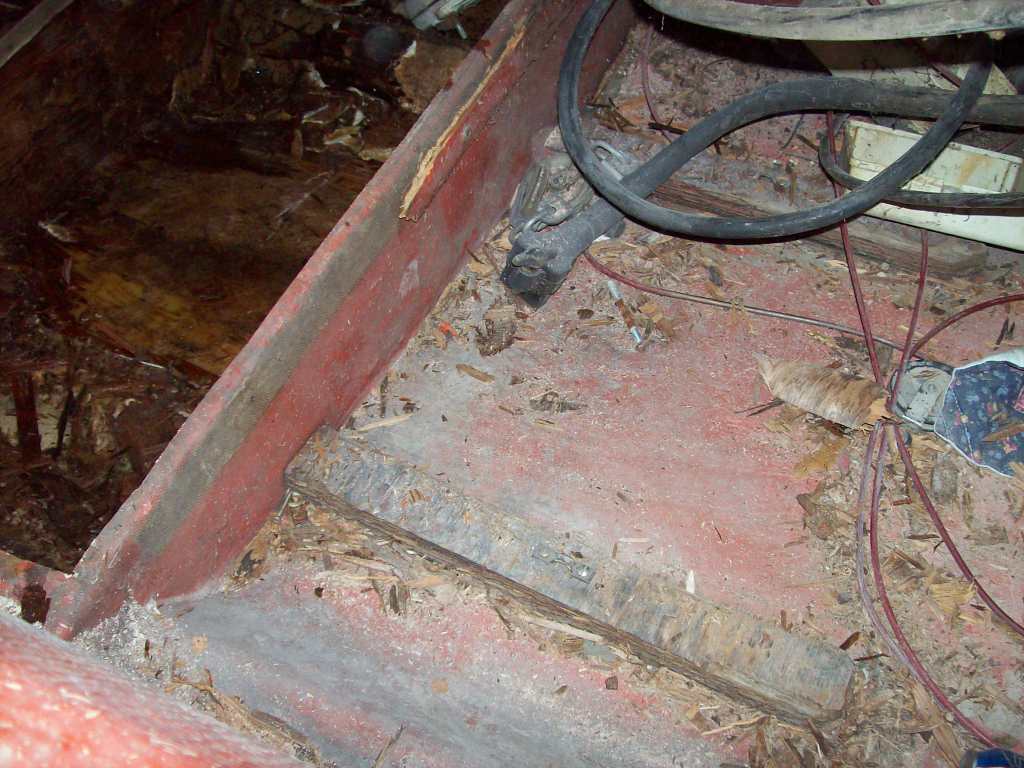

I'm into the rear seat and now have all the foam out of that one. My problem is that it looks like the plywood floor continues to the transom from the front seat. I have not started to cut the ply out under the second seat or to the transom, but I do not think that sheets of plywood are sold in 7-8 foot lengths. Where would it be good to make the break? I do not want to compromise the strength of the floor since this ply is so thin. I will post pics later if I did a horrible job of explaining this.
Re:Update (maybe big problem) 16 years 8 months ago #2157
A pair of 4'x8' plywood sheets are sufficient to do the flooring in most boats under 17'. Not sure what your original plywood floor thickness was, but I shouldn't think it was below 3/8" or 1/2" thickness. 3/4" for a floor is just excess weight. More photos of a work in progress are always appreciated.

Well it's more like mass destruction right now. Between the two seats there was one piece of 3/8"? ply strips side by side. As far as I can see, they were continuous to the transom. It measures over 7 ft in length. I guess I can use 2 sheets. One from the transom to the middle of the rear seat, then from the middle of the rear seat to under the front seat. I don't plan on cutting the ply into strips. It seems almost pointless that they did it to begin with... Must have been for faster build times somehow.
Re:A little help for a Span sea king 16 years 8 months ago #2185

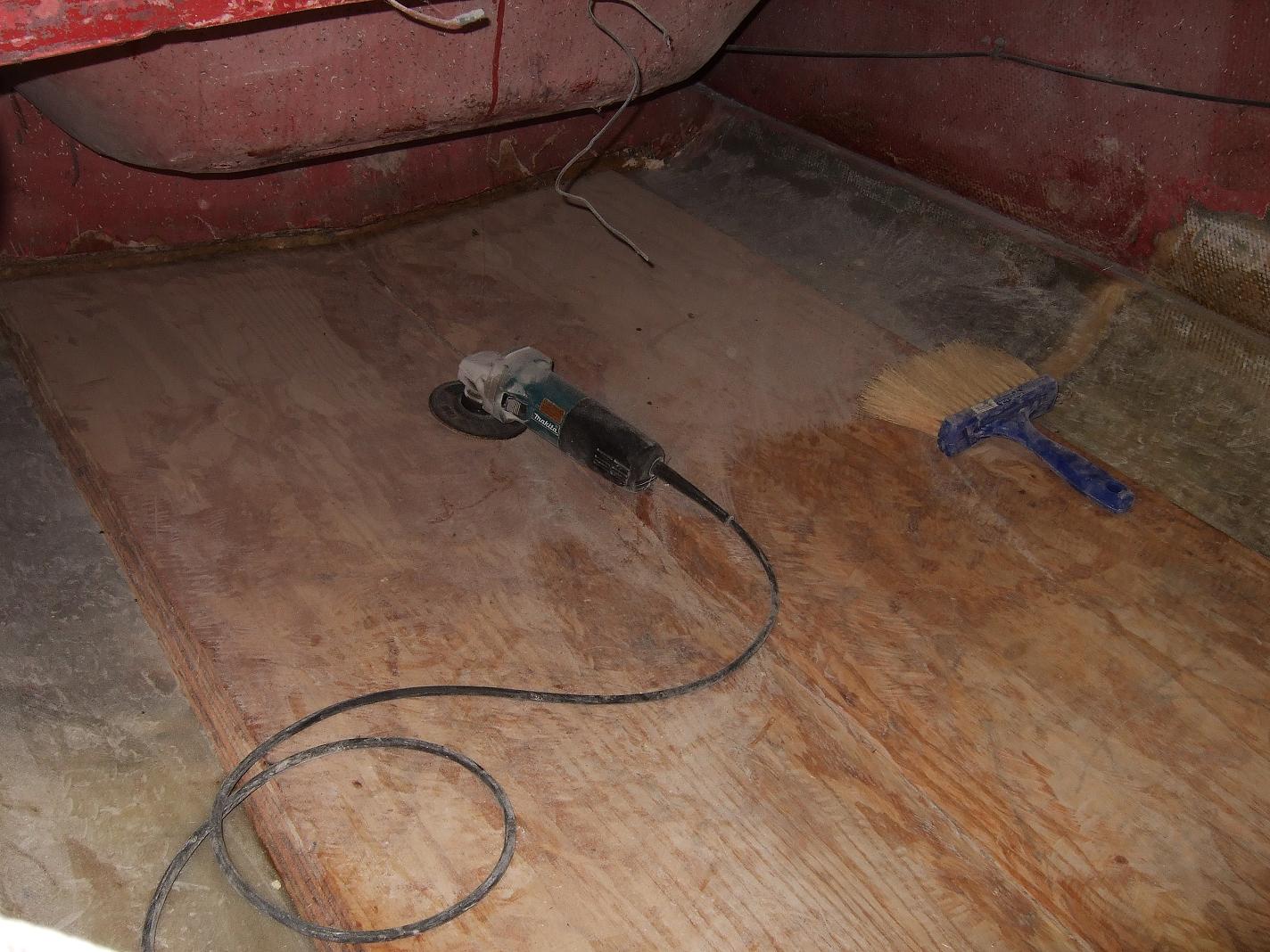

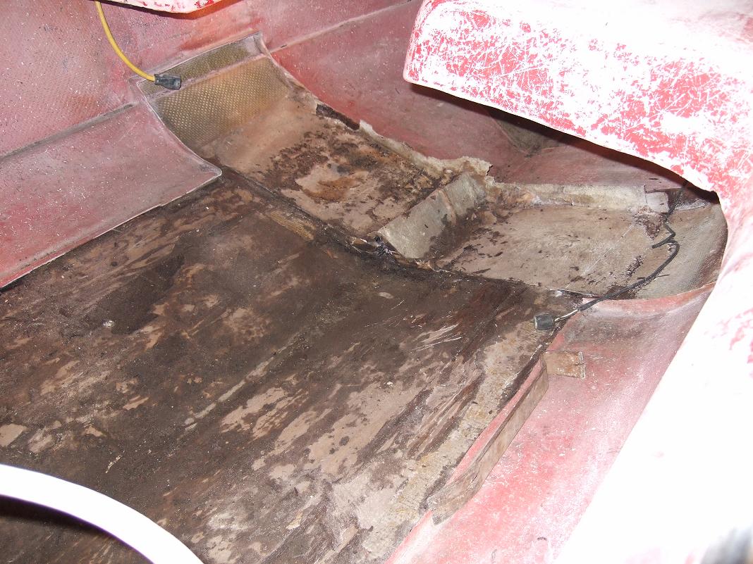

Well the way it was originally done was one piece of ½” ply from the transom to just past the back of the front seat. You don’t really want any breaks in it lengthwise… As far as the strips widthwise go, that helps the wood to follow the contour of the floor better. I took my plywood all the way under the front seat. I used two pieces of ¾” marine grade plywood & made relief cuts in it where needed to make in fit the shape of the hull. Here are some pictures to help with what I’m explaining.
The plywood stops at the line where the yellow extension cord is.
The new floor is ran to the front edge of the front seat. That is where the floor really changes from basically a flat v to a compound curve.
View of the rear.

Should I just redo the floor back into strips? It seemed that the old ply was only 3/8". Maybe upgrade to 1/2" and just rip cut the sheet into the original strips? I want to be cleaning up tomorrow and Sunday start replacing the floor. Hopefully it will be pretty straight-forward.
Re:A little help for a Span sea king 16 years 8 months ago #2192
Its really up to you. I don’t know what kind of tools you have… I wouldn’t recommend going with the strips unless you have a table saw. Using a circular saw would be tough to get quality cuts. Considering they will need to be angled to what ever degree needed do fit the pieces together with out gaps between them. I’m really sure ½” plywood was originally used on the floor. I wouldn’t go any less than that! I went with ¾”, it may not be necessary but I’m building this boat to last. My best piece of advise is do not rush your work!!!! Take your time & think every thing you do over well before doing it! I’m new at this too… Rushing things with little experience leads to disaster! It will take some serious time to remove that wood & prep the glass under the wood for the installation of the new floor! I had about 16+ hours of real work time in cutting out the seats, removing the plywood, sanding/grinding the floor smooth for the new stuff. I’m pretty picky so it may not take you that long. Is the wood rotten or just wet?

I have a table saw, skill saw, compound miter saw, and a jig saw. My wife doesn't like to see me NOT working on something... it's just never anything that I want to work on. I've had several boats in the past and still have my '86 330hp four winns, but all needed mechanical help and none nearly this old. I like your way the best with cutting reliefs where the wood will need to contour to the bottom. Since it's such a small boat, I think that I will just use the 1/2" ply and set the fiberglass "cap" back on and glass it all shut. I will hopefully have the old floor from the rear seat to the transom out and everything cleaned up by Sunday afternoon... I have to work Saturdays. I think that I should have half the floor fitted by Monday night. With any luck, I can keep setting goals and keep pushing forward with this awesome little boat. Again, I appreciate all the help I get here. I will keep taking pics and updating as I go.

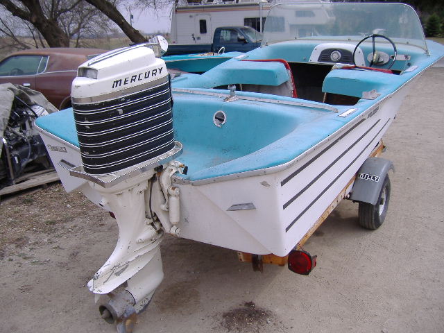

randy in 1964 seaking was built by starcraft,at least my 64 seaking cabin cruiser was built by them,i posted scans of the 1964 wards catalog of their boats in your other post "64 seaking",ill post them again here it may also help others,john
Re:A little help for a Span sea king 16 years 7 months ago #4195
Thank you very much for the pictures. My boat has a dip in the bumper rail about two thirds of the way towards the back. It looks just like a span America but without the fiberglass cowling over the seats. It resembles the red boat under "Beauty, Performance,Safety" tag line but that boat has no dip. I am going to work on getting a picture on here. Thanks again.
randysnr
Re:A little help for a Span sea king 16 years 7 months ago #4197
I am trying to upload in a compressed format. Here goes [img]http://www.fiberglassics.com/media/kunena/attachments/legacy/images Here is another view. Anyone know who made this boat?/100_0892.jpg

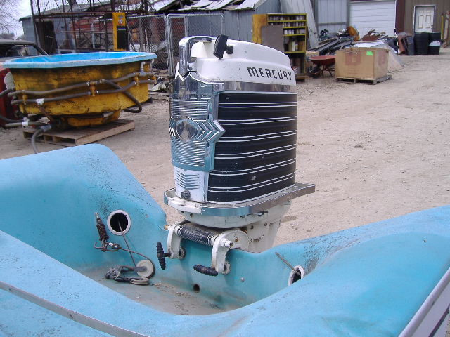

randy does you motor look like this?if it does,its probably a 63 seaking,that was made by gale,its the last year of production of gale,but you can usually use johnson/evinrude parts,they used alot of the same parts,these are bigger motors(mine was the 63 60hp.but they should have a similar badges. look at the motors on the boats in the scan above,john

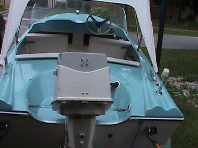

I have just recieved a 14ft Elgin Simpson/Sears fibreglass boat, with a 1965 Eglin/Chrysler 2storke 50hp engine from my Papa, it is still in about 95% condition, and was last on the water 7years ago, tuned and winterized after that, but has been sitting ever since, engine runs but needs tune up, carb clean, etc, boat has all orginal parts, including ski bar, was wondering if anyone knew of this boat and its value, as well of anyone in the ara that might be able to maintain, and winterize this vintage piece, I live in London, Ontario, Canada
