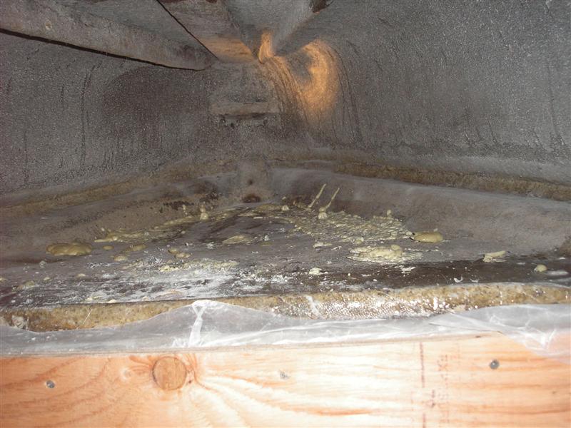

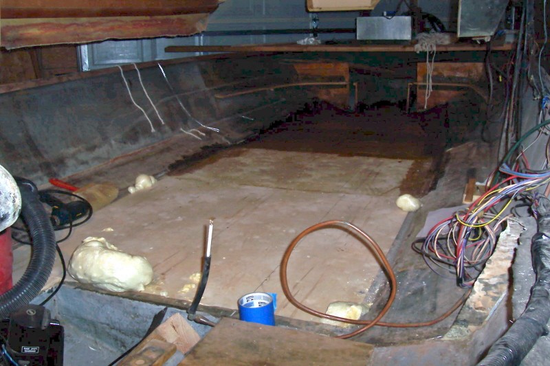

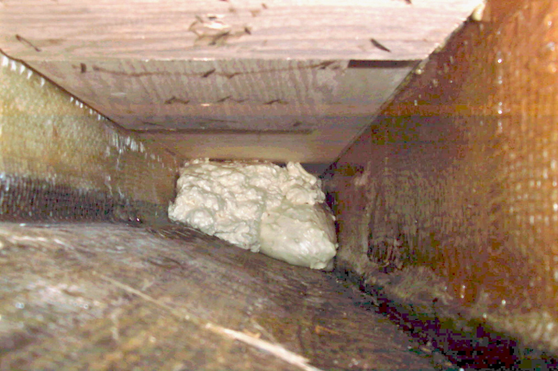

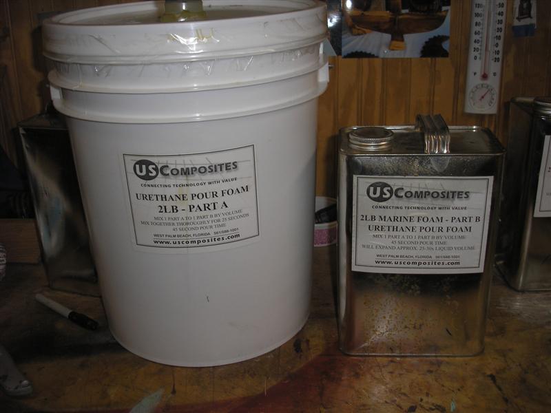

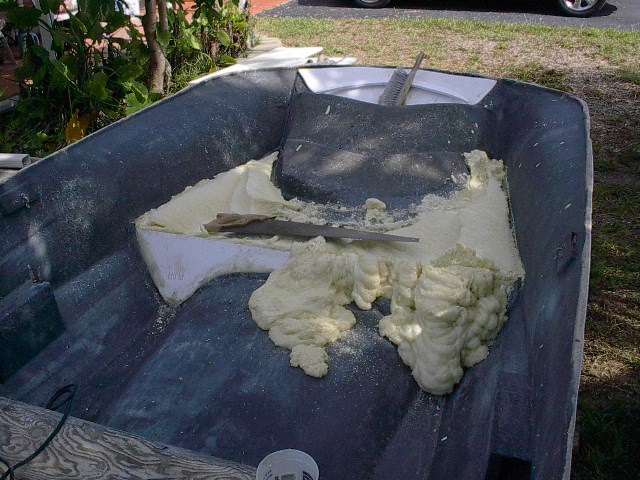

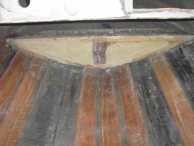

You want to use a two part Marine foam what I did was get the deck down and screwed in place then you drill a series of holes with a hole saw (save the plugs) tilt the boat up so the foam will flow down hill and start with the low spot and slowly mix small batches of the expanding foam and fill till it seeps out of the holes. Make sure that the foam has room to flow out of the holes and does not expand and raise the floor. I got some of the 2 pint plastic containers like you get in the Deli for salads and also some 1 pint containers I filled about 5 of the 1 pint containers about 3/4 full with part "A" and 5 with part "B" then when I was ready to mix I would fill one of each into a 2 pint container and there was room to stir - then pour slowly pour into each hole one at a time . When you mix you have a few minutes but not alot. you can also run some drain pipes in before you foam so that if any water does get in it can run to the back ? When done trim off the foam that oozes out of the holes and put the plugs you saved back in and put some fiberglass over them to seal. I'm sure others may have another way but this worked well for me. Good Luck

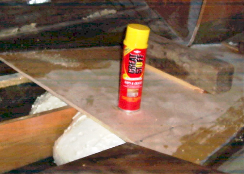

I've also seen folks use "Great Stuff" (spray foam in a can) from the building supply stores, but there's some disagreement as to whether it's waterproof or not.

Call on your high school math to get a rough volume of what the space will hold as you don't want to over foam it by much. A little isn't bad as the holes will help the overflow, but a lot can be a problem. As it solidifies the foam in the holes starts to plug up and the expansion has no place to go - causing the bottom and floor to bow and possibly rupture... A LOT of pressure in that foam!

Another thing to consider, most use a 4 lb foam instead of a 2 lb. Some of these glassics could use a little extra reinforcing and the denser the foam, the greater the rigidity. I've done that (with the US Composites products)and it works pretty well

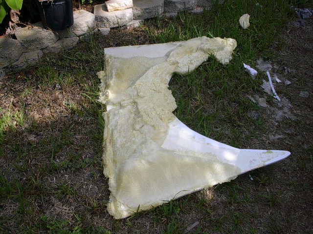

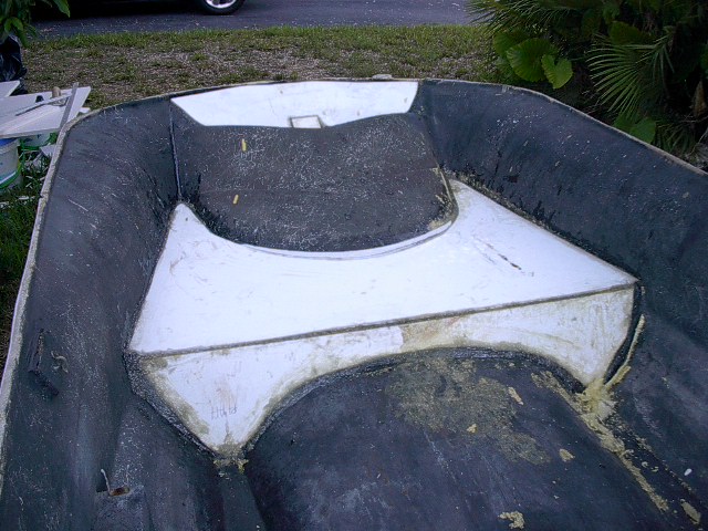

I foamed a void in the bow of the MR. Measured the volume with water, mixed the foam in two batches one for each side, put 4 ammo boxes full of lead on top, went inside to get a towel. When I can back out 2 minutes max…
It cuts easy with a hand saw, elec knife wooks well also.

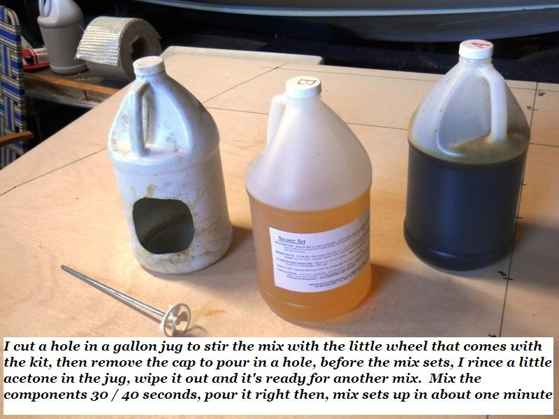

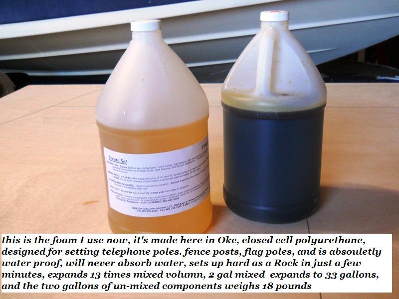

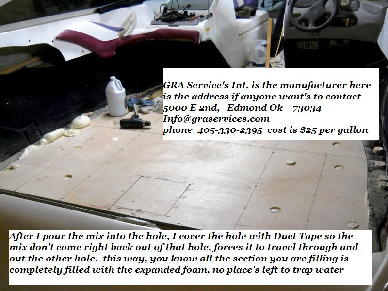

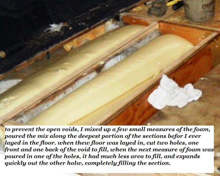

This is the foam I use now, it's polyurethane closed cell foam used for setting telephone poles, fence post, flag poles, and will never absorb water, sets up hard as a rock in just a few minutes, expands 13 times it's mixed volume, weighs 9 pounds a gallon, 50/50 mix

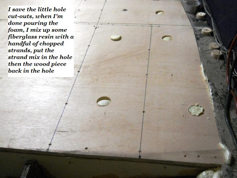

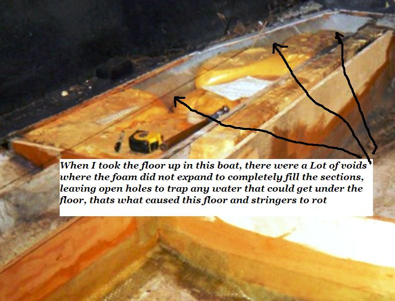

Don't use funnels, it restricts the flow of the liquid to the point it will set-up before you are ready, 1" holes are too small, the foam liquis builds up quick, hard to hit the hole, run's out on the top. You don't have but One Minute for get the foam mixed in in the hole, No More.
I put the wood back in the holes mainly for the reason of mounting seats, and anything else that is screwed to the floor, after fiberglassing the wood piece's back in place, it's more solid. The 5200 is a Great product, the best there is for it's purpose, but it takes it Days to cure, and it won't hold a screw very well, one more thing, it will scrink when used in the volumn it takes to fill a hole that size, not be flat.
The contact for the Secure Set foam products is listed on one of the pic's I posted

I have used the stuff you can buy at Home Depot, or Lowes, "Great Stuff" but Now, they have changed the chemical make-up of it to several different consistancies, it's not as rigid as it used to be, but it is water proof, and easy to inject, but you need to do it as you lay the floor in, so you can see where to inject the next can. although it expands rapidly, it don't cure for a couple days, and creates some pressure while curing. I didn't use the little tip that comes with the can, I drilled 1/4" holes in the floor where I wanted to inject the foam, and inserted the nozzel of the can right into the hole, the can emties in 9 seconds that way, and achieves greater expantion. A lot of folks don't know that this "Stuff" will set up under water, and is absolutely water proof.

the pour in foams they used to use in boats for Years would absorb water if continually exposed over time, I am currently re-flooring a 1997 Celebrity and had to dig out some waterlogged foam, this hull depends on the rigidity of the foam for it's strength, that foam, as stated, will keep a boat afloat for a long time, but will eventually soak up water, even moisure, it don't have to be submerged to absorb water, a wet stringer would probably transfer moisture to the foam. On the other hand, there are a few closed cell foams that will not absorb water, like polyurethane, styrene, and polystyrene closed cell foam blocks have floated boat docks and boat house's here in Oklahoma for 50 years that I know of, and they are still floating, that foam is used under the seats of some boats, and under some decks. The foam I have used in the past, and the "Great Stuff" in a can from home depot, the rigid set stuff, will expand and set up under water, it creates a "skin" during expantion that prevents water from entering the little closed cells, but once the "skin" is broken, it may absorb water. The "Secure Set" foam I use now is a polyurethane closed cell foam, it sets up hard as a rock, bonds to everything it come's in contact with like glue, as long as it's a dry surface, and it will not absorb water, it is designed for setting telephone poles, flag poles and fence posts. I believe that if the Secure Set foam was applied to a clean dry aluminum surface, that it would not cause pitting, no moisture can get to it, but I've not tried it on aluminum boats ... yet.
