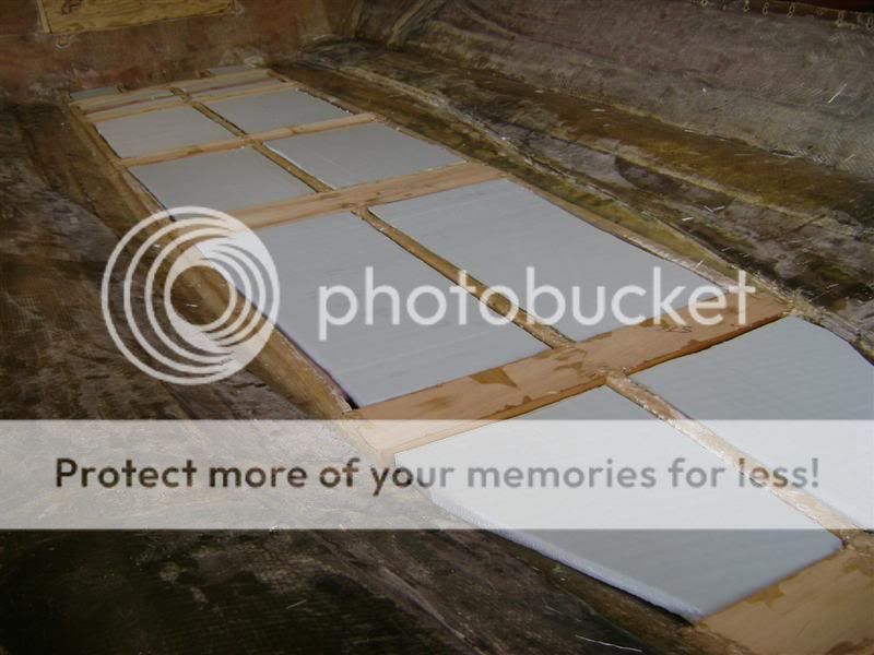

This is the foam I use now, it's polyurethane closed cell foam used for setting telephone poles, fence post, flag poles, and will never absorb water, sets up hard as a rock in just a few minutes, expands 13 times it's mixed volume, weighs 9 pounds a gallon, 50/50 mix

Don't use funnels, it restricts the flow of the liquid to the point it will set-up before you are ready, 1" holes are too small, the foam liquis builds up quick, hard to hit the hole, run's out on the top. You don't have but One Minute for get the foam mixed in in the hole, No More.
I put the wood back in the holes mainly for the reason of mounting seats, and anything else that is screwed to the floor, after fiberglassing the wood piece's back in place, it's more solid. The 5200 is a Great product, the best there is for it's purpose, but it takes it Days to cure, and it won't hold a screw very well, one more thing, it will scrink when used in the volumn it takes to fill a hole that size, not be flat.
The contact for the Secure Set foam products is listed on one of the pic's I posted
