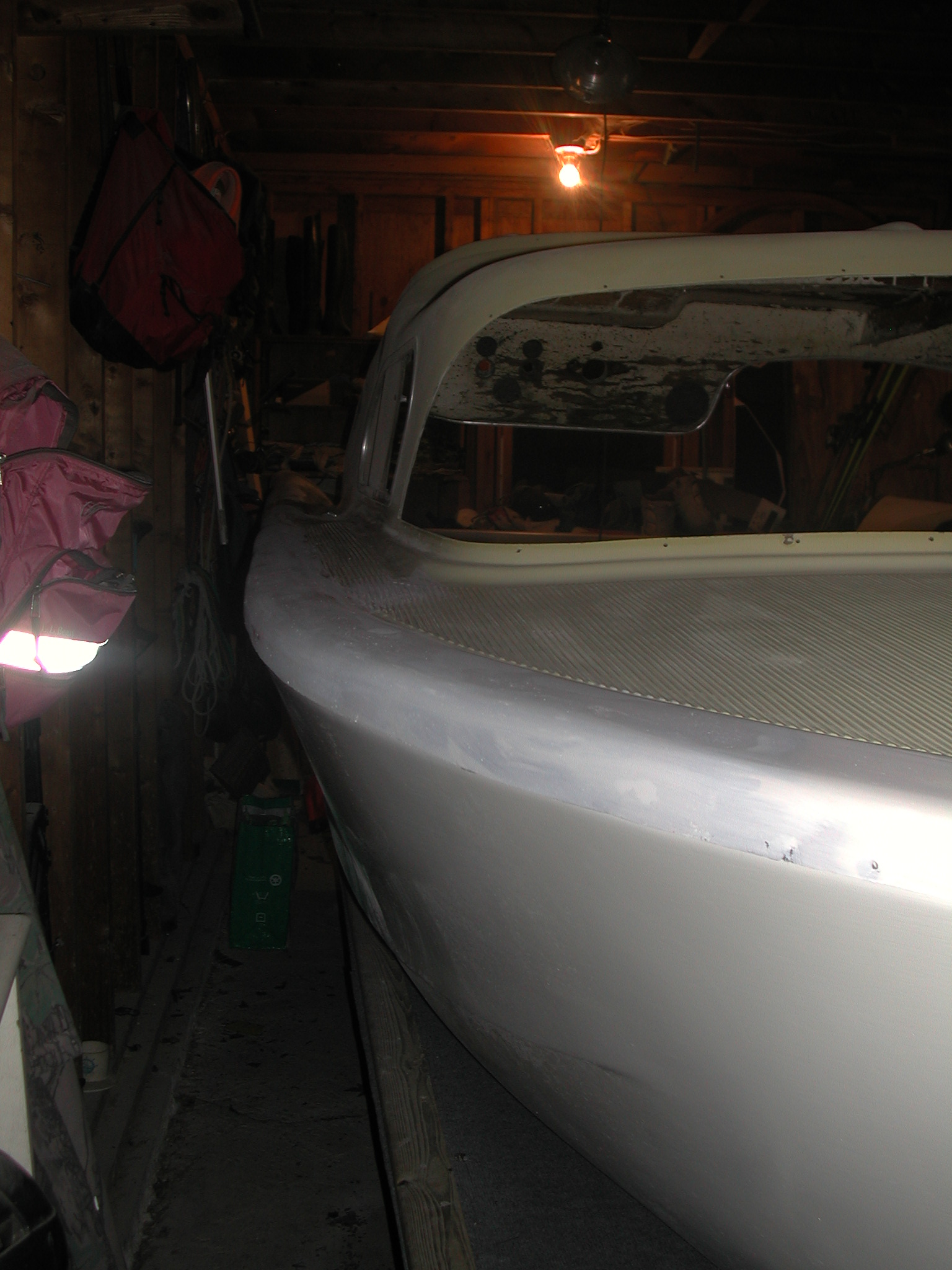

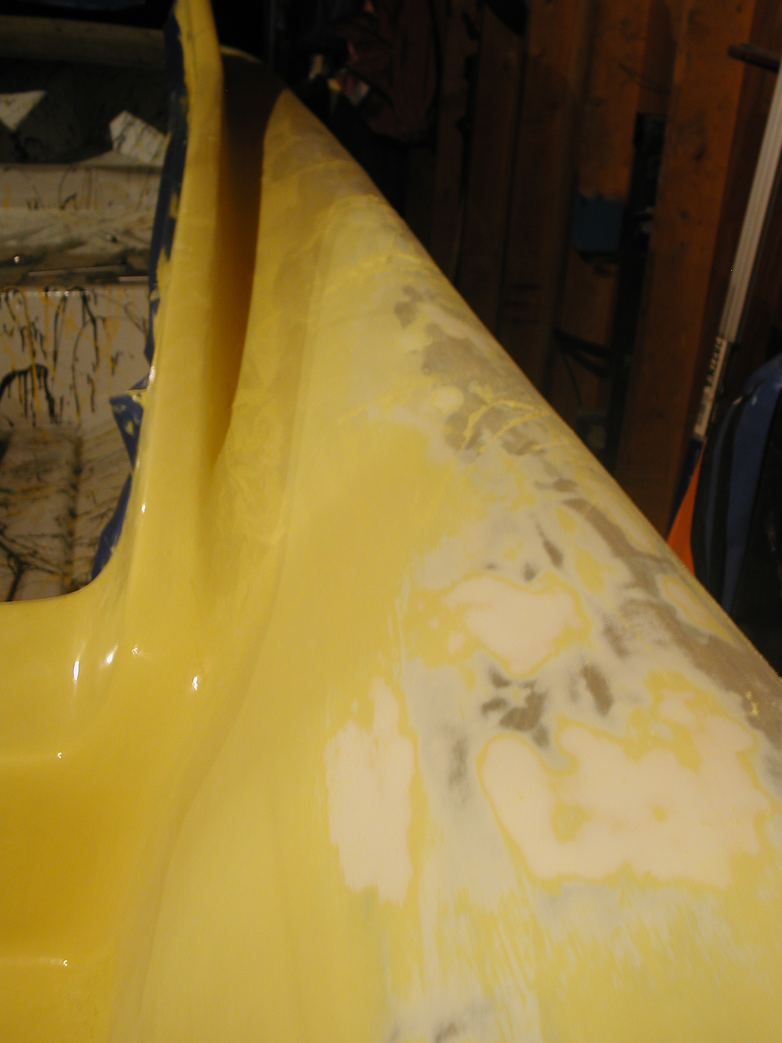

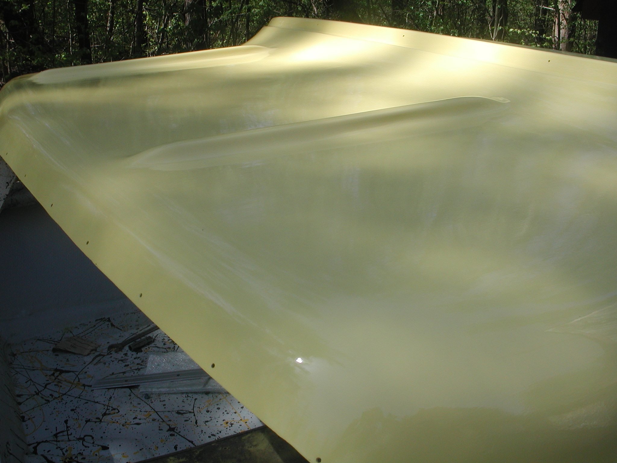

Spread a little primer on the glass repairs. Getting darn close to painting. A few little fixes of pin holes to do, but overall in great shape.

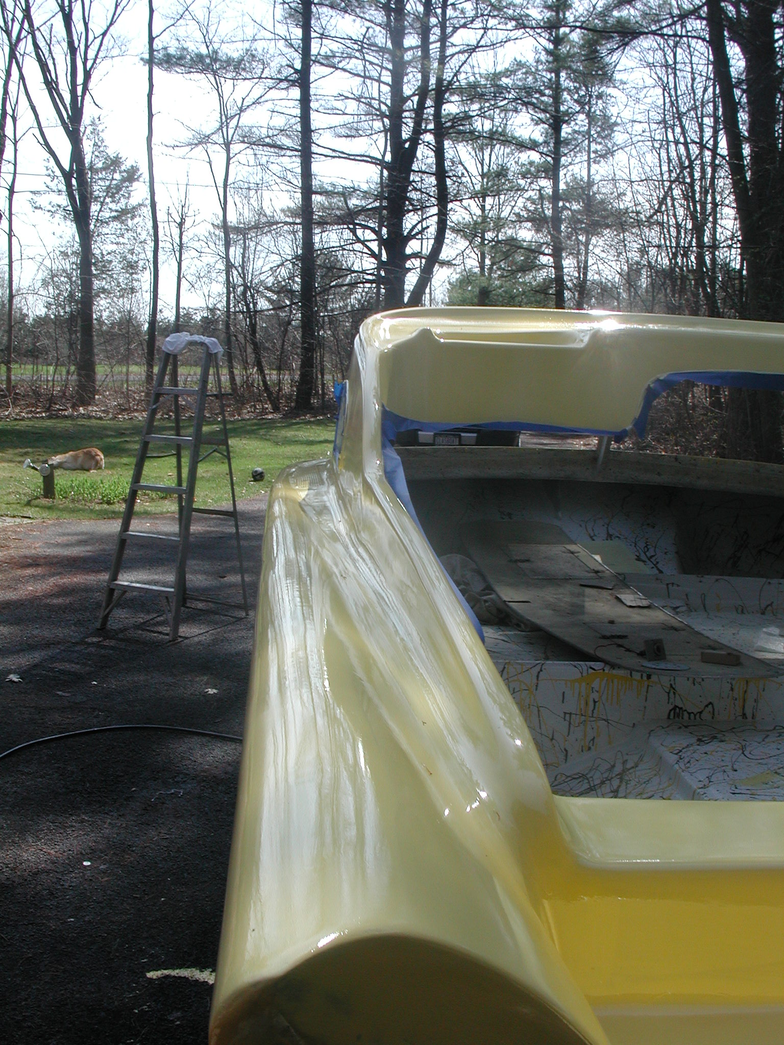

Powercat 18DC in Paint 16 years 7 months ago #3981
  • crosbyboat
  • crosbyboat's Avatar Topic Author
  • Posts: 677
  • Karma: 31

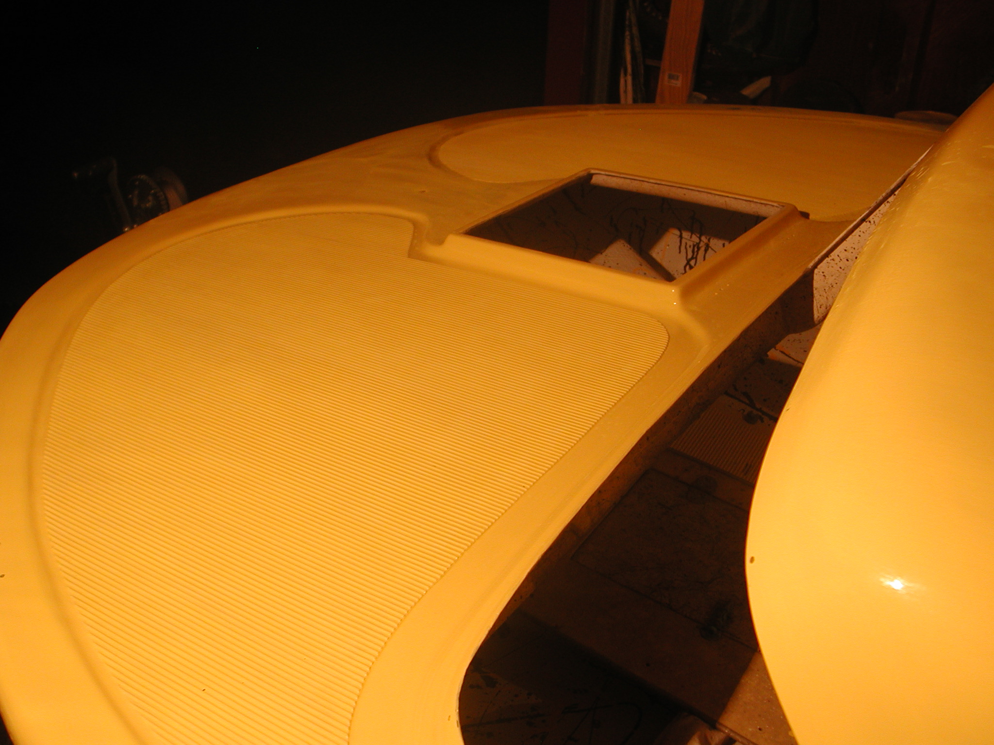

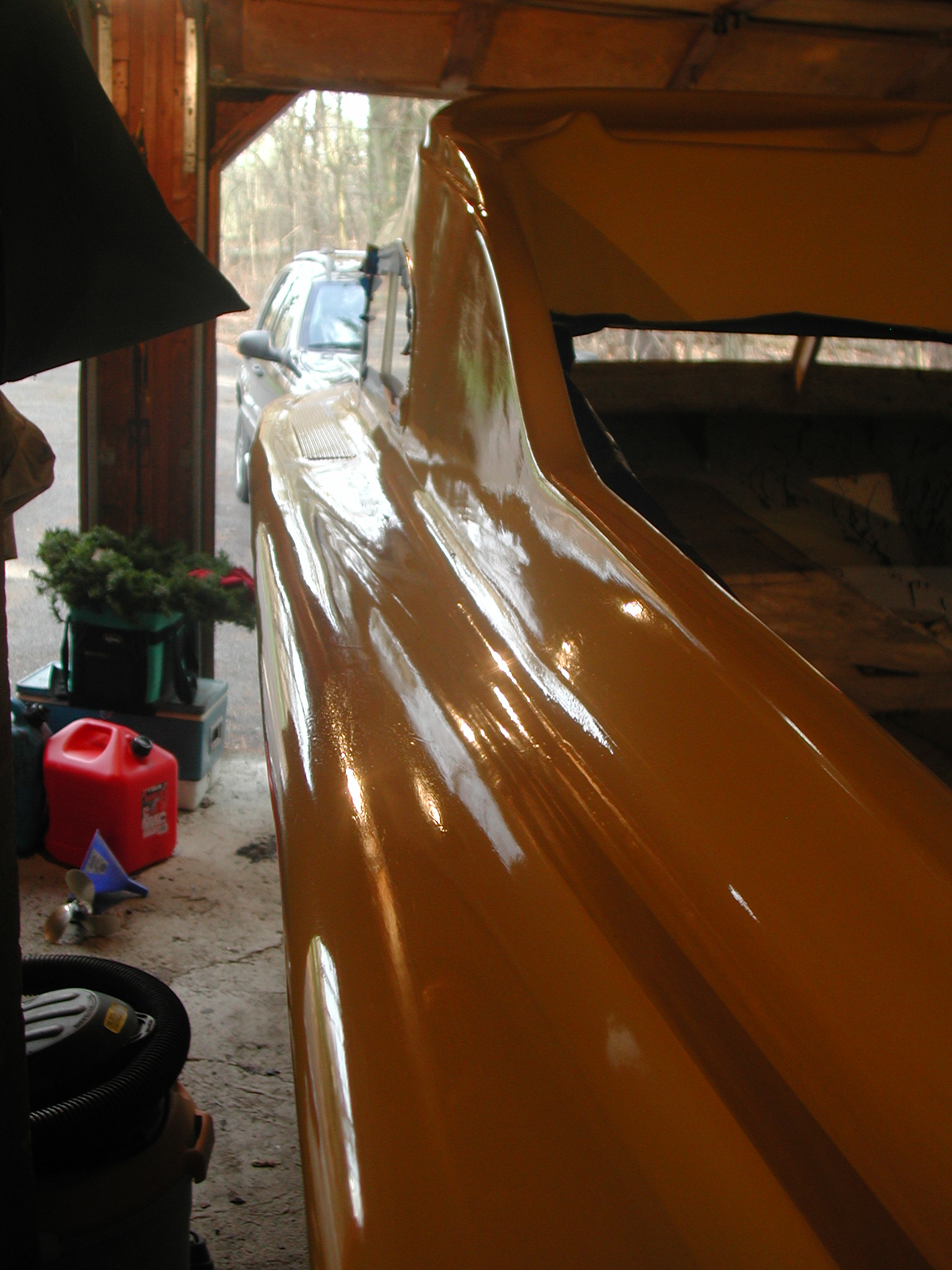

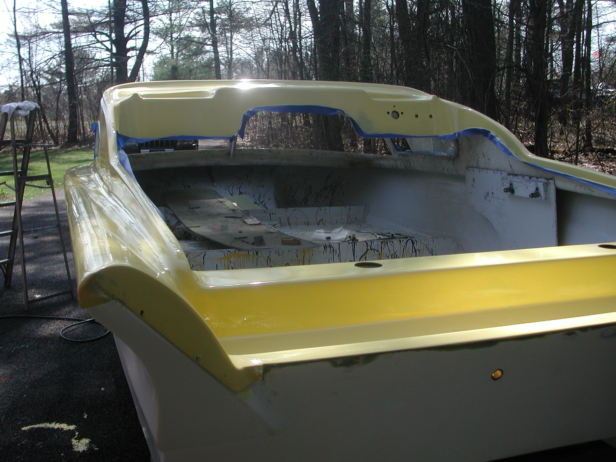

This is Interlux Brightside applied with a 3" Wooster foam brush using the technique I described in the "Paint it Black" article posted on the site. Looks so sweet, and I am glad I custom mixed the Brightsides to tone down the yellow. Should get a second coat on today. Takes about 2 hours to lay down a coat. Hundreds and hundreds of hours to get ready to paint. I'm thrilled.
Re:Powercat 18DC in Paint - Brightsides Coat #2 16 years 7 months ago #3996
  • crosbyboat
  • Posts: 677
  • Karma: 31

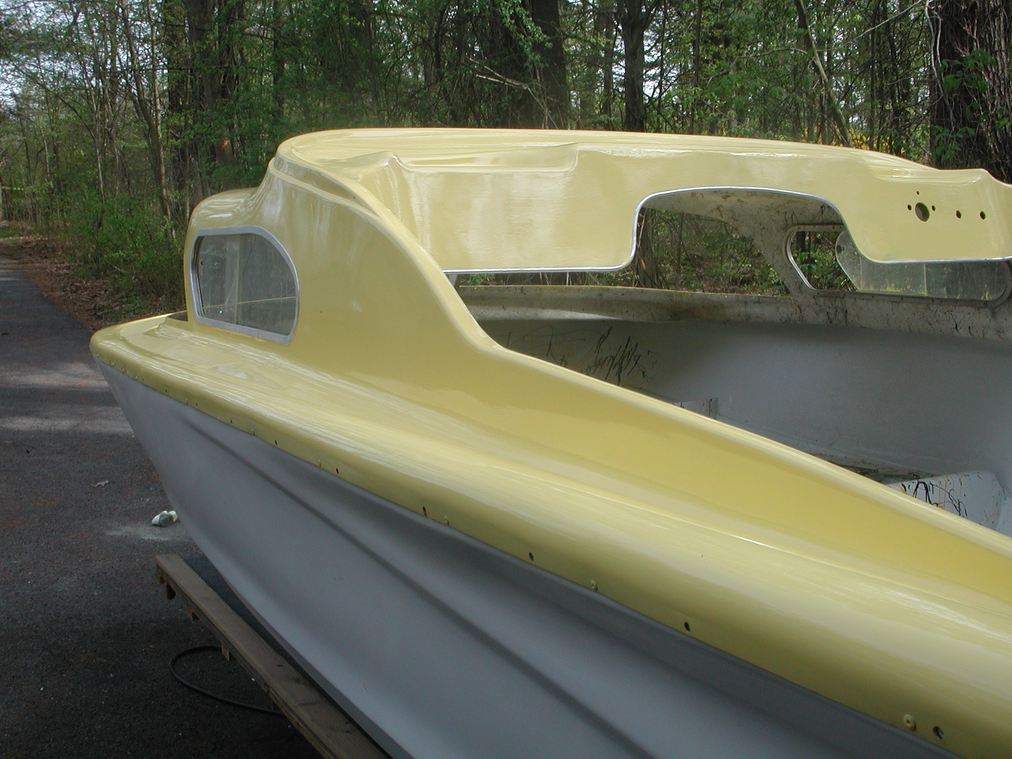

Got #2 on after playing with the Mercury 1350.

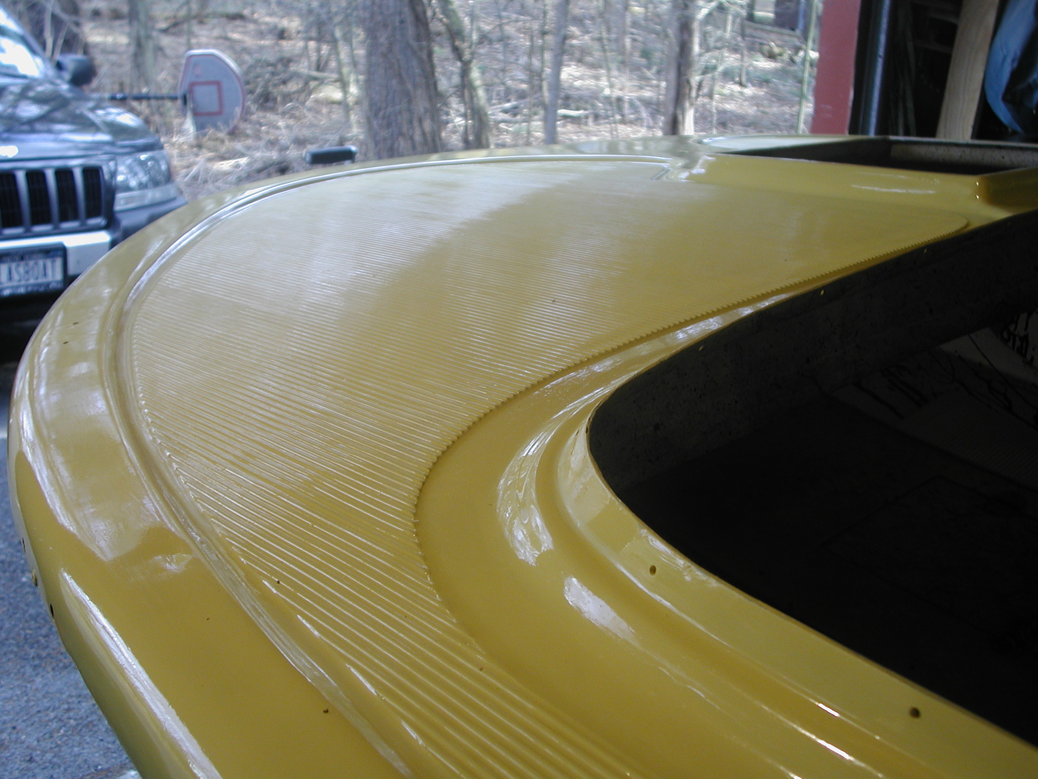

Re:Powercat 18DC in Paint - Brightsides Coat #2 16 years 6 months ago #4822
  • crosbyboat
  • Posts: 677
  • Karma: 31

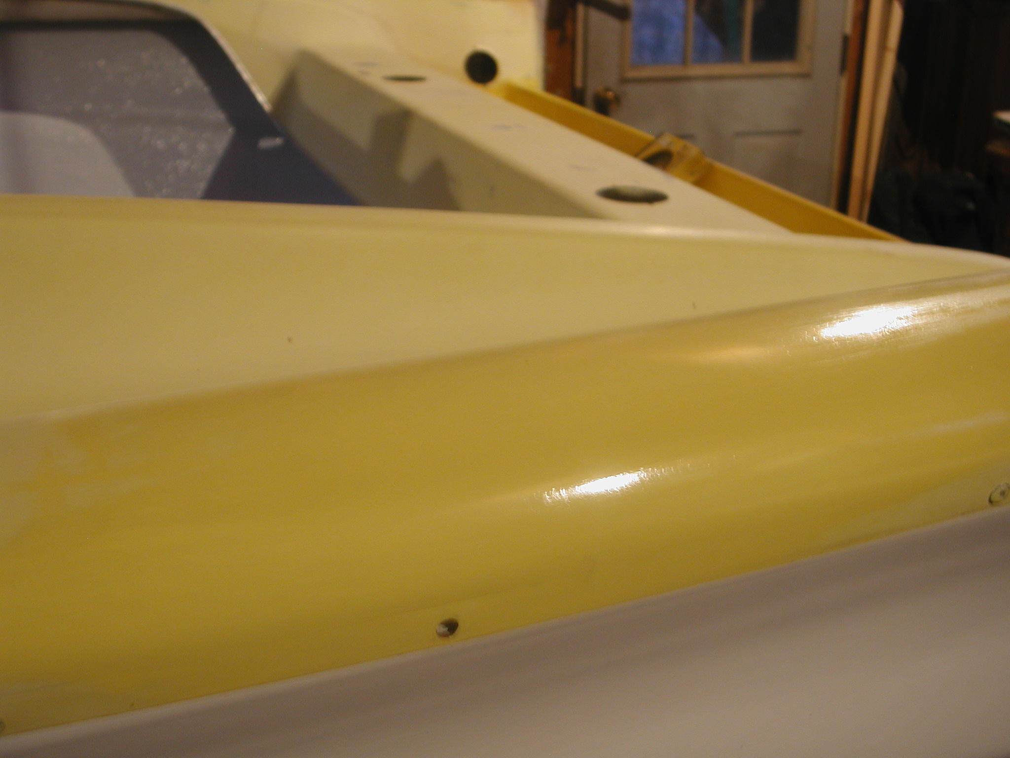

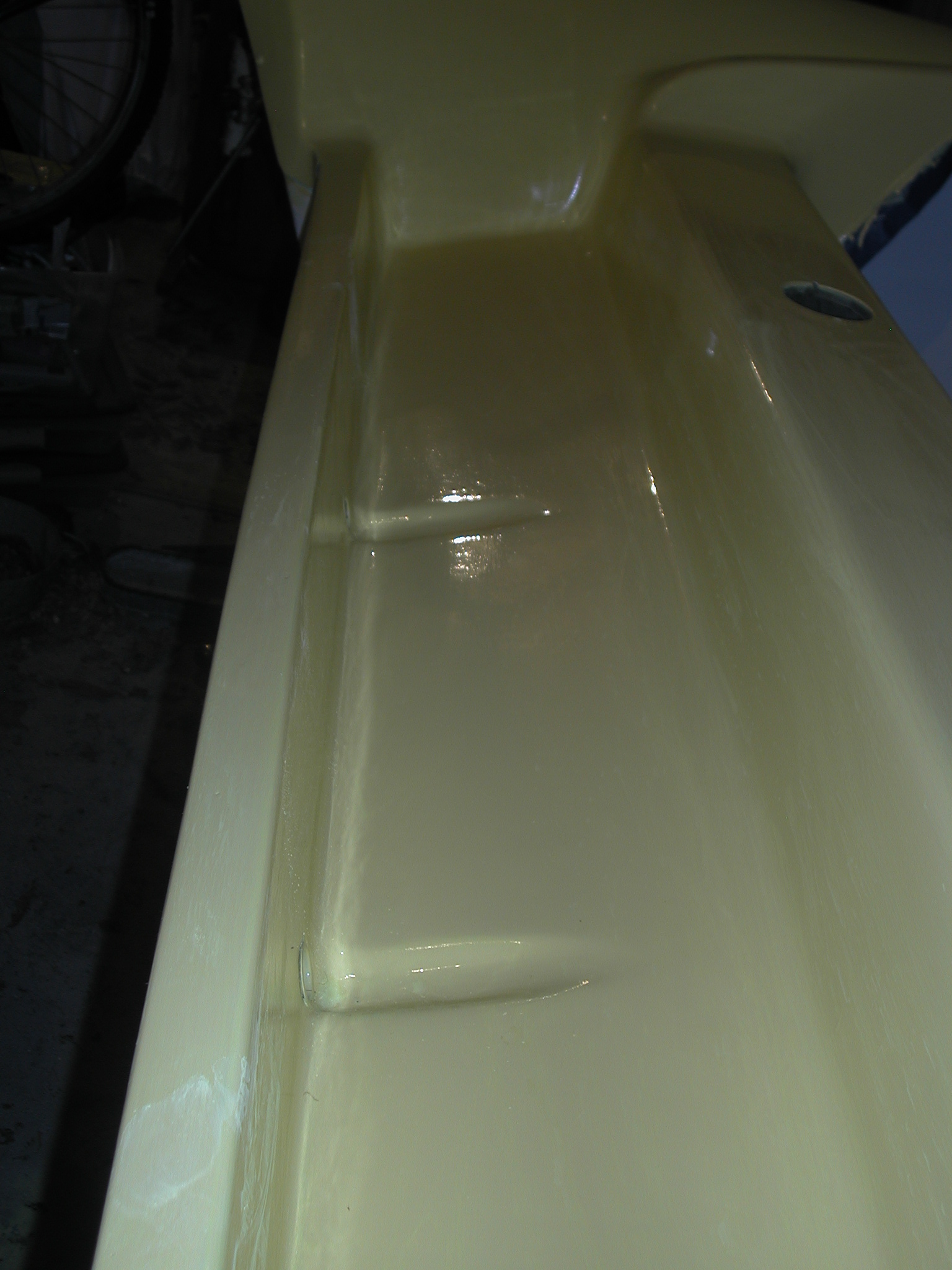

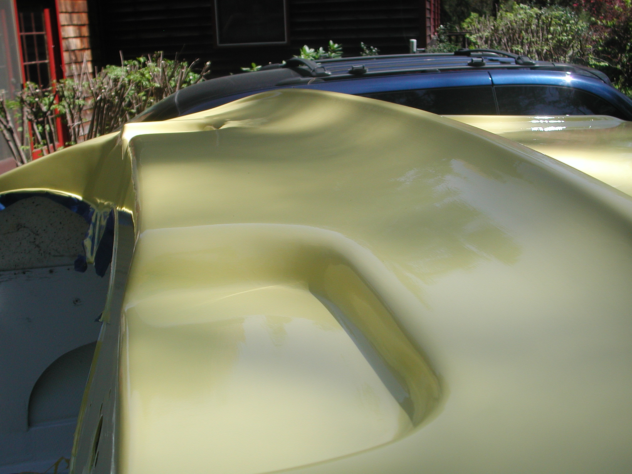

There's only one way to sand an 18DC...one groove at a time. A file wrapped in 220 does the trick. Deck is sanded after two coats. Port fin wet sanded. Stbd side and fin, the total rebuild side, I heavily sanded tonight. Splash well is good. Almost ready for motors. Should be ready for another couple of finish coats soon. Motors nearly done. RideGuide steering and conversion to OMC figured out. Making great progress. Should see water soon.
Re:Powercat 18DC in Paint - Brightsides Coat #2 16 years 6 months ago #4827
Nice work, one step at a time...
Hello, World!!
Re:Powercat 18DC in Paint - Brightsides Coat #2 16 years 6 months ago #4828
She looks great - but then I'm a sucker for yellow!

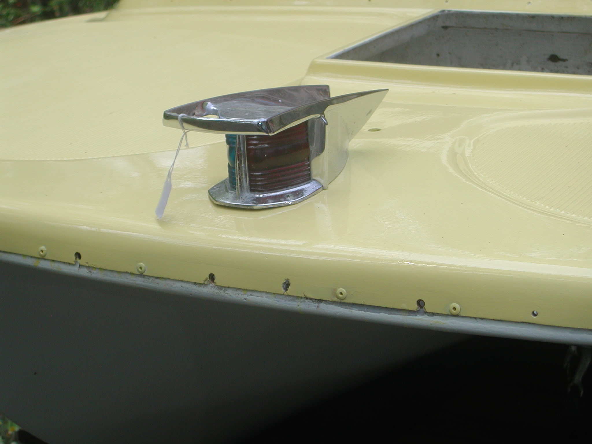

And this weekend I polished these little gems with Cameo metal polish and a toothbrush. Not perfect, but they'll do until the kids are out of college!
Re:Powercat 18DC 16 years 6 months ago #4835
Lookin' good, B! She's coming along nicely, you'll be out there enjoying the fruits of your labor SOON.

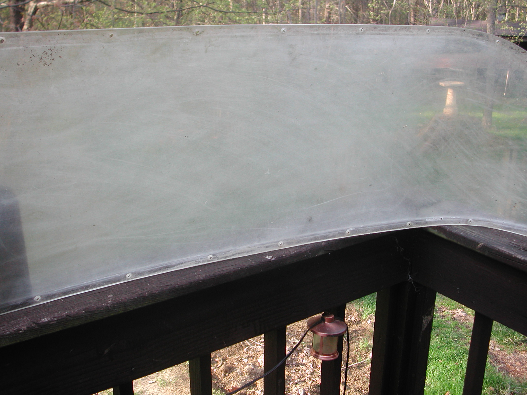

Heh Brian,, How are your windshields, when I get ready to do mine I am going to need them all Thanks Bill

Pretty bad. I am negotiating to get them polished to see if the haze and scratches can be removed. Fall back is to have new ones made. There's a place across the Hudson that will do it. I'm sure they as soon make 4 rather than 2. Not certain what I'm doing with the top windshield but suspect (highly) I won't use the old tall one, but rather will keep it low and more rakish in it's look....and so it will fit in the garage. Also going to be ordering new windshield gasket and need to have a die made. If you need gasket, would love to split the cost of the die with someone.

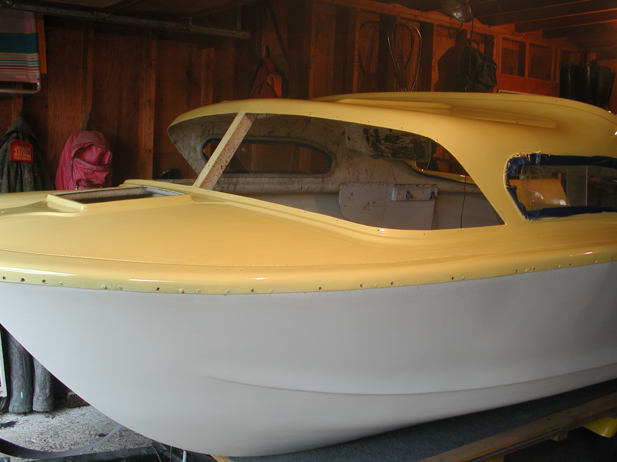

Re:Powercat 18DC 16 years 6 months ago #5192
  • crosbyboat
  • Posts: 677
  • Karma: 31

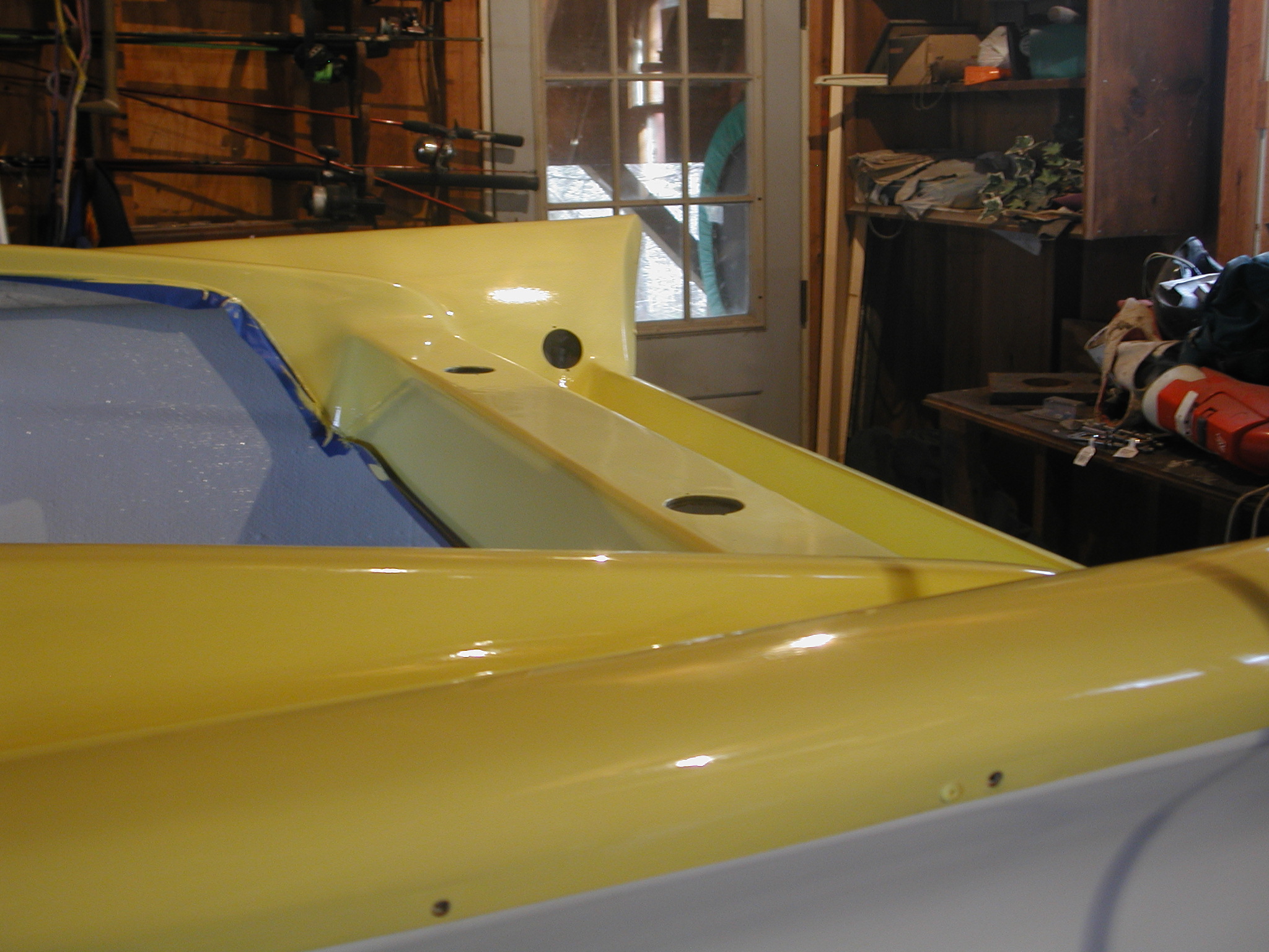

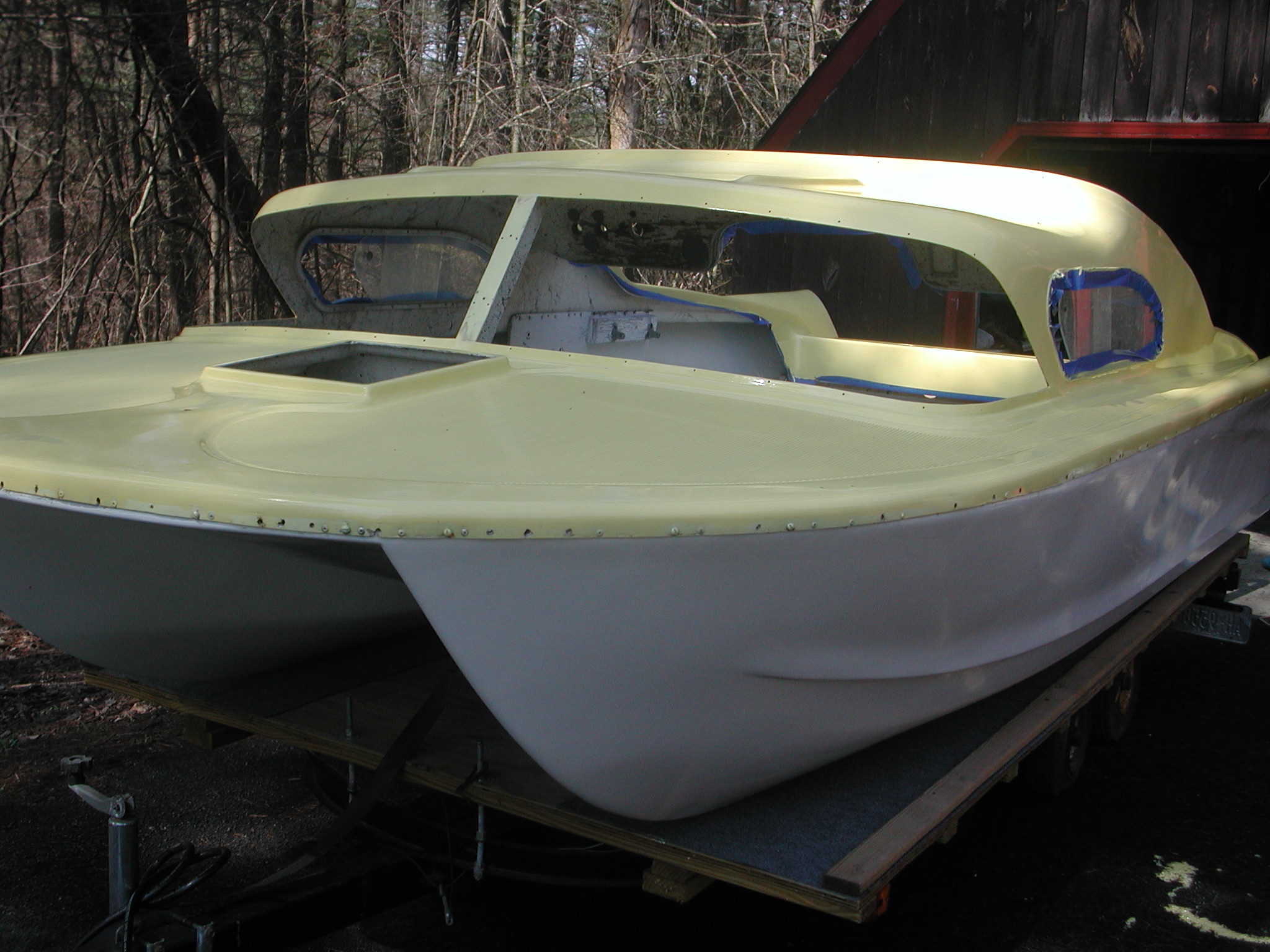

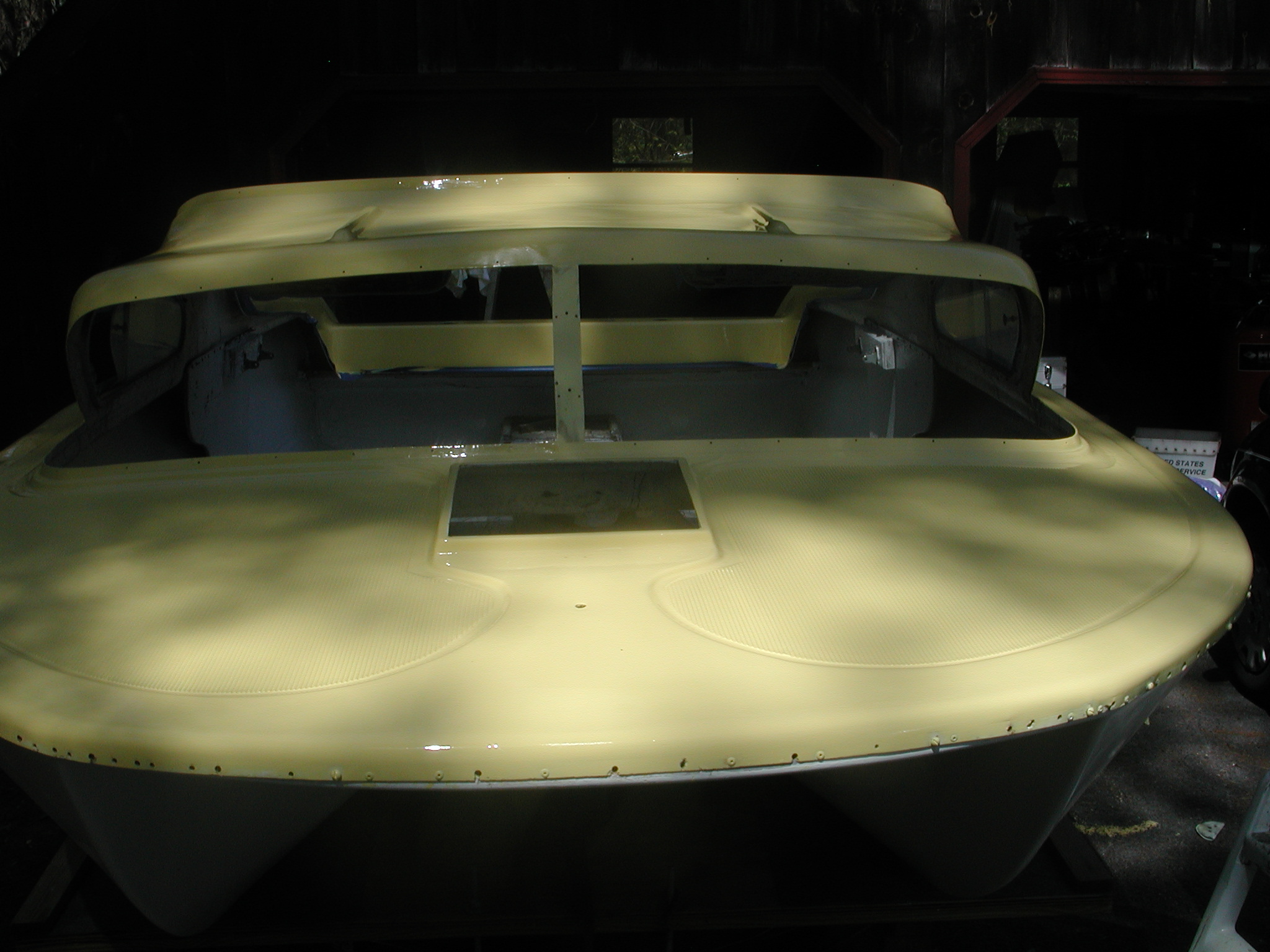

Coat #3 on, and I'm calling it done, except for one more sanding of the dash. Great day of work on boats. Next weekend headed to the St. Lawrence. Added a couple more photos of work in progress before pulling the tape.
Re:Powercat 18DC 16 years 6 months ago #5198
  • Heather
  • Heather's Avatar
  • Posts: 243
  • Karma: 10
Very Nice work. Shines like a New Penney!

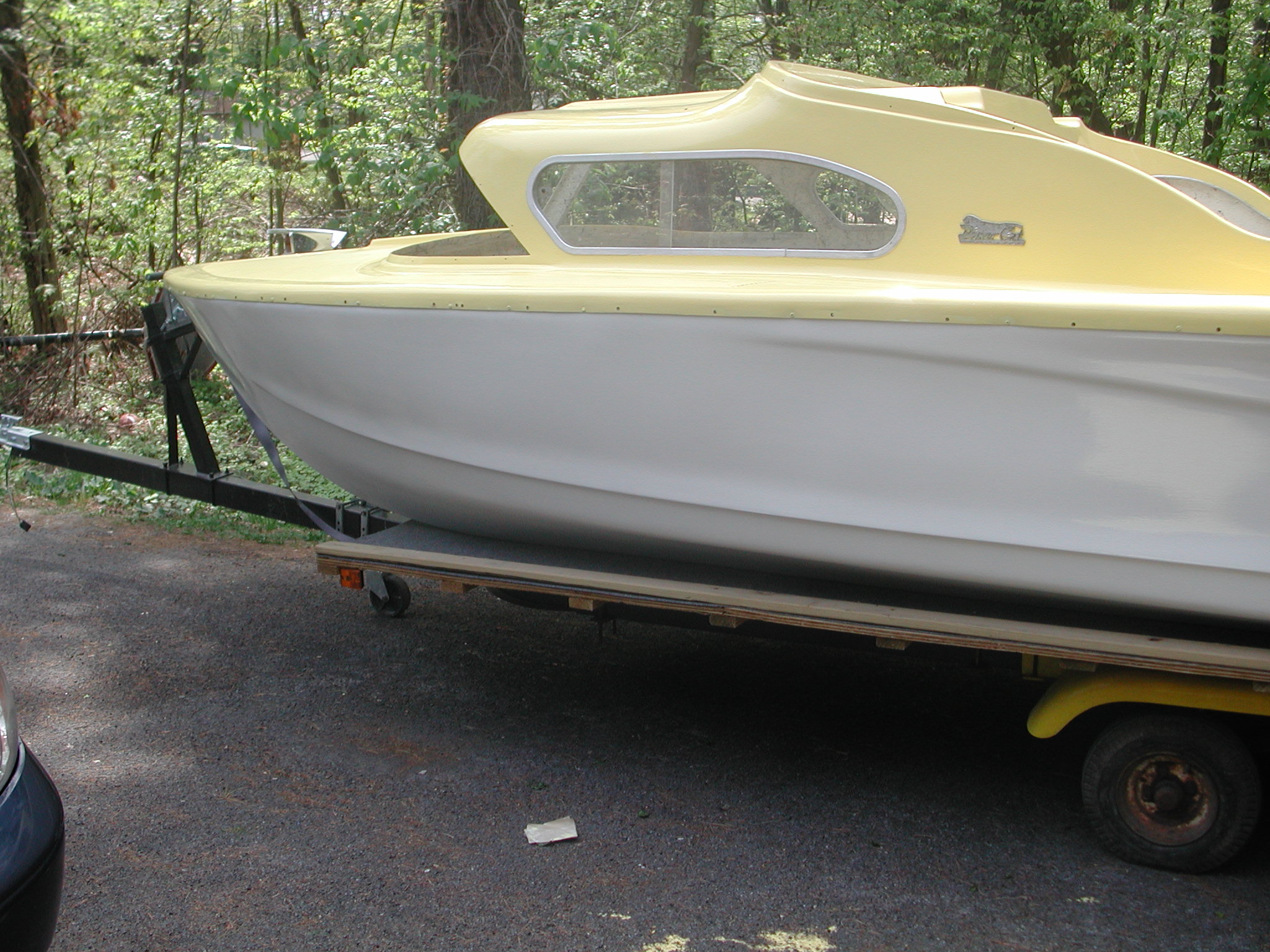

Re:Powercat 18DC - A Little Bling 16 years 6 months ago #5245
  • crosbyboat
  • Posts: 677
  • Karma: 31

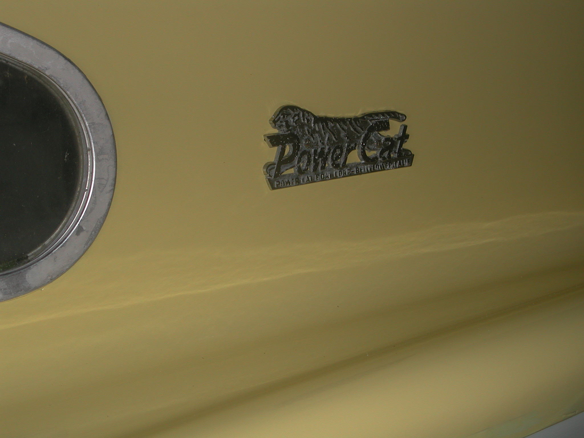

Thanks to Gary Larson of Niantic, CT who gifted these Power Cat logos to me. Stopped after church and picked up the mounting bolts for them. They look great. Lots more to do, but making progress every day.

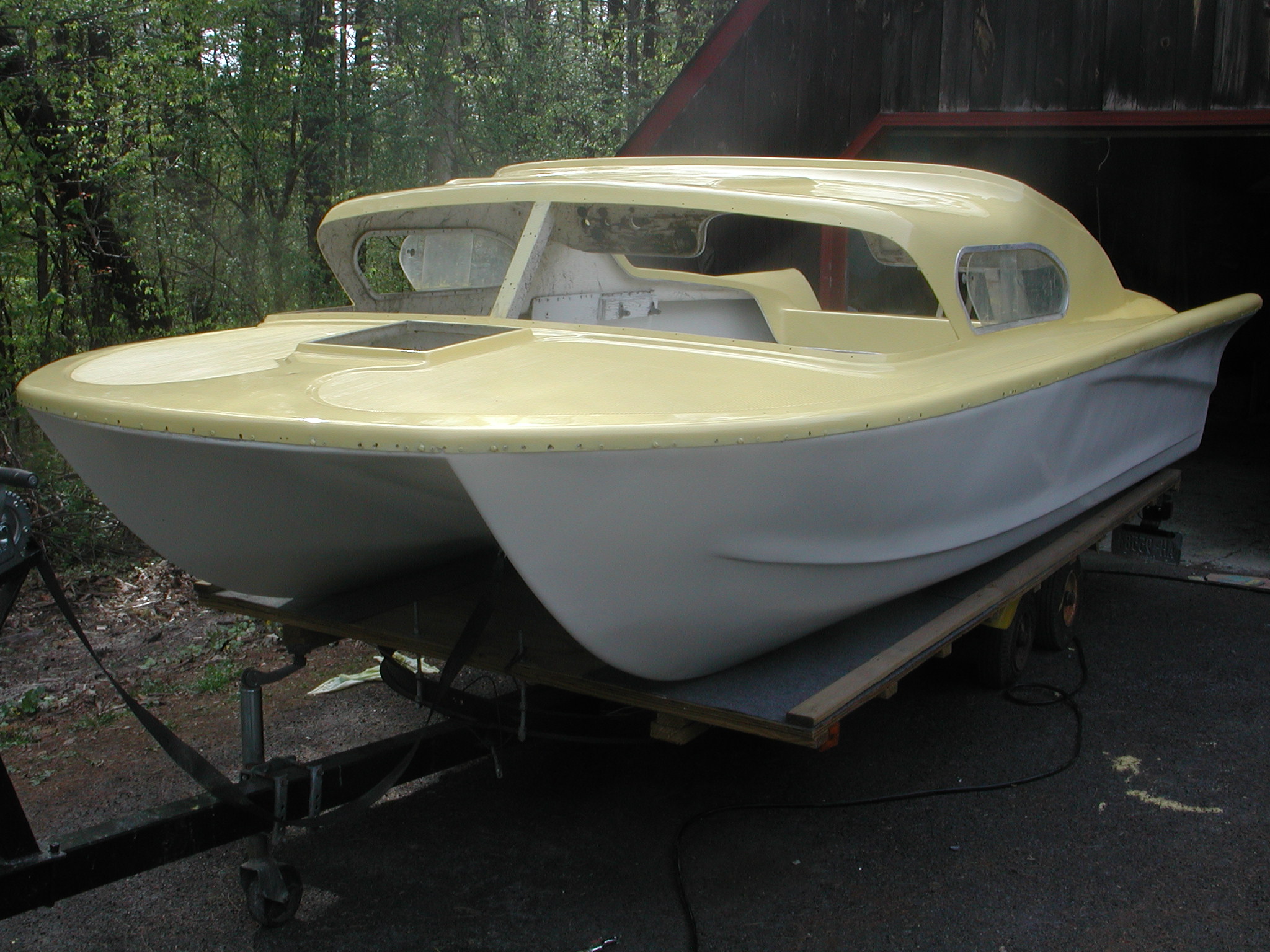

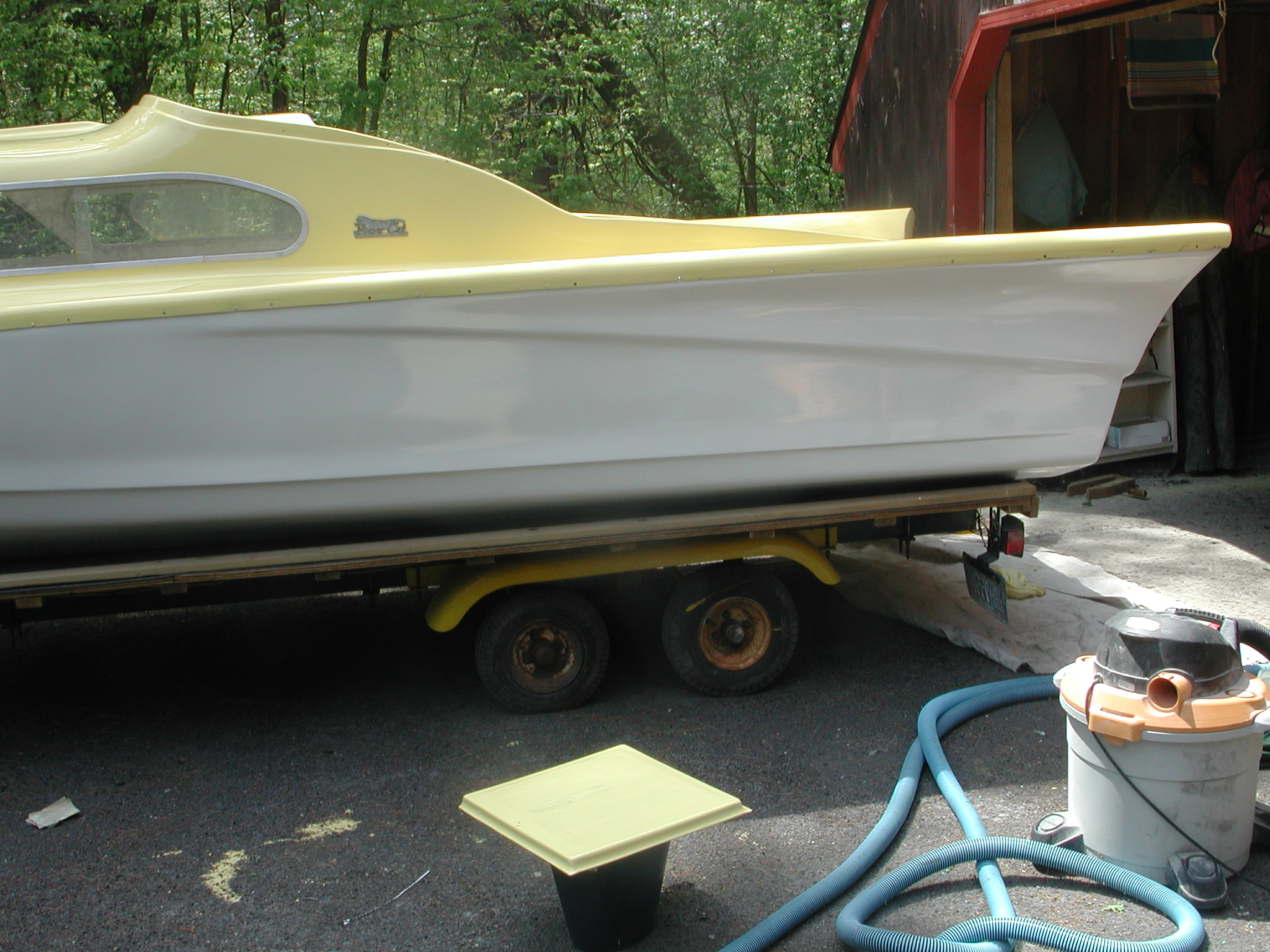

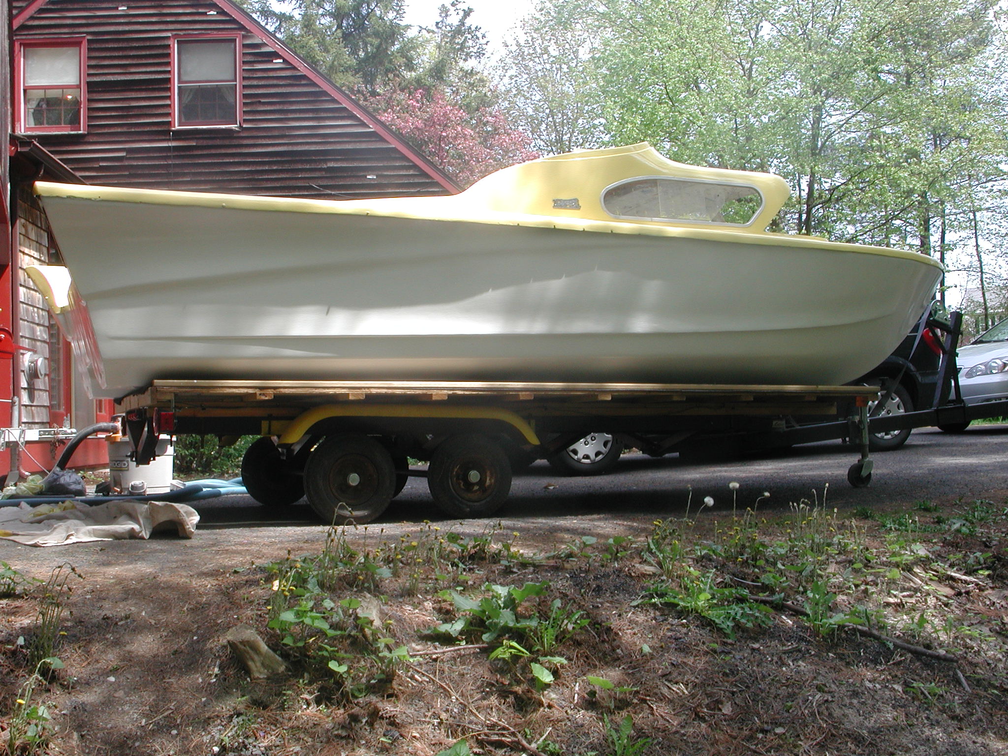

Another coat of Interlux VC Performance Epoxy on the sides and three on the transom. Maybe one more on the transom since it's all mixed. Am about 24 hours away from being ready for motors.

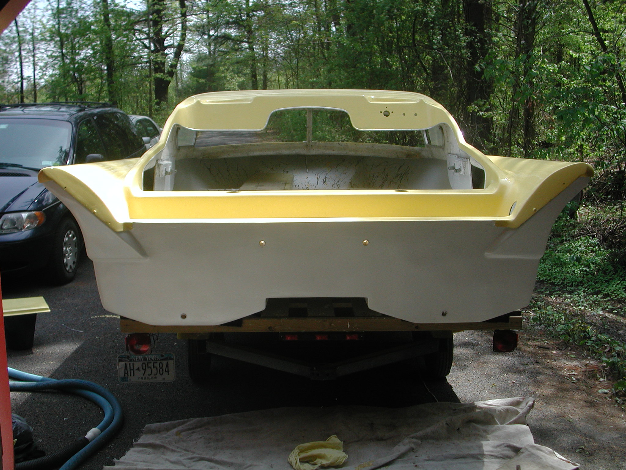

Re:Powercat 18DC 16 years 6 months ago #5802
  • crosbyboat
  • Posts: 677
  • Karma: 31

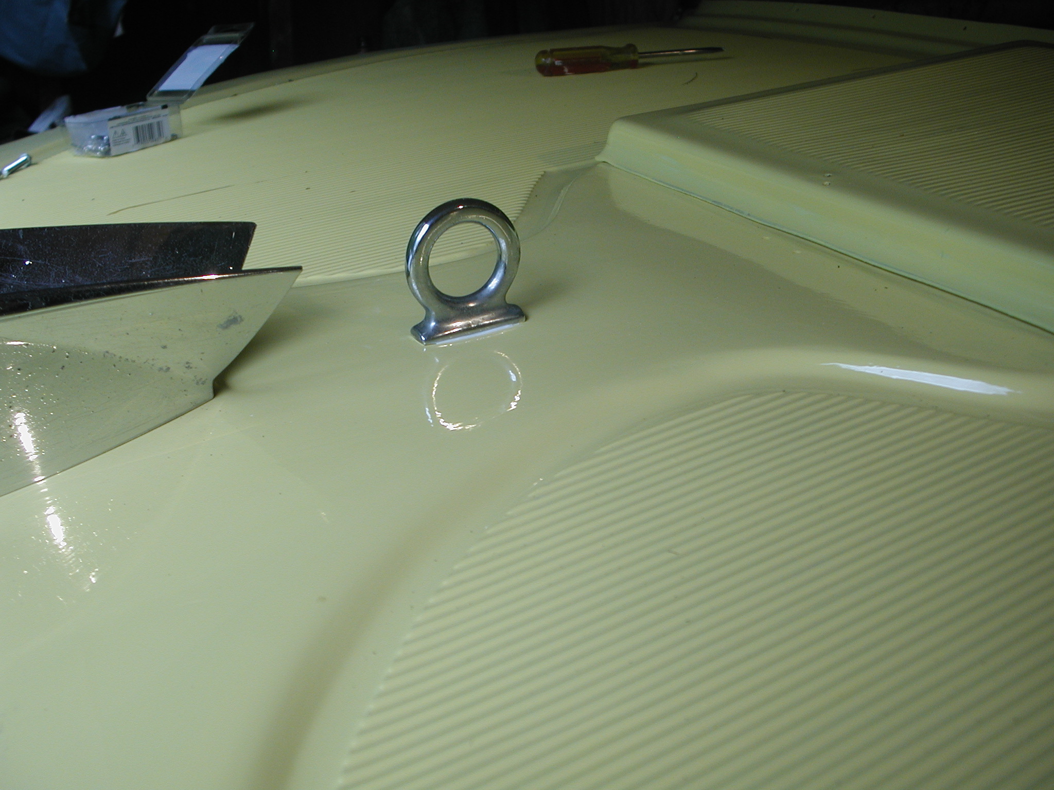

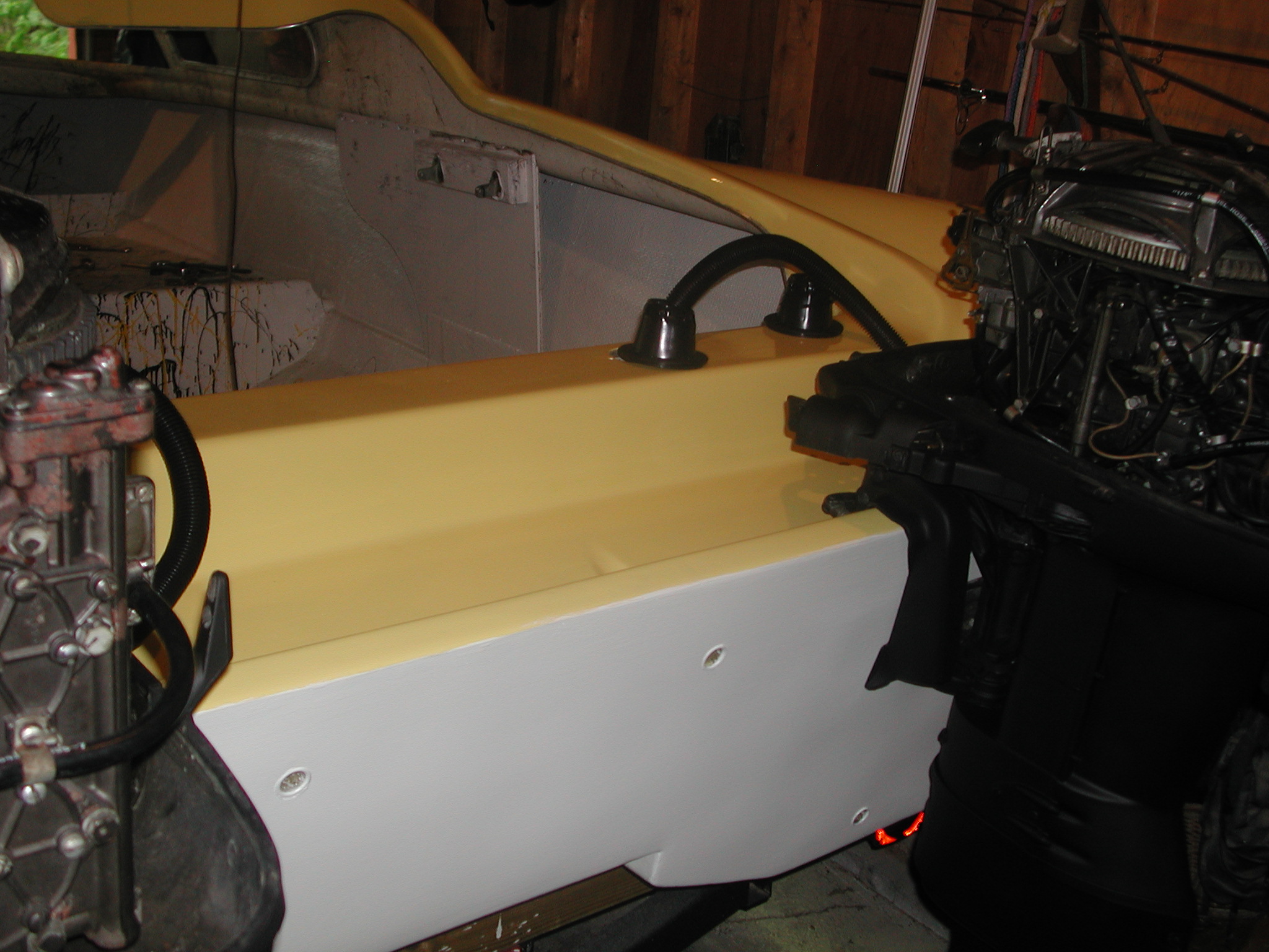

More work today. After church, sanded the transom and gave it a final coat. Installed a 1/2" chromed lifting ring on the bow. This actually goes through the deck and bolts to a very heavy duty glass tab that in turn is glass to the hull. Sort of helps hold the top to the bottom, but is the main tie off for the bow. Also installed chrome transom rings. Then put 1/4" bolts through the stbd side and pulled the top to the bottom and got out the drill and rivet gun. Time to order T-bolts and measure the rubrail I have to see if will make it with the original.

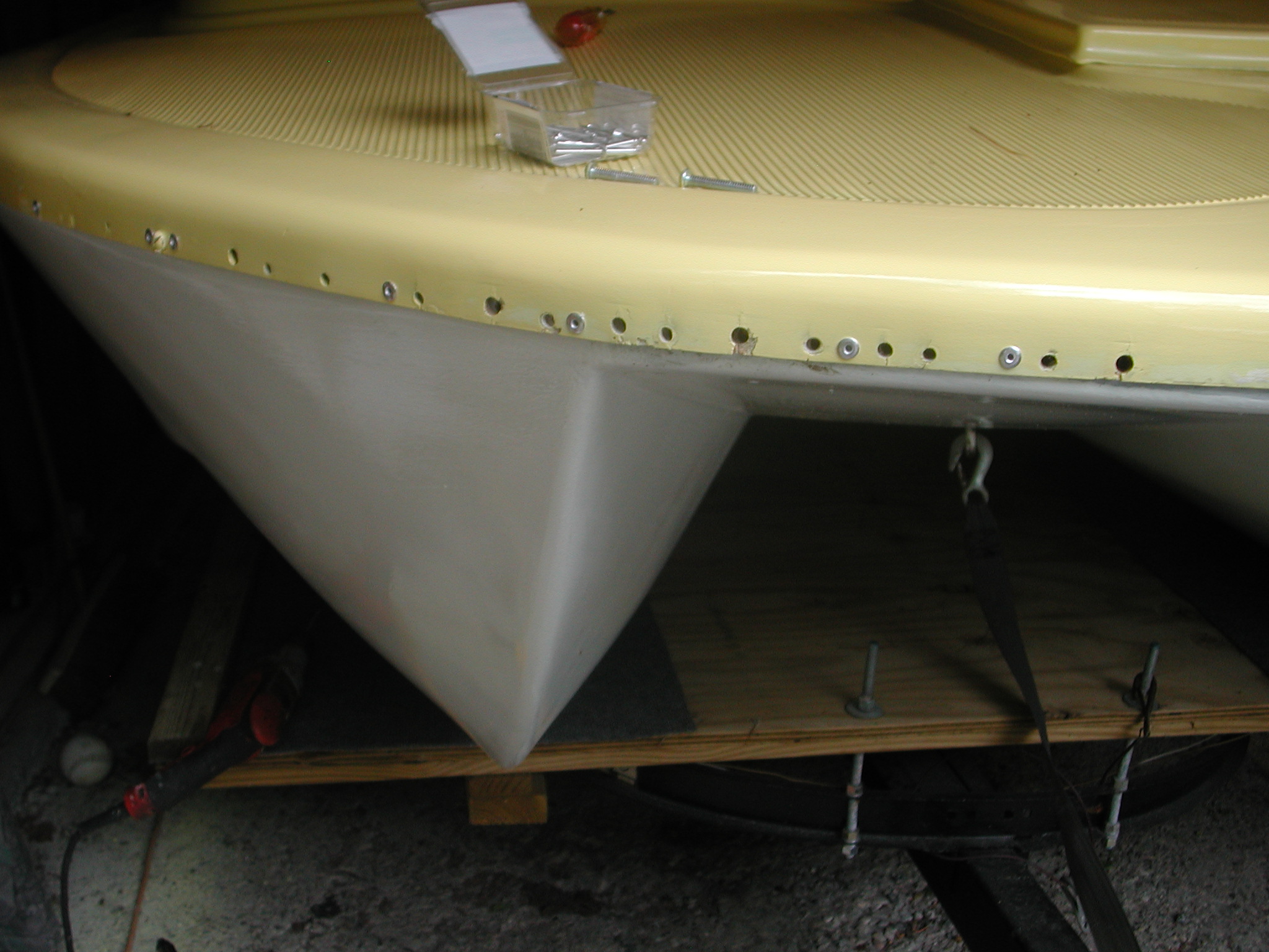

40 Feet of Rub Rail Needed 16 years 6 months ago #5973
  • crosbyboat
  • Posts: 677
  • Karma: 31

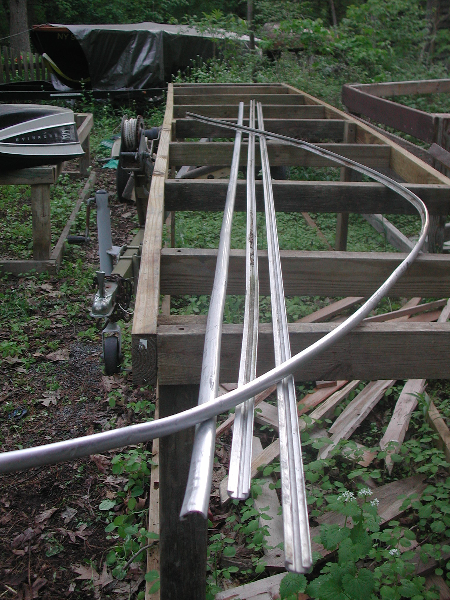

I have enough of the original rub rail to replace it. I have three 12' sections and the bow wrap around. The bow piece is pretty scratched up, but I have no options. Started wet sanding it tonight and got all the old T-bolts removed. It'll be fine. That's why it's called patina.

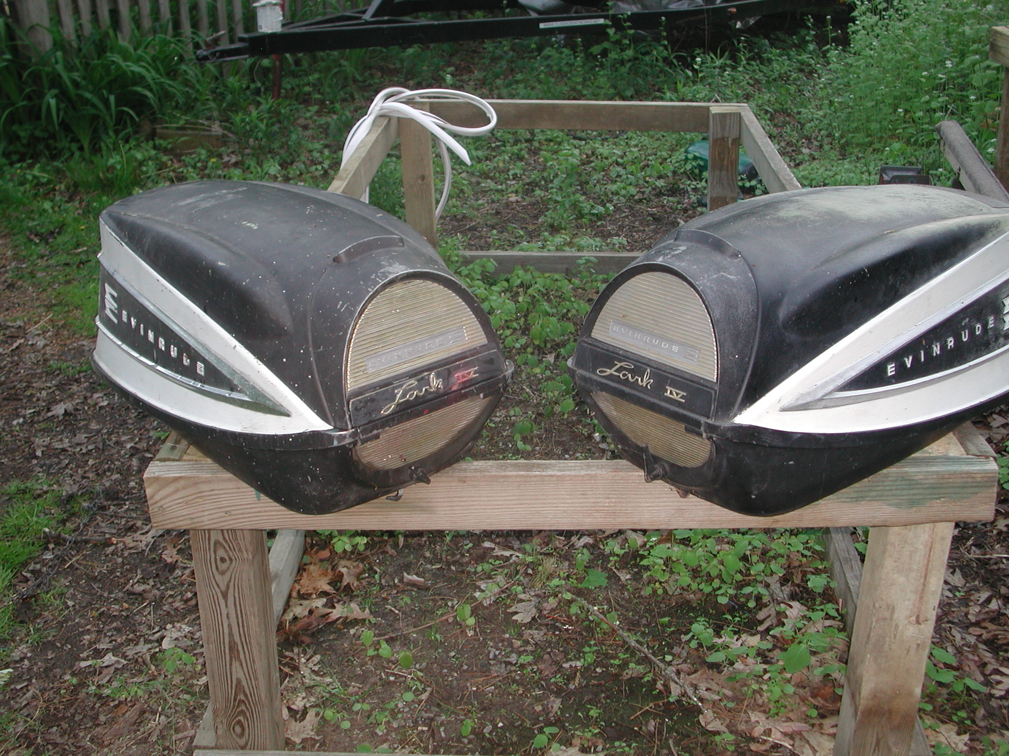

The hoods for the 1962 Larks before dressing up.
Re:40 Feet of Rub Rail Needed 16 years 6 months ago #5984
  • crosbyboat
  • Posts: 677
  • Karma: 31
Ouch.....!!! Found what I need at Rockler.....$1.09 per T-bolt...$65 for 50 bolts with shipping; figure 1 every foot or so. YYEEOOUUCCHH!! Course Rockler has never been cheap, but they have what you need.

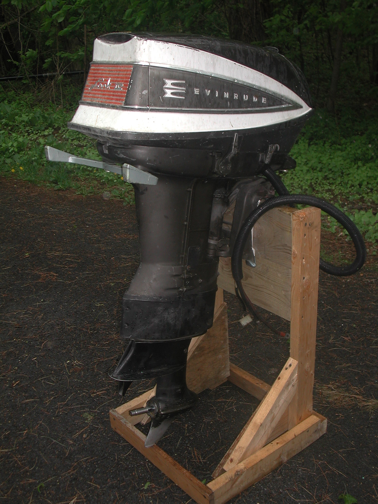

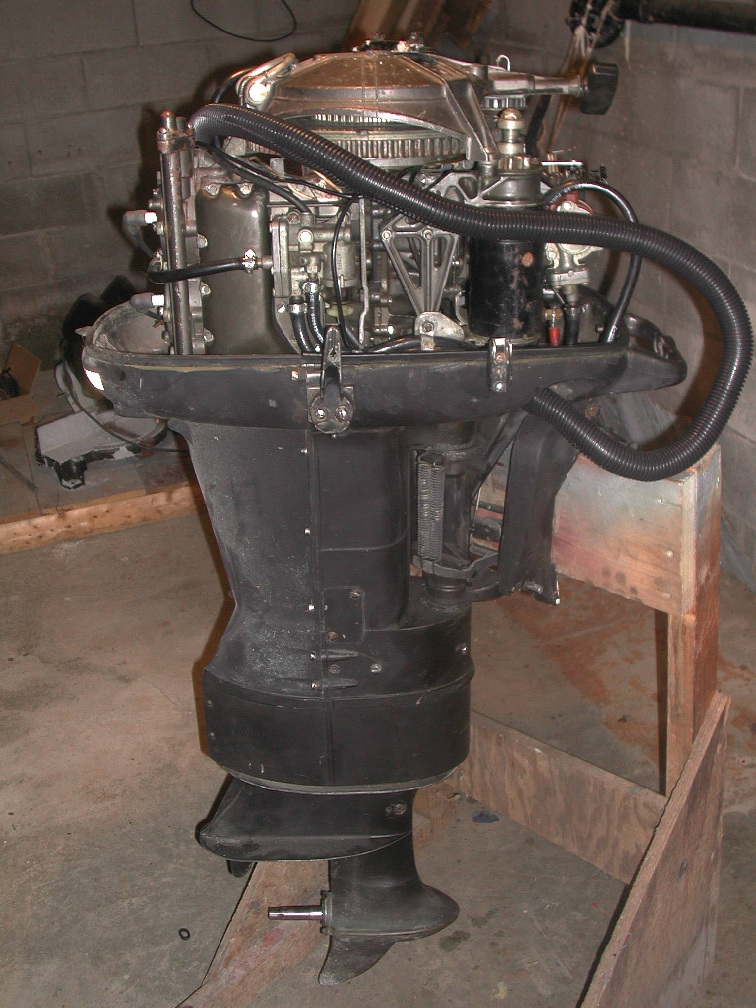

Thanks Chinewalker for working on this. All back together. Tomorrow I'll do a little painting. This one is ready to start. #2 is in the basement and is also all put together and ready to start. Just need to carry it up. And, thanks again Chinewalker for steering components. Took everything apart and sorted it all out. And thanks Frank for the vice! 50 year old dissimilar metals don't like to come apart. Making good progress.
Re:Power Plant #1 16 years 6 months ago #6273
Those are my favorite evinrudes. I love the style of this model. I've got a couple myself.

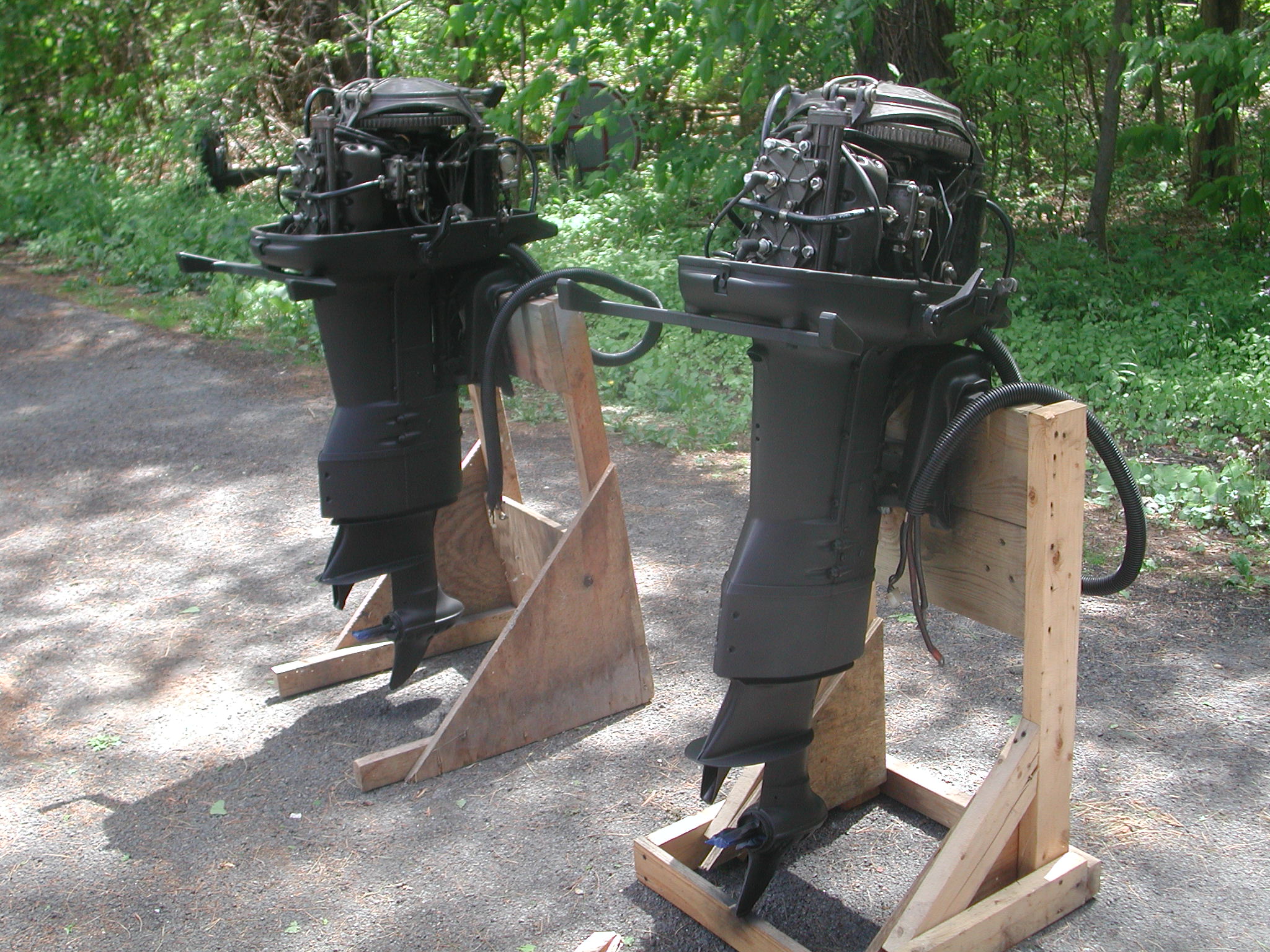

I painted this pair of bad boys this afternoon. As soon as my daughter and her boyfriend get back from shopping I'll be setting this pair of motors on the back of the Power Cat. Been a L-O-N-G road to get here, and it's an exciting day. Heading to Frank's Place now to thread a 4' steel rod to connect the two motors. Center to center the front of the motors are 50" apart!

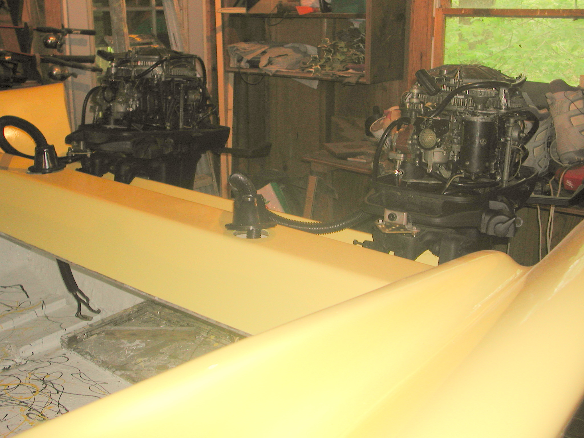

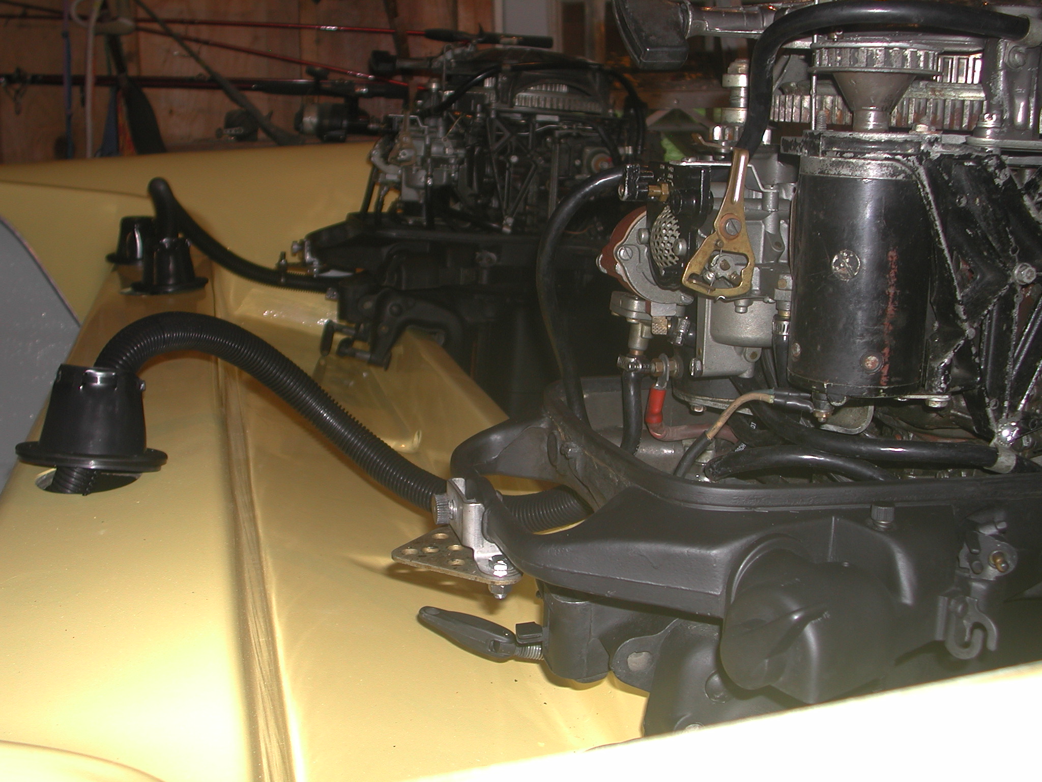

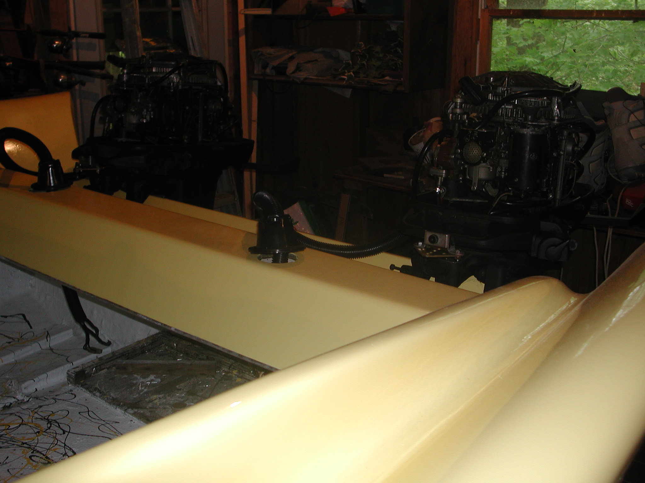

Haven't tightened them down yet. A little more to do on the connecting rod between them. Once I have them pointed dead ahead and the connecting rod on I'll tighten them down. 22 months of work on this beast so far to get to this day I've been dreaming about since the Raceboat Regatta in 2008 when I dragged it home.
Re:Power Cat 18DC 16 years 6 months ago #6327
Looking good B. Get 'em bolted down and you're one GIANT step closer to launch!
Fat Boy (Phat Bouy?) :laugh:
Re:Power Cat 18DC 16 years 6 months ago #6329
  • crosbyboat
  • Posts: 677
  • Karma: 31
LOL...this one seems to have already gotten a name; "Double Wide".

Please remind me the horse power of those motors.... It's looking great.

40 hp each. Total of 80 hp.
