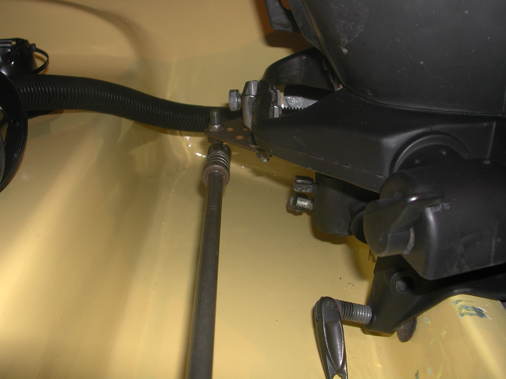

Motor Connecting Bar 16 years 5 months ago #6420
  • crosbyboat
  • crosbyboat's Avatar Topic Author
  • Posts: 677
  • Karma: 31

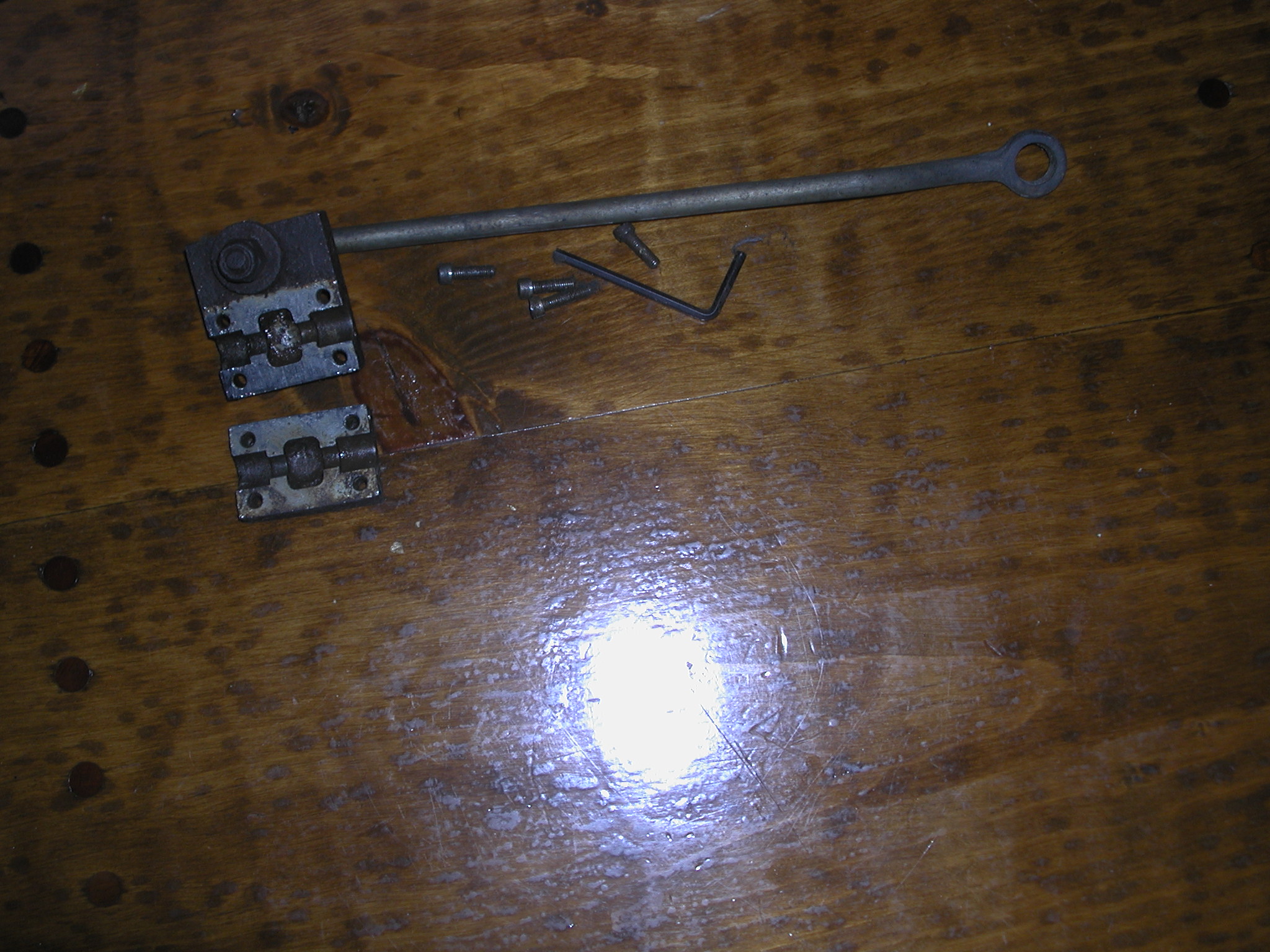

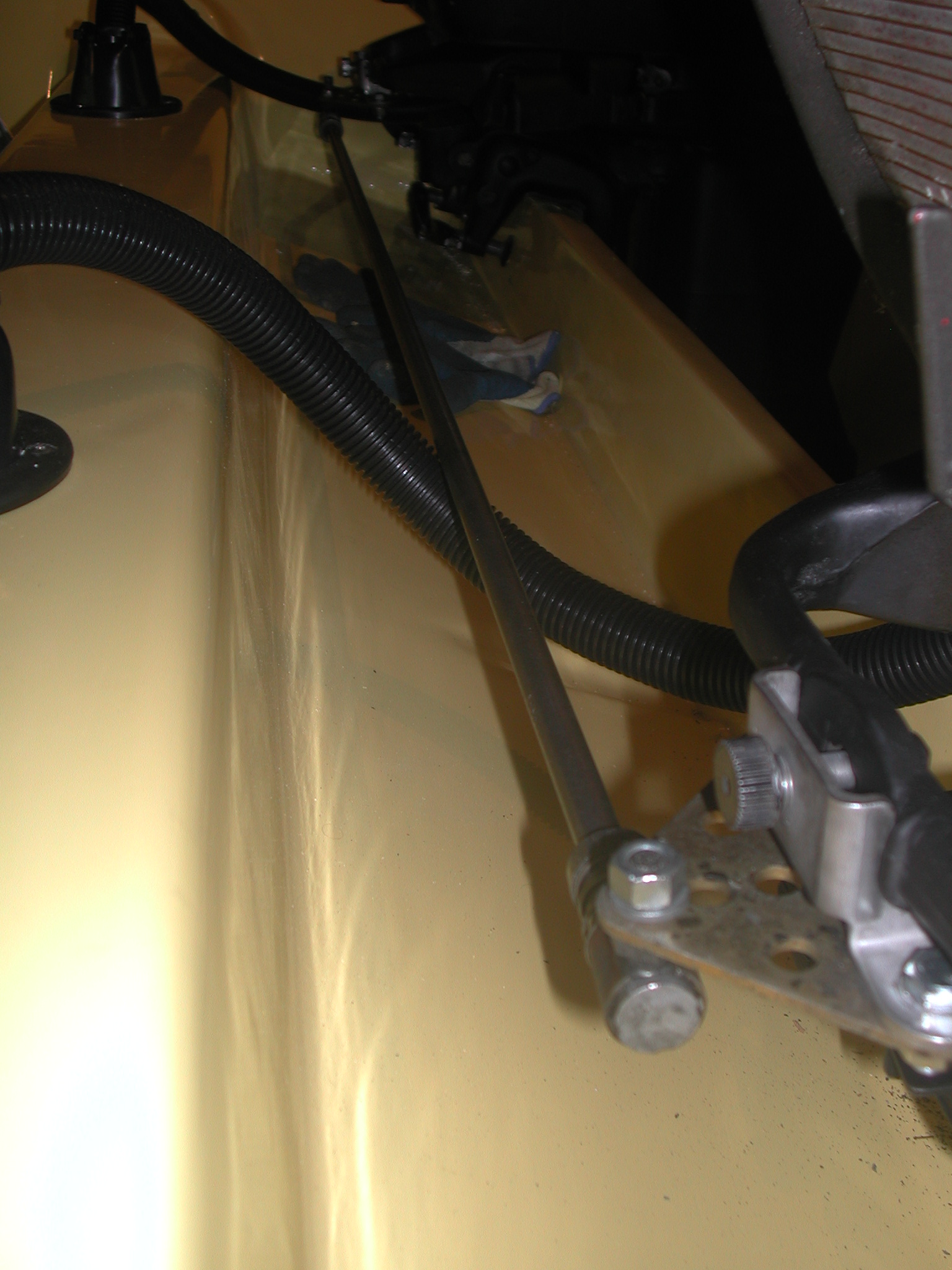

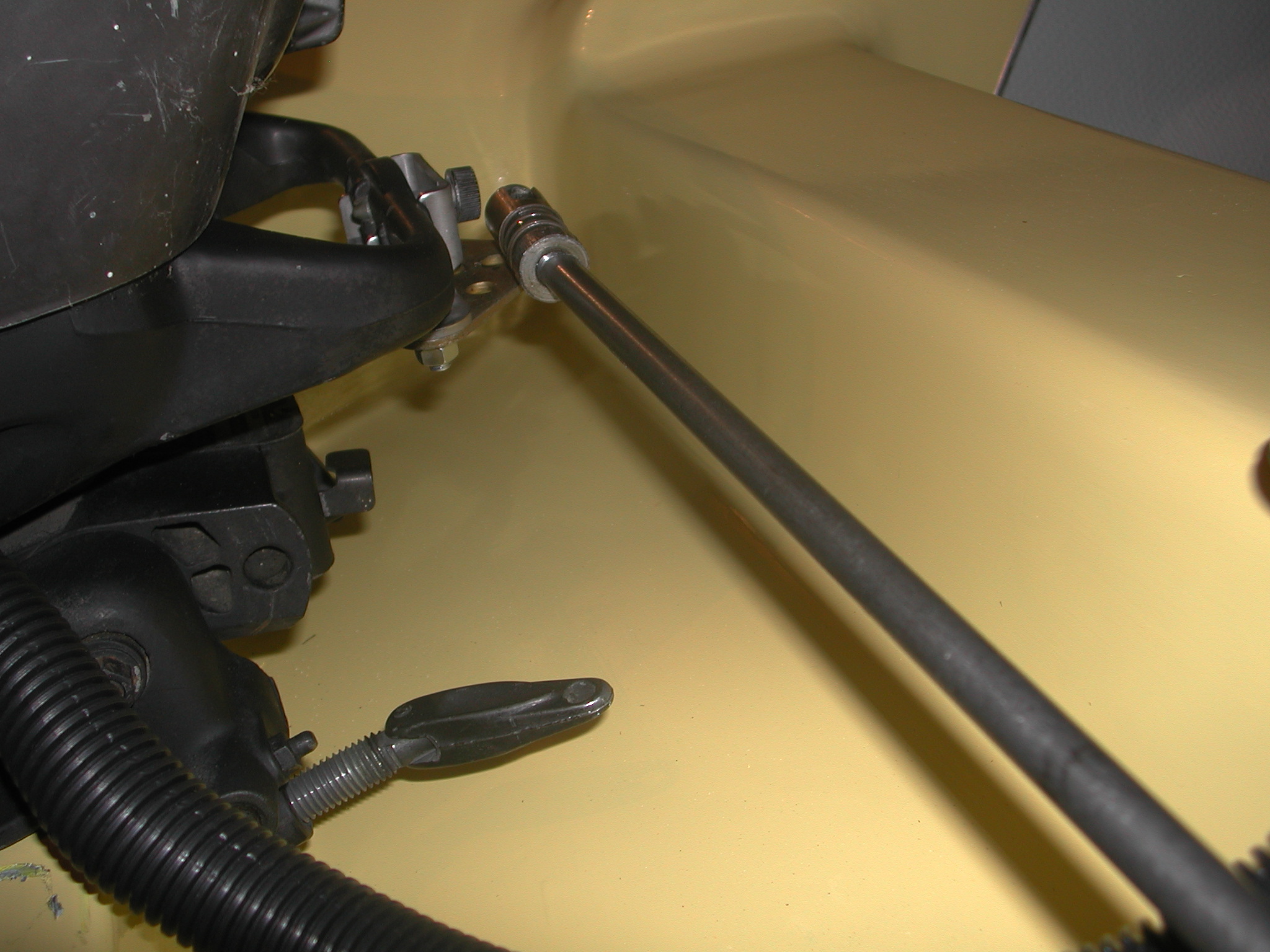

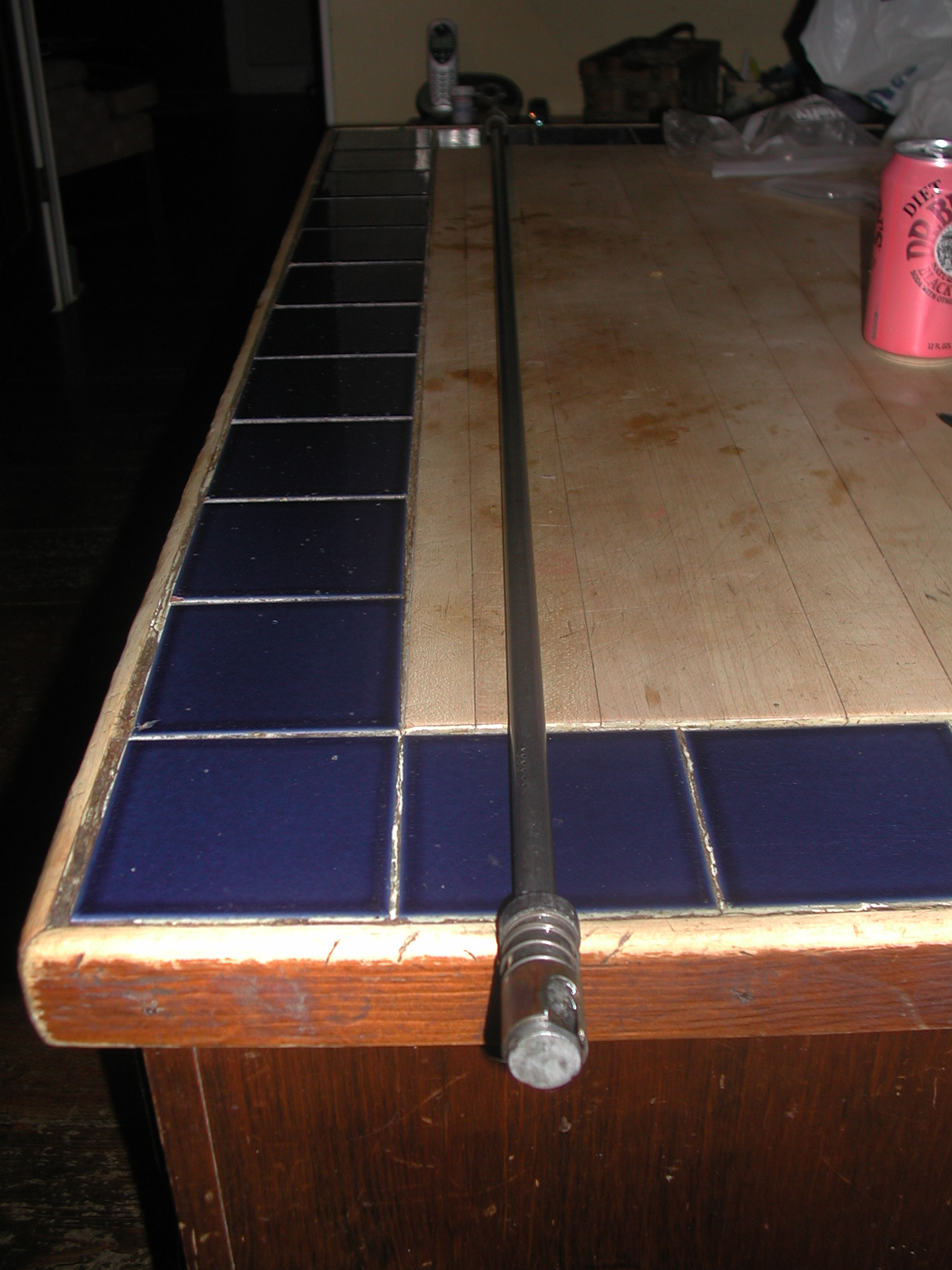

Just got back from Frank's place and building the 50" socket to socket connecting bar to connect the Evinrude 40's steering. Came out great. And, had an email from Greg Anderson when I got back telling me he was sending me ball and socket joints he picked out of his metal recycling bin. You gotta love this place!
1) Thanks to Chinewalker for parts; 1 socket was 7/16" fine, the other 1/2" fine. So Frank and I drilled out the the 7/16" and tapped it for 1/2" fine. Then took a 48" steel rod and threaded the ends with 1/2" fine. Viola. A 50" socket to socket connecting bar.
2) Thanks to Frank for the drill press and tap and dye set. Ok, it cost me a 29/64 bit. Cheap enough.
3) Thanks to Greg Anderson for ball and socket joints on the way.
Re:Power Cat 18DC 16 years 5 months ago #6422
B, It appears you're "well-connected". Get it, connecting bar, friends, joke? Never mind. :blush:
Re:Power Cat 18DC 16 years 5 months ago #6425
  • crosbyboat
  • Posts: 677
  • Karma: 31
LOL...excellent. Next is figuring out how to connect the old Mercury RideGuide to the steering bar, well, after I remount the wheel. Shouldn't be too hard. I have the transom cable clamp so, it's really figuring out how to connect from the cable end to the connecting rod, or the closest motor. I'm thinking it's going to need to be the rod as without a tilt tube on the Rudes there's nothing to latch onto and still have room for the cable clamp between the fin and the first motor. Probably become obvious once the steering cable is back in.
Re:Power Cat 18DC 16 years 5 months ago #6446
Just so everyone knows, I didn't require the drill bit as payment. Brian just gave it to me. Of course, he will always know where it is when he needs it again... :laugh:
Hooking your steering cable to that rod would certainly do the trick B. Get er dun!
Long day today for Frank. Not much time to work on da boat. Same for tomorrow. Bah.
Frank

Any way to mount the cable bracket inside the fin, B? (That would probably make too tight of a turn for the cable tho, now that I think about it.) Looks like your motors are pretty close to the fins, think I see your dilemma. May have to come out to the middle area with a longer cable, mount the bracket there and weld a connector to the rod? Just thinking.......I'll shut up now, I know you'll figure out something!
Re:Power Cat 18DC 16 years 5 months ago #6465
Looking good Brian! Glad you were able to make something out of the pile of steering parts I left for you. My vote for first run is the St. Lawrence - then I get to help synch them! And drink your beer afterwards. ;)

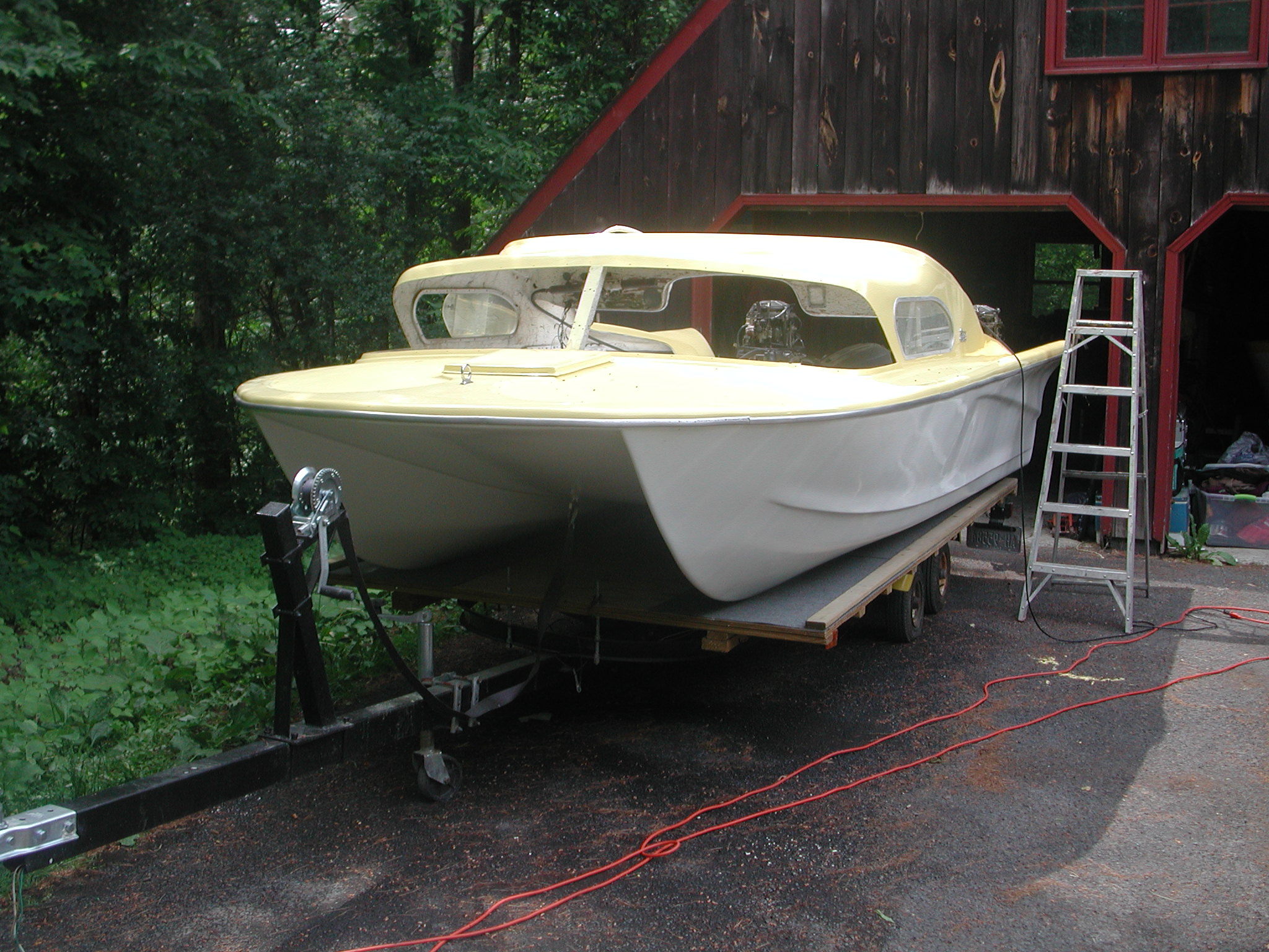

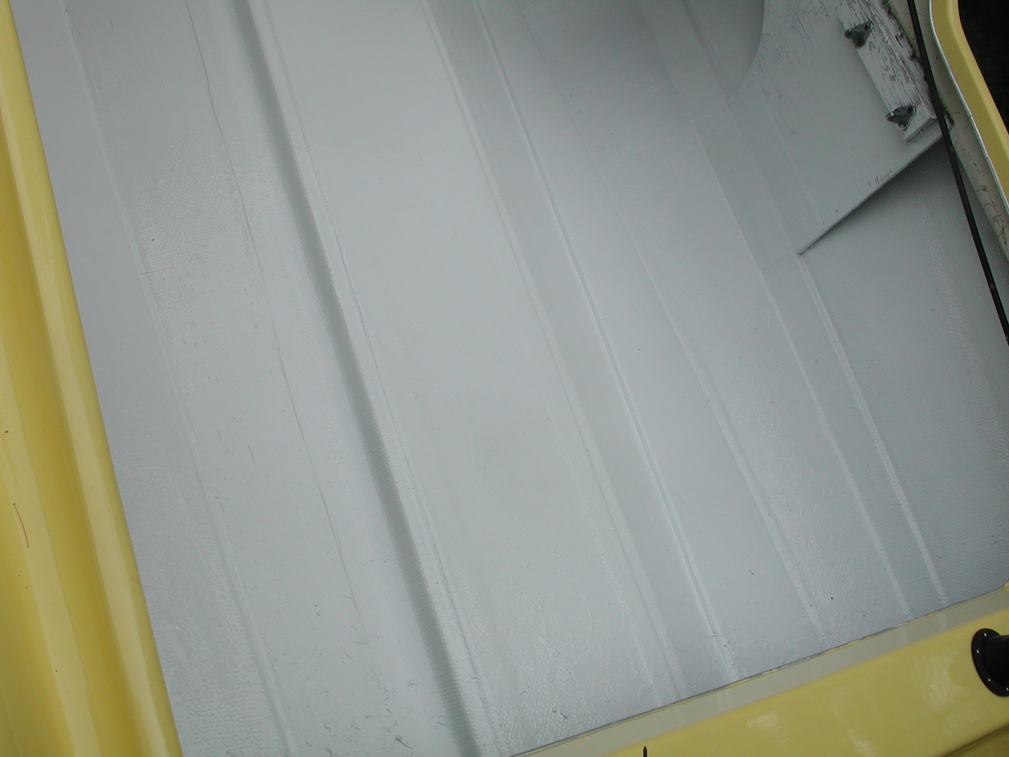

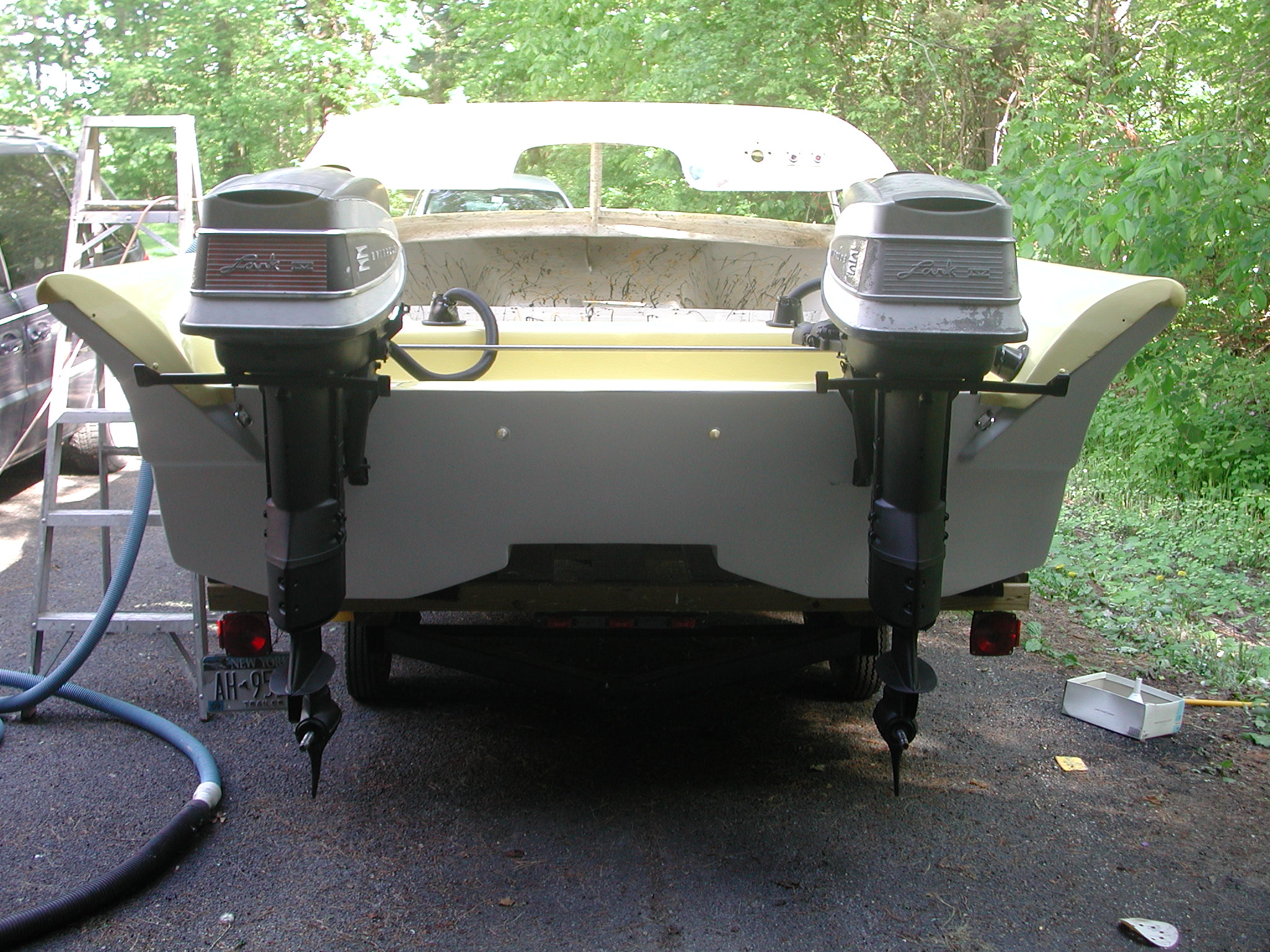

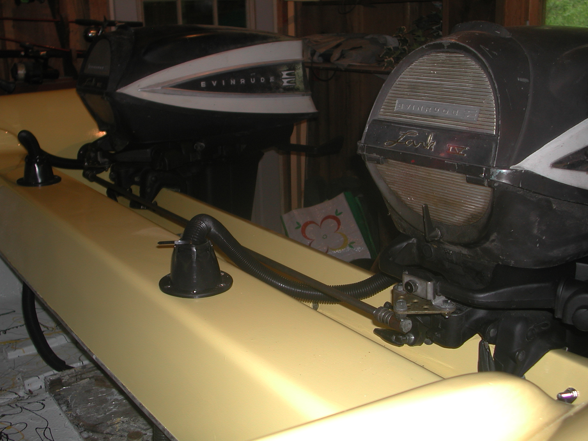

Sanded the 4 pieces of rub rail I have. Laid it out on the boat. More than enough to do the rail and have enough left over to make a pair of transom trim pieces. Polished up really nice, except for the deep gouges from the storm. Those sections I will cut out and discard.
Also, cleaned the forward bulkhead which I hadn't done anything with in almost 2 years. This just gets put back in as is. It's in great shape, was just very dirty.
And finally with the motors on and the boat out of the garage I was able to get far enough away to capture both motors on the boat. I'm thinking instead of DOUBLE WIDE, which I never really cared for, this one ought to be called SEPARATION ANXIETY. (And recognize I haven't wet sanded the transom yet. It's got 8-9 coats of Interlux VC Performance Epoxy on it. Will wet sand it on a nice summer day when I can be in the water with it.)

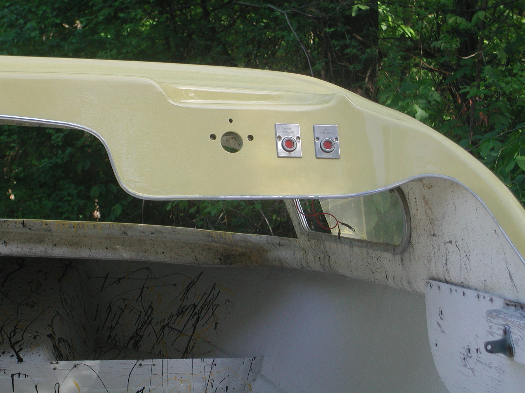

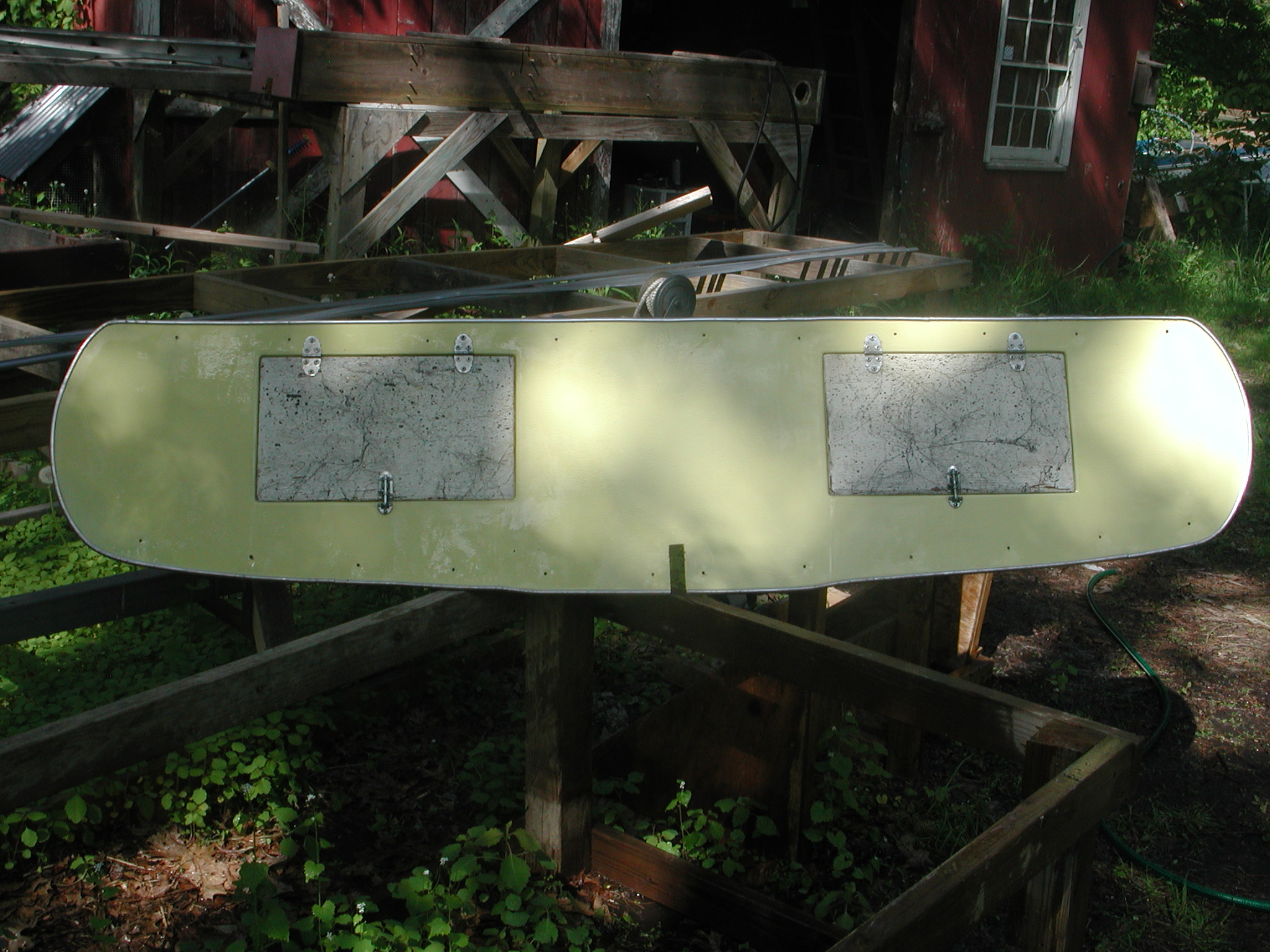

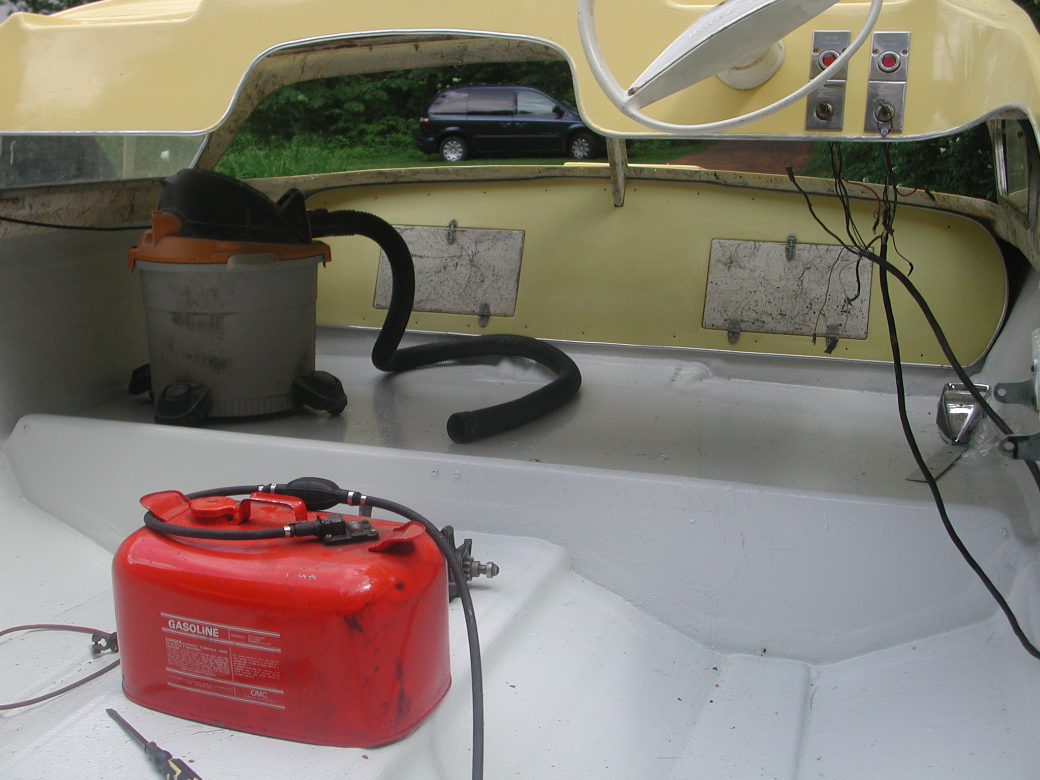

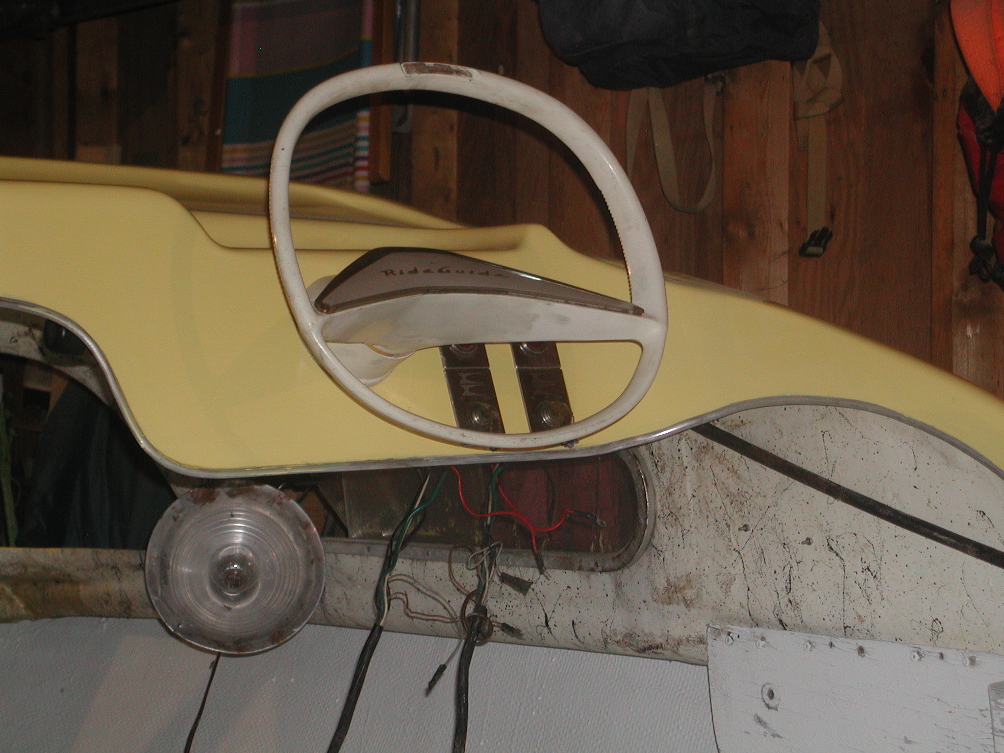

And finally today, completed repairs to the dash. I had a problem where a large batch of kitty hair I mixed up a while back I did not adequately mix in the hardener. I found 2 or 3 spots where I could dent a large fill I made (speedo hole?). Dug all the still soft stuff out and mixed up new filler. Sanded and painted it out. Installed the two overheat lights in the dash. Ready to start rigging the steering and wiring harnesses. But first I need to glass the inside seam, and paint out the interior again (my wife does not like my art work), then I'll install the rub rail.

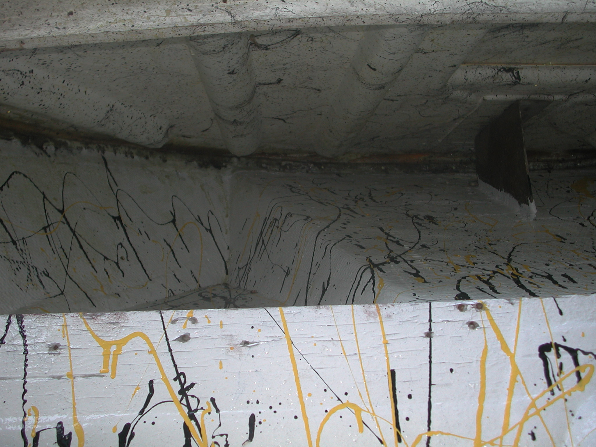

RideGuide steering system back in. Ignition switches drilled.
Re:Power Cat 18DC 16 years 5 months ago #6922
Didn't like the spatter job huh?
Those engines do look as if they don't like each other way out there. Sounds like you are nearly there, keep up the good work.
Bernie

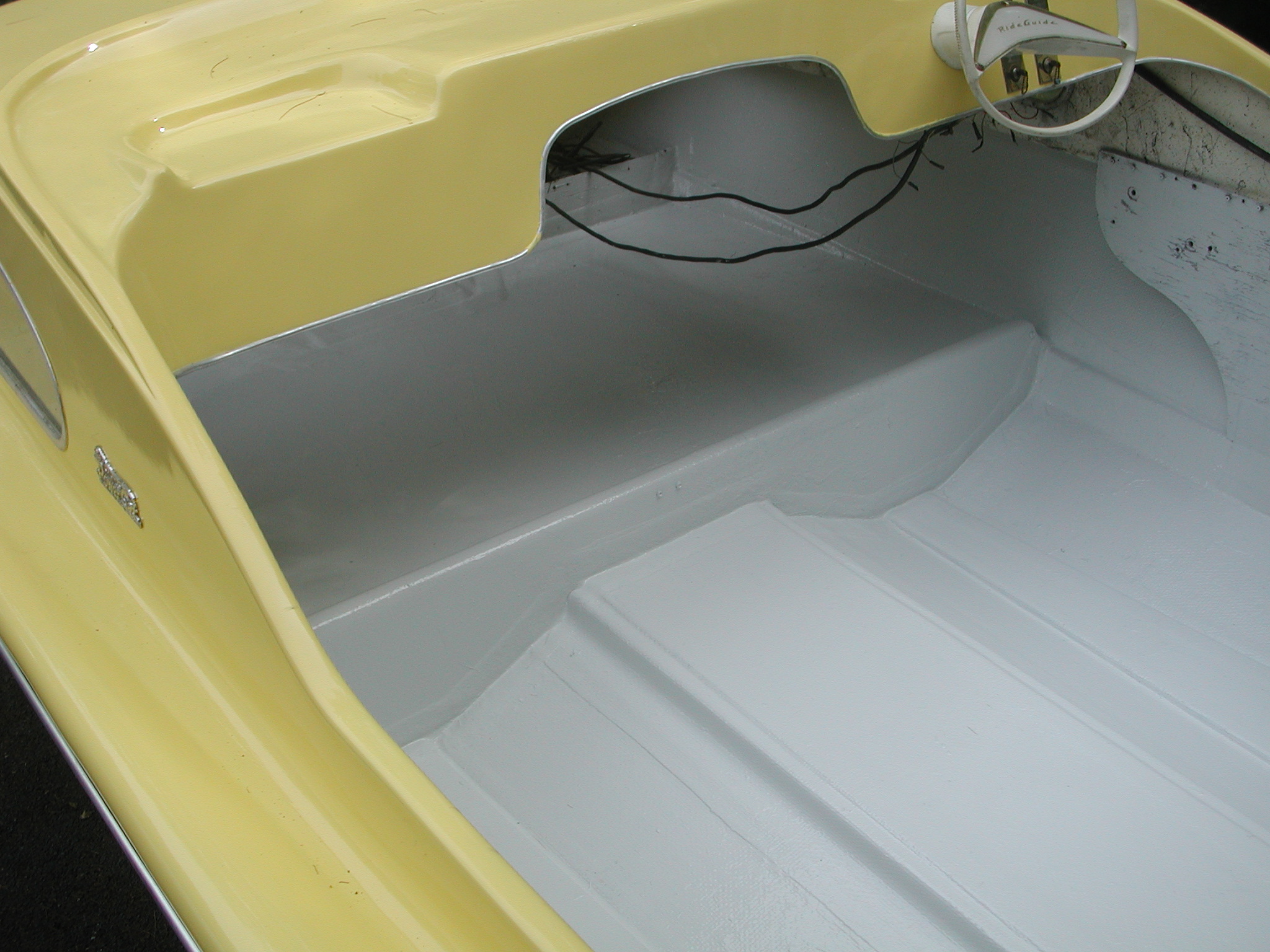

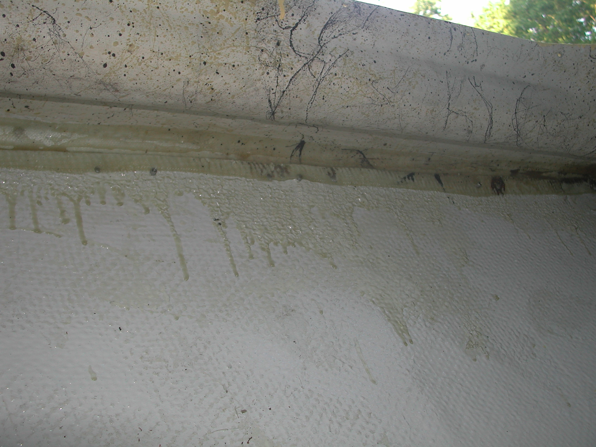

A fresh night on the 18DC. Laid up the rest of the inside seam before dinner while I was still fresh. And...worked port to stbd, not stbd to port. That's my natural work position. Was able to get up under the deck and get all the way around the boat with the seam tape and resin. Was thrilled. And...the T-bolts came from Rockler. Next is the rub rail installation.
Re:Power Cat 18DC 16 years 5 months ago #7146
Certainly one of the nicest looking boat desings out there. You're a master artisan Brian. Fabulous attention to detail.

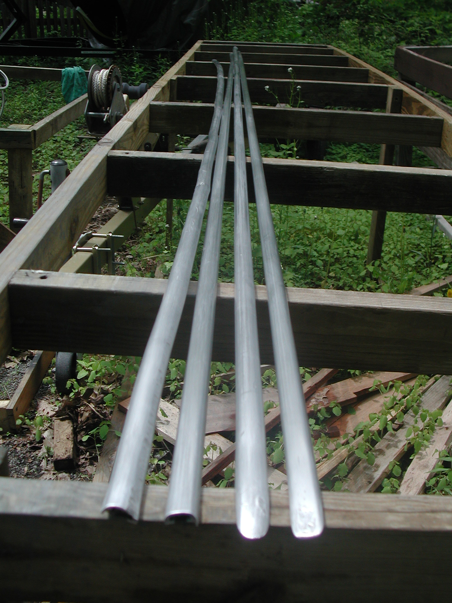

Re:Power Cat 18DC - Rub Rail 16 years 5 months ago #7214
  • crosbyboat
  • Posts: 677
  • Karma: 31

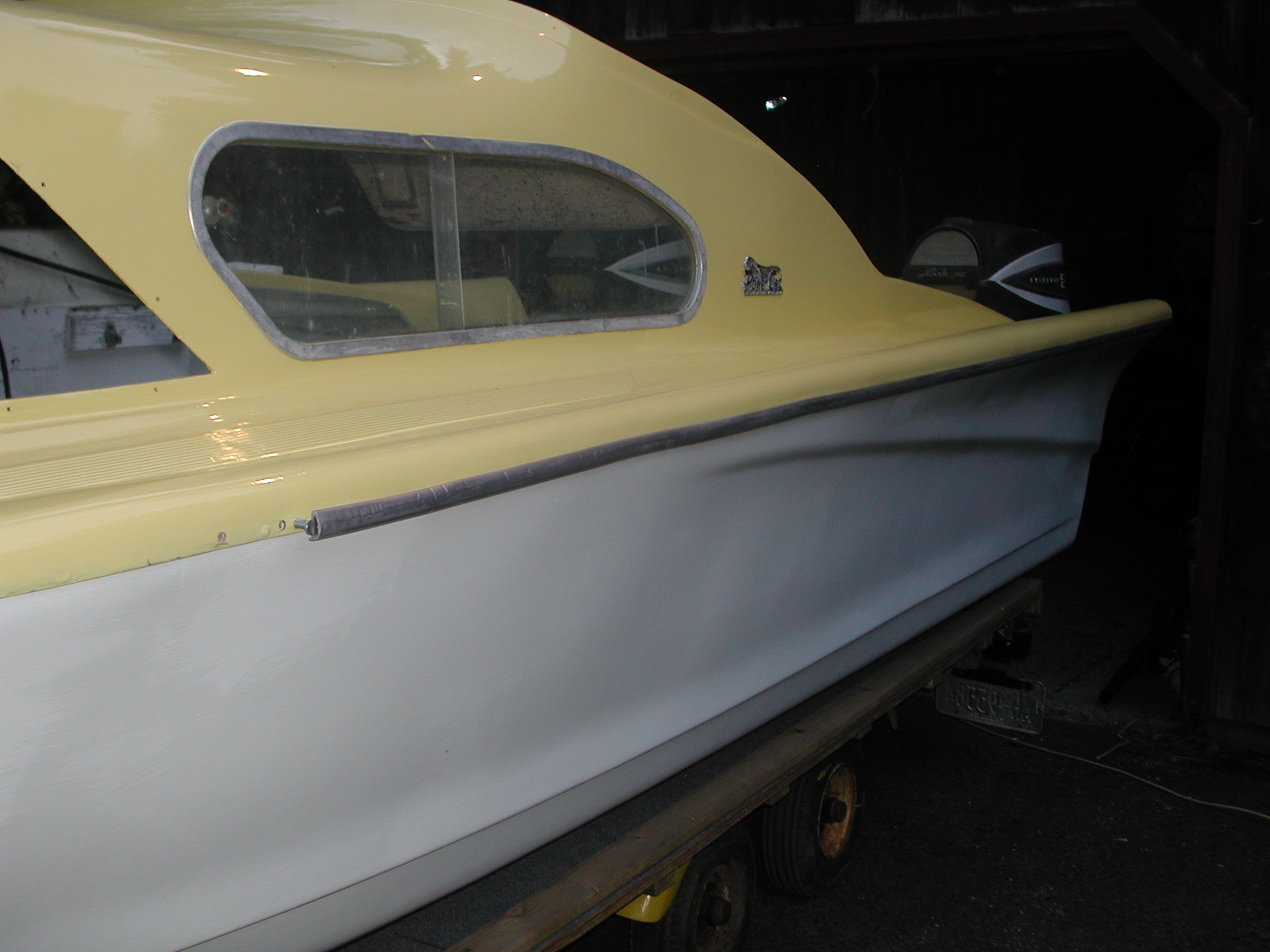

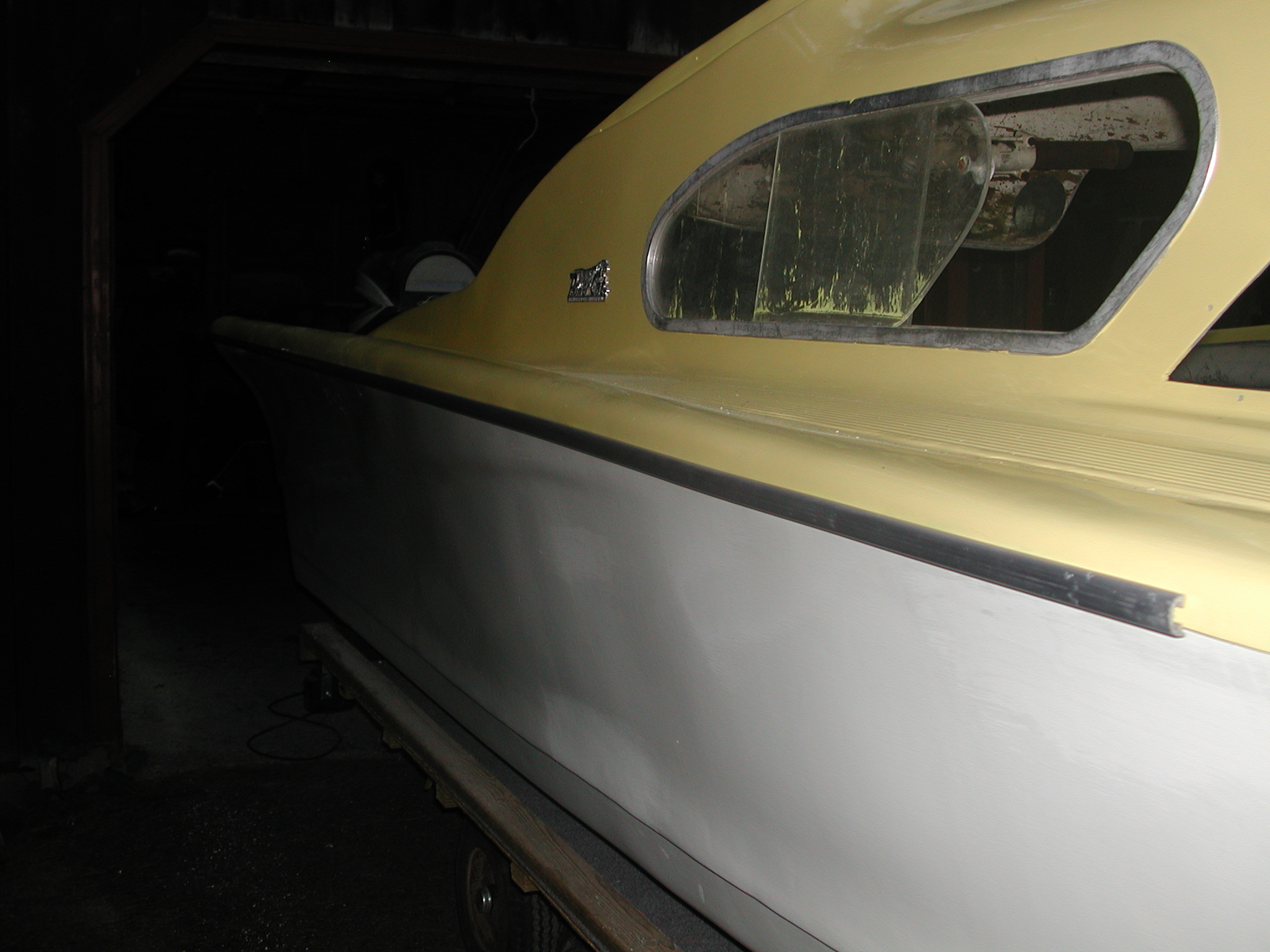

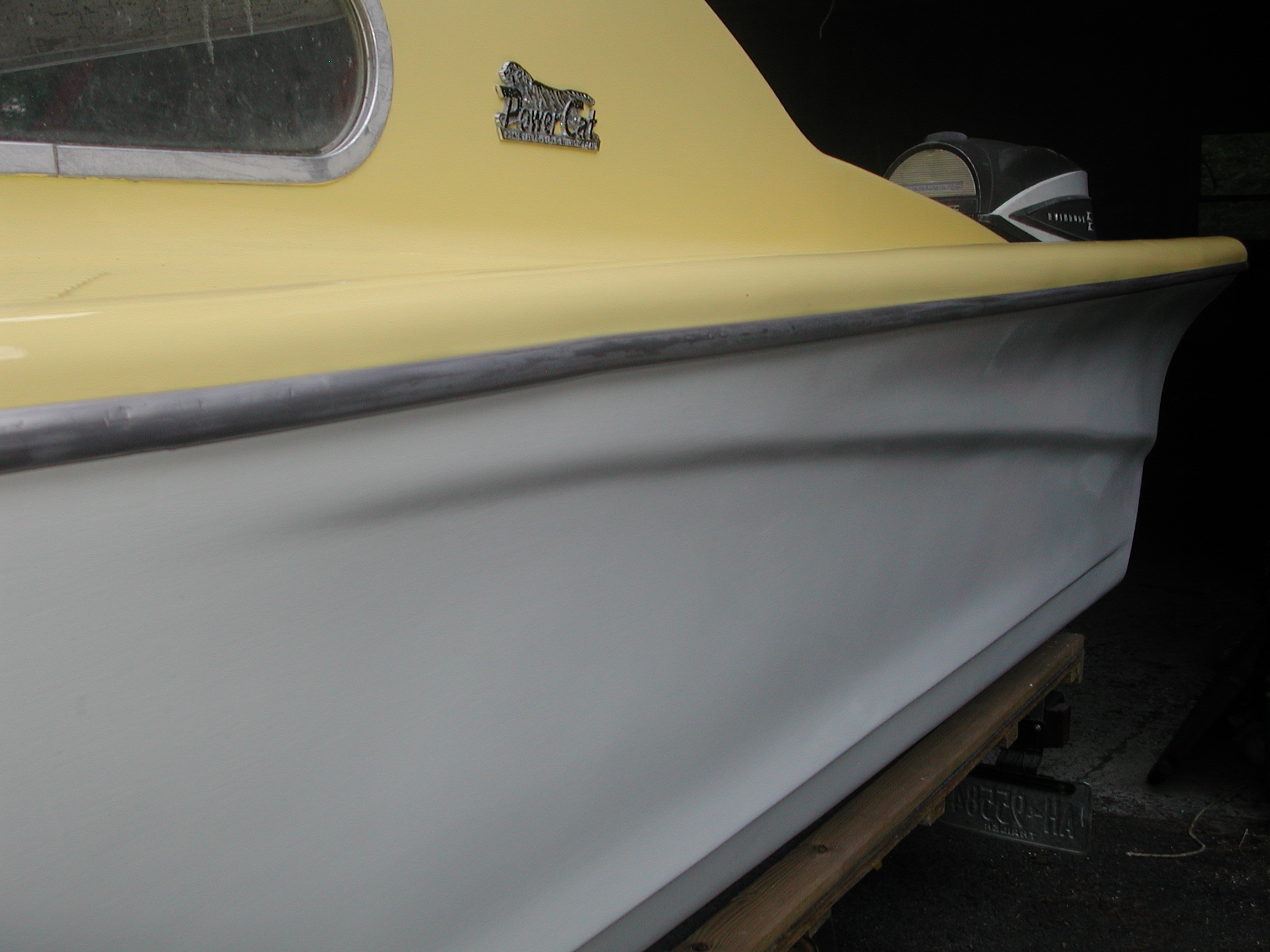

Got two 12' rub rail sections ready to install. Big day tomorrow. Lots of small jobs to do.

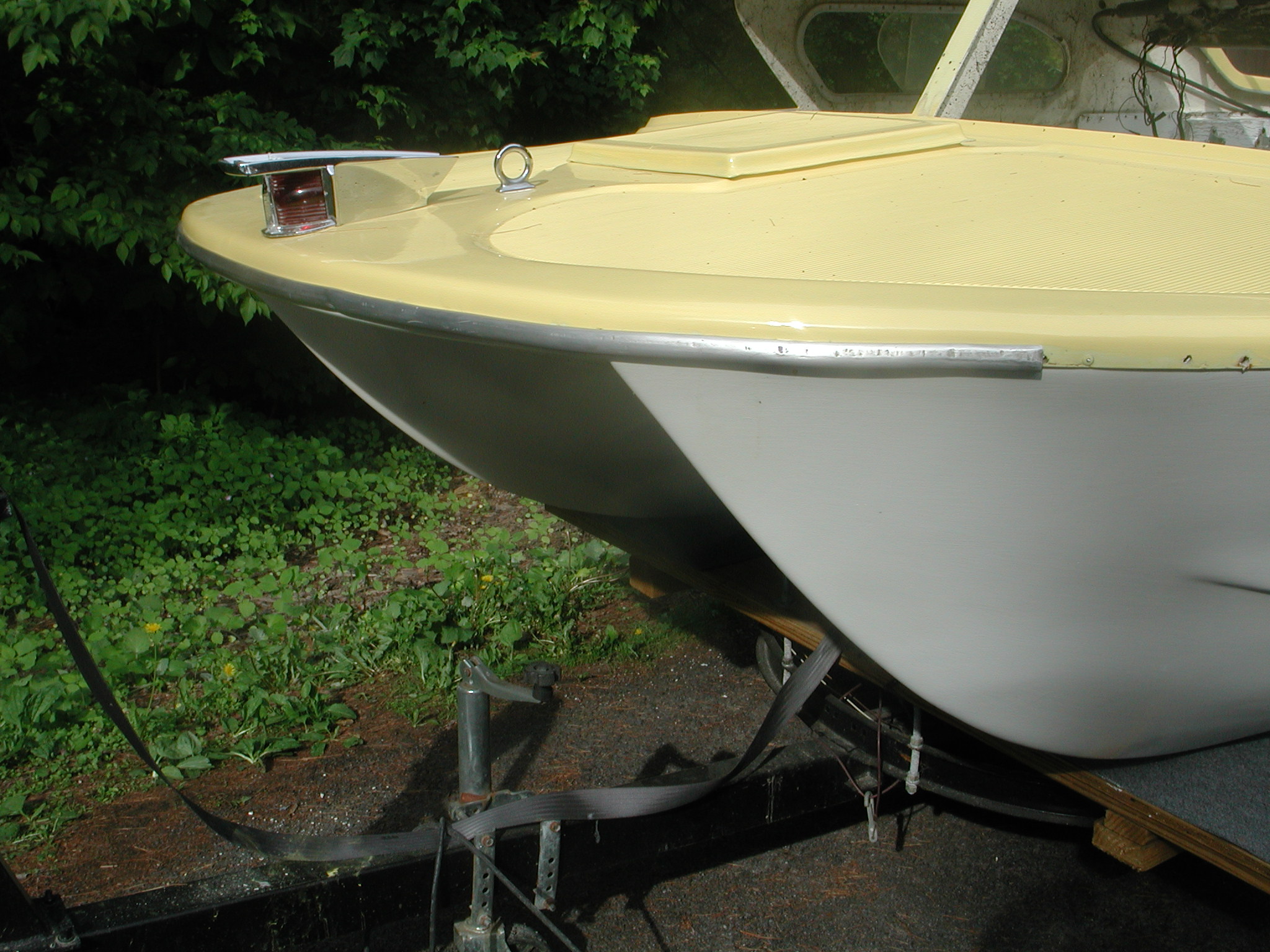

Re:Power Cat 18DC - Rubrail On - Well Most of It! 16 years 5 months ago #7242
  • crosbyboat
  • Posts: 677
  • Karma: 31

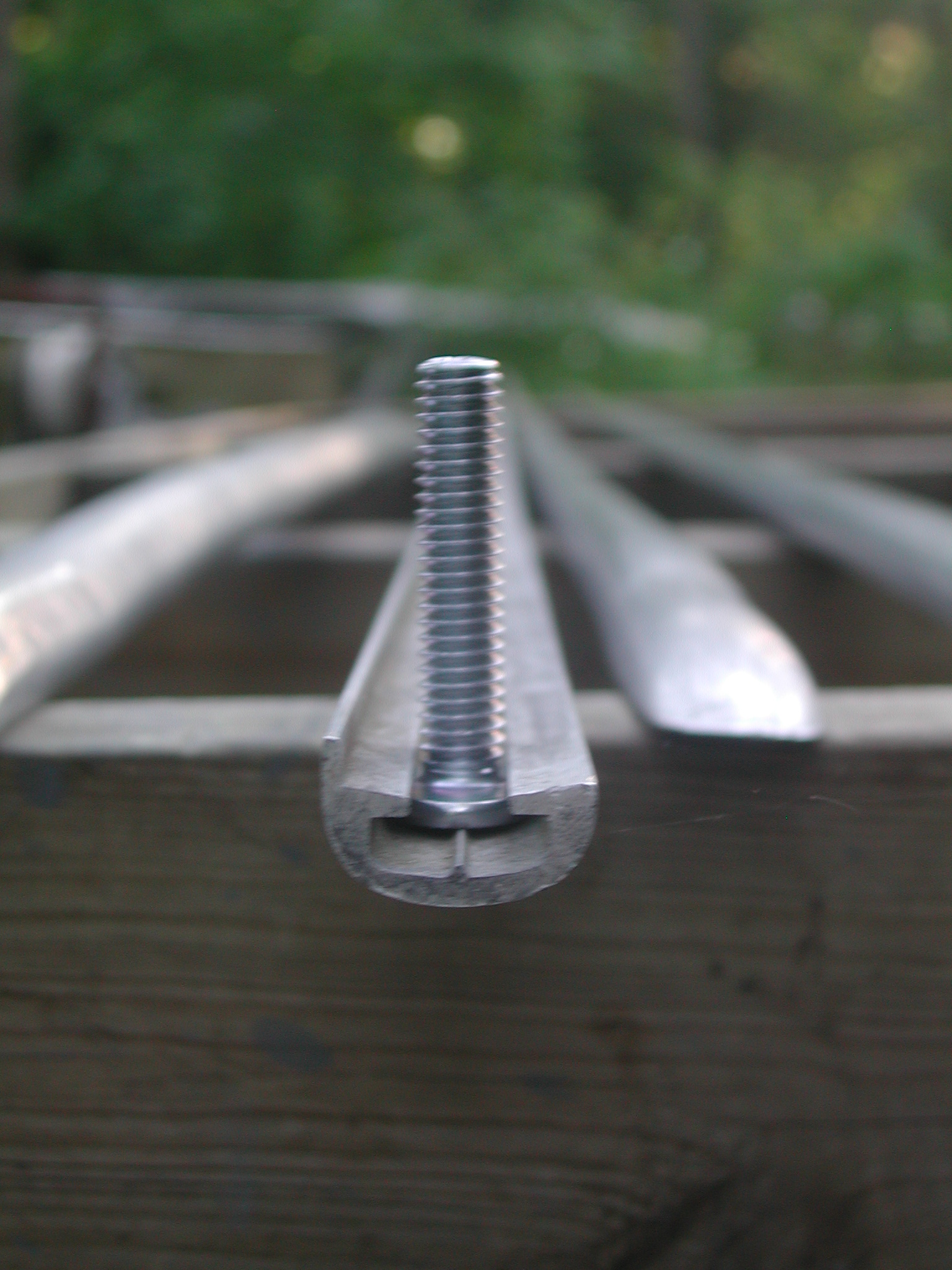

Bought 44 T-bolts. Should have bought 60. Takes a good number to make the turns and pull everything in nice and tight. Ordered more this morning. Cut out as much of the badly damaged section that I could. A few scratches are left behind. Best I can do and have enough to finish the boat. A ~4' section on each side left to do, and the two transom trim pieces. I have 4 T-bolts left, so will make and install the transom today, and finish the side rail when the additional bolts come next week. I think I've crawled under the deck for the last time, and will install the fwd bulkhead later today.

Bright, and boring. That's what my wife wanted. It is impossible to be an artist!
Re:Power Cat 18DC 16 years 5 months ago #7271
Jeeezzzeee, "Sell the Cutter" (Me), "I want the red and white seats (Frank), "paint the inside white" (Brian)! I hope they appreciate our undying love. :P

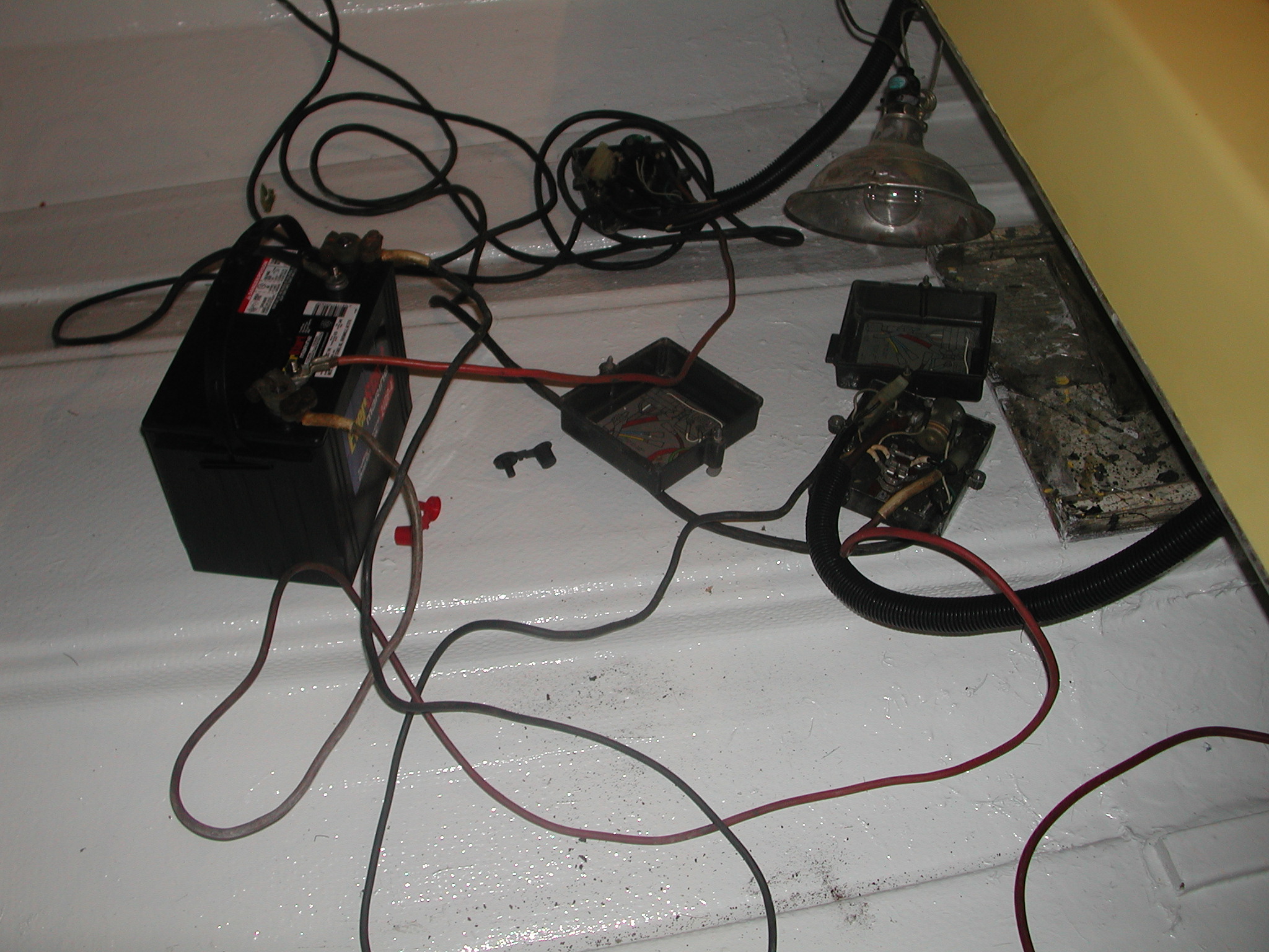

Re:Power Cat 18DC - We have Ignition 16 years 5 months ago #7505
  • crosbyboat
  • Posts: 677
  • Karma: 31
Wired the twin 1962 Evinrude Lark IV tonight. Bought a new battery and gave them a whirl. Port engine spinning fine. Stbd is spinning slow. I'm thinking the starter is bad. I have several spares. Will swap the port harness to the stbd motor later to rule out the solenoid. Continuity through both. Life is good. I want to add gas to the port engine!
Re:Power Cat 18DC - We have Ignition 16 years 5 months ago #7517
  • crosbyboat
  • Posts: 677
  • Karma: 31
After swapping wiring harnesses, the slow spinning motor stays with the stbd side, does not follow the harness swap. That tells me the problem is the starter most likely....the only part of the starter circuit that stayed with the motor.

Ok, back from Memorial Day, Monday night I swapped out the starter to stbd. Same result, slow spin. WTF? Pulled the spark plugs, and the engine whipped right around. Hmmm....shot a little WD40 in each hole and spun it for 10-15 seconds. Let it sit all day until last night. Plugs back in. Went through the battery-started wiring on both motors again hand over hand tightening everything and checking things. Both motors spinning nicely now under compression. Stbd motor could have been dry from not being run, or I could have had a loose connection causing losses. It's great now. Tonight I'll install the solenoid boxes to the transom under the splashwell and pretty up the harnesses. Also, as soon as I saw the fitting that Madprops posted earlier I thought I've seen something like that before. Monday night went out to the shop and there at the end of old bent connecting rod between the old Mercs that use to be on this was the same style fitting, but complete with a motor connecting bar! Taught me I need to better forensics during project take down and maybe log on paper what I found.

Fired off the port engine last night. Wham! Instant start. The stbd engine sputtered and balked and backfired so I quit for the night. Corrected the problem on the stbd side this morning and started it up. Uh...I reversed the plug wires. That doesn't work so good!
I'm all too familiar with the "shooting yourself in the foot" syndrome, nice to hear somebody else experiences that problem once in a while. :laugh:

Actually, truth be told, the mistake was mine. I rebuilt the magnetos for Brian and I mis-marked the tag for the TOP spark plug wire. Doh!!

Re:Power Cat 18DC 16 years 5 months ago #8427
  • crosbyboat
  • Posts: 677
  • Karma: 31

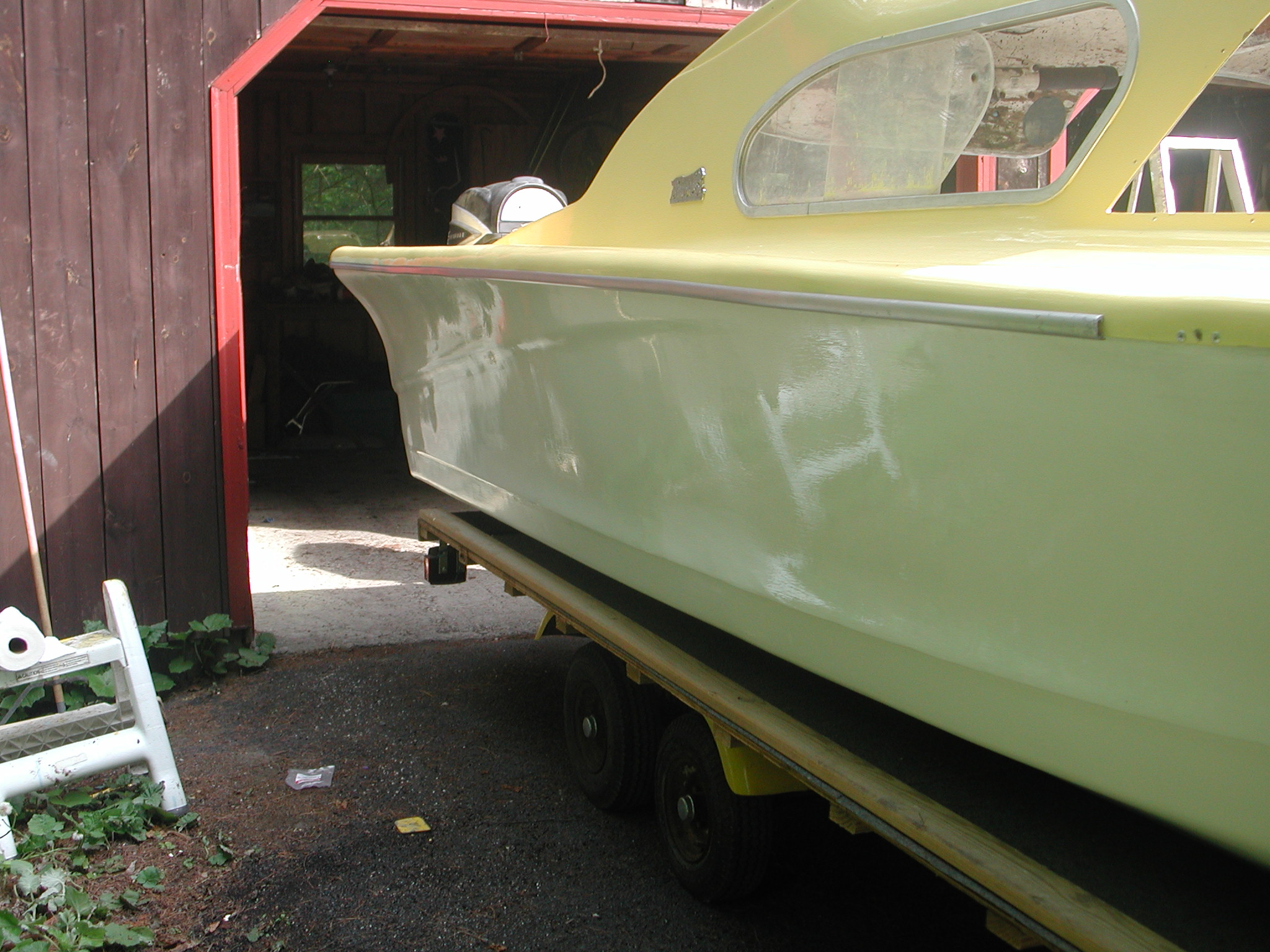

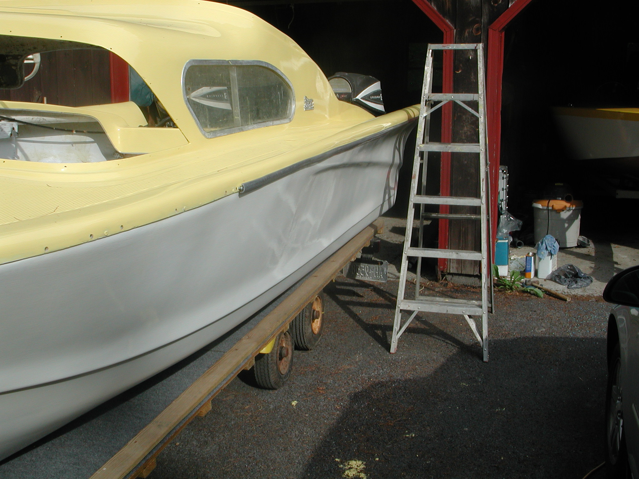

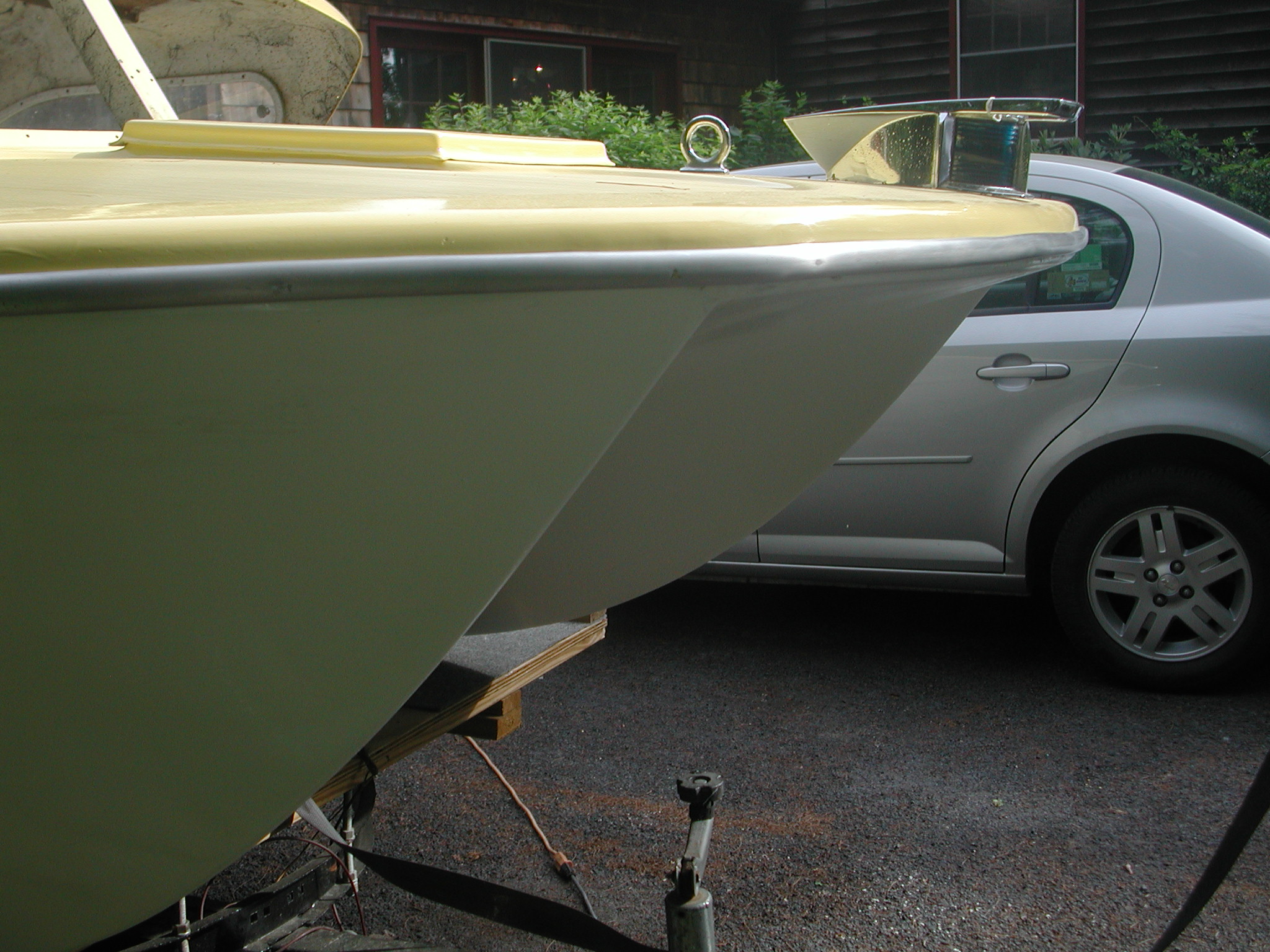

Got the last of the rub rail on today. Not an exact match, but durn close and glad it was in the boat. It works. Also got the wiring harnesses dressed up some, and the forward bulkhead is back in. Need to get some grommets and screws tomorrow.
Re:Power Cat 18DC 16 years 5 months ago #8532
At the risk of double posting (again)
I agree with your wife, the plain white interior looks better, we'll see when it gets some dirt on it...
Do you have the windshields for the cabin?

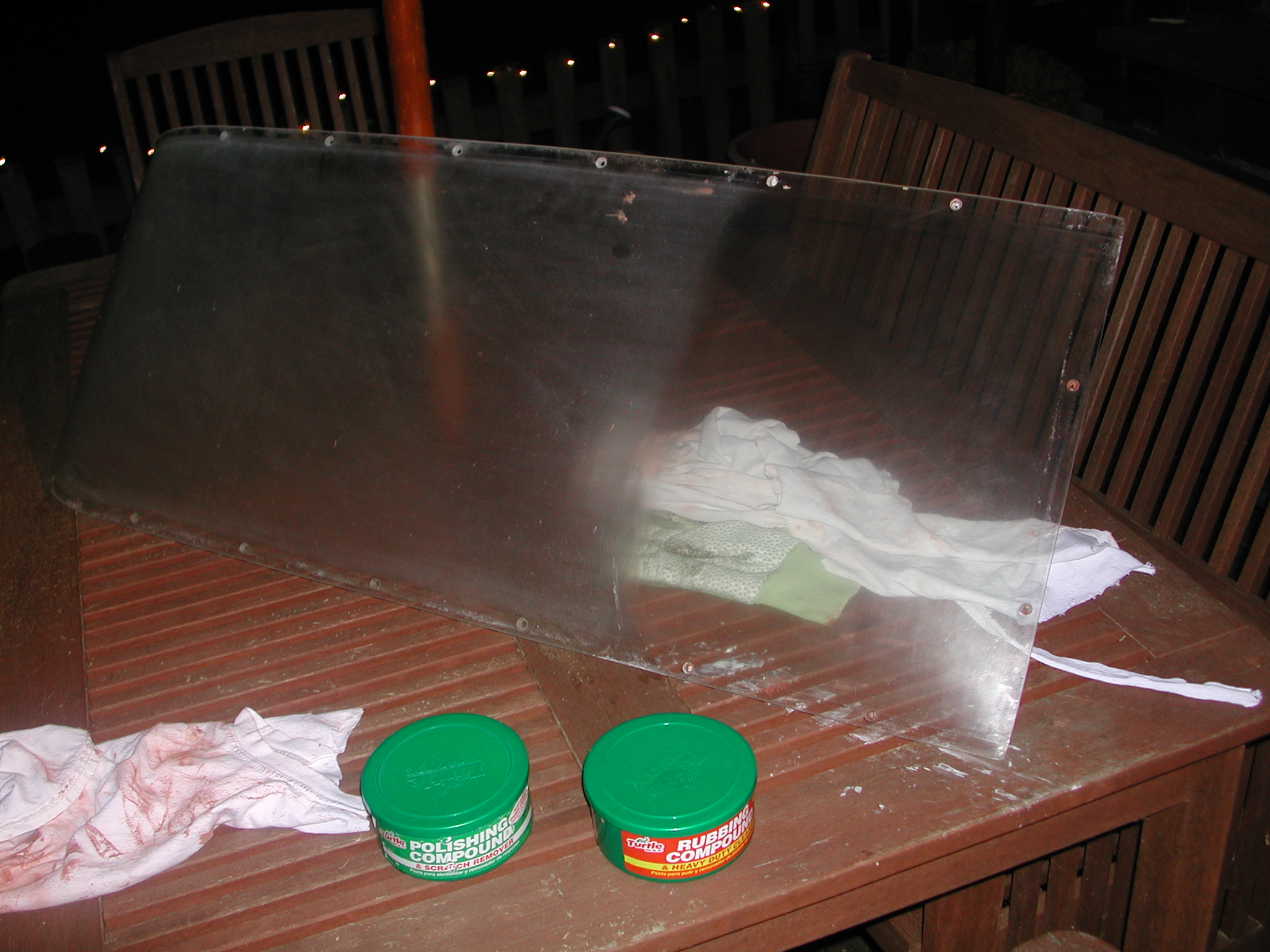

Re:Power Cat 18DC 16 years 5 months ago #8634
  • crosbyboat
  • Posts: 677
  • Karma: 31
Hi Bernie - Yes I have the windshields but they need some serious work. Just bought compounds tonight to try to recover them.
Brian

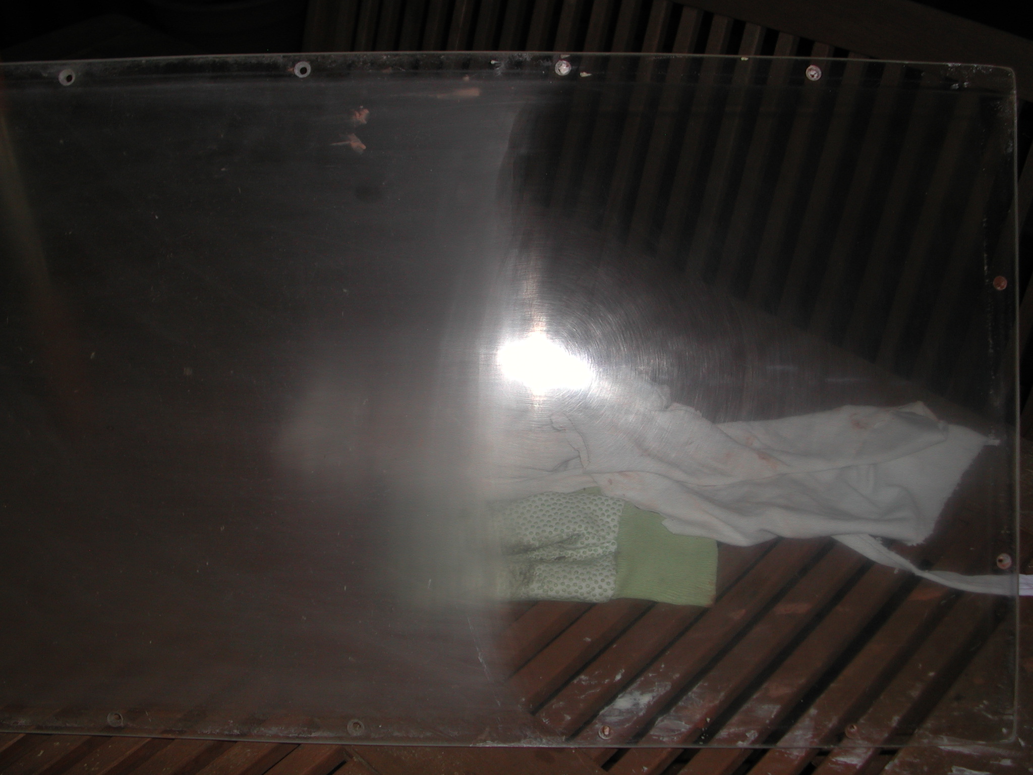

The John Gambill School of Windshield Restoration 16 years 5 months ago #8641
  • crosbyboat
  • Posts: 677
  • Karma: 31
The master windshield restorer shared his secrets on FG regarding how to restore a plexiglass windshield. Attached are photos of the stbd front window of the 18DC. Horribly hazed and scratched on one side, and the other after spending no more than 15-20 minutes on it. Amazing. JAG has saved me probably more than $500 with this easy repair. $20 in material and some elbow grease is all it will take.
