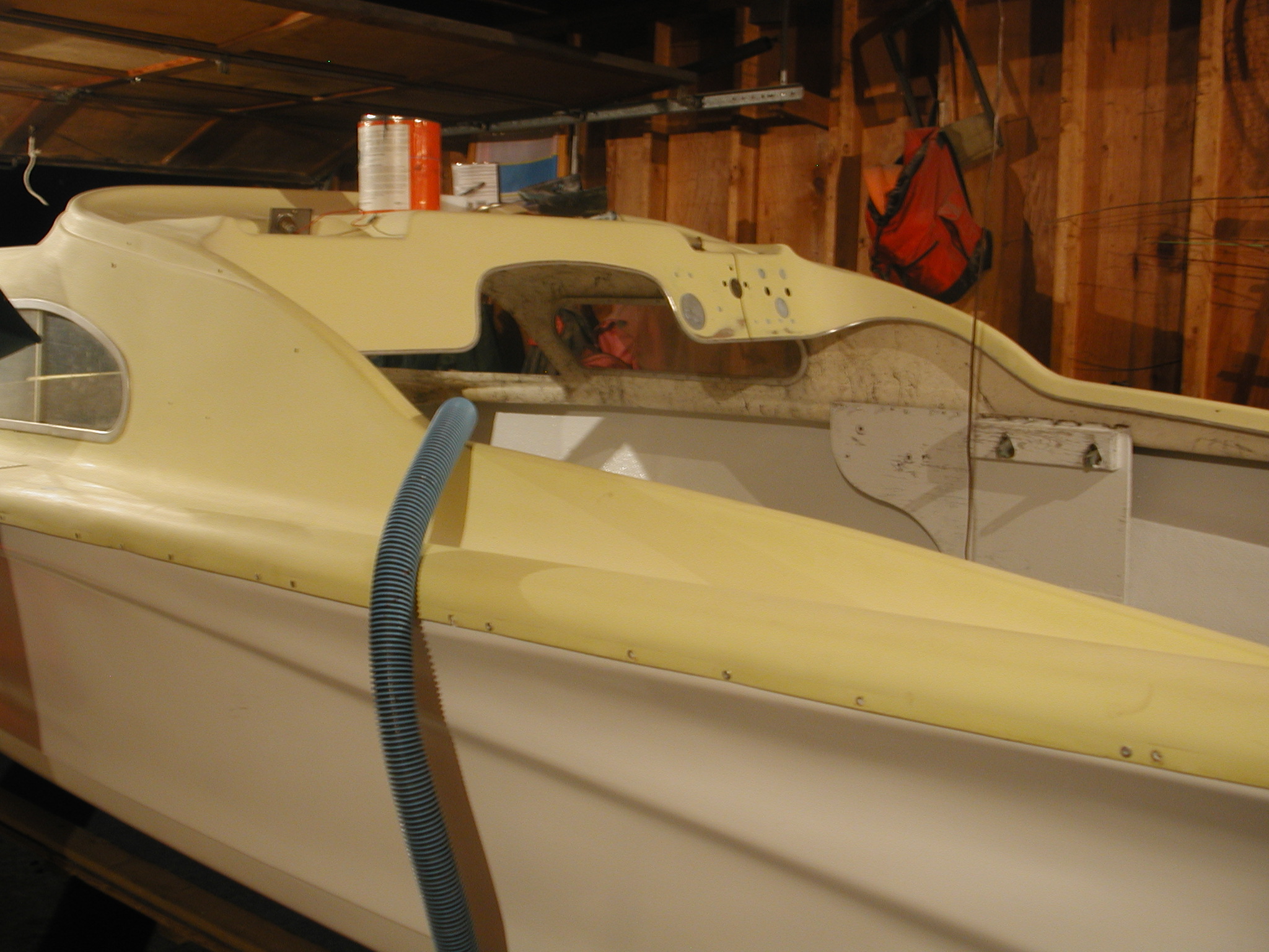

Yanked the 18DC out of the snow and put it back in the garage. Pulled the RideGuide steering system and figured out why it was so stiff. NOT a bad cable, but just an oxide build up in the steering tumbler. A little emory paper and grease and it works great. Started filling dash and transom holes. Motors under way too. To do list getting shorter.

Yup, well down the path on this one. Already been split in two, new transom in, top back on and transom cap done, exterior hull painted with epoxy. Mostly finishing work left. You can see the complete rebuild over on Danny Ledger's Power Cat site.

Spread a little primer on the glass repairs. Getting darn close to painting. A few little fixes of pin holes to do, but overall in great shape.
