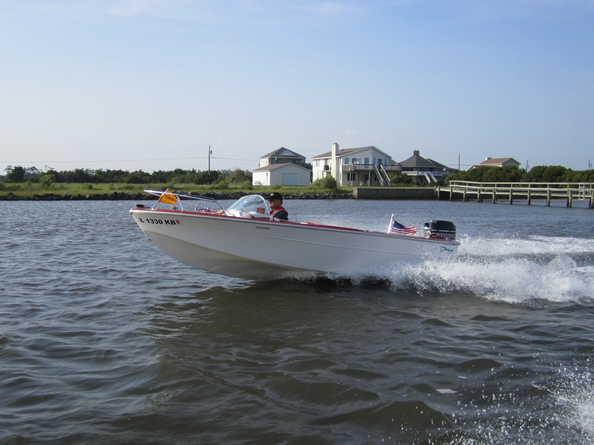

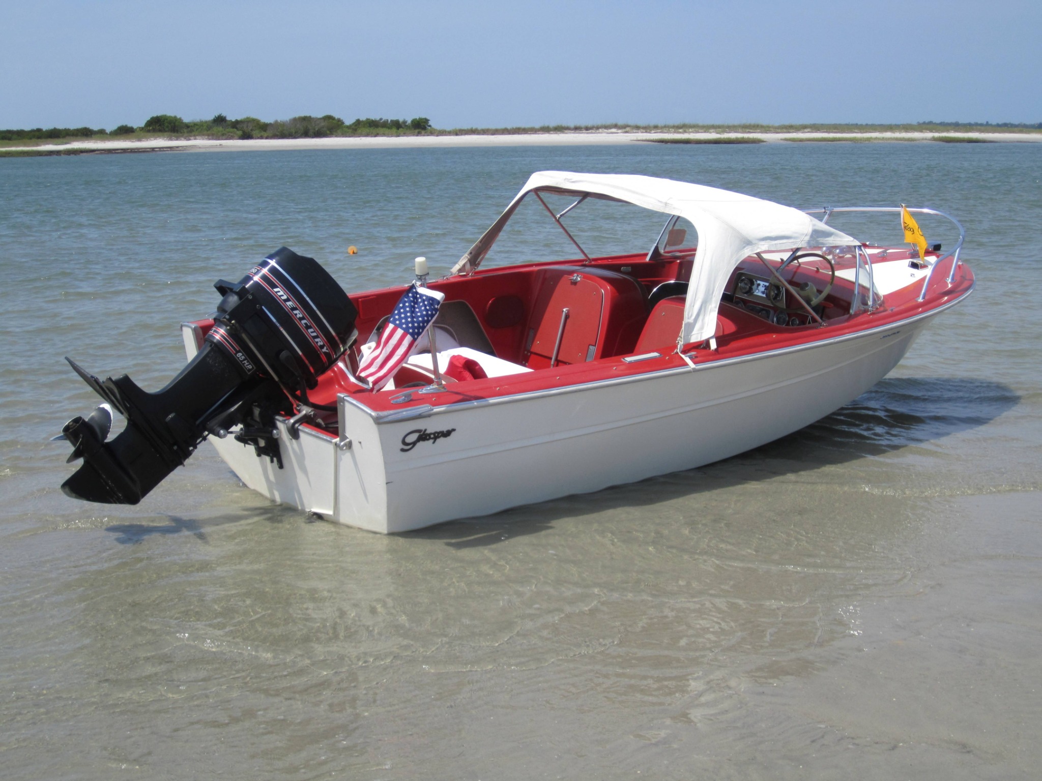

Lotsa Glasspar fans here so please share photos of the Citation.
Would hate to see an old Merc get swapped out but modern power sure has advantages.
A friend runs a 65hp Merc on his Citation and he always said he would like more.
The Citation is one of my favorite Glasspar models and is testament to the genius of Bill Tritt.

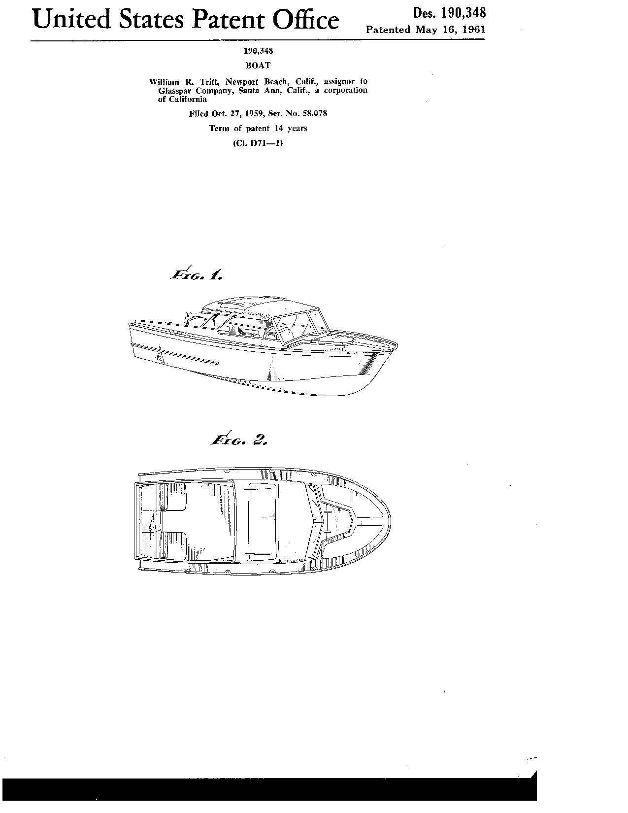

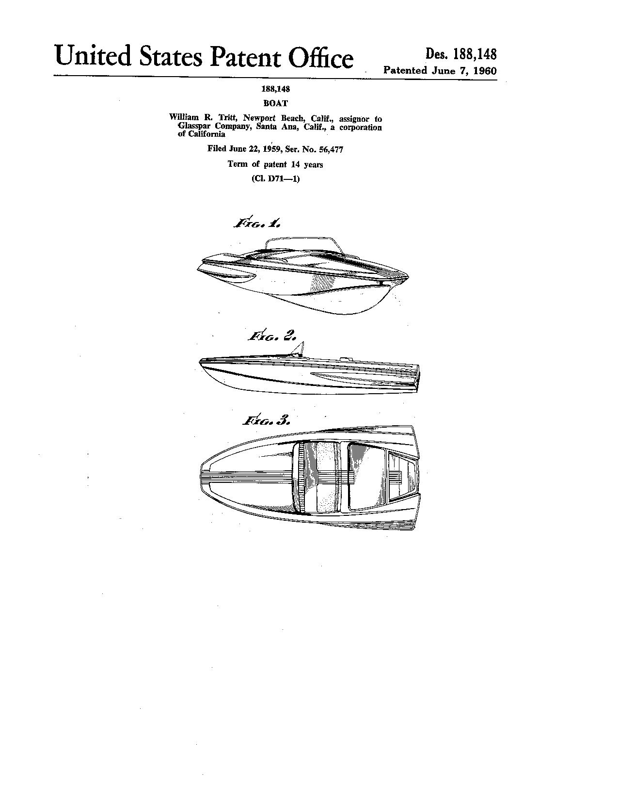

The FG library here has good information on Glasspar and includes a few of the patents.
The G3 which was new for 59 is the earliest listed.

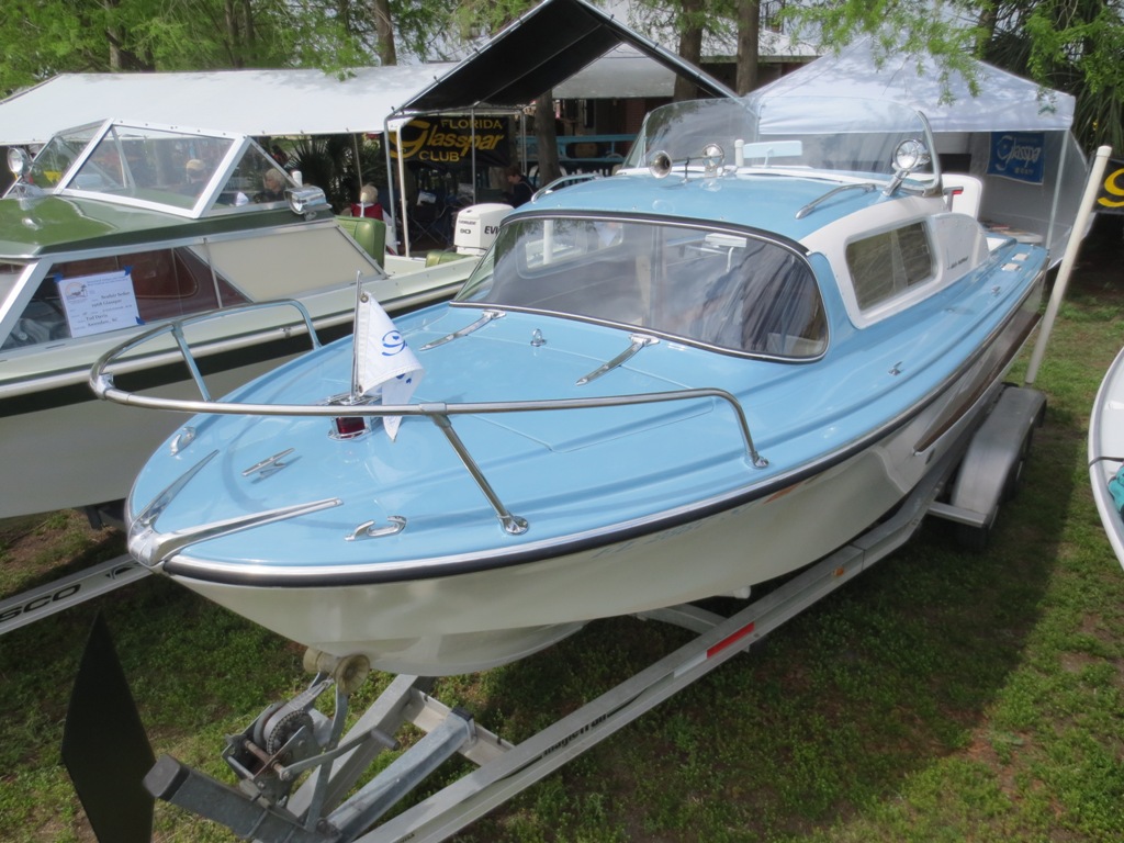

The Seafairs and G3’s seem to be everyone’s favorite but we are in the same boat with the Mariner.

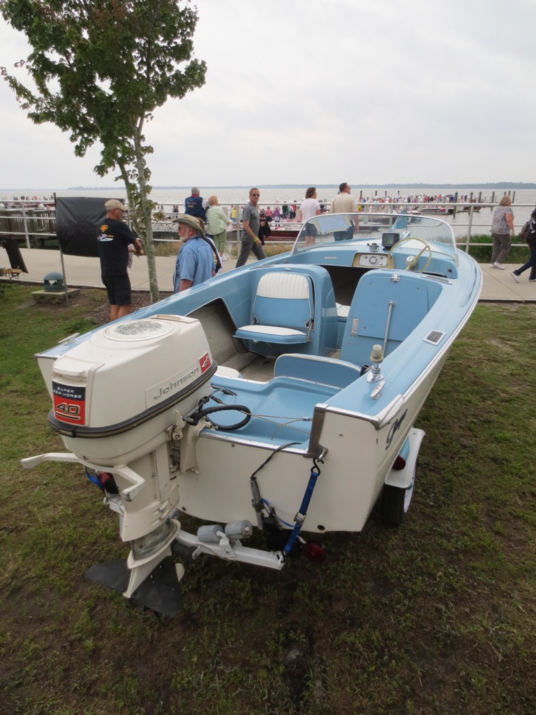

Friends have restored this 60 Club Mariner and I posted pictures of it and other Glasspars at Tavares FL years back.
www.fiberglassics.com/forum/main-forum/92458-acbs-2014-sunnyland-boat-festival-glasspar-winners.html#92458
Another pretty Citation was shown there too.
